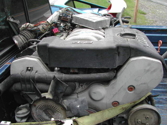

engine man (fieroa8@gmail.com) MSG #1, 06-10-2012 12:09 PM

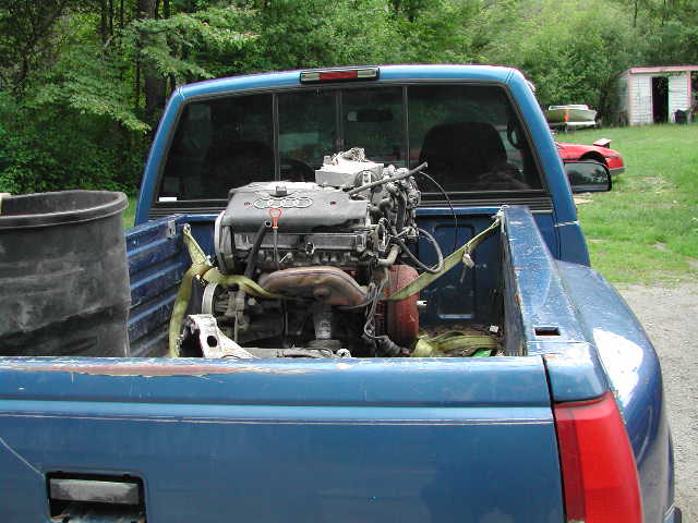

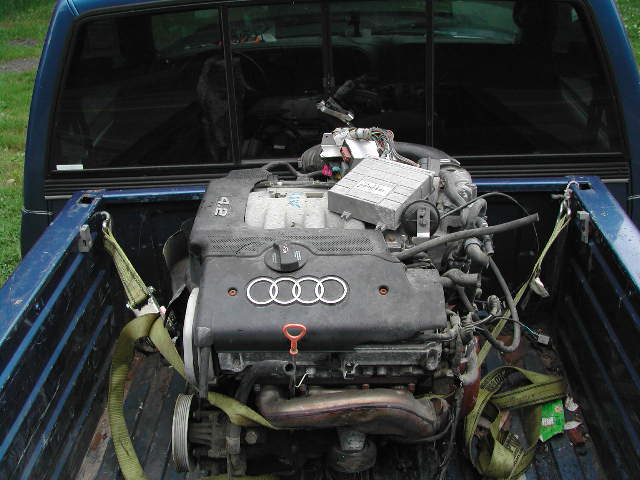

      I have bought an 1998 Audi A8 engine and a 2001 Passat 012 transmission plus the wiring harness and ECU to put in my 1988 Fiero T Top car . The engine will be mounted Longitudinal not transverse i will not stretch the car or cut the fire wall I should be able to keep the CV joint angle at about 10 degrees since the engine is so short. If one of you could send me the wiring schematic for a 1998 audi A8 so i can figure out the harness i would appreciate that

No, he bought the motor, eventhough he showed us a picture of the car instead of the motor which I'd have preferred to see.

      how low would you dare to run the engine's oil pan from the ground
seajai MSG #27, 06-12-2012 11:27 PM
      How tall is the engine? Seeing as how the firewall is angled and you want the least amount of angle on the CV shafts, I would think to run it as low as bottom of the cradle, lower if you make a skid shield. This would allow you to get it as far forward as possible.
engine man (fieroa8@gmail.com) MSG #28, 06-13-2012 06:13 AM
      the engine is 25 tall from the bottom of the oil pan to the top of the intake and it is 23 inches tall to the top of the timing belt covers . the engine bay is 24 inches from the top of the cradle to the top at the firewall and the cradle frame rail are 4 inches tall
engine man (fieroa8@gmail.com) MSG #29, 06-13-2012 06:28 AM
      the first thing that will hit the firewall would be the timing belt covers. my plan is to run the engine oil pan 2 inches below the frame rails and maybe put an aluminum belly pan under it

engine man (fieroa8@gmail.com) MSG #32, 06-13-2012 11:04 AM
      thanks guy's, so the 98 A8 was drive by wire throttle hmm i am not a big fan of that but as long as it can be tuned to just do what my foot is telling it and not give me some crappy throttle response . after thinking about it Will you are right the gain i would get froward wouldn't be worth it being lower . again thanks for the input

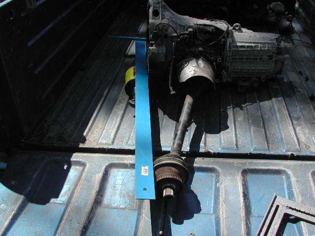

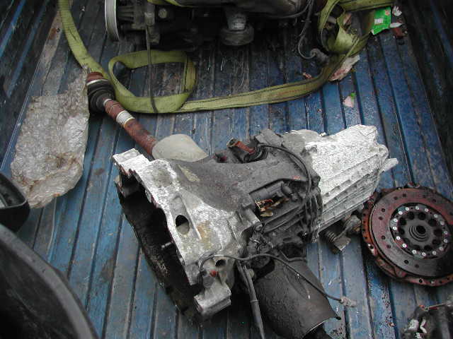

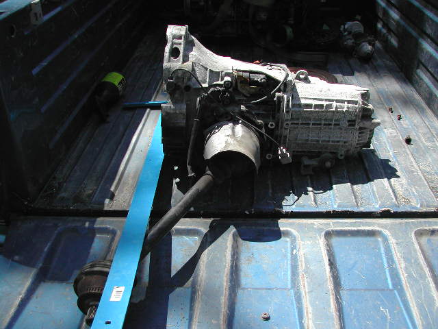

engine man (fieroa8@gmail.com) MSG #39, 06-14-2012 03:33 PM
      Thought i would post a few pictures of the angle of the axle i expect to be running . the top picture shows the maximum angle the axle can go when it binds about 25 degrees the bottom picture is about the angle i expect to be running around the 15 degree mark.
the axles are within 1 inch of the correct length

      thought i would put a few pics up of the engine removal . i am just getting it ready to come out right now and there will be a few nice parts for sale
engine man (fieroa8@gmail.com) MSG #66, 07-10-2012 06:19 PM
      just looked up how much to re-spline my axles so i can use the fiero outer CV joint Moser engineering gets $125 per pair that seems like a really good price
Will (william.lucke@gmail.com) MSG #67, 07-11-2012 02:57 PM
      Length? Resplining the Audi axles to the Fiero spline?
[This message has been edited by Will (edited 07-11-2012).]
engine man (fieroa8@gmail.com) MSG #68, 07-11-2012 03:04 PM
      I cant remember off the top of my head for sure but i think it was 24 inches and the passat axles where just the right length due to the passat and fiero have close to the same track width . tomorrow i should have the engine out i have the day off i just hope the 2 back cradle bolts don't fight me . yes VW to fiero spline since the transmission stuff is from a VW passat

      if i remember correctly the axle centerline to bellhousing face is about 6.75 on the 012 transmission and 7.87 on the 016 i have the 012 transmission seajai. thanks for the help motoracer838
engine man (fieroa8@gmail.com) MSG #91, 08-04-2012 08:20 AM
      034 motorsports flywheel insert and a F1 ceramic clutch disk no springs

      A picture showing the axle offset

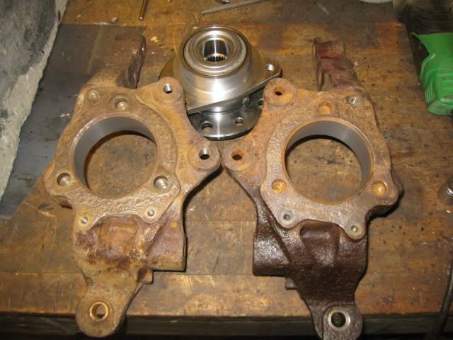

      Yaa i got my knuckle back today from the machine shop

Will (william.lucke@gmail.com) MSG #238, 10-03-2012 03:01 PM
      Interesting.
engine man (fieroa8@gmail.com) MSG #239, 10-03-2012 03:53 PM
      this should allow me to run VW passat axles when used with their hubs that are redrilled to 5x100 bolt pattern. the VW axles are bigger and have bigger CV joints

engine man (fieroa8@gmail.com) MSG #249, 10-08-2012 02:59 PM
      yes i was surprised that they where so low priced for that engine also
picture of the 40 valve
its really not much to look at with the engine cover

engine man (fieroa8@gmail.com) MSG #258, 10-13-2012 04:06 PM
      thought i would show how the hub bearing looks on the knuckle and the axle angle with the knuckle and axle on the car . i need to get the hubs in a few weeks and drill them to the 5x100 lug nut pattern
ghost187x MSG #259, 10-13-2012 09:58 PM
      What are you doing for brakes? And why keep the 5x100 pattern?
engine man (fieroa8@gmail.com) MSG #260, 10-13-2012 10:40 PM
      just stock 88 brakes and why keep the 5 x 100 because i have wheels for it and it's not that hard to drill the new hubs for the 5 x 100

Will (william.lucke@gmail.com) MSG #264, 10-14-2012 05:44 PM
There are VAG products that use the 5x100 pattern already (like the TT...). Can you use a hub from one of those cars so you don't have to redrill the Passit hub?
engine man (fieroa8@gmail.com) MSG #265, 10-14-2012 06:51 PM
      Will i might be able to I just need to see what size bearing they use i am using a 82 mm bearing

      VW has 2 bolt patterns 5 x 100 or 5 x 112 the 5 x 100 wont work with the 82 mm bearings i used and if i use the hubs as they are i will need to buy 2 wheels due to the 5 x 112 bolt pattern so i can buy wheels and rotors or i can have these modified

engine man (fieroa8@gmail.com) MSG #977, 12-10-2015 06:19 PM
      well the new engine came in and looks much better no water in the cylinders or in the intake runners like the last engine
