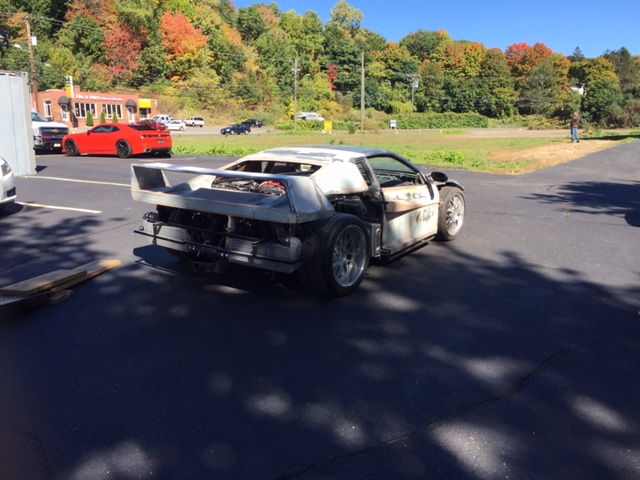

Bozzie (widerisbetter88@aol.com) MSG #1, 01-26-2012 05:45 PM
      http://i252.photobucket.com...ec/stage11202012.jpg

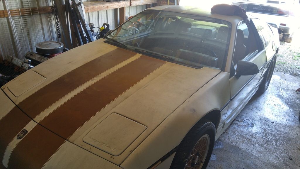

Bozzie (widerisbetter88@aol.com) MSG #9, 01-27-2012 03:18 PM

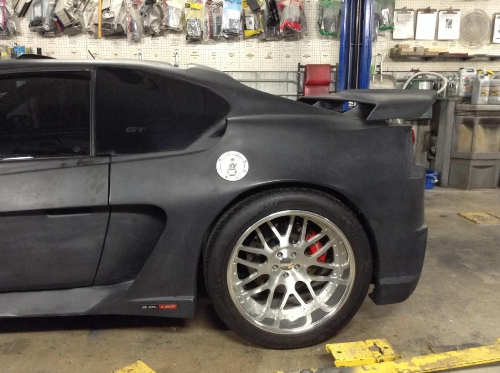

      Ok, now that i know how to post i'll start at the beginning. Here is my 88GT with 31k miles on it. I bought it with 28k back in 2006. Took er' out on nice days and enjoyed her for what she was.
Bozzie (widerisbetter88@aol.com) MSG #10, 01-27-2012 03:19 PM
      Next came 18" TSW's 8" front 9" rears
Bozzie (widerisbetter88@aol.com) MSG #11, 01-27-2012 03:20 PM
      Battery relocation Via West Coast Bucket
Bozzie (widerisbetter88@aol.com) MSG #12, 01-27-2012 03:21 PM
      Made a custom fiberglass enclosure for the passenger kick......yes....it Rocks ! And plenty of foot room as well .
Bozzie (widerisbetter88@aol.com) MSG #13, 01-27-2012 03:23 PM
      I had Dietmar make this rear spoiler with 3rd brakelight while he was still building for people.
Bozzie (widerisbetter88@aol.com) MSG #14, 01-27-2012 03:25 PM

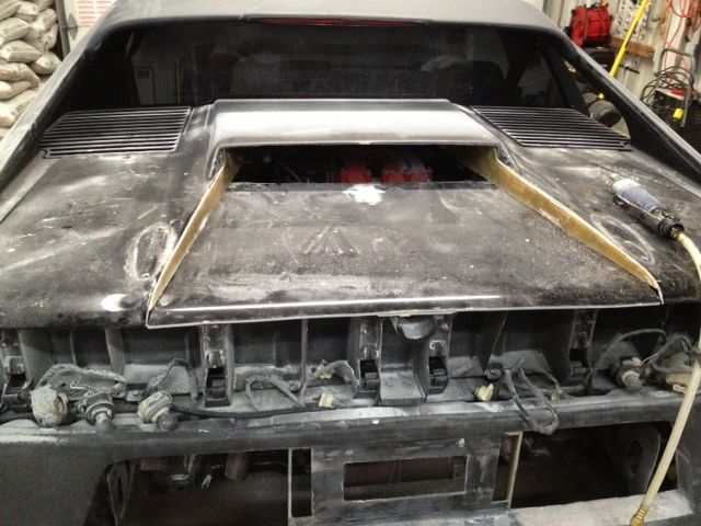

      Here is a pic of my hood. Its a mustang cobra hood idea i got from another PFF member....i believe his car was purple.
Bozzie (widerisbetter88@aol.com) MSG #15, 01-27-2012 03:26 PM
      Here is the Dietmar sideskirts and scoop i had made well. These pieces are now for sale 450 shipped.
Bozzie (widerisbetter88@aol.com) MSG #16, 01-27-2012 03:27 PM
      This is were i start the Archie Widebody Kit.

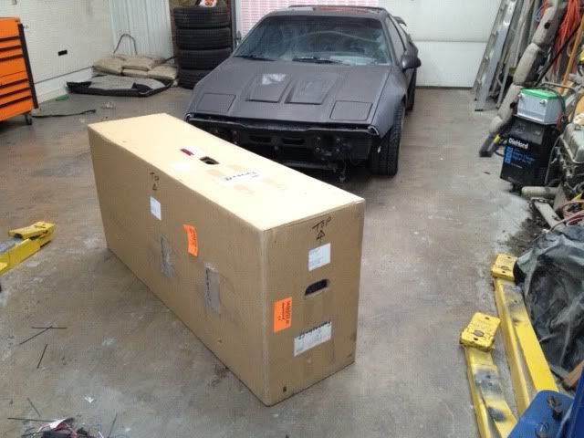

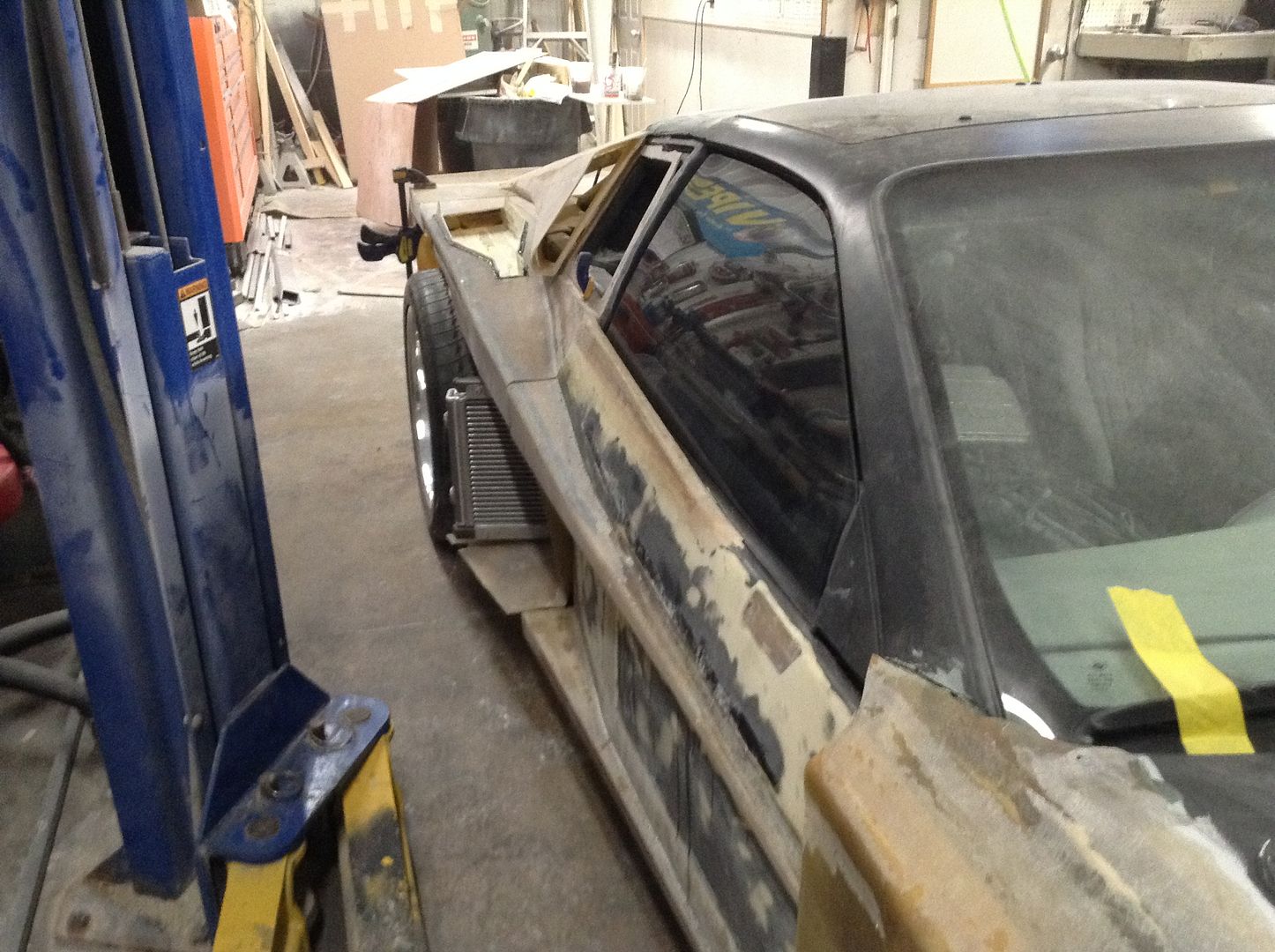

Bozzie (widerisbetter88@aol.com) MSG #17, 01-27-2012 03:43 PM
      Kits comes in !!! My buddy who's takin the pic is not as happy for me ! LOL

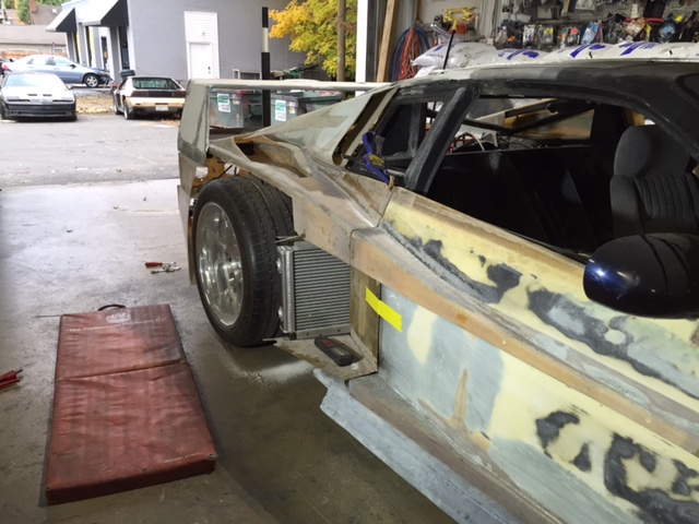

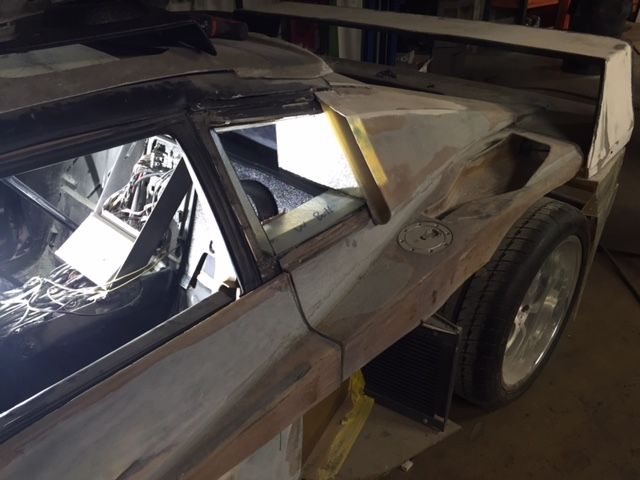

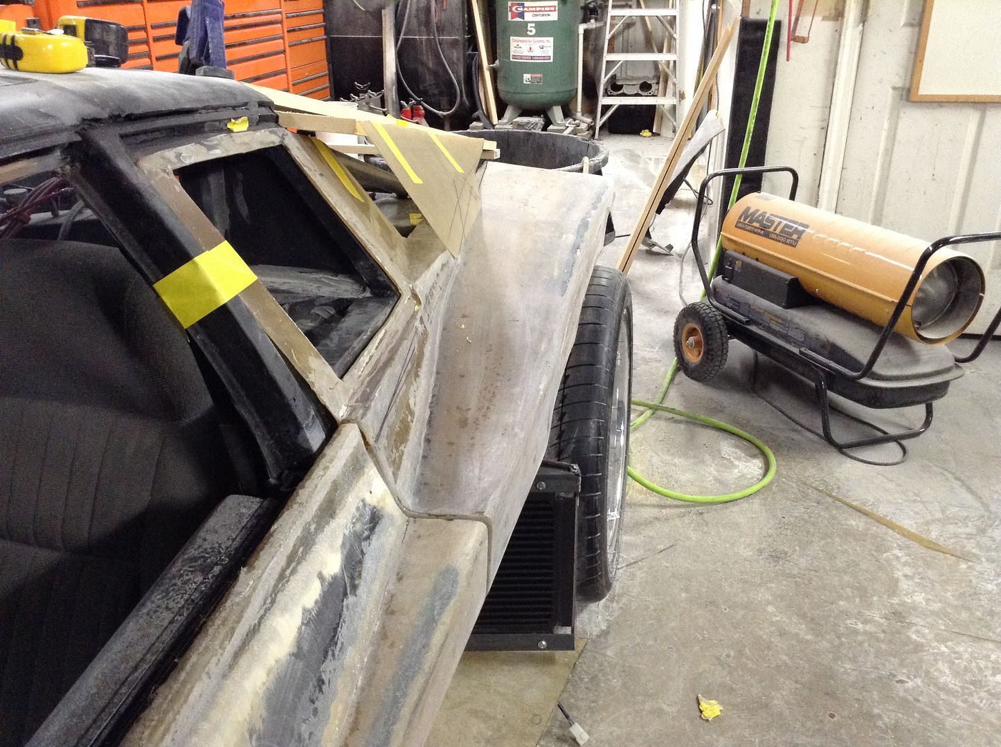

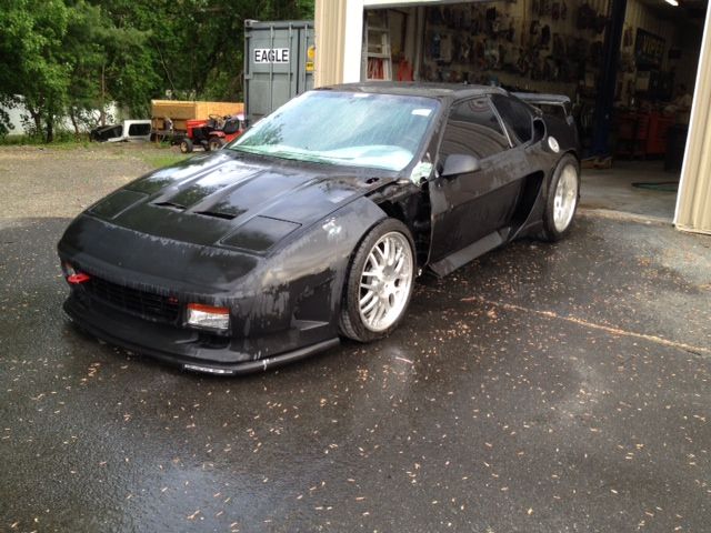

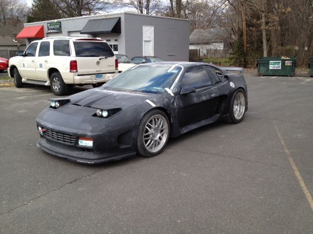

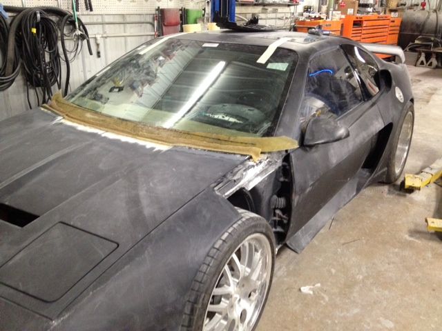

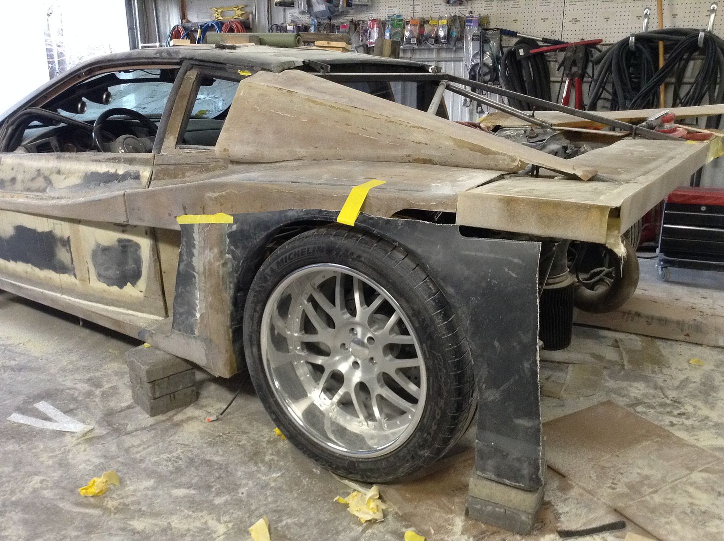

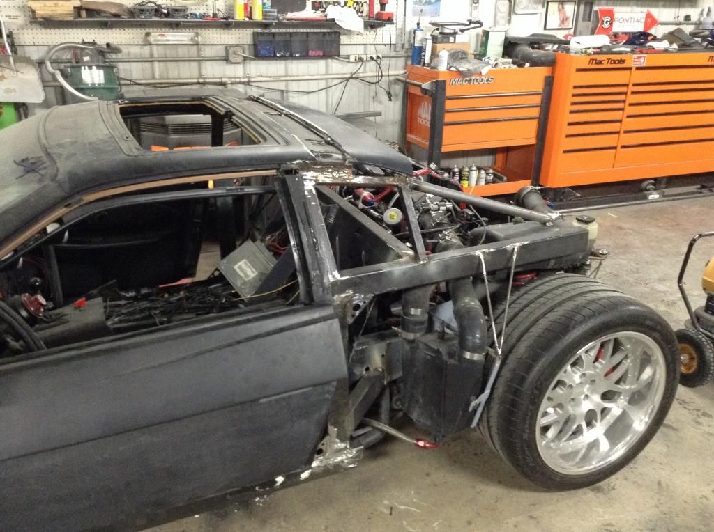

Bozzie (widerisbetter88@aol.com) MSG #19, 02-01-2012 01:32 PM
      Step 1....striping body panels

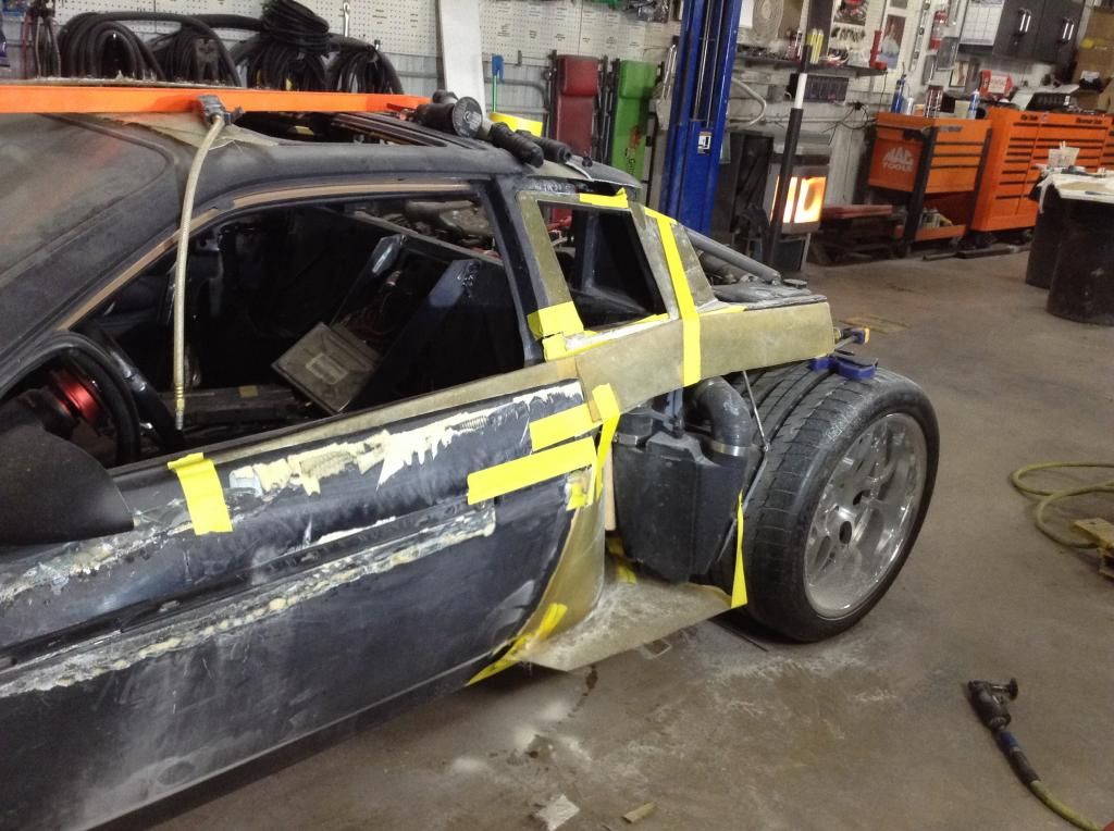

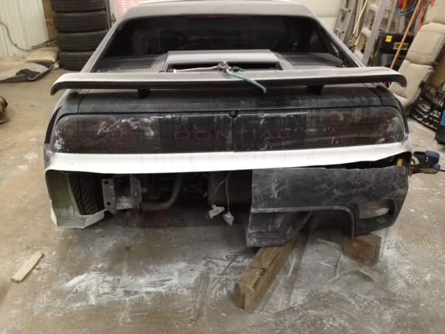

Bozzie (widerisbetter88@aol.com) MSG #20, 02-01-2012 01:33 PM
      Cutting the quarters

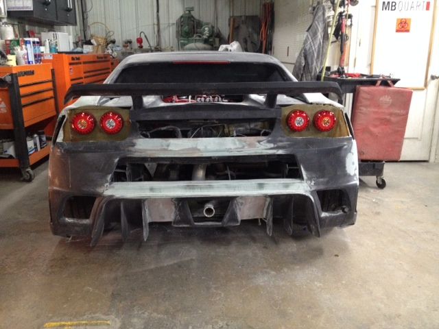

Bozzie (widerisbetter88@aol.com) MSG #21, 02-01-2012 01:34 PM
      Trial fit Favorite part so far !!

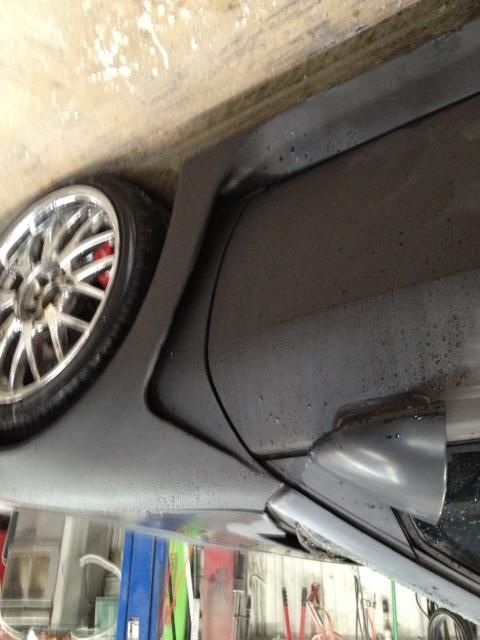

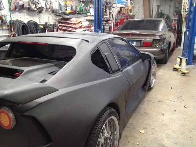

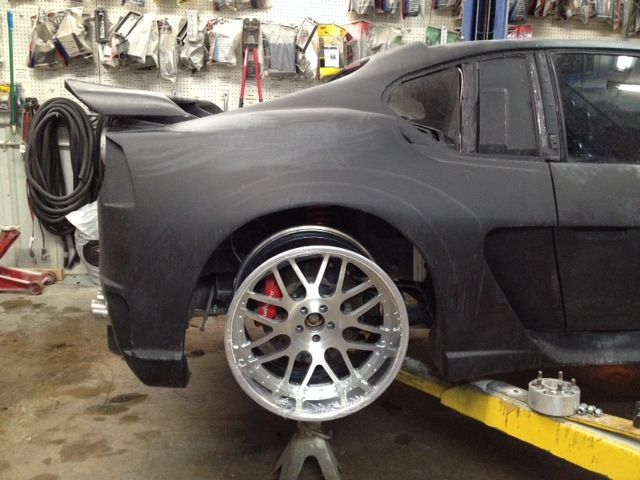

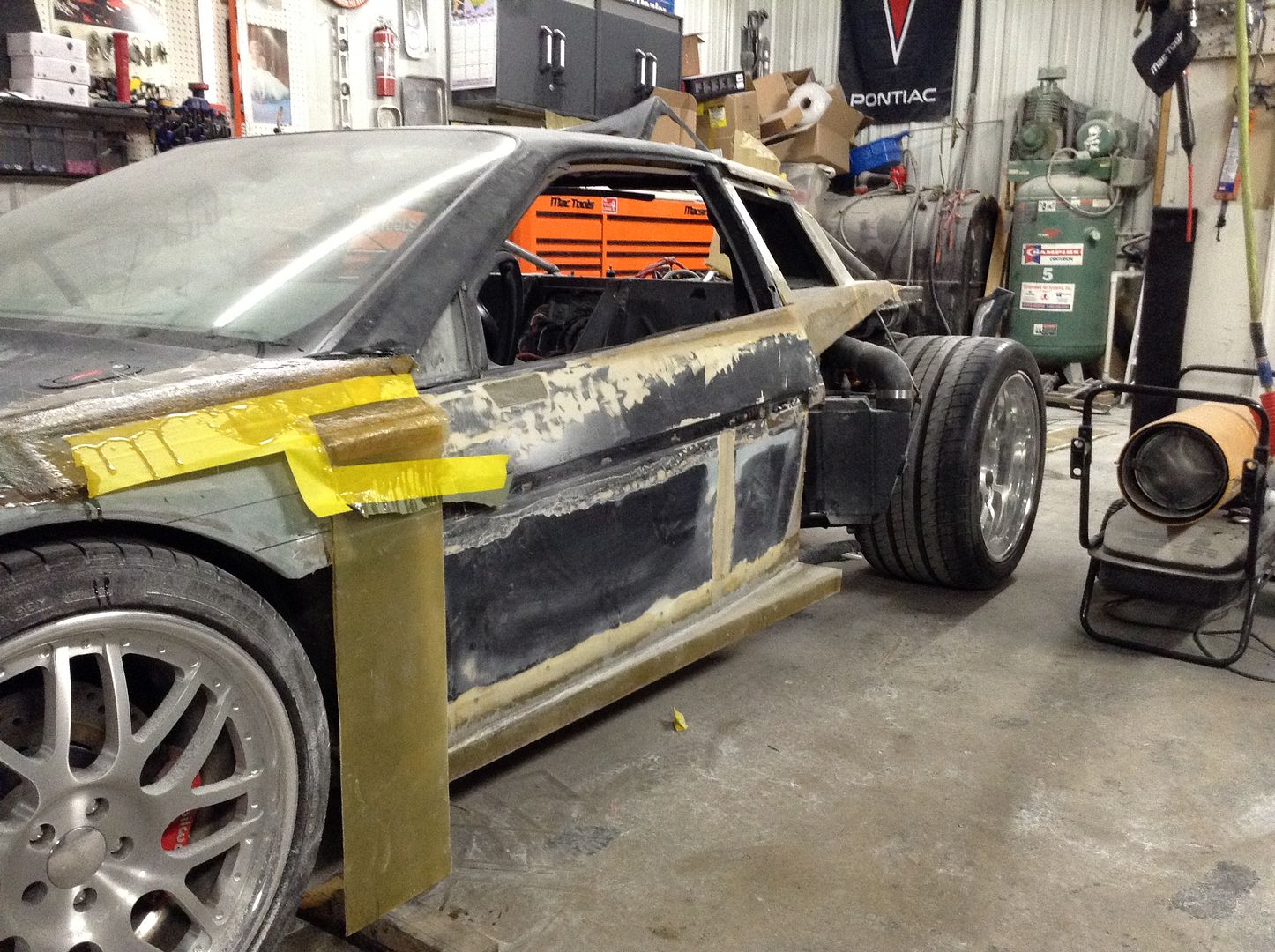

Bozzie (widerisbetter88@aol.com) MSG #22, 02-01-2012 01:36 PM
      Front side view

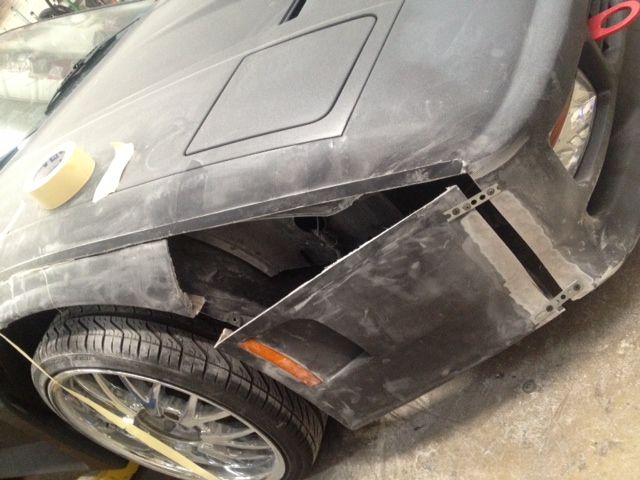

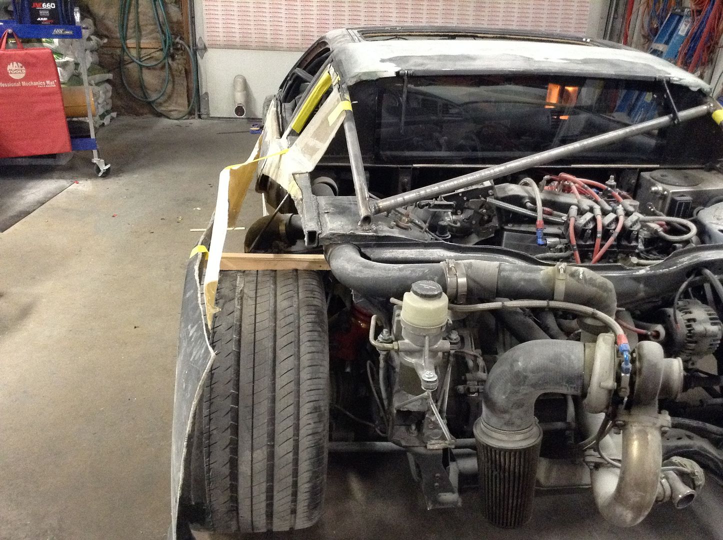

Bozzie (widerisbetter88@aol.com) MSG #23, 02-01-2012 01:40 PM

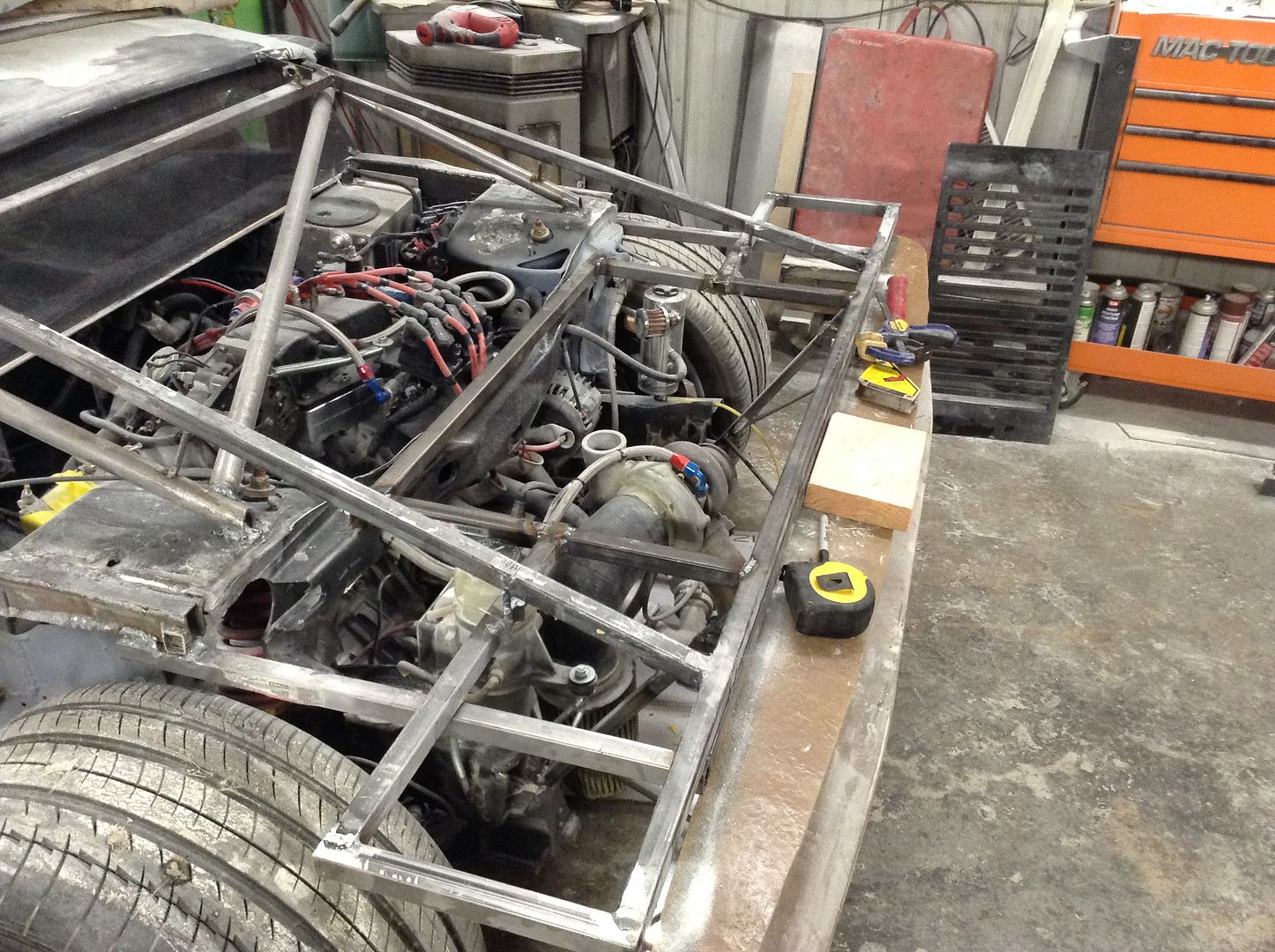

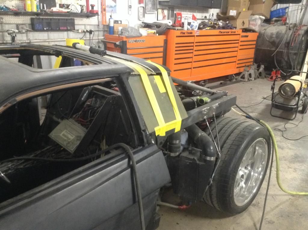

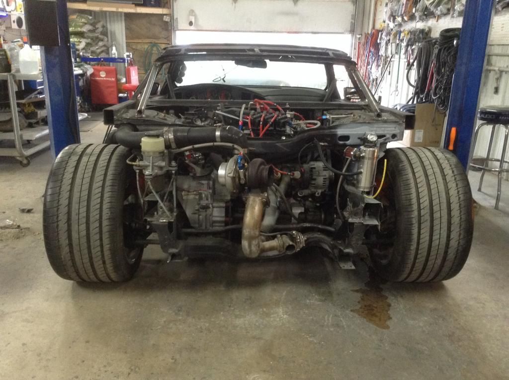

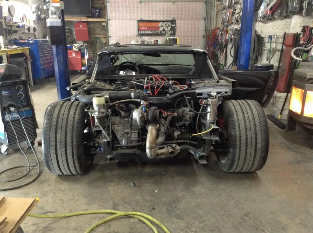

      Trunk ???? Perfect spot for the upcoming TURBO

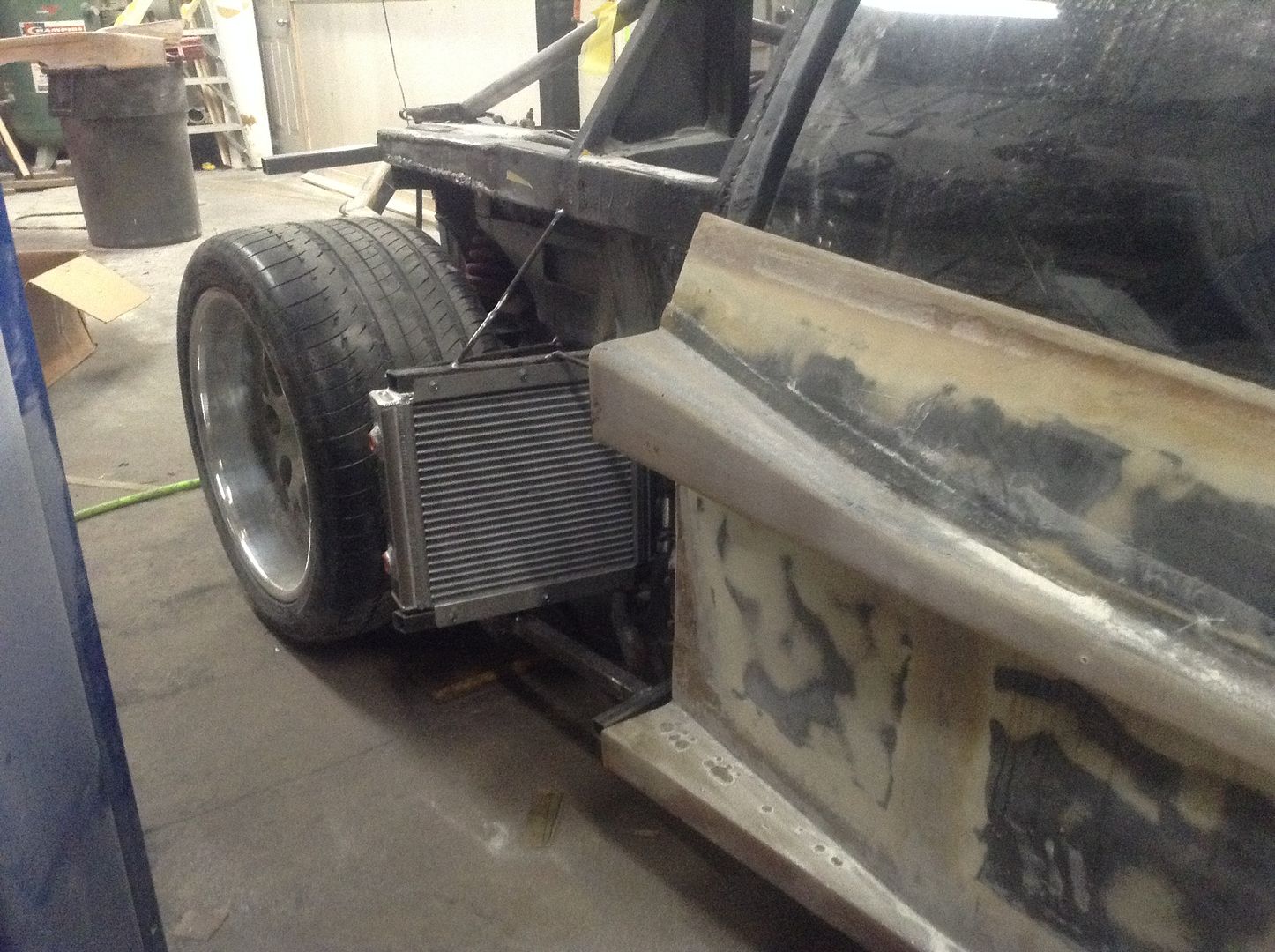

nosrac MSG #24, 02-01-2012 01:50 PM
Originally posted by Bozzie:
What R your mods in that BEAST? I see the GEN V, IC, Headers, but what cam and what TB is that?
nosrac MSG #25, 02-01-2012 02:24 PM
I assume you wan't a rear mounted Turbo.
Better hold off or sell off all those pretty SC mods as you won't need any of them if going turbo? Ask me how I know this?
However, SC is better for winning shows Turbo for winning races. Choose your addiction.

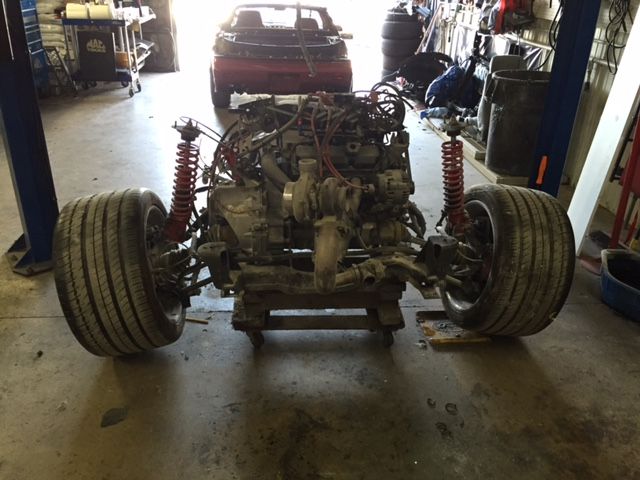

Bozzie (widerisbetter88@aol.com) MSG #26, 02-01-2012 03:17 PM
      Nosrac.....the motor you see was my 1st build. Has Billet TB from ZZperformance, 4" maf sensor, stage 4 cam, 2" intercooler, etc......if you look in the background you'll see a set of ZZP Aluminum heads I took this motor apart and did the heads, a stage 3 Turbo cam, pics to come Blower is sold .
nosrac MSG #27, 02-01-2012 04:26 PM
Oh, snap!
So what Turbo are you using and where are you mounting it. I am also doing a rear mounted 3800 Turbo build too using ZZP PEM and custom T4 adapter Flange.
Also, Stage 3 Turbo Cam, Water to Air IC, L26 intake with /HV3, etc, etc.
Did you run the old setup @ the track? What are your power goals?

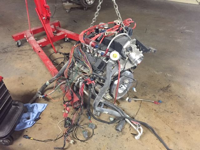

Bozzie (widerisbetter88@aol.com) MSG #34, 02-02-2012 09:53 AM

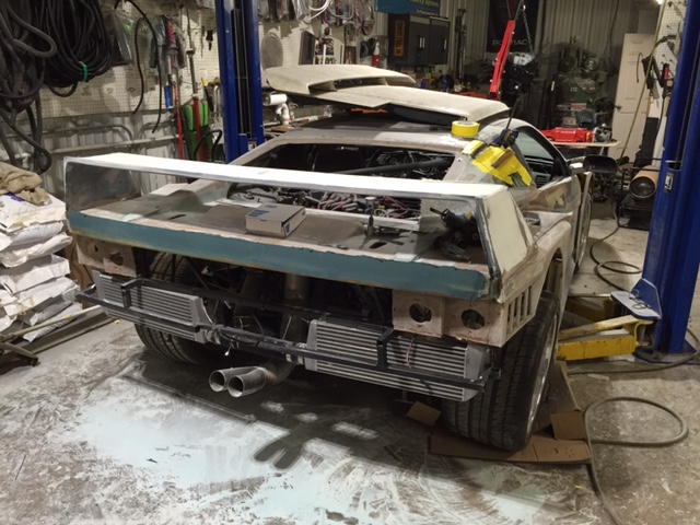

      Nos.....ironic on the builds were doing ! I have a garrett T4 70ar bb liquid cooled turbo. Headers are zzp with custom turbo mount off of it to locate it in the trunk. Water to air intercooler as well. I'll post a pic soon. I never ran that motor with the blower, i build it, and had it read to drop in and then got bored , and ripped it down and went turbo......i have more fun building it i think...thou it'll probably scare the heck out of me when i get it dialed in !! Est. for 500 to 550hp
darkhorizon MSG #35, 02-02-2012 08:30 PM
      I wouldnt be fiddling around with 500hp numbers myself...
What sort of trans setup do you have going? The horsepower is the easy part.... with those heads and assuming you have a quality T70 turbo.... Toss some e85 in and 800hp+ would be a walk in the park.
I suggest AGAINST the headers myself, I am not convinced the heat loss is worth the "directed flow" that a closer to the motor exhaust gives.... Considering there are major RPM issues that need to be addressed on a 3800.
feel free to post up questions as you get moving along.

redraif (redraif@yahoo.com) MSG #43, 02-22-2012 11:19 PM
      Any more pics of the side skirts/rockers? Deciding if they will work with my planned mods... if you have a straight on side shot for a photoshop?

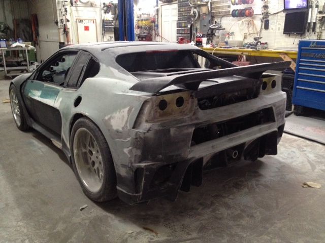

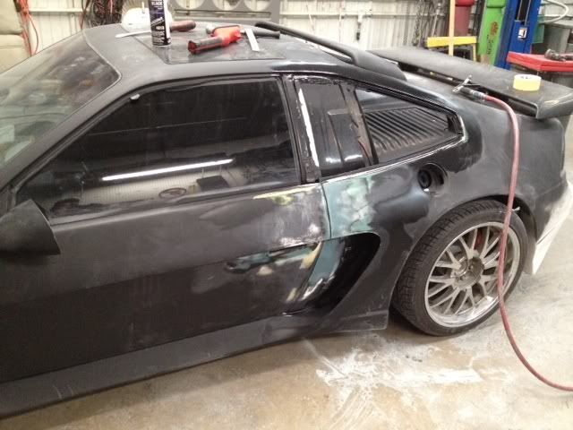

Bozzie (widerisbetter88@aol.com) MSG #45, 03-16-2012 10:20 AM
      http://i252.photobucket.com.../stage11202012-1.jpg
Coming together

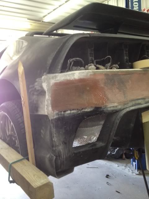

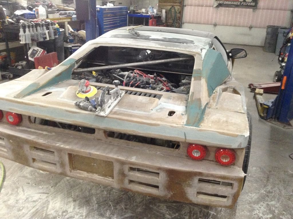

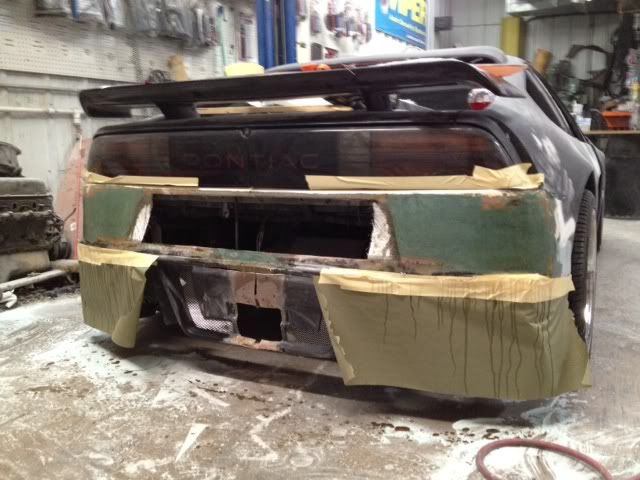

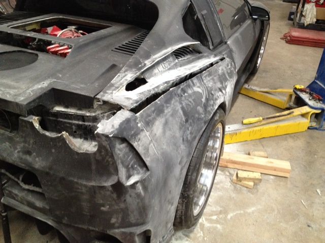

Bozzie (widerisbetter88@aol.com) MSG #46, 03-16-2012 10:21 AM

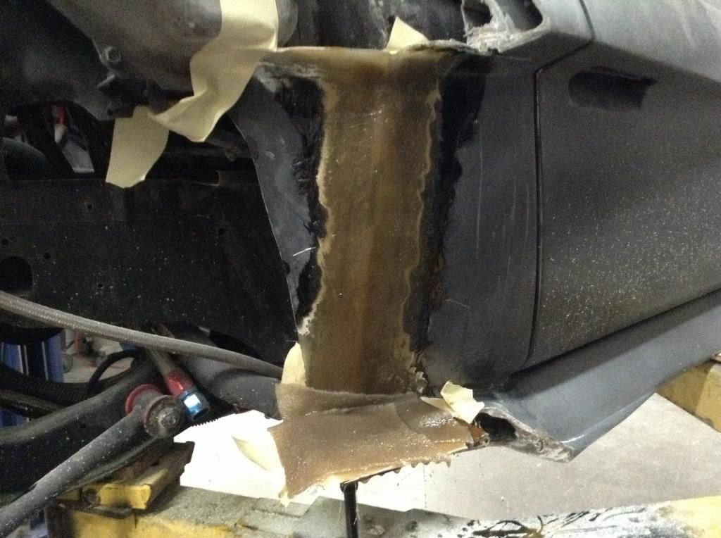

Getting rid of some seams

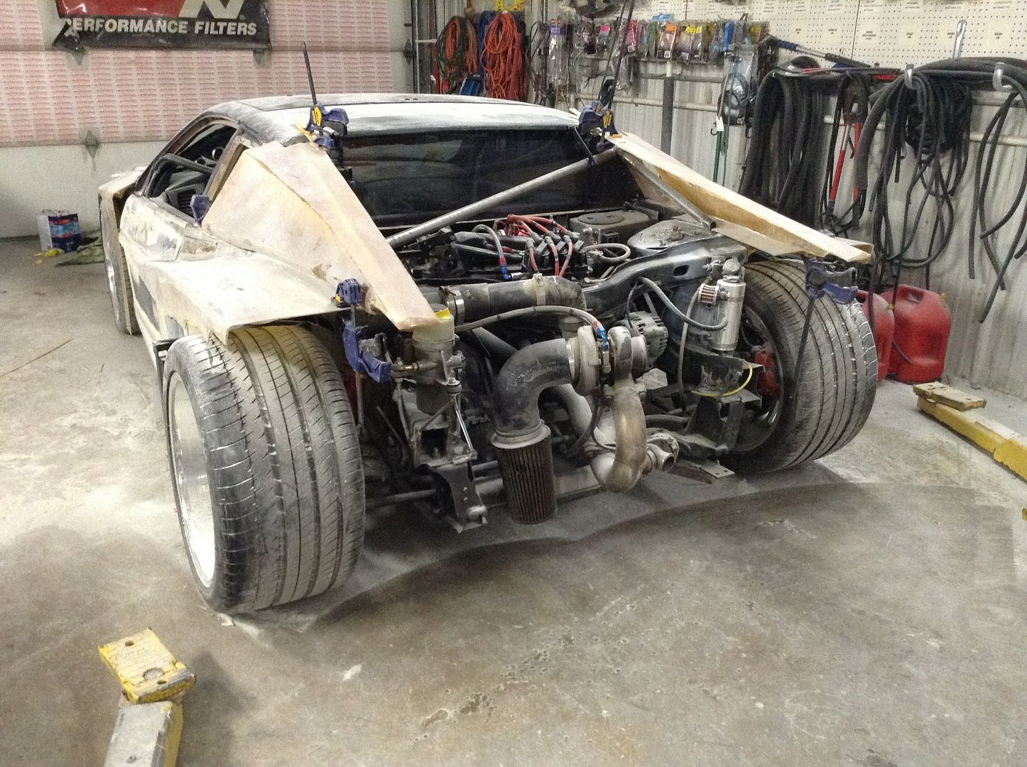

Bozzie (widerisbetter88@aol.com) MSG #47, 03-16-2012 10:23 AM
Quarters , i didnt bother lookin at the instructions thou they are quite good from archie....ive seen this done a dozen times here and done it in my dreams a thousand as well !!
Bozzie (widerisbetter88@aol.com) MSG #48, 03-16-2012 10:24 AM
Fiberglassin
Bozzie (widerisbetter88@aol.com) MSG #49, 03-16-2012 10:31 AM

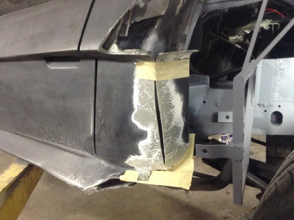

Fender gap.....this kit, thou real good does need to be worked...but heck...thats the fun part !!

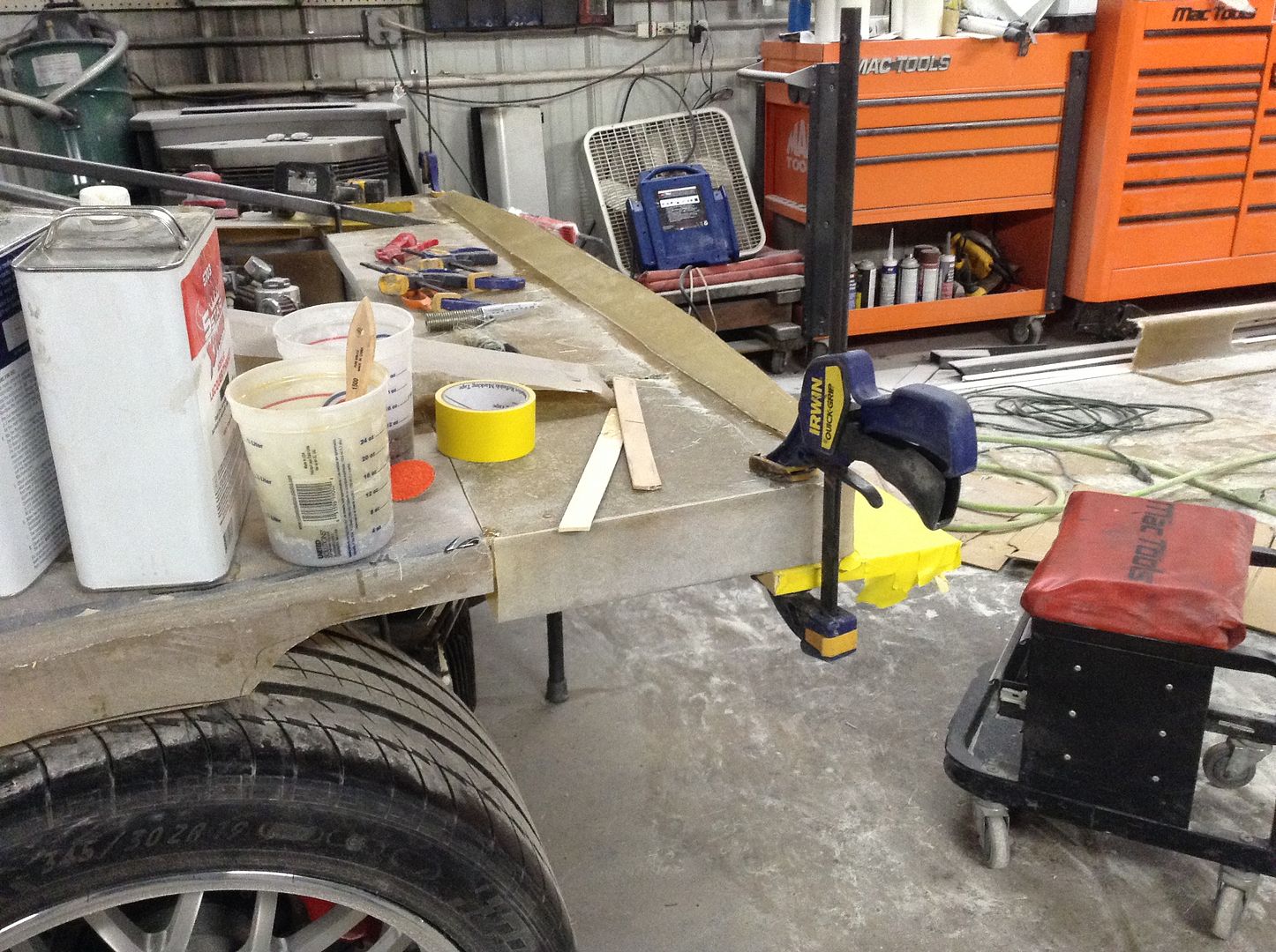

Bozzie (widerisbetter88@aol.com) MSG #50, 03-16-2012 10:33 AM
Glassed
Bozzie (widerisbetter88@aol.com) MSG #51, 03-16-2012 10:37 AM
Door coming together.....this is so time comsuming !!

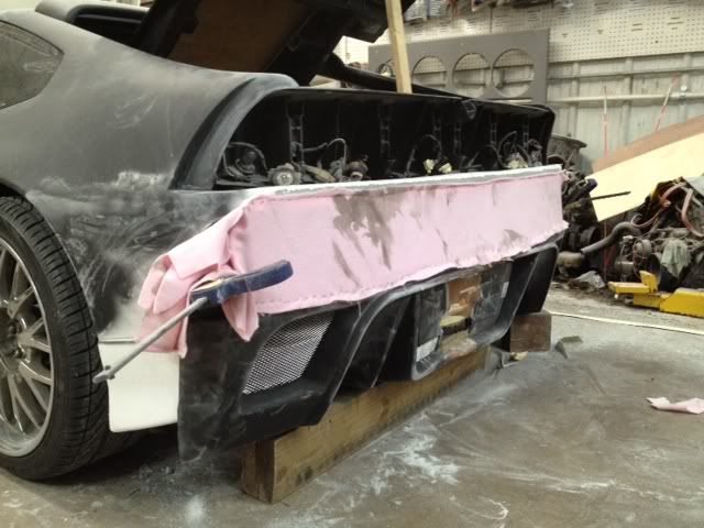

Bozzie (widerisbetter88@aol.com) MSG #52, 03-16-2012 10:41 AM

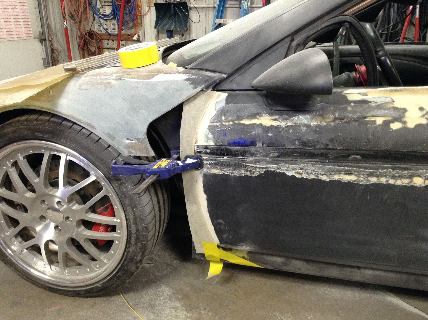

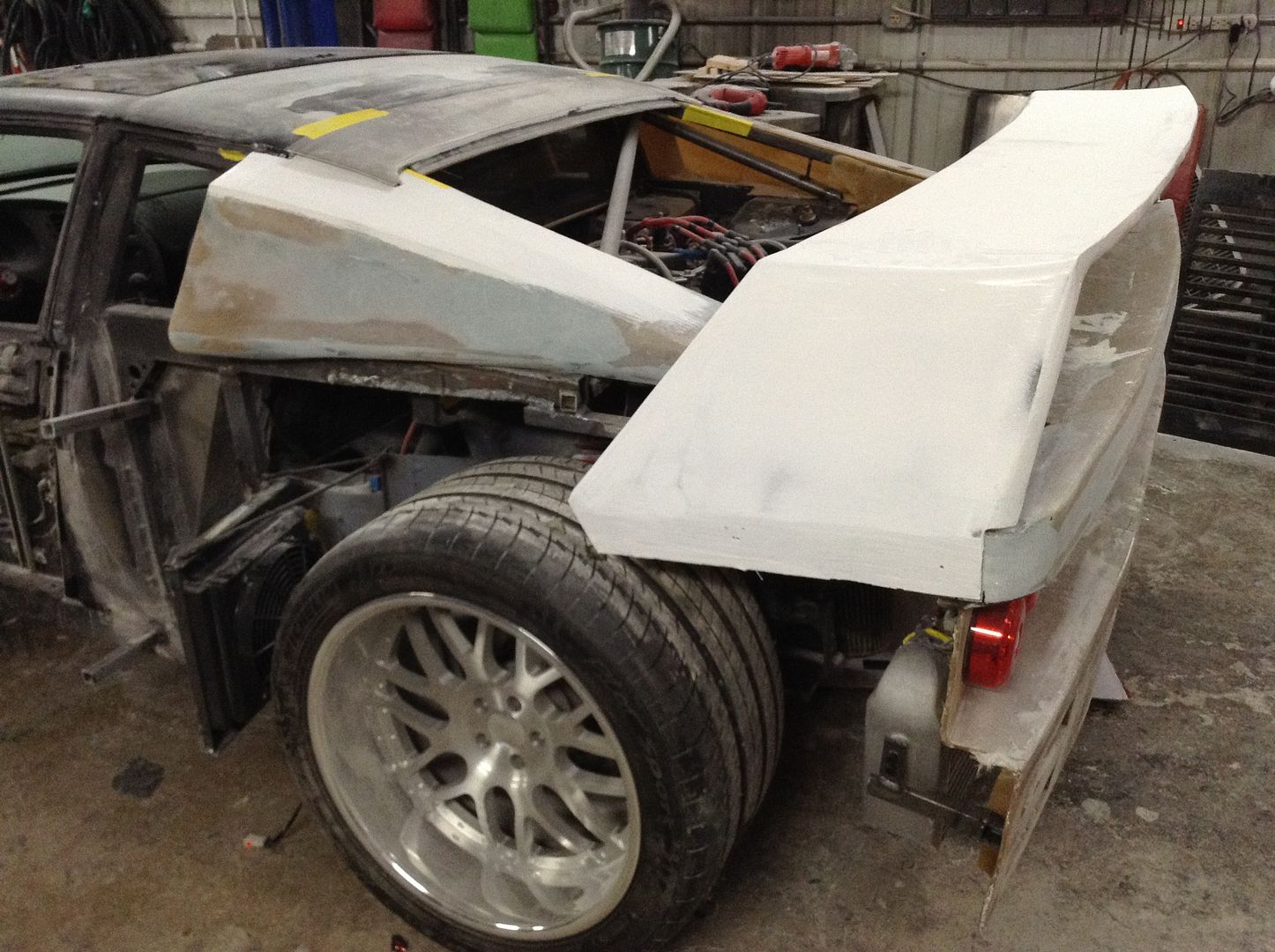

Car is coming together. Ive been working on making in ge gaps tighter in the door seams. The factory gap is just way to much. Now is the time to bring it in. Pics to come. Also on the way is Amida's 512 front bumper )))))) I'll be installing that hopefully next week and making a custom splitter kinda like Whodeanie's. Everybodys cars are such a inspiration to me and my project...thank you

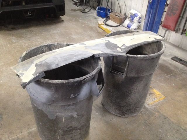

Bozzie (widerisbetter88@aol.com) MSG #54, 03-16-2012 11:29 AM
      GADjet......all seams are fiberglassed inside and out. Im useing duraglass filler over it. It has glass fibers in it for reinforcement.

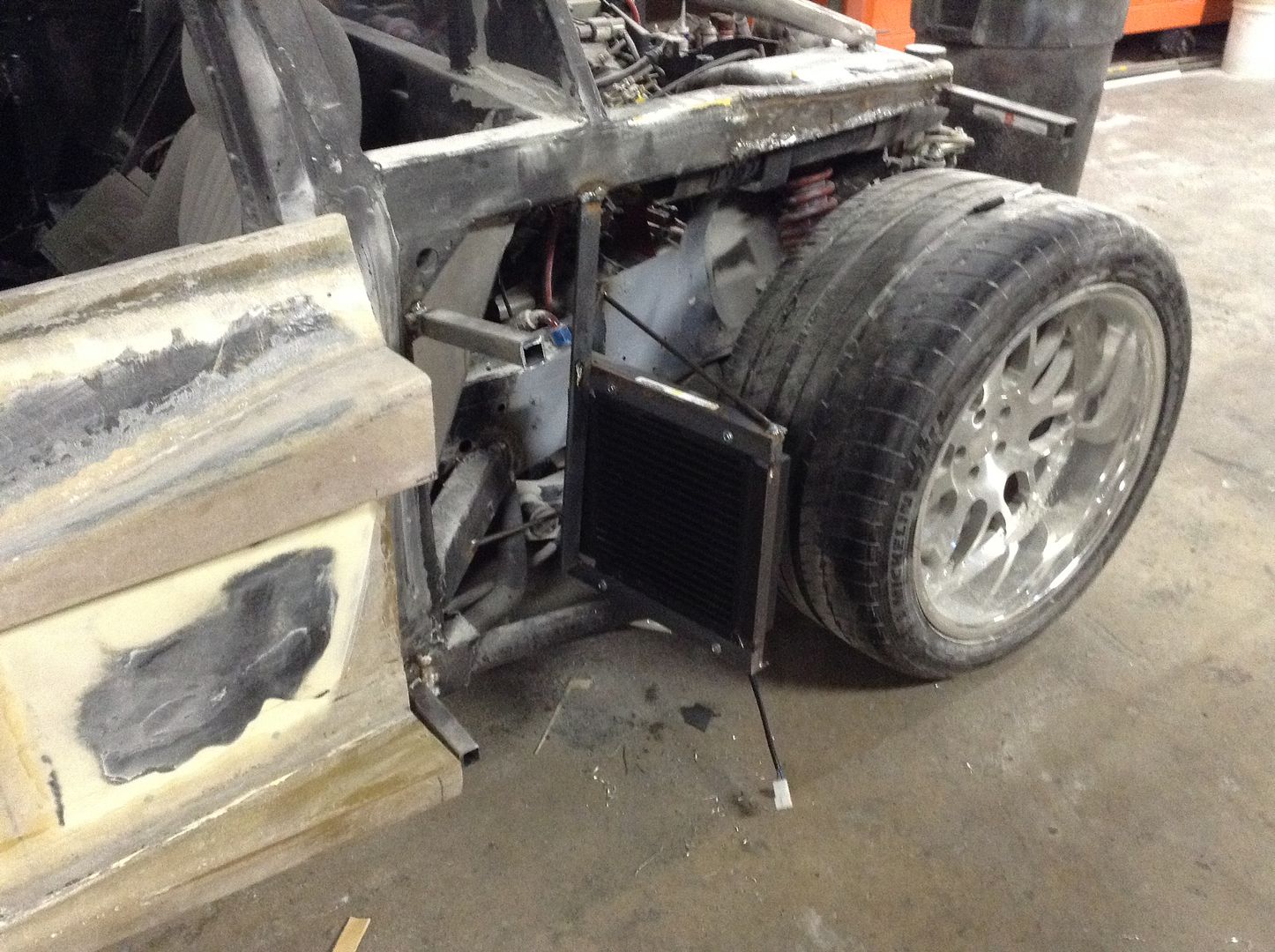

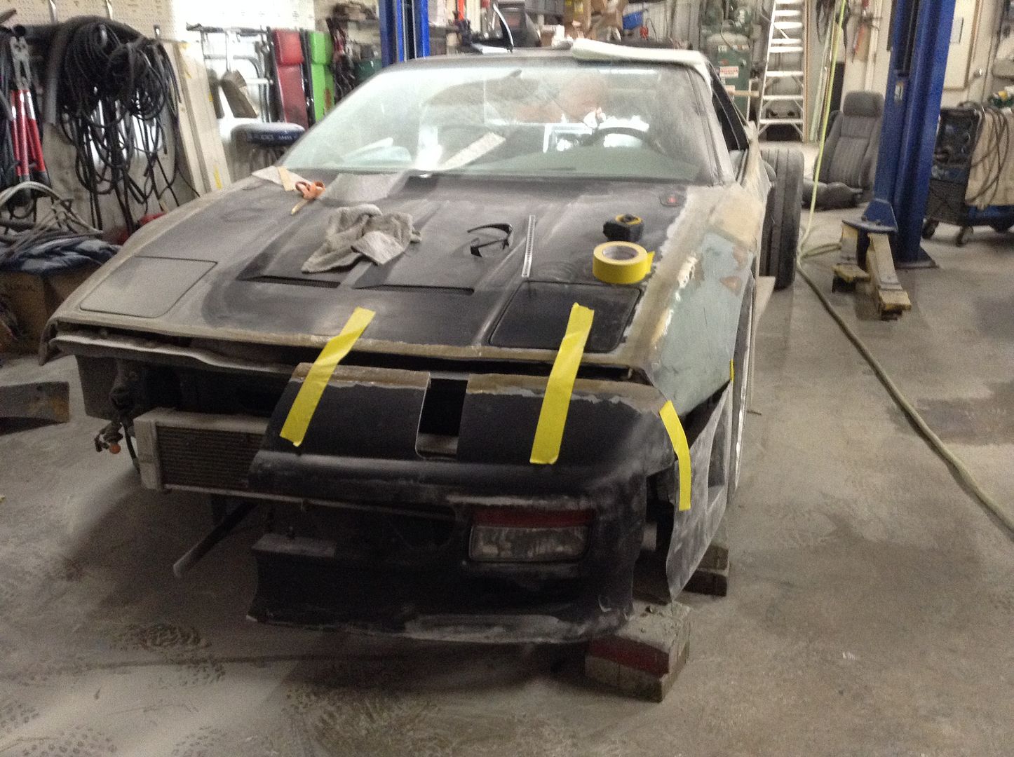

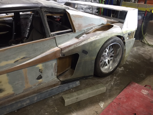

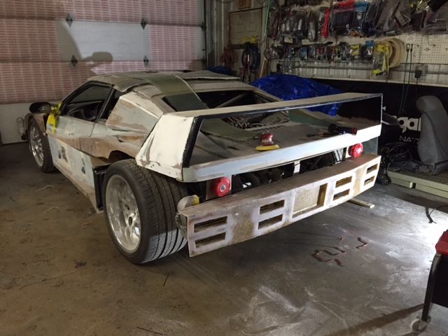

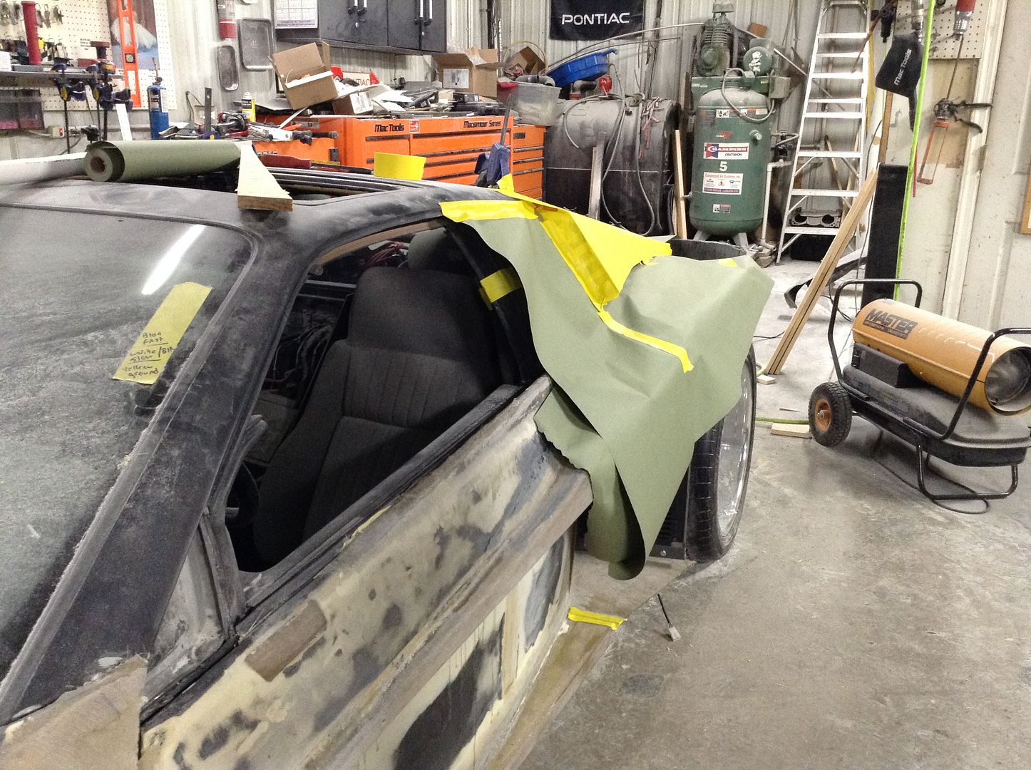

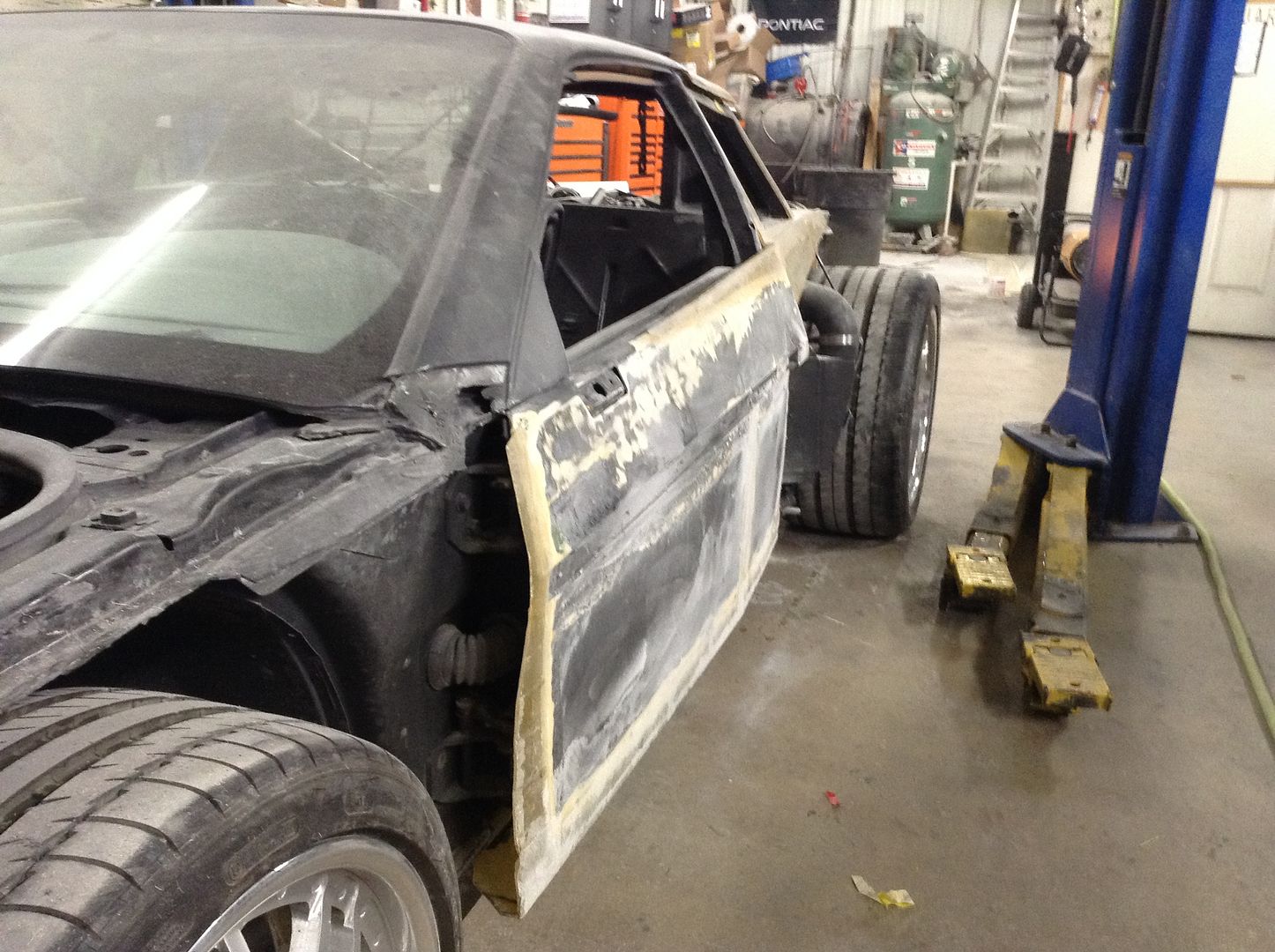

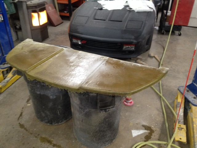

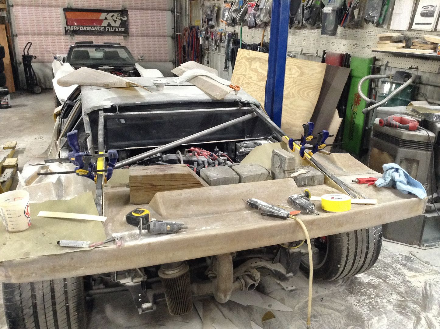

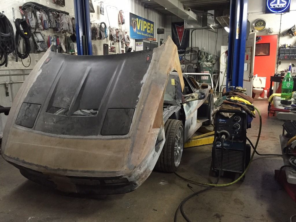

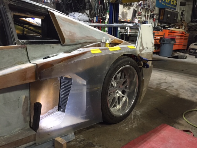

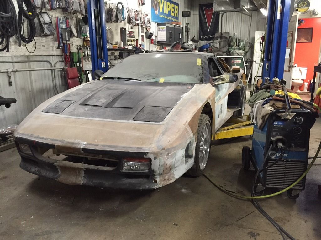

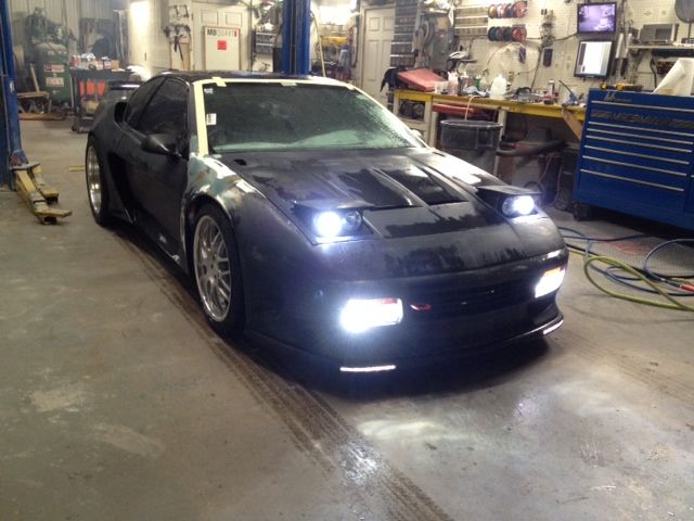

Bozzie (widerisbetter88@aol.com) MSG #55, 03-26-2012 12:40 PM
Door off and ready to glass the inside. Car mostly in primer now and the lines are lookin good

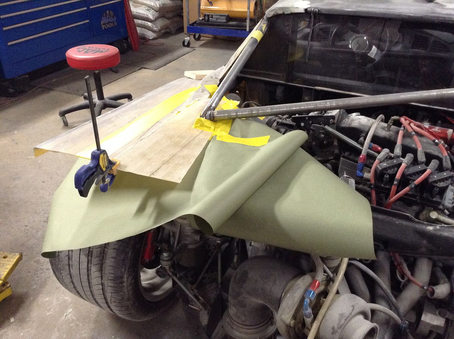

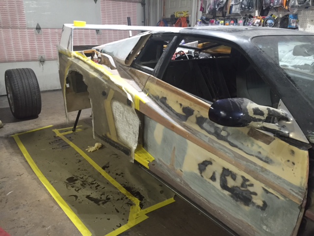

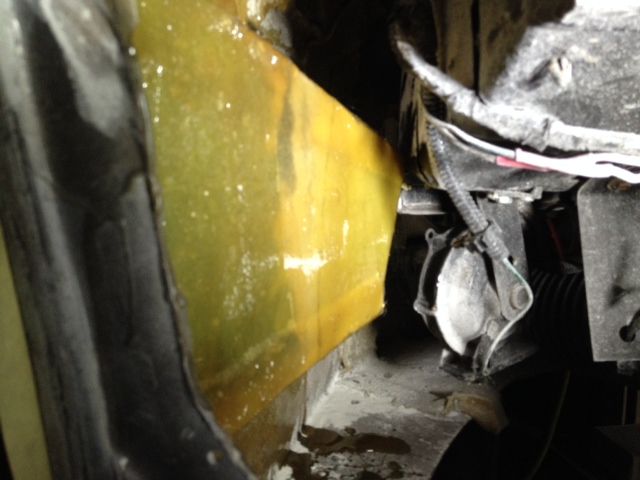

Bozzie (widerisbetter88@aol.com) MSG #56, 03-26-2012 12:41 PM

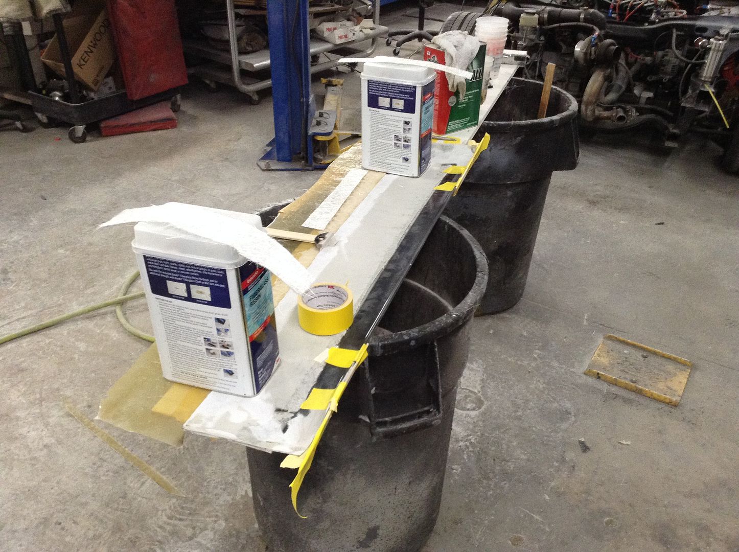

Door gettin a layer of glass on the inside. This seams to be the easy'st part ! Nothin like glassin from the top ! It made such a big difference on the rigity of the door.

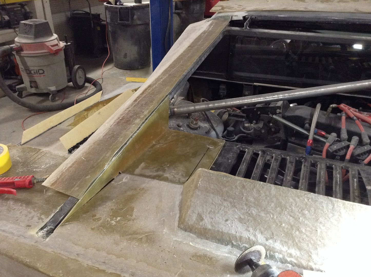

Bozzie (widerisbetter88@aol.com) MSG #57, 03-26-2012 12:43 PM

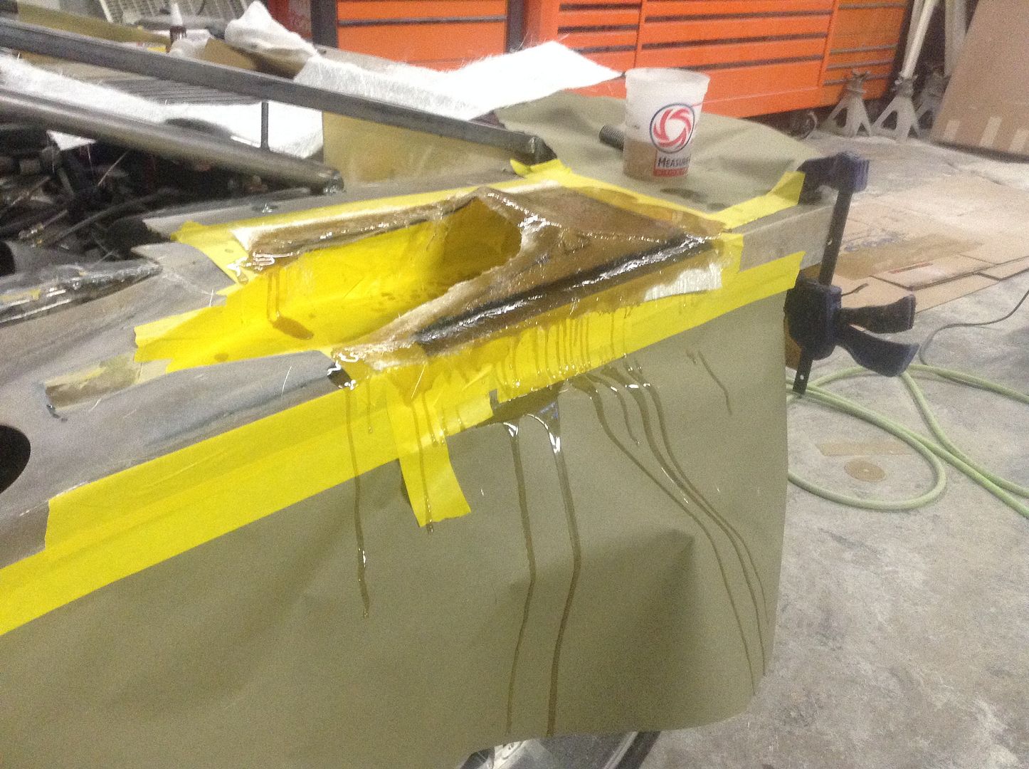

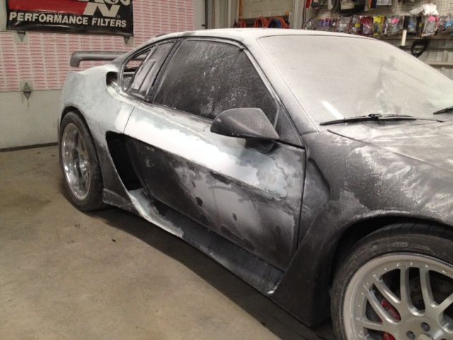

While i had the door off i figured id ad alittle to the door edge. The gaps seam so big around the doors for some reason. Figure 3/16 all the way around would be alittle nicer
Bozzie (widerisbetter88@aol.com) MSG #58, 03-26-2012 12:44 PM
Door back on and the gap looks alot better. Also flushed the door to body gaps and did alittle more filling and sanding.

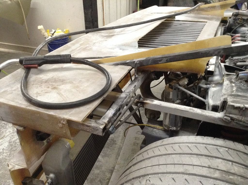

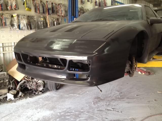

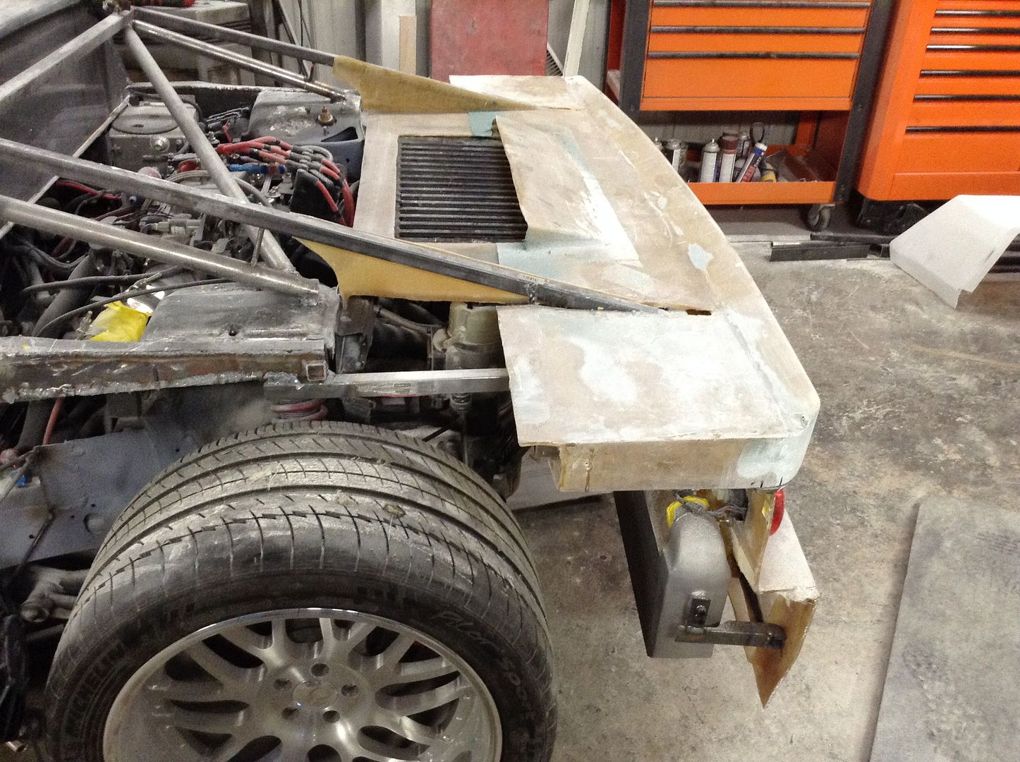

Bozzie (widerisbetter88@aol.com) MSG #59, 03-26-2012 12:47 PM

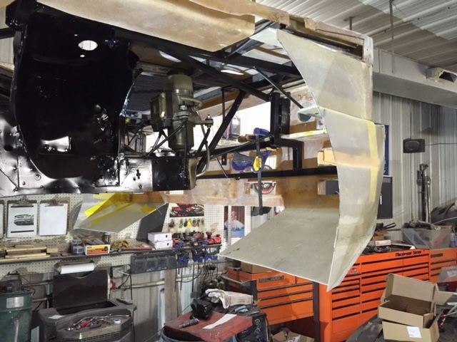

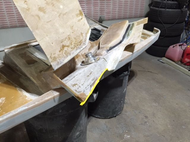

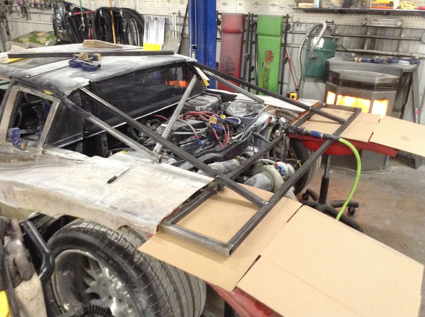

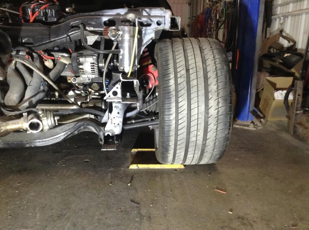

Pulled the nose off in preperation for Amida's 512. Anyday now.....................................
BV MotorSports (sbvincent@yahoo.com) MSG #60, 03-26-2012 04:40 PM

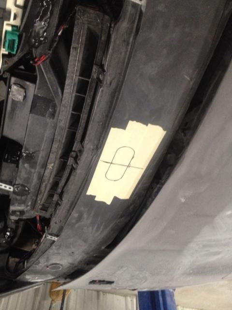

      I like the hood vent. Does it require cutting of the sheet metal (chassis)?
Bozzie (widerisbetter88@aol.com) MSG #61, 03-27-2012 09:51 AM
      BV. Hoods a 03 cobra hood , narrowed a few inches. Where it is is pretty much as far forward as you can go without cutting the "chassis" . I woulda wanted it about a 1" more rearward but didnt want to cut it. It seals real tight. Just have to finish the bottom of it.
2.5 MSG #62, 03-27-2012 12:18 PM
      Wow nice job, nice attention to detail, vision and craftsmanship!
redraif (redraif@yahoo.com) MSG #63, 03-28-2012 10:08 PM
      AMAZING WORK! Totally loving it. Nice attention to detail fixing the gaps!

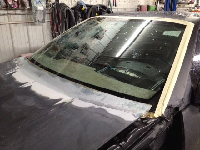

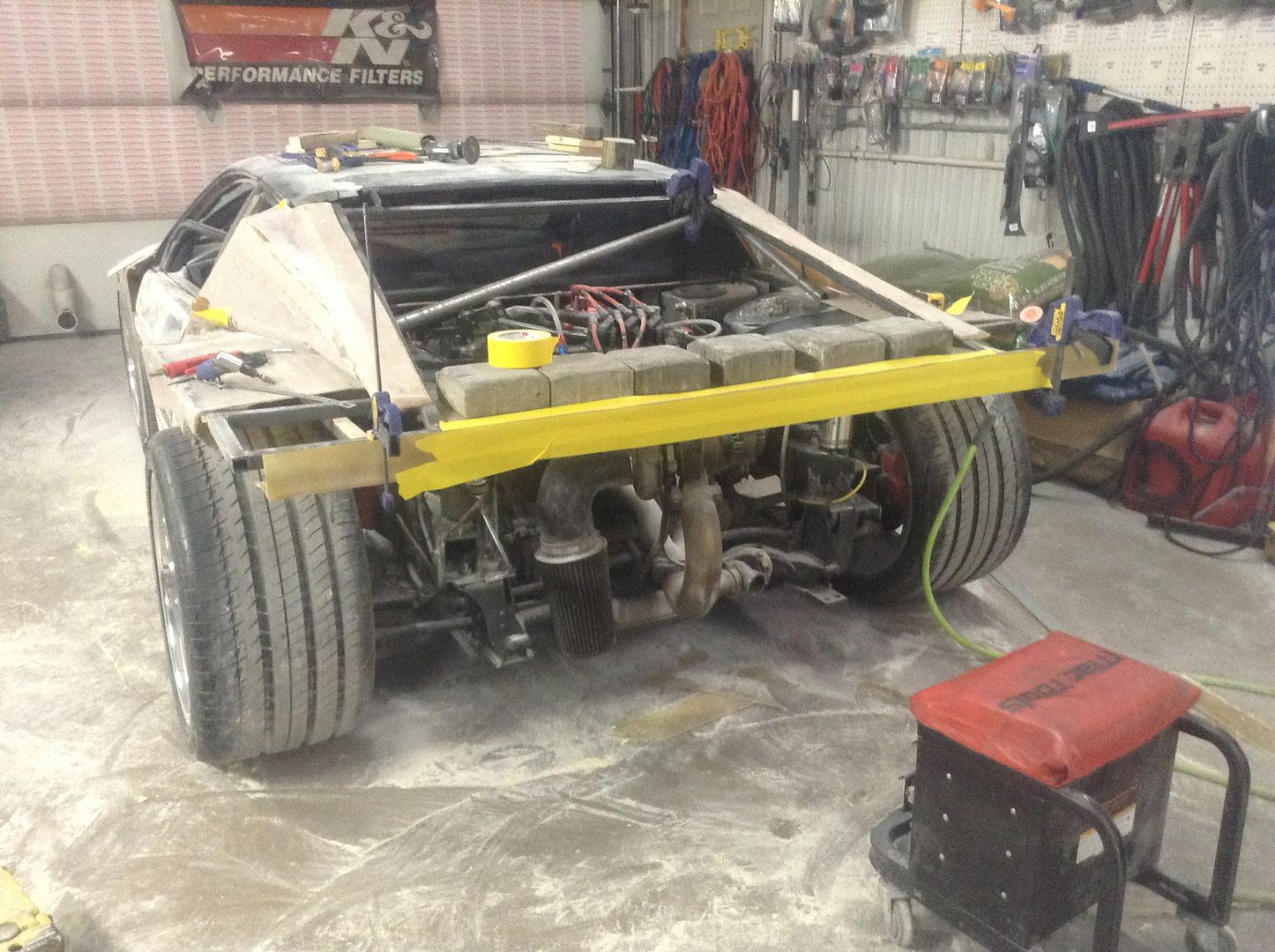

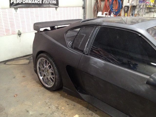

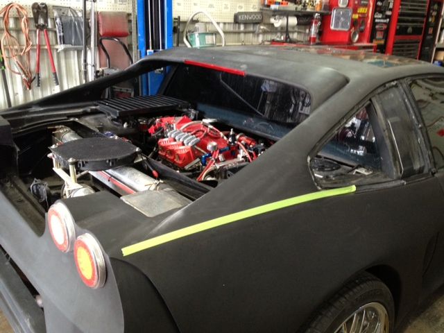

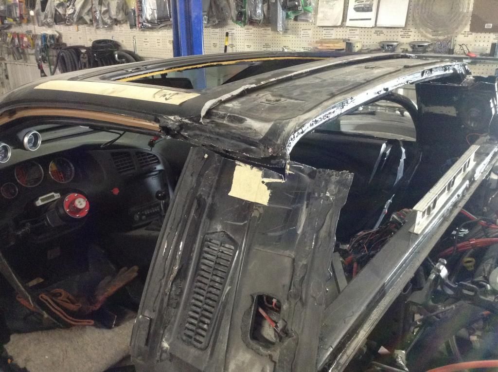

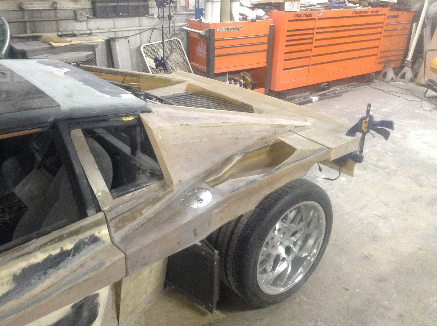

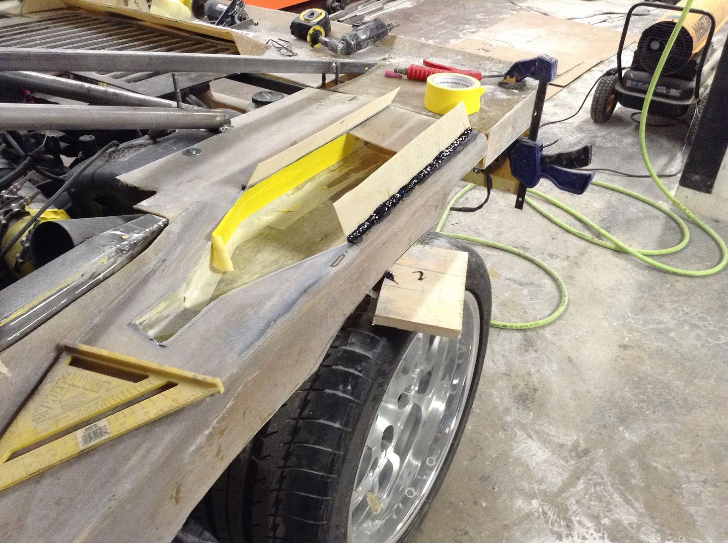

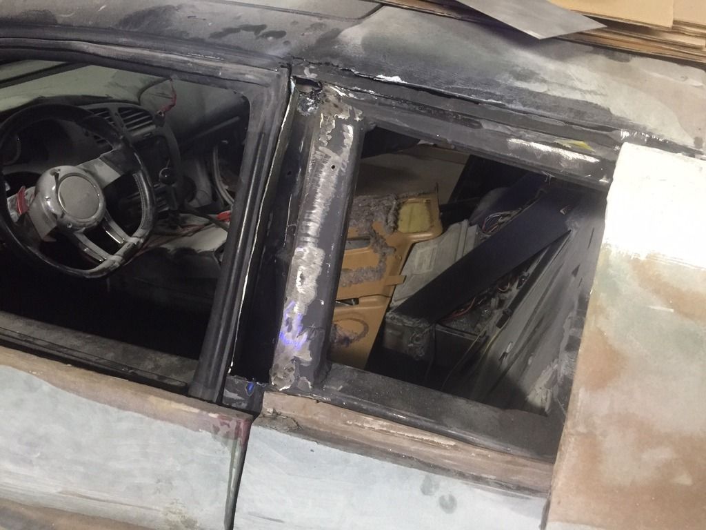

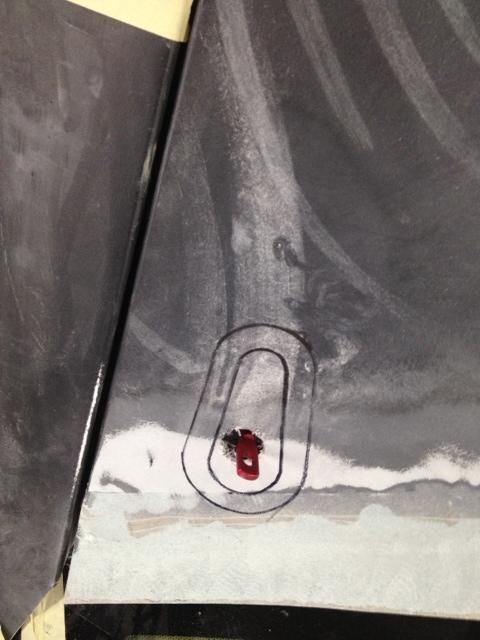

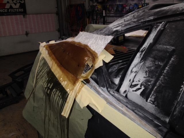

Bozzie (widerisbetter88@aol.com) MSG #64, 03-29-2012 11:25 AM

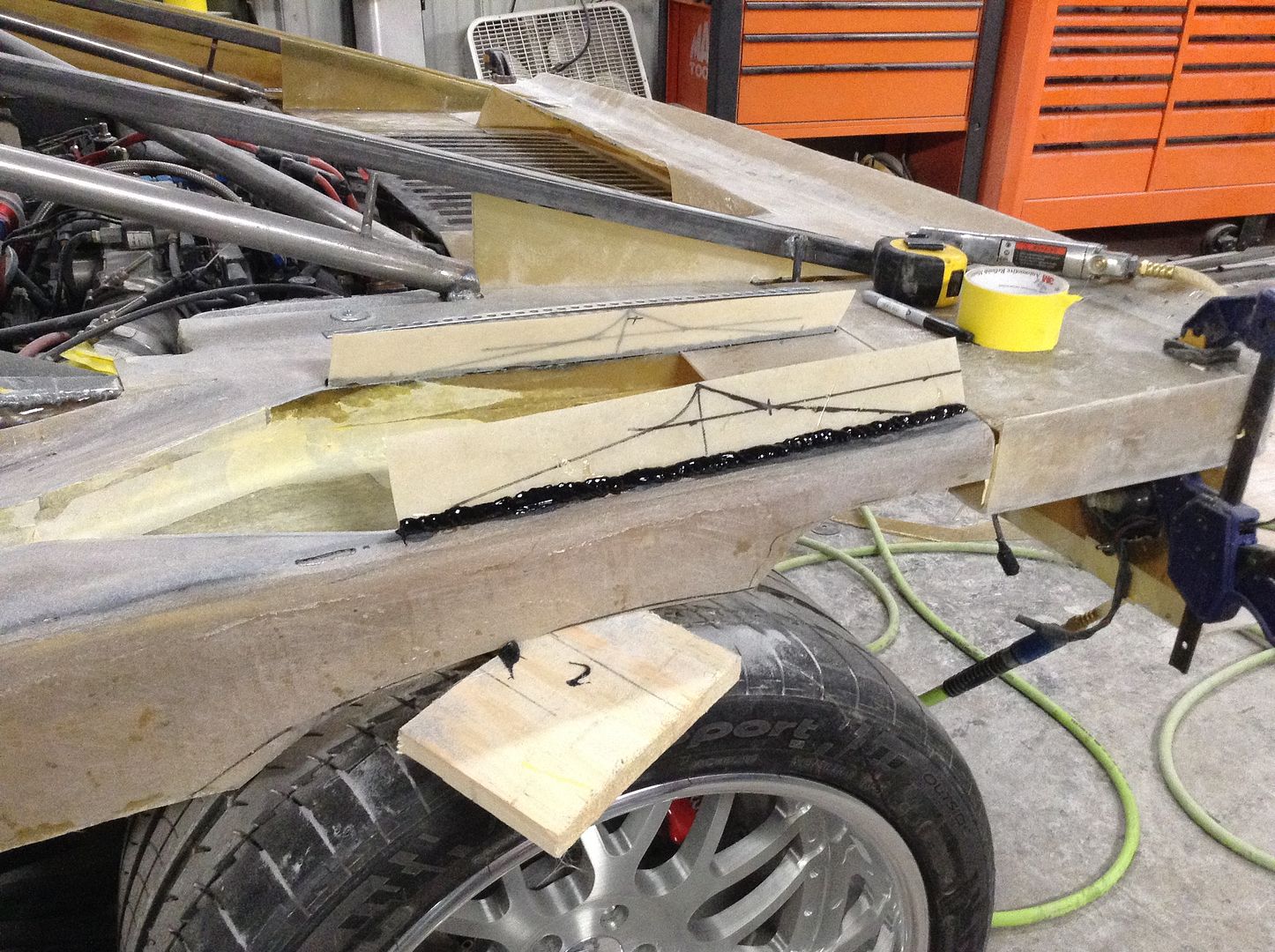

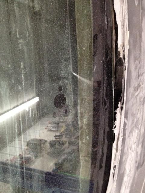

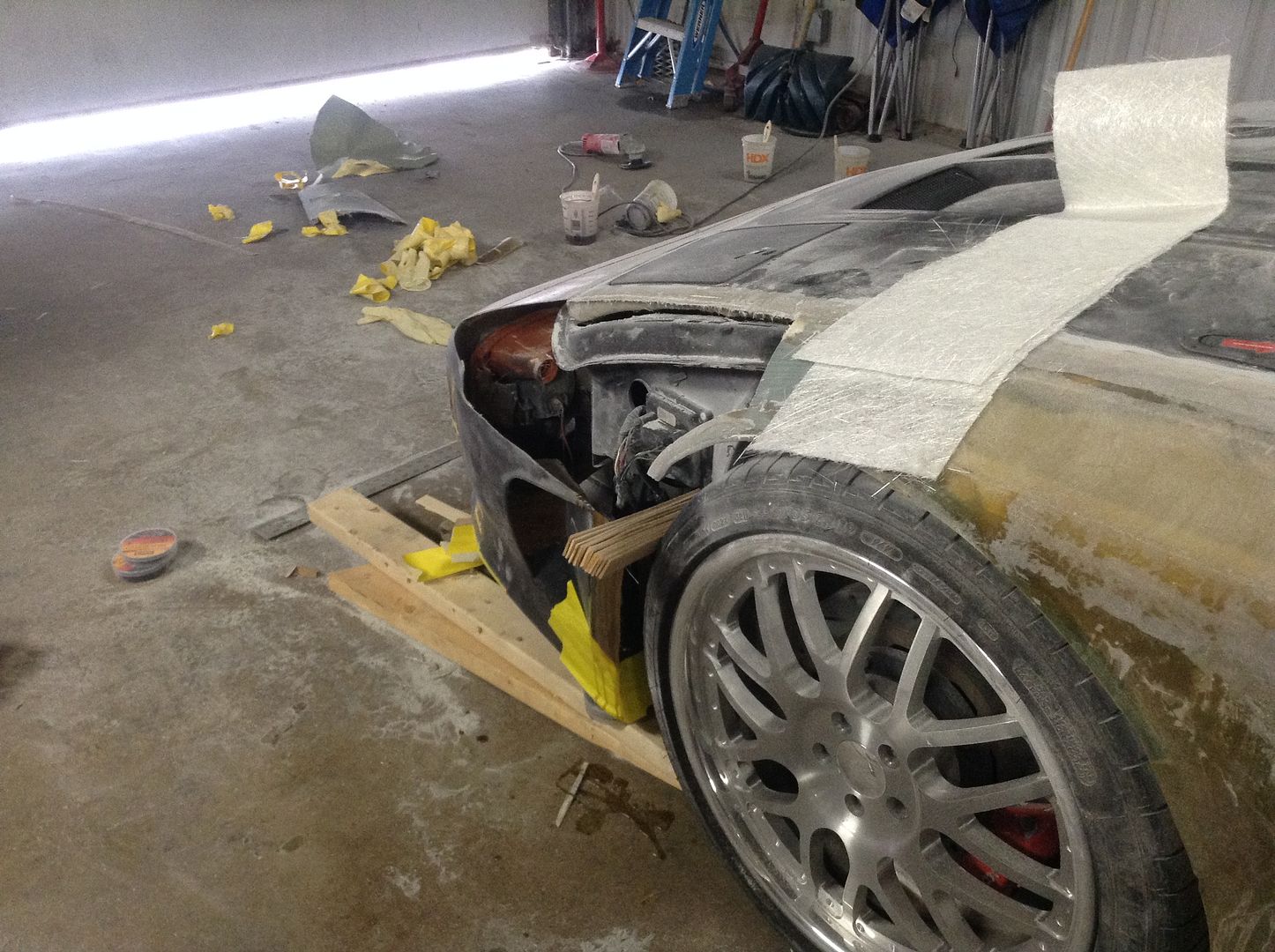

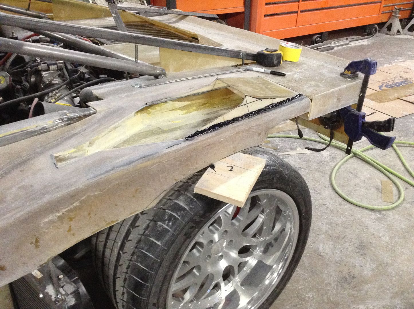

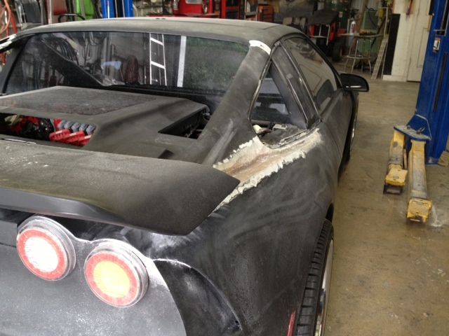

Thanks Red ! Hears another "gap" that i hate to look at ! Ground down and ready to glass
Bozzie (widerisbetter88@aol.com) MSG #65, 03-29-2012 11:27 AM

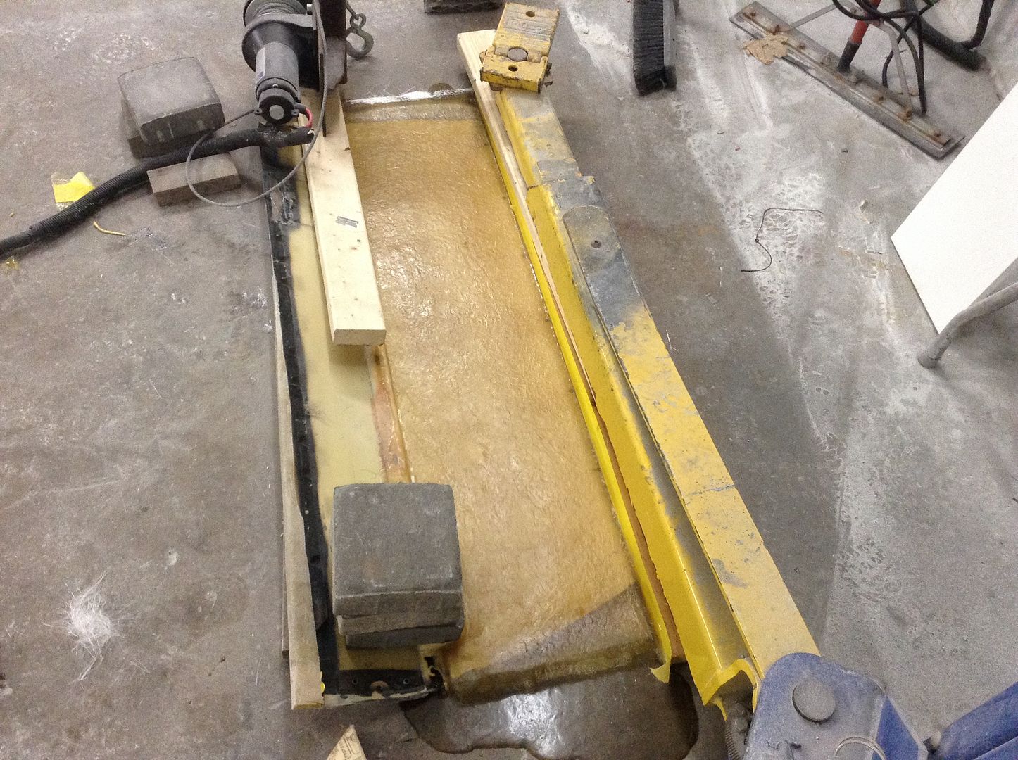

Layer of glass. The roof wasnt totally flat so with the use of the lift arm i applied alittle "love" to a high area. 3 layers of glass later its pretty solid
Bozzie (widerisbetter88@aol.com) MSG #66, 03-29-2012 11:29 AM
Grinding down the high spots. Getting the feel for the new 1 piece look on the roof.
Bozzie (widerisbetter88@aol.com) MSG #67, 03-29-2012 11:30 AM
Ground down and rolled outside for a blow off of all the dust ! Voila !! Ready for a skim coat of filler
2.5 MSG #68, 03-29-2012 12:16 PM
Will that area you held down try to com up later and ruin your work?
Bozzie (widerisbetter88@aol.com) MSG #69, 03-29-2012 01:50 PM
      2.5....... The area was just alittle high....didnt take much to level it out. A deep V groove and alot of glass reinforcement should do it. Im going to let the car settle for a year before paint. Anything changes / pops / moves can be fixed before paint.
Bozzie (widerisbetter88@aol.com) MSG #70, 03-29-2012 02:34 PM
Layer of Filler.
Bozzie (widerisbetter88@aol.com) MSG #71, 03-29-2012 02:35 PM
Sanded down
Bozzie (widerisbetter88@aol.com) MSG #72, 03-29-2012 02:37 PM
Primered. Looks alot smoother without the line there.
Bozzie (widerisbetter88@aol.com) MSG #73, 03-29-2012 02:38 PM
Better shot of the roof.

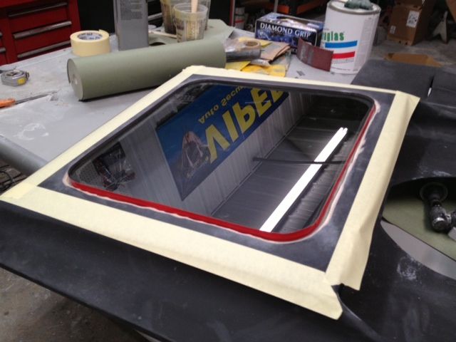

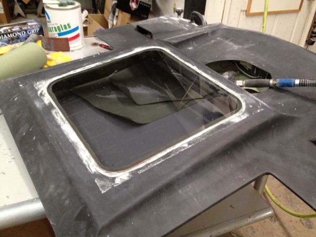

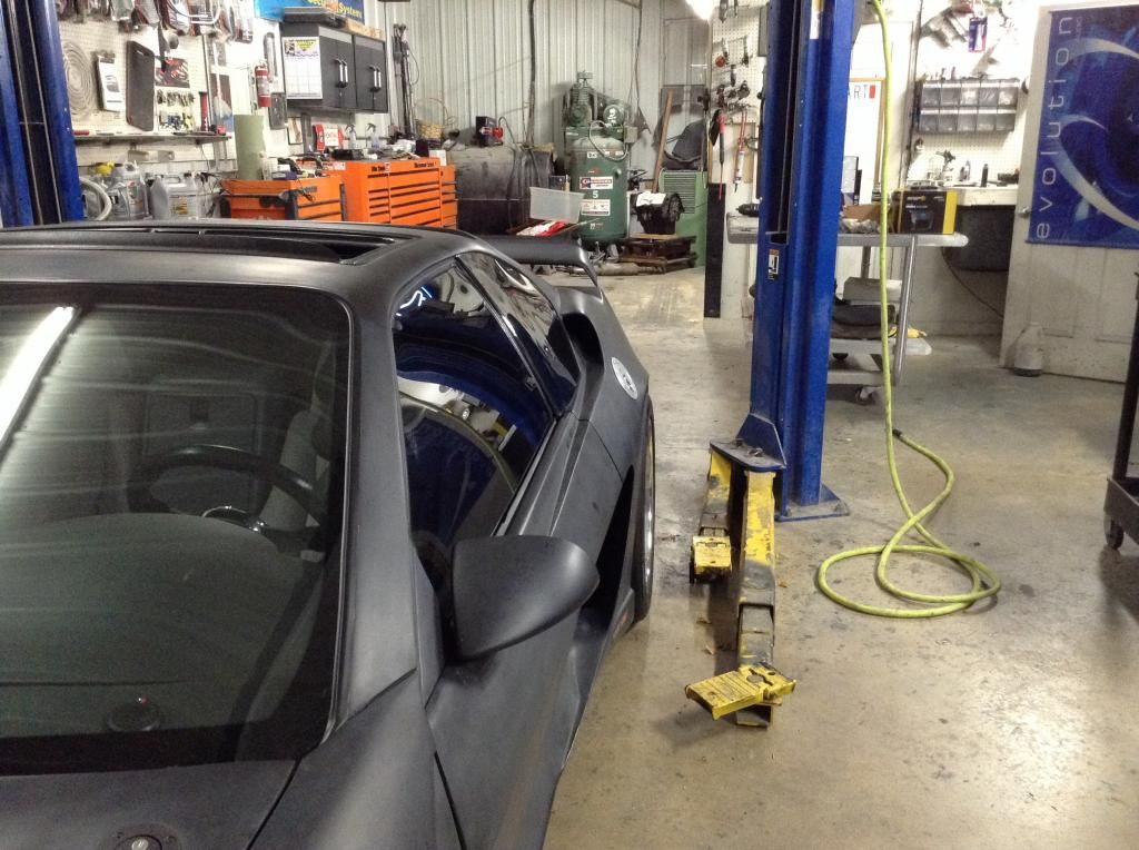

Bozzie (widerisbetter88@aol.com) MSG #80, 04-06-2012 02:26 PM
Working on the door seam.. Pretty much got it where i want it. 3/16 all the way .
Bozzie (widerisbetter88@aol.com) MSG #81, 04-06-2012 02:28 PM
In primer now. Time to get rid of that drip edge !!! Smoother is better !! Thanks for all your input everybody. Seams to be a few widebody builds goin on right now and idea's are flyin !! My 512 nose is in a box and im almost ready to start the front.......drivin me NUTZ !!!
Bozzie (widerisbetter88@aol.com) MSG #82, 04-06-2012 02:30 PM
Bozzie (widerisbetter88@aol.com) MSG #83, 04-06-2012 02:32 PM
Filling in around the Drip edge gap.
Bozzie (widerisbetter88@aol.com) MSG #84, 04-06-2012 02:33 PM

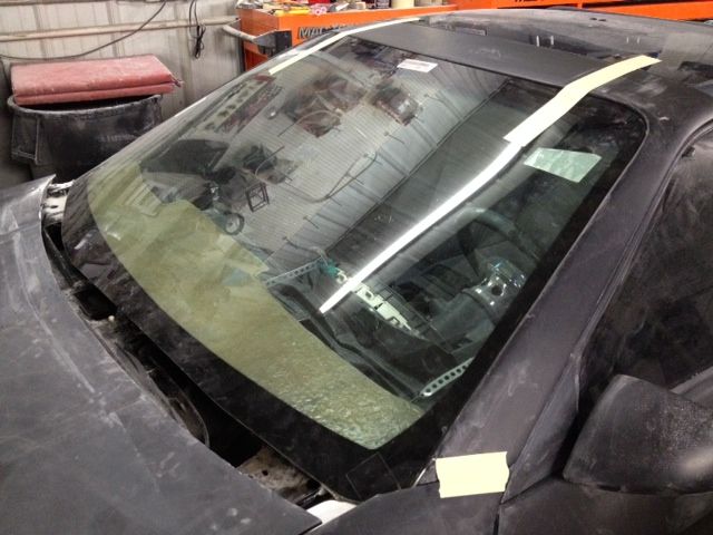

Window in !!!! YEA !!! this side i pretty much DONE !!!

Bozzie (widerisbetter88@aol.com) MSG #86, 04-09-2012 01:34 PM
      85' .....Rear adaptors are 2 1/4". Place in Cali that Archie recommended. They didnt really wana do that size and had 2" in stock but i prefered alittle more...was worth it. Been chowin down hard on the 512 front. Pics to come

exoticse (exoticse@netzero.com) MSG #88, 04-19-2012 03:47 PM

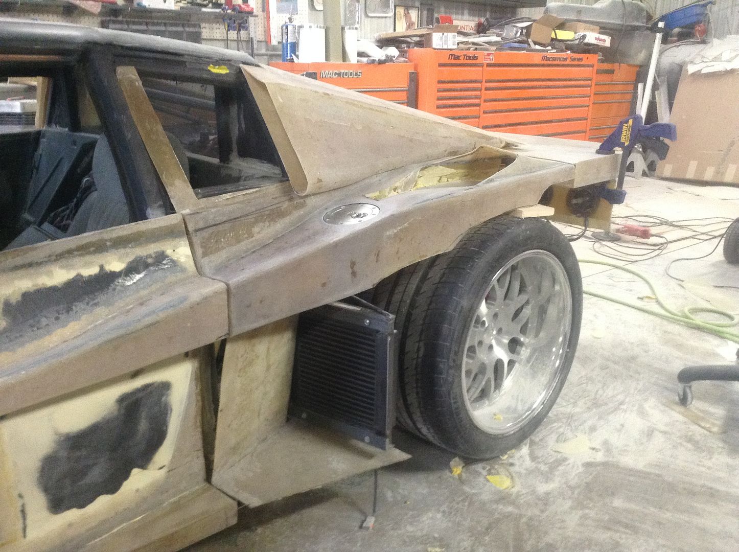

One interesting thing i did notice was that you molded the rockers into the hip addition, making it a one big piece unit instead of two separate pieces.

Box from Amida !!!!
Time to get goin !!

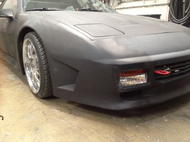

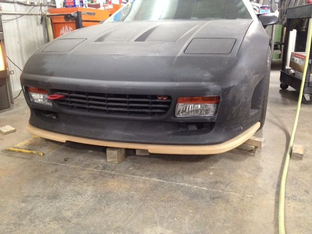

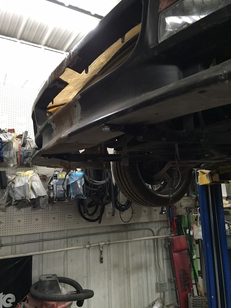

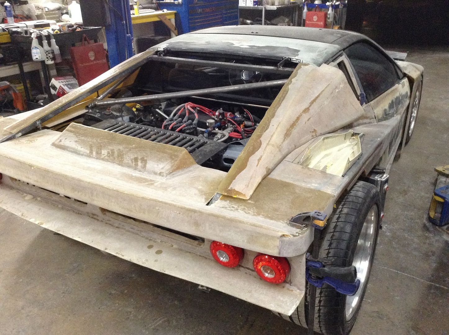

Quick fittment, VERY good fit actually. A nip and a tuck here and there and PRESTO !! With Archies wide fenders i wasnt sure how it would all come together but im liking it !
Bozzie (widerisbetter88@aol.com) MSG #96, 04-27-2012 12:21 PM

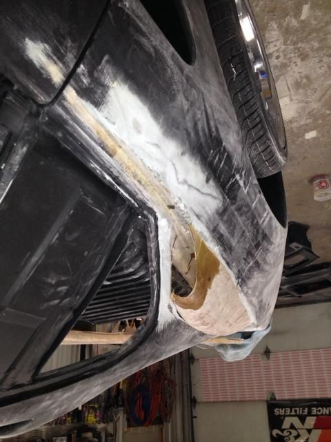

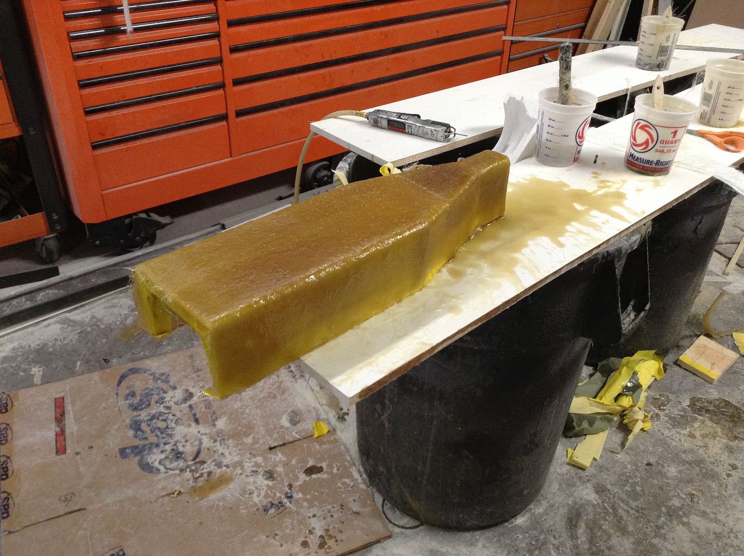

WIth the nose kinda on there i wanted a chin spoiler. Started glassin up the shape.
Glassed a few "squares" to become the wingletts.....
Bozzie (widerisbetter88@aol.com) MSG #97, 04-27-2012 12:23 PM
My "helpers"
Wingletss on and shaped
Bozzie (widerisbetter88@aol.com) MSG #98, 04-27-2012 12:25 PM
Think im gonna have to raise her a bit !!
Outside for a good once over before final glassin
Bozzie (widerisbetter88@aol.com) MSG #99, 04-27-2012 12:26 PM
Time to SMOOTHHHHH it on over
Bozzie (widerisbetter88@aol.com) MSG #100, 04-27-2012 12:28 PM
Fill and sand..................
SOmeones TIRED of waiting for the glass to dry !!!
Bozzie (widerisbetter88@aol.com) MSG #101, 04-27-2012 12:29 PM
Sand and sand and fill....................... GONE !!
Bozzie (widerisbetter88@aol.com) MSG #102, 04-27-2012 12:30 PM
Time for some primer. AHHHHHHHHHHHHHHHHHHHHHHHHH
Attach grill and splitter ...........PResto !
Ayrow (ayrow@ayrow.com) MSG #103, 04-27-2012 12:31 PM
      This thread is absolutely fascinating. Thank you so much for posting your progress. I wish I had the skills, space, and time to do all of what you are doing. It's fun watching it come together.
I'm not a big fan of the little lip and wings that you put under the nose, but the rest of the car is looking beautiful.
Keep up the great work and keep those pictures coming!

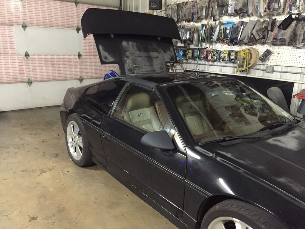

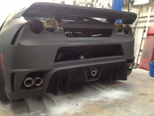

Time to put some love into the rear......there's nothing like a perfect "A$$" and this one's gotta GO !!
Bozzie (widerisbetter88@aol.com) MSG #105, 04-27-2012 12:45 PM
On the ground again. This thing spend more time in the air !!!
Outside with a Fello Fiero'r Man....im jealous.... he's DRIVING his !!! Mine hasnt left the parkin lot in 2years !!!

      Hey Ayrow ! Thanks for your input. It all comes in time. I just dove into this after living my car thru the eyes of other tweekers on here. Cant wait to finally drive this thing but i really enjoy putting the time in on this. Ive had this car for 6yrs and it only has 32k origional miles !!

      Hey Exoticse ! Funny, i was googling chin spoilers and saw this style as well. Simple and makes the point. I showed my girlfriend the pic of your "hips" on your car and she got jealous as i was drooling all over it !! LOL

      Good job on the splitter. You'd better brace the lower lip really well...there will be many contacts with driveways.

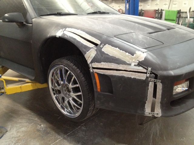

Rick
Bozzie (widerisbetter88@aol.com) MSG #118, 05-17-2012 02:27 PM

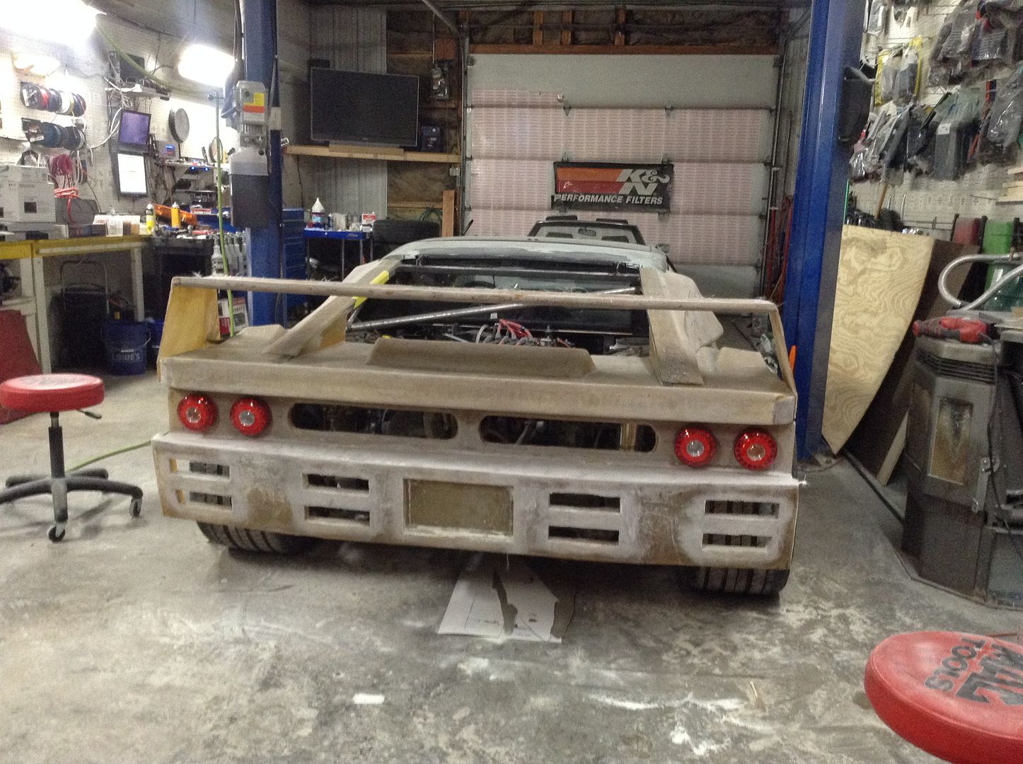

Part one of the Bumper Reconstruction arrives !! This is gonna be a LONG project !
Bozzie (widerisbetter88@aol.com) MSG #119, 05-17-2012 02:29 PM

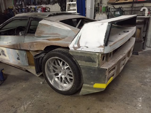

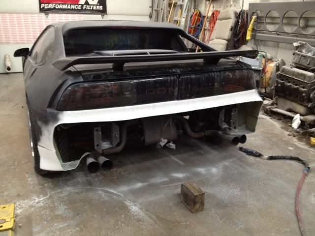

Her it is ! Infinity G35 rear diffuser bumper. Its a far cry from a direct fit. To Tall, to thick, to curved, to short. Definatly not what i thought it was going to be. But its a good start......i think !! LOL
Bozzie (widerisbetter88@aol.com) MSG #120, 05-17-2012 02:31 PM

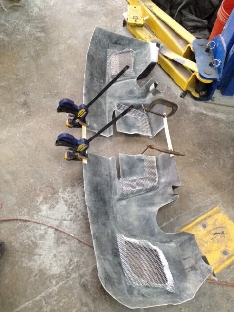

1st step, cutting the Archie widebody bumper somewhat. Alittle here and there, hoping not to cut to much. Its easier to take away than add.
Bozzie (widerisbetter88@aol.com) MSG #121, 05-17-2012 02:33 PM
Then i cut the G35 bumper...this is whats left of it !!! Trial fitting the piece to one side. Its 4 1/4 " to short. WAY to curved !! At this point im thinkin....what did i get myself into !!! Got ALOT of respect for the custom guys here now !!
Bozzie (widerisbetter88@aol.com) MSG #122, 05-17-2012 02:34 PM
Sides not looking to bad. Figured it may just look like something after all !! Boy you really gotta have perception at this point !!
Bozzie (widerisbetter88@aol.com) MSG #123, 05-17-2012 02:36 PM
WIth the correct measurments i set a jig at 4 1/4" apart and started to glass the half's together.
Bozzie (widerisbetter88@aol.com) MSG #124, 05-17-2012 02:38 PM

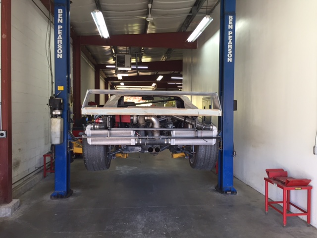

Here it is. Jointed temperorally and test fit for height on the rear. I want it to be low like the Archie side rockers, but not to low !!

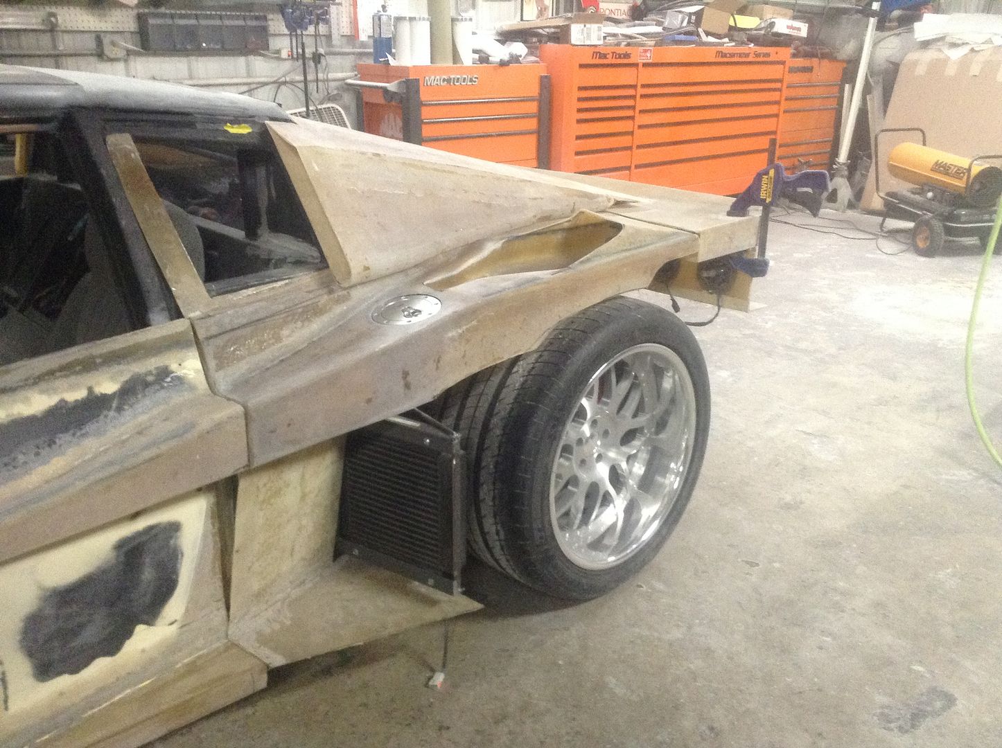

Bozzie (widerisbetter88@aol.com) MSG #125, 05-17-2012 02:39 PM
Another view of the fit
Bozzie (widerisbetter88@aol.com) MSG #126, 05-17-2012 02:41 PM
Bozzie (widerisbetter88@aol.com) MSG #127, 05-17-2012 02:43 PM
With the bumper at the right height i used mold fabric and stapled it to the car and bumper stretched tight to form the top. This will be glassed.
Bozzie (widerisbetter88@aol.com) MSG #128, 05-17-2012 02:44 PM
Bozzie (widerisbetter88@aol.com) MSG #129, 05-17-2012 02:45 PM
Glassed. Pretty rigid. Trying to get the idea of the shape here. Not so sure but its something to work with.
Bozzie (widerisbetter88@aol.com) MSG #130, 05-17-2012 02:46 PM
The sanding and shaping begins !! Now trying to make this thing straight !! LOL
Bozzie (widerisbetter88@aol.com) MSG #131, 05-17-2012 02:48 PM
Now for glassing in the sides. Round for now tapering into the back.
MORE sanding !!!
Bozzie (widerisbetter88@aol.com) MSG #132, 05-17-2012 02:50 PM
Shaping again. Kinda happy with it so far. Thinking about the exhaust exits at this point. Rear mounted turbo in the works later so nows the time to think about it. There are dual cutouts on the bottom but im not feeling it. Think i spend just as much time eying this and thinking as glassing and sanding !!

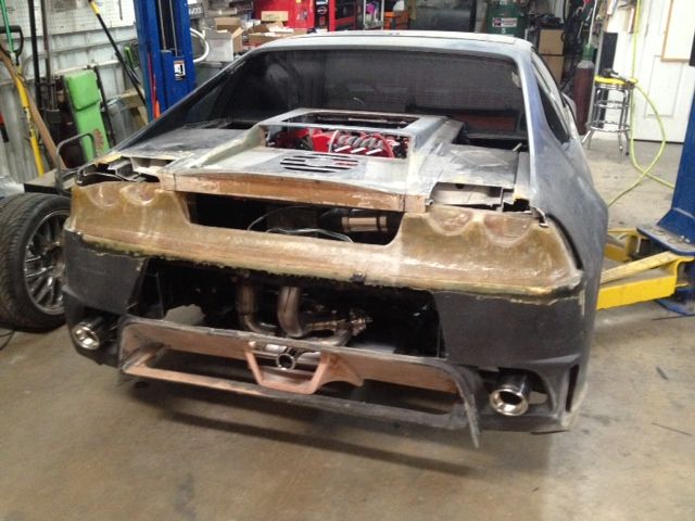

Bozzie (widerisbetter88@aol.com) MSG #133, 05-17-2012 02:52 PM

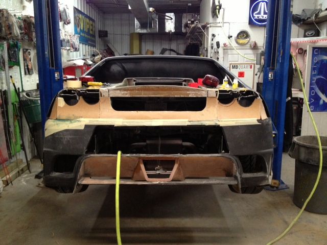

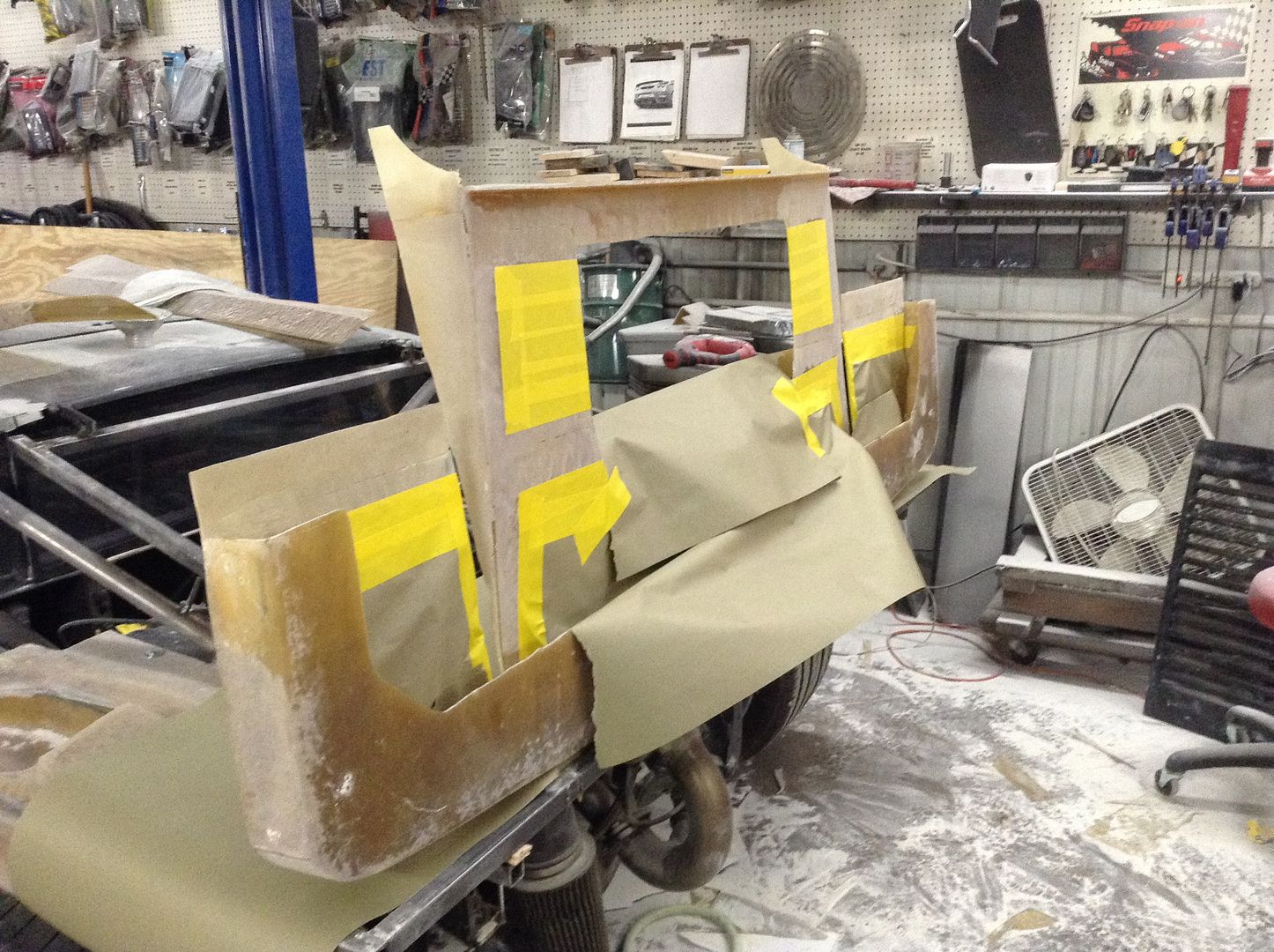

The side pieces from the bumper that i cut off initially i trimmed to fit on the sides again. I made a jig with a 4x4 and upright to position the panel where i wanted it and so i could just flip the jig and replicate it on the other side.

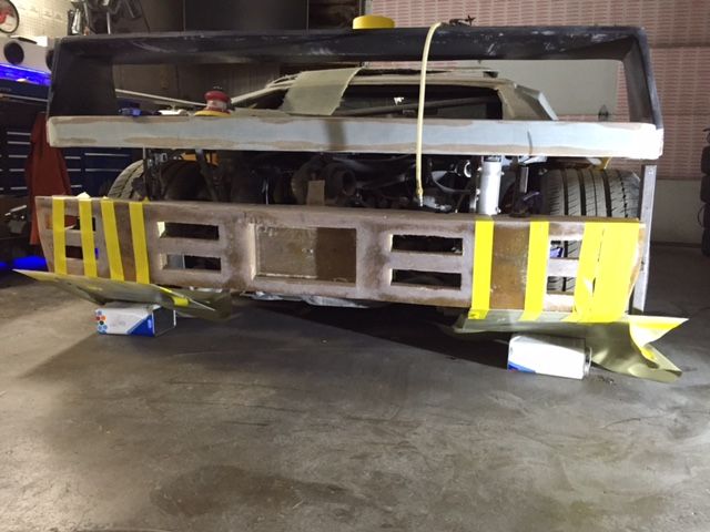

Bozzie (widerisbetter88@aol.com) MSG #134, 05-17-2012 02:57 PM
My thoughts are on the F 430 rear. Lots of pictures in front of me and im thinking of doing some more trimming
Cut a opening in. Im going to make a pocket here, maybe for the plate, and possible exhaust exit. Started filling in.
Bozzie (widerisbetter88@aol.com) MSG #135, 05-17-2012 02:59 PM
Taking shape, i just cant even think of adding up the hours , days and weeks picking away at this till all hours of the night. Its getting alittle fustrating and im alittle tired of it. Sometimes stepping away for awhile just to come back again hard !!!
Bozzie (widerisbetter88@aol.com) MSG #136, 05-17-2012 03:01 PM
Made a pocket out of fiberglass. Mounted the plate into it. This was a BIG job. !!
Bozzie (widerisbetter88@aol.com) MSG #137, 05-17-2012 03:04 PM
Upon looking at the center lower section....i decided i didnt like it and it wasnt really going to work for what i wanted. SO........ZIP !! out it comes !! ALOT smoother i think. But added probably weeks to no building my own diffuser !! OOPS !!!
Made a back panel for the diffuser
Bozzie (widerisbetter88@aol.com) MSG #138, 05-17-2012 03:06 PM
Framing and getting the location of the center part of the diffuser, not sure if the exhaust will exit here or on each side of the plate yet. Now about 4 week into this bumper.

Bozzie (widerisbetter88@aol.com) MSG #146, 05-29-2012 12:12 PM
Fresh outside summer pic

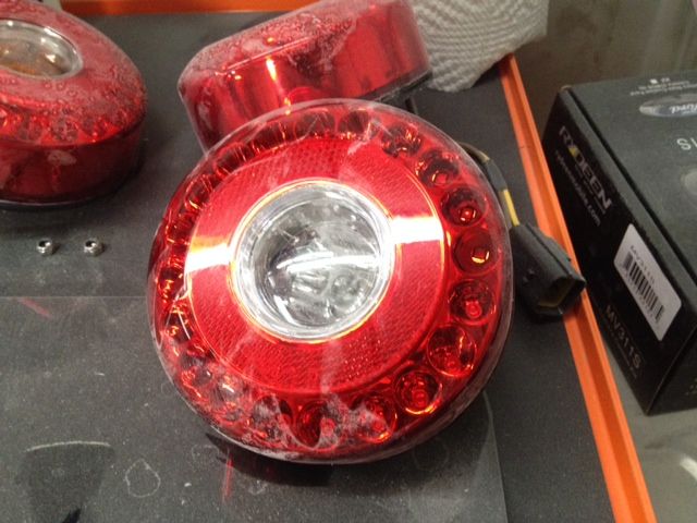

Cooper lights installed
Rear is coming along...SLOW but sure !!

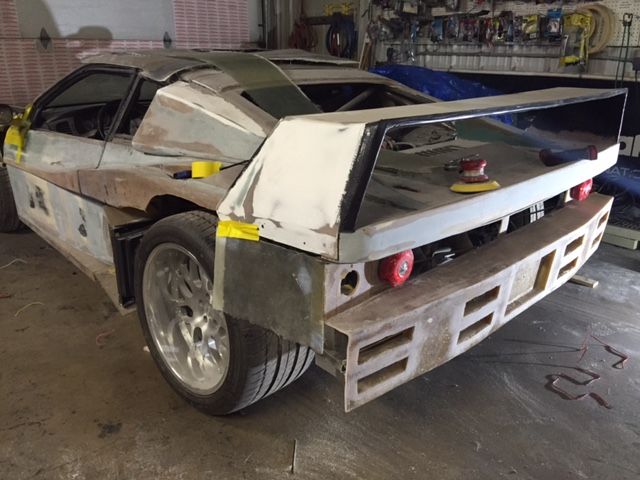

85LAMB (linck777@netzero.com) MSG #147, 05-29-2012 07:55 PM
      Wow !!!
That is a LOT of work...
a couple of questions:
How big are the rear tires ? they look nice
How come you decided to go with out a rear reinforcement bar ?
Why did you fiberglass the bumpers to the body ?
the reason I ask, is because I deal w/ auto accidents,
I would be afraid that if anything even minor happen,
It would be a lot more work to repair, specially on the rear w/out a reinforcement bar.
exoticse (exoticse@netzero.com) MSG #148, 05-29-2012 10:12 PM
It would be a lot more work to repair.
I thought the exact same thing when i saw that, granted it does look pretty good that way, but man even a minor mishap and you are in for some serious rework.
Bozzie (widerisbetter88@aol.com) MSG #149, 05-31-2012 09:54 AM
      The Rear tires are 255 35 18's on 9" wide wheels. I decided to bond all the seams together for a smooth look. I knew if something ever happened it might be alittle more work because of this but i think the body will spend more time in one piece than in a accident. If a accident happens then i'll deal with it. I built this car from the inside out so i know how to put it back together. Manufacutures make it easier for body guys for insuranse purposes but this is a one off car, not mass produced, by me anyway !! LOL. Im building this for me, not for anyone else and i'll spend the extra few hours on it if there is a bender to put it back rather than have hidious body lines everywhere. Course.....thats my opinion

Bozzie (widerisbetter88@aol.com) MSG #163, 02-02-2013 01:15 AM
      back to work here abit. Decieded to lower the rear trunk lid center abit....1st step was the cut and shape
Bozzie (widerisbetter88@aol.com) MSG #164, 02-02-2013 01:17 AM
      ruff look as of now
Bozzie (widerisbetter88@aol.com) MSG #165, 02-02-2013 01:27 AM
      I had made some strips from fiberglass and cut to shape for glassing in .....here i check for fit before gettin dirty
Bozzie (widerisbetter88@aol.com) MSG #166, 02-02-2013 01:31 AM
      fitting...
Bozzie (widerisbetter88@aol.com) MSG #167, 02-02-2013 01:35 AM
      grinded down and ready for glass
exoticse (exoticse@netzero.com) MSG #168, 02-02-2013 03:24 AM
Sweeeet !
Similar to the rottinchop car, but very, very nice.
Bozzie you are knocking it out of the park on this one, Keep it going !

Bozzie (widerisbetter88@aol.com) MSG #171, 04-20-2013 09:46 PM
      Rear Pic as of now. Lowered vent hatch and working on the engine conversion now.....pics to come !
Bozzie (widerisbetter88@aol.com) MSG #172, 04-20-2013 09:48 PM

ok....gettin tired of glassing so i took a break and decided to drop the tank...........
Bozzie (widerisbetter88@aol.com) MSG #189, 04-22-2013 04:32 PM
one of the best parts of this car is the shape its in. 31K miles never in snow....this just made it to easy to take apart. dropped in a walbro 255 and put er/ back together
Bozzie (widerisbetter88@aol.com) MSG #190, 04-22-2013 04:35 PM
back to glassing. Where the front "mini" style light was mounted i decided to incorporate it into a vent.....so cuttin away
Bozzie (widerisbetter88@aol.com) MSG #191, 04-22-2013 04:37 PM

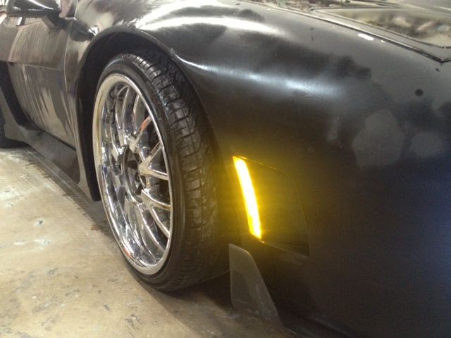

now on the drivers side i didnt like on the passenger side how the top of the vent was square so i made it rounded on top and i think it flows much better.......then i moved to the passenger side and added glass to it to create the same "curve"
Bozzie (widerisbetter88@aol.com) MSG #192, 04-22-2013 04:41 PM
Finished vent. The marker light actually "bends" into the vent. I think its a pretty neet look

I was really excited to finally put in the lights into the 512 bumper. What you dont see is the 9 hrs it took to get the fit right. Dont get me wrong, this is a great bumper. But the gaps around the lights i wasnt happy with and its much easier to fix them now. So walla !!
Bozzie (widerisbetter88@aol.com) MSG #194, 04-22-2013 04:47 PM

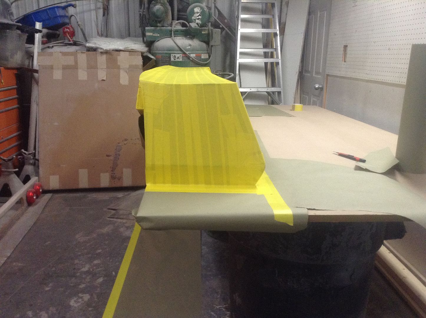

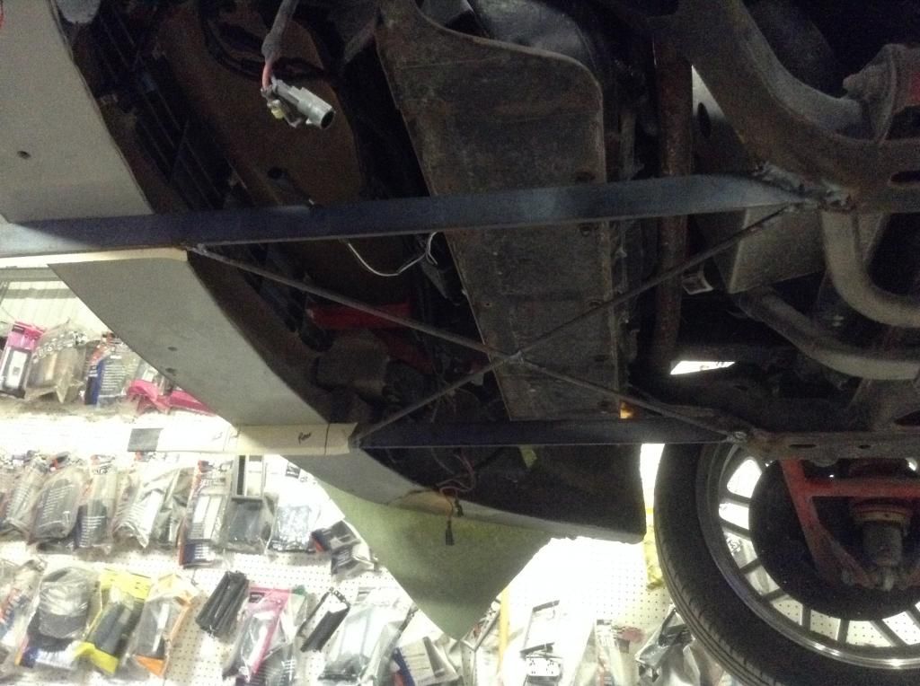

ok...back to the rear again...now that i got some sanity back ! I wanted the valance to be curved so i got some 12" sonic tube and cut it to size. It creates a concave fit to the lower spoiler. I then glued wood to the inside to create depth to the mold....lots of tape, cutting and glueing to get it somewhat to shape.
Bozzie (widerisbetter88@aol.com) MSG #195, 04-22-2013 04:50 PM
More sonic tube cut to length and height taped to the car to make the shape..............
Bozzie (widerisbetter88@aol.com) MSG #196, 04-22-2013 04:53 PM
More taping and cutting and the shape moving along
Bozzie (widerisbetter88@aol.com) MSG #197, 04-22-2013 04:56 PM
gluing in the sides .........
Bozzie (widerisbetter88@aol.com) MSG #198, 04-22-2013 05:00 PM
complete....well as much as its gonna get !
Bozzie (widerisbetter88@aol.com) MSG #199, 04-22-2013 05:02 PM
Now that its got the shape i pulled it off the car. Now to make something out of this mold
Bozzie (widerisbetter88@aol.com) MSG #200, 04-22-2013 05:09 PM
after pulling it out of the mold i glassed it to the car.....you'll also notice i cut the rear deck behind the light sockets. This will be glassed to the light pockets and the hatch will be seamed there.
Bozzie (widerisbetter88@aol.com) MSG #201, 04-22-2013 05:13 PM

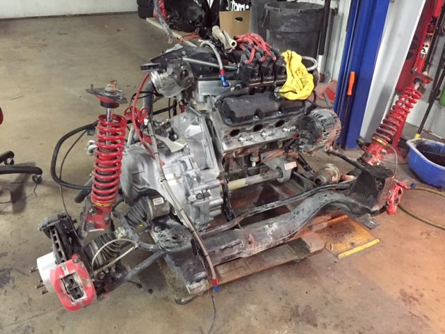

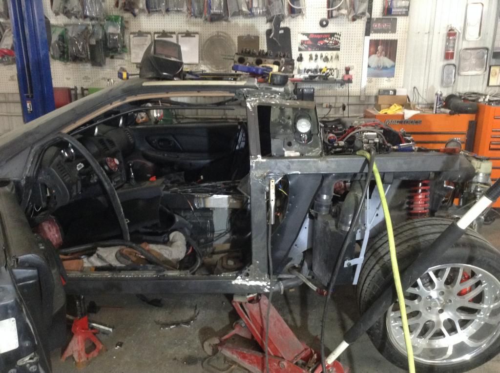

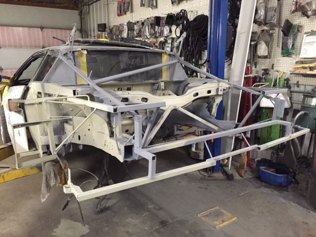

Ok....spring is here and here is my labor of love. 3.8 crate engine. ZZP stage 3 turbo cam, ZZP aluminum heads, Stattama intake, Billet throttle body, ZZP long tube SS headers..sent out and jethot coated.....etc.......Tranny is a G6 6speed, Quaife differential thats been cyro'd. Archied 6sp install kit, aluminum flywheel and stage 3 clutch. Turbo is a Garret Gt35r liquid cooled BB.......Getting this to fit and work is another story. Harness Made by TImm and computer programed by Ryan at Sinister............
Bozzie (widerisbetter88@aol.com) MSG #202, 04-22-2013 05:15 PM

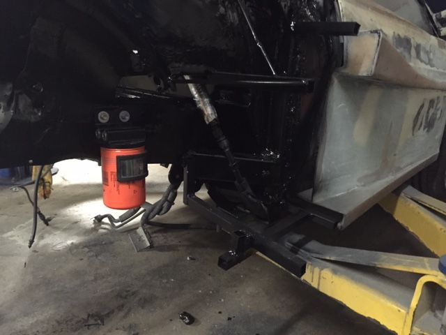

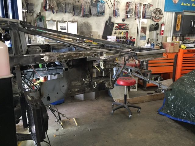

Ok...gonna skip all the engine removal fun stuff....this is my cradle....it was in good shape so i just cleaned it up and gave it a few coats of epoxy paint.....any yes Exoticse....this is why i cant make it to daytona !!

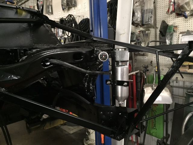

      http://i252.photobucket.com...ozziec/watertank.jpg
Custom made "daddys" water tank just came in...........
Bozzie (widerisbetter88@aol.com) MSG #206, 05-08-2013 10:02 AM
      <a href="http://s252.photobucket.com/user/bozziec/media/watertank.jpg.html" target="_blank"><img src="http://i252.photobucket.com/albums/hh14/bozziec/watertank.jpg" border="0" alt=" photo watertank.jpg"/></a>
Bozzie (widerisbetter88@aol.com) MSG #207, 05-08-2013 10:03 AM

      Ok...build is moving along real nice , decided to work on the gas cap. So i just got a custom made one in and hear it is !
<a href="http://s252.photobucket.com/user/bozziec/media/gc2.jpg.html" target="_blank"><img src="http://i252.photobucket.com/albums/hh14/bozziec/gc2.jpg" border="0" alt=" photo gc2.jpg"/></a>
Bozzie (widerisbetter88@aol.com) MSG #211, 06-13-2013 06:00 PM
Bozzie (widerisbetter88@aol.com) MSG #212, 06-13-2013 06:02 PM
      I tood a piece of 3/16 aluminum and made a trim ring to sandwich the fuel block in place .........heres the end result
Bozzie (widerisbetter88@aol.com) MSG #213, 06-13-2013 06:04 PM
      when you remove the cap this is what the fill looks like

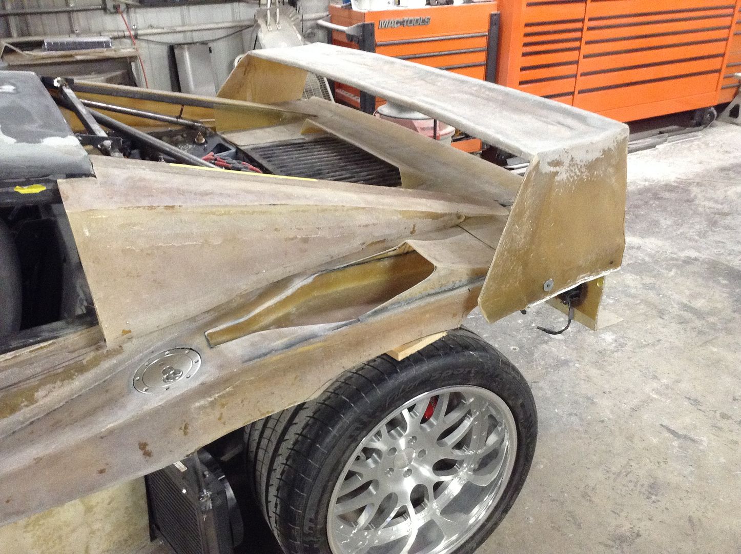

      moving on to the wing. Needs some upfit. Decided to drop the sides by 1" .....hears a piece of fiberglass i made and bonded to the underside for shaping....
Bozzie (widerisbetter88@aol.com) MSG #215, 06-13-2013 06:28 PM
      Another shot of the extensions. You will notice the stands sit on 3/4 in blocks....hense the addition later
Bozzie (widerisbetter88@aol.com) MSG #216, 06-13-2013 06:30 PM
      Filling and sanding to take shape...........
Bozzie (widerisbetter88@aol.com) MSG #217, 06-13-2013 06:31 PM
      Rear shot
Bozzie (widerisbetter88@aol.com) MSG #218, 06-13-2013 06:34 PM
      Wingstand time......screwed in 1/4 20 threaded rods in
Bozzie (widerisbetter88@aol.com) MSG #219, 06-13-2013 06:39 PM
      Mounted 1" foam blocks to it with adheisve and shaped it. Sanded the stands ready for glassing
Bozzie (widerisbetter88@aol.com) MSG #220, 06-13-2013 06:42 PM
      Glassed
Bozzie (widerisbetter88@aol.com) MSG #221, 06-13-2013 06:44 PM
      Upon looking at the stands i thought they needed to be more raked so i cut a template out of a paint stick and glassed it on
Bozzie (widerisbetter88@aol.com) MSG #222, 06-13-2013 06:46 PM
      Glassed and 1st layer of filler to shape
Bozzie (widerisbetter88@aol.com) MSG #223, 06-13-2013 06:47 PM
      2nd coat of filler and sanding
Bozzie (widerisbetter88@aol.com) MSG #224, 06-13-2013 06:50 PM
      Shaped / primered and fitted......you can also notice the lip spoiler i bonded and shaped to the top of the wing for added presence......

      Thanks Amida....thats def. a compliment ! Moving onto the rear hatch engine window. I startet with a Piece of Safety glass tinted already. It was cut with aprox. size and radius to within a 1/2 inch of my precut opening.
Bozzie (widerisbetter88@aol.com) MSG #227, 06-19-2013 07:32 PM
      I laid the glass in after i protected it with masking tape on the edges. Its a good fit. I spaced it out to acount for the spacing on the glass, glue and mounting tab. Hear it is ready to glass in the mounting flange.
Bozzie (widerisbetter88@aol.com) MSG #228, 06-19-2013 07:34 PM
      Here it is with a 3" wide glass flange. Its plenty strong and thick with 3 layers of fiber. Then i just popped it out.
Bozzie (widerisbetter88@aol.com) MSG #229, 06-19-2013 07:37 PM
      After the glass is removed this is the opening for it with the new mounting flange. A ruff opening.
Then i trimmed it to 1/2 " all the way around.
Bozzie (widerisbetter88@aol.com) MSG #230, 06-19-2013 07:40 PM
      I then placed the glass in with a 1/16 tape wrapped around it to provide a nice fit without being to tight.
A layer of filler is applied.....sanded and reapplied and sanded
Bozzie (widerisbetter88@aol.com) MSG #231, 06-19-2013 07:43 PM
      After sanding and checking for the fit i put it down in primer
This idea i got from Skitime's Build. What a great idea and thank you for the incentive !

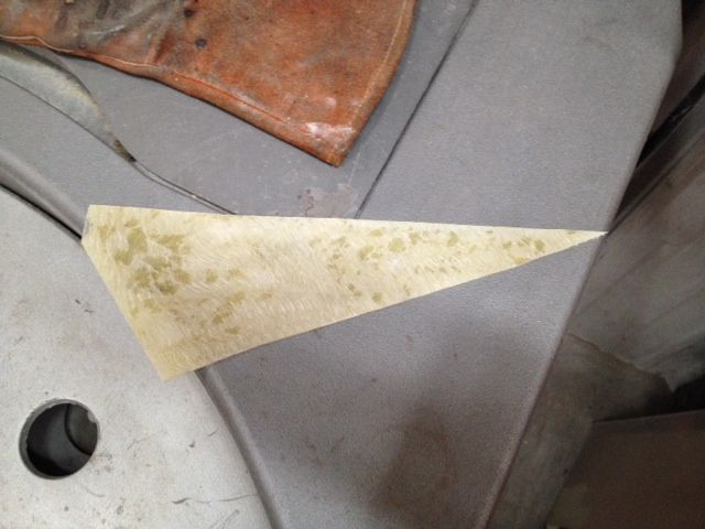

      Diffuser time. I made "ribs" from 1/4" plexi. Cut a slot into the diffuser and bonded it in. Smoothing it out with 1/2 rounds.......
Bozzie (widerisbetter88@aol.com) MSG #233, 07-08-2013 04:22 PM
      Another view
Bozzie (widerisbetter88@aol.com) MSG #234, 07-08-2013 04:25 PM
      Sanded and Primed. More work to do on, going to add a stabilizer across the middle and secure with turnbuckles later. Also didnt like the single exhaust tips so i swapped in the C6 corvette tips .
RCR (rcrabine@comcast.net) MSG #235, 07-08-2013 08:23 PM
      Wow!!
Bob
exoticse (exoticse@netzero.com) MSG #236, 07-08-2013 08:29 PM
Originally posted by RCR:
Wow!!
Bob
Double WOW !!
You nailed it Bozzie !
dajack761 (dajack761@gmail.com) MSG #237, 07-08-2013 09:45 PM
      That diffuser looks great. Well done!

Bozzie (widerisbetter88@aol.com) MSG #241, 07-31-2013 01:15 PM
      Working on getting the tail lights straight. What i had done was just a close mock of what it was supposed to be but now its time to get them straight and true. First i routered out 2 templates out of wood for the shape i wanted and screwed them to the back.
You can see by the spacing that i need to fill with glass and sand a bunch !
Bozzie (widerisbetter88@aol.com) MSG #242, 07-31-2013 01:21 PM
      Its definatly alittle off !! Dang my eyesight !
Taped off you can clearly see what needs to be done. Going to glass in the inside and fill in the outside and make some smooth curves
Bozzie (widerisbetter88@aol.com) MSG #243, 07-31-2013 01:23 PM
      Messy job. Glassed and filled...real ruff
Bozzie (widerisbetter88@aol.com) MSG #244, 07-31-2013 01:25 PM
Bozzie (widerisbetter88@aol.com) MSG #245, 07-31-2013 01:34 PM
      getting a look of how its coming.........
My helper prepairing to glass !
Bozzie (widerisbetter88@aol.com) MSG #246, 07-31-2013 01:47 PM
      Sanding............
Filling in the inside
Bozzie (widerisbetter88@aol.com) MSG #247, 07-31-2013 01:49 PM
      Taking shape
Decided to take a line diagnal to the corner on the outside taillight
Bozzie (widerisbetter88@aol.com) MSG #248, 07-31-2013 01:50 PM
      Man... cant stop this girl !
The center line drawn and sanded to .
Bozzie (widerisbetter88@aol.com) MSG #249, 07-31-2013 01:52 PM
      Working both sides to get them equal
Sanded / shaped and primered...............whew !!

Bozzie (widerisbetter88@aol.com) MSG #254, 08-05-2013 07:08 PM
      Oil Cooler installed, very tight fit !

      LED, taillights installed....these things are BRIGHT !!

RCR (rcrabine@comcast.net) MSG #261, 08-06-2013 07:11 AM
Everything looks great, Bozzie.
Question about the cooler....It looks like the one(s) I'm going to use out of a Cadillac. Is it?? Also, how did you mount it??
Bob

doublec4 (doublec4@hotmail.com) MSG #263, 08-06-2013 12:35 PM
      Looks like a lot of time has gone into it!
What LED tail lights are you using?
KVCFIERO MSG #264, 08-06-2013 02:11 PM
They look like the ones you get at the truck stops for the trailers.

Bozzie (widerisbetter88@aol.com) MSG #268, 09-07-2013 10:24 PM
      After Contemplating the next "mod" , after eyeing the car for hours from every angle and wanting to do something with the rear windows i decided to add some " hips" , to bring in the rear alittle and apply alittle more shape to her body. 1st ...remove rear quarter windows and hesitate !
Bozzie (widerisbetter88@aol.com) MSG #269, 09-07-2013 10:28 PM
      I eyed the side of the car alot. Drew some tape lines as to where to cut and give alittle swoop and flair....
Bozzie (widerisbetter88@aol.com) MSG #270, 09-07-2013 10:30 PM
      Time to cut and never look back....god knows !!
After the cut i pulled it in 3" which cracked up alittle by the roof because of expansion, will glass that as well.
Bozzie (widerisbetter88@aol.com) MSG #271, 09-07-2013 10:32 PM
      Now to cut the lower quarter window edge and move that in.
Outside for a quick look before i cut the other side. The rear roof spoiler will be taken off and trimmed to fit the narrower roofline
Bozzie (widerisbetter88@aol.com) MSG #272, 09-07-2013 10:34 PM
      quarter window moved in and the gap filled to lay the glass down.
BOOM !!
Bozzie (widerisbetter88@aol.com) MSG #273, 09-07-2013 10:36 PM
ruff 1st sanding to shape
Bozzie (widerisbetter88@aol.com) MSG #274, 09-07-2013 10:46 PM
      Rear view
in primer after alittle filling and sanding. Outside for a look and clean
Bozzie (widerisbetter88@aol.com) MSG #275, 09-07-2013 10:50 PM
      Wash rinse and repeat to the other side. Took alittle longer because it had to be the same as the other side. I ended up triming off 1" off each side of the rear lid to accomadate it to open. I will add what i cut to the car to fill in the gaps. As for now i narrowed the roof spoiler and lowered it abit from the height it was last time. Was alittle to high and from the front it looked wierd. Now lower you can barely see it from the front and the side view looks swooping.
This is my friday night !! LOL
exoticse (exoticse@netzero.com) MSG #276, 09-08-2013 03:41 AM
      Nice tweek Bozzie !
I have been eyeing my car and was leaning again toward doing the exact same thing (more hip)..
I had specifically asked Dean to do it, but he was convinced it would not look good and did not do it.
Boz did you have to remove the clip and glass on the underside ??
BTW thanks for my new screensaver for the week !
[This message has been edited by exoticse (edited 09-08-2013).]

Bozzie (widerisbetter88@aol.com) MSG #285, 10-24-2013 07:57 PM
      Ok.....bouncing all around here. Amida's bumper is amazing. With Archies +2 fenders the front tires stuck out i think alittle to much....so time to make it wider. 1st follow the countor and cut.
I had to move the lower fender back about 1" because it got "shorter" when i moved it out. Held it in place with straps.
Bozzie (widerisbetter88@aol.com) MSG #286, 10-24-2013 08:01 PM
      Pieces i cut out like a puzzle, just needed to be adjusted and then replaced.
Bozzie (widerisbetter88@aol.com) MSG #287, 10-24-2013 08:04 PM
      With trimming and straps, frankenstein comes together !
Definatly ALOT wider and hides the tire pretty good i think.
Bozzie (widerisbetter88@aol.com) MSG #288, 10-24-2013 08:07 PM
      Time to glass..............
Same deal on the drivers side...
Bozzie (widerisbetter88@aol.com) MSG #289, 10-24-2013 08:10 PM
With a cut off wheel in my hand i took it to the fender. Cut in this notch and moved it to the rear. This is going somewhere...just not sure yet.
Bozzie (widerisbetter88@aol.com) MSG #290, 10-24-2013 08:34 PM
      Filling and sanding.. I also removed the old vent in the lower front fender and glassed it back as well.
Bozzie (widerisbetter88@aol.com) MSG #291, 10-24-2013 08:38 PM
      back onto the fender. got the rear piece glassed..
no real plans here, just wingin it. Figured id make the door caps flatten out at the fender so i ground it down
Bozzie (widerisbetter88@aol.com) MSG #292, 10-24-2013 08:43 PM
      These are filler pieces i made out of glass. Its 1 layer of matting. Very flexable and i cut it to shape on the fenders.
[IMG]
http://i252.photobucket.com...2424.jpg[/IMG][/URL]
I skipped a few pics, dont know where they went but heres the piece in place, glassed and filled / primered to see
Bozzie (widerisbetter88@aol.com) MSG #293, 10-24-2013 08:49 PM
      skipping a few pics, i added 3" to the bottom of the rear fender rearward. Also put in a "notch" at the top of the fender which kinda goes along with the rear. For now here it is.
in primer
Bozzie (widerisbetter88@aol.com) MSG #294, 10-24-2013 08:54 PM
      OK., front vents are filled back in and ready to start marking the new vents.
Cut and 1st glass
Bozzie (widerisbetter88@aol.com) MSG #295, 10-24-2013 08:59 PM
      one of the " filler" plates. 1 layer of matt. These go on the top and bottom inner. The bottom is angled up and the top is angled down just a bit.
Cut / installed and just held in place nice n snug
Bozzie (widerisbetter88@aol.com) MSG #296, 10-24-2013 09:01 PM
      Glass the back....
Glass the front....
Bozzie (widerisbetter88@aol.com) MSG #297, 10-24-2013 09:21 PM
      In primer, i might curve the top forward edge, but for now this is it.
Bozzie (widerisbetter88@aol.com) MSG #298, 10-24-2013 09:32 PM
      Hint of whats in store...... does this EVER END ???!!!
For now i figured i'd pull the rear quarter out another 1" or so.
Marked and cut
Bozzie (widerisbetter88@aol.com) MSG #299, 10-24-2013 09:34 PM
      Pulled and chimmed
Bozzie (widerisbetter88@aol.com) MSG #300, 10-24-2013 09:40 PM
      Glassed
Bozzie (widerisbetter88@aol.com) MSG #301, 10-24-2013 09:45 PM
      Filled / sanded / primered. She's got some nice hips now, and a new body line
