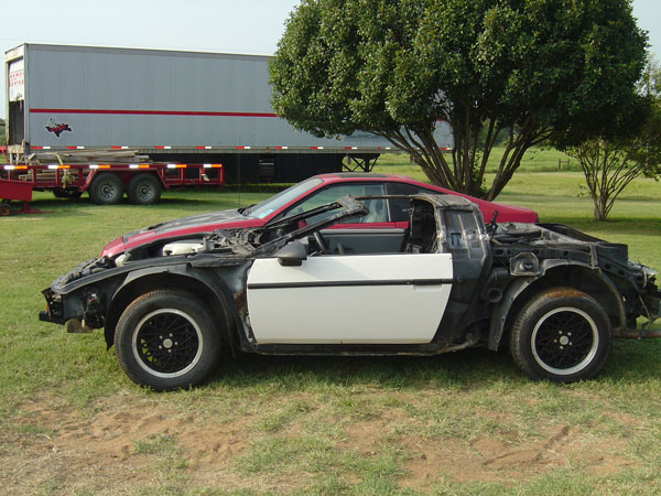

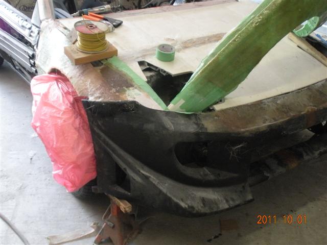

F355spider (nixon@itexas.net) MSG #15, 06-16-2011 10:25 PM
      I was not expecting to do a build thread so there are not a lot of the chop.
Gianina took one of me taking out the interior.
A couple after the chop fitting the body back
Sorry but that is all I have for tonight

F355spider (nixon@itexas.net) MSG #20, 06-17-2011 01:11 PM
Originally posted by av8fiero:
Good luck with your build, I'm looking forward to seeing you pull this off as no one has pulled a Choptop t-top off yet as far as I know.
Thanks,
I have a few pictures of the T-Tops in and the driver side window test fit. All the welding is done on the top. I have the body cut down in the back. I did not cut any on the T-Top frame it is as it was just a few inches lower.
The Glass shop I got the Sebring windshield from said they will cut my back window for me. I hope to get them a wood template made this weekend. I have to be at work both Saturday and Sunday this weekend so I will not be able to do much. The pictures I post tonight will get the build up to date as it is.

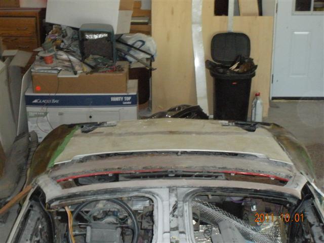

F355spider (nixon@itexas.net) MSG #28, 06-17-2011 11:29 PM
      This is were we are to date. I put the tops in to show the fit. No seals, I want to order the new ones for a Camaro. One picture shows my window test fit.
Every thing lined up good took me two days to weld it up. I took more measurements than needed but Gianina told me it better be right.

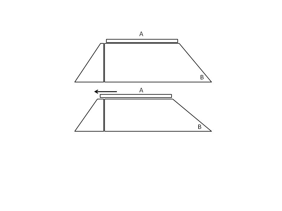

The difference is that in a "normal" fiero chop top the stock windshield is used only laid back 9 degrees and therefore the roof gets shorter.
In a chop top t-top the roof stays the same size so the windshield has to get shorter...hence Mike is using a custom windshield, (from a Sebring) I believe and he is also moving the cowl forward giving the car a more modern look. It is more work than simply making the roof shorter and that's one reason one hasn't been completed to my knowledge.

qwikgta (qwikgta@yahoo.com) MSG #49, 06-20-2011 05:59 PM
      This is a bad drawing but I think it helps what im saying.
If you change the angle at "B", it moves "A" back. If you move it back more than an inch, it will hang over into the sail panel, and I think, look goofey when the glass is off. I just want to see how the heck he did it. I have been looking at my top for years and I can't figure out how he did it.

jscott1 MSG #50, 06-20-2011 07:00 PM
Rob
I totally get what you are saying, but from the posted pic the t-top looks like the example on top, which is the same as a stock T-top.
I can't speak for Mike, but on my chop top t-top the windshield frames were cut down such that the "A" pillars were shorter. This required a cut down windshield.
I'm not sure exactly how Mike did it.

fieroguru MSG #51, 06-20-2011 08:05 PM
      My $$$ is that he moved the lower attachment points for the A-pillars forward. With his window selection he was going to have to build a new lower windshield base anyway, so why not move the bottoms of the A-pillars. This would allow the t-top section to remain essentially stock and the needed length change happens at the front. Here is a comparison pic between his lowered t-top and an old stock height parts chassis.

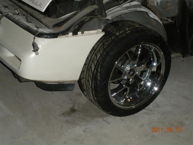

Thanks, I will be ordering her wheels next week I hope they work. The backs are 17X10 the fronts are 17x9. They are XXR 536. I wanted 18 rears and 17 fronts but it is so hard to find what you want unless you pay mucho. So it will be 17 rears and 17 fronts.

F355spider (nixon@itexas.net) MSG #103, 07-01-2011 08:03 AM
      I ordered the wheels. We decided not to get the XXRs and went with a wheel we could get in 18X10 rear and 17X8.5 front. I hope to get them in next week. The plan is to bring the body out to fit the wheels and tires. Just not sure what size tires will look good and still ride good.
I will be working on the hood this weekend and the tray for the windshield if all goes well.

      I did get a couple of pictures from yesterday I have a base, will fill the gaps with foam and fiberglass over. That is the plan anyway.
Yes the blue carpet will be gone. This was a very clean car one of the better cars I have had but man what some people like to do. Stephen was right on when he described its condition. I think I am on the right track Gianina walked out last night and said WOW.

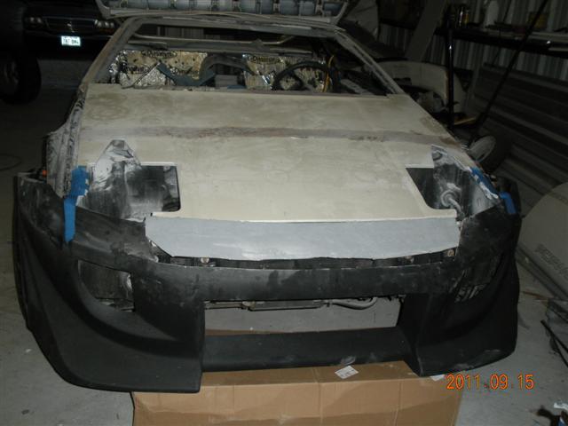

F355spider (nixon@itexas.net) MSG #123, 07-06-2011 09:37 PM
      Thanks, Guys. I spliced the hood today and took four inches out of it. I also put some glass over the foam on the new shelf.
Next I have to put the latch, pins and wipers back. Then I will start on the headlights.

Check this out......
When we chop the top we lower the windshield by 9 degrees. SEE "A"
That shifts the whole roof back about 1-1/2 inches. SEE "B"
That will change the angle and hurt the seal in the area where the roof panels meet the windshield. SEE "E"
As the roof shifts towards the rear of the car the trailing edge of the "T" top panels also moves back toward the rear. SEE "C"
As a result that will screw-up the seals and several other things at Fiero B pillar. SEE "D"
If you've ever removed the headliner from a "T" top car and looked at the "T" top structure from underneath (in the area "E" from the inside) You'll find that it extends almost all the way to the rear window. We do a lot of cutting and welding in this area and (SEE "E") and if we try that with a "T" top car, I'm afraid we'll ruin the "T" top car.
I hope that explains it.
Archie

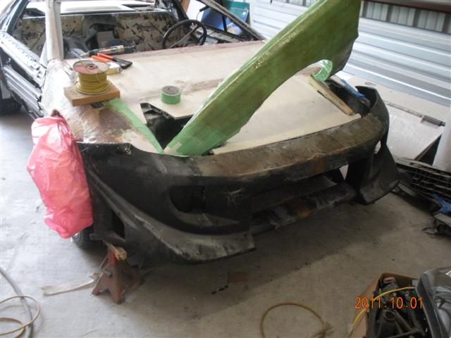

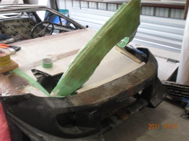

I almost forgot I made a cap of the top of the front bumper yesterday. Once I pull it I will be able to use it to build the new front bumper and get the headlights cut in. I have to what for the sides of the car until the wheels are made and shipped. Once they are where they need to be I will know how wide the car will be.

      Had a little time to work on the car today. I worked on the windshield area some.
I had to fill at the bottom and fill the center at the top. I have a cap to start the bumper with. Not sure how it will end up yet but with the top I will be able to work on the lights.
I just used tape it was faster than waxing and less work.

      I have the ruff out done for the headlights will try to get some time to post a picture or two. I was able to pick up the Stu-wipes also.

I have the top hoop fitted and the rear hips removed ready to be fattened up a little.
MstangsBware (stephen_p38@yahoo.com) MSG #180, 08-16-2011 09:42 PM
      Starting to look a little differant......

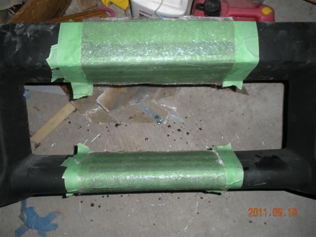

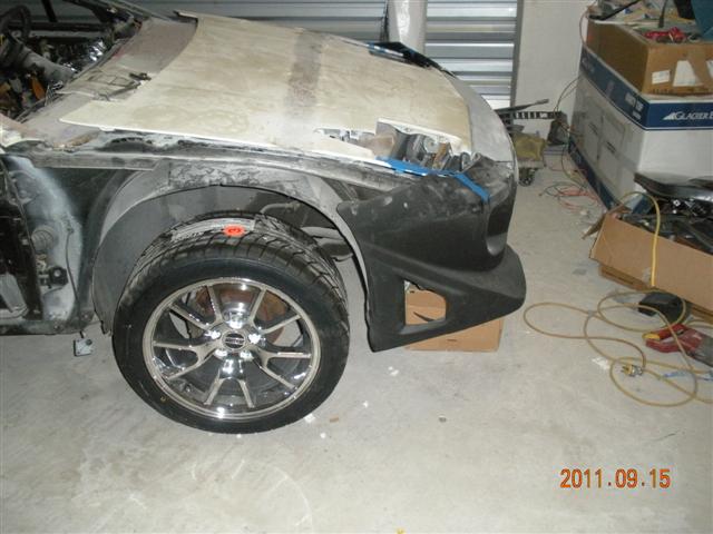

      I took a few pictures of were I am with the front of the car. I decided to modify a bumper saves a lot of time.
Shot of the rear wheel on the car
F355spider (nixon@itexas.net) MSG #215, 09-18-2011 04:29 PM
      Still only one day off this week so I took a little time to make the spacers for the front bumper. I have to make it five inches wider on the front. Looks like the front is 73 inches wide tire to tire and the rear is 75. If I remember right that is the width of the 355 Ferrari.

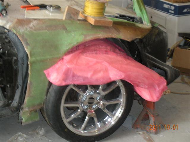

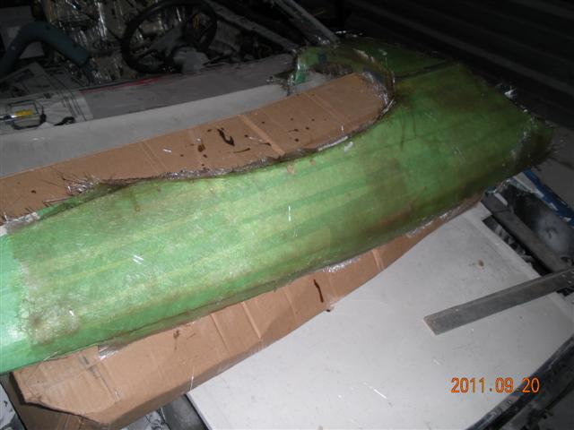

F355spider (nixon@itexas.net) MSG #217, 09-20-2011 10:21 PM
Looking good spider.
Are those lambo headlamps in the works ?
Can't wait to see how you going to shape the front and rear hips.
Thanks, Celica headlamps. I got one of the fenders started today.
The way I do it is fast but takes more finnish time but beats making molds.
KVCFIERO MSG #218, 09-21-2011 06:32 AM
      I like the front bumper it looks like it is close to fitting or could be fitted to a stock Fiero fairly easy. I wonder how many others have done this and how much would it cost?
F355spider (nixon@itexas.net) MSG #219, 09-22-2011 06:26 AM
For me it is a big time saver. It would be too wide for a stock fiero but could be made to fit as I have to make it fit for my needs. I paid $123.00 for it online. So for the price I would use that much in material and time to make something of my own. I got the back bumper in yesterday but did not get to take a look at it. I also got all the Polly and parts for front and rear cradle so I will get that done next, cut the springs (need a coil off drop front) and get at it again when I get some time.
Thanks,

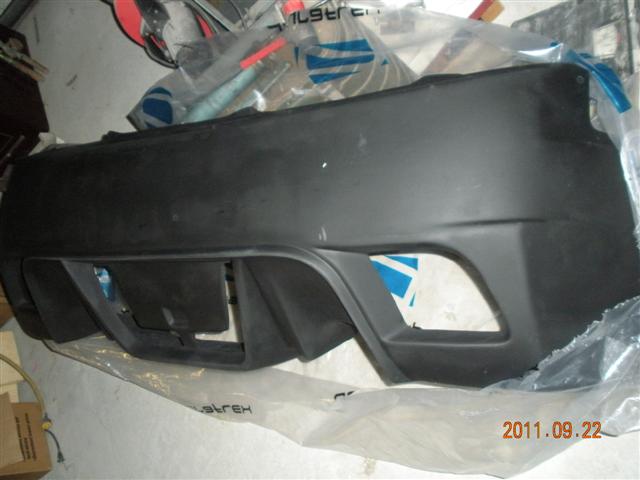

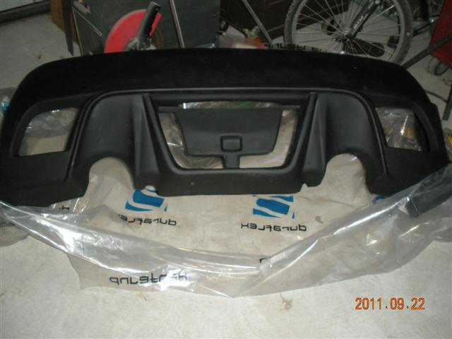

      Got the back bumper in today. After posting my last post this morning of the price of my front bumper I got a (NEG) added to my bar so with this post I will let everyone know the back bumper was $186.00 and that Amazon.com is were I got them. There are a lot of good deals there.
Thanks,
exoticse (exoticse@netzero.com) MSG #221, 09-22-2011 09:43 PM
Now that back bumper is really slick looking !
What car was that made for ?
Man I really need to look around for a future project !
F355spider (nixon@itexas.net) MSG #222, 09-23-2011 09:15 PM
It is for a G35

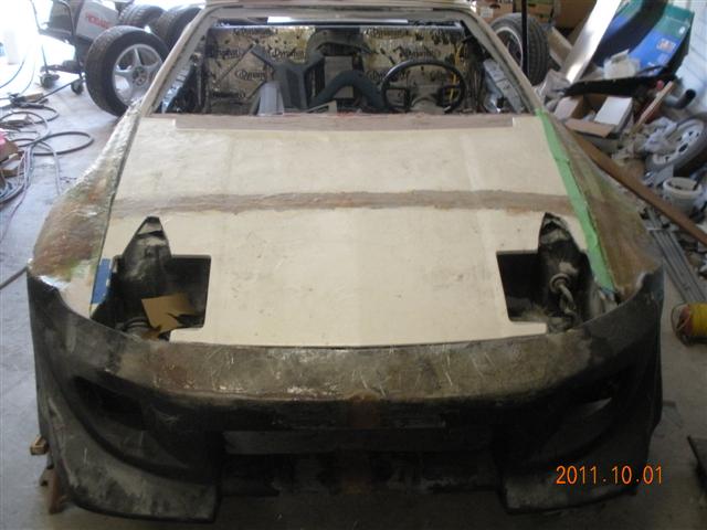

F355spider (nixon@itexas.net) MSG #225, 10-01-2011 11:42 PM
      I got to do a little work on the front end
Finnished with the fender skins
then molding the front together
Next is a couple of shots on how wide the front will be. I want to have the car flow front to back like the curves of a woman. The doors will be the waist then I will work on the wide hips.
A overhead shot
KVCFIERO MSG #226, 10-03-2011 08:50 AM
A overhead shot
I like what you are doing. Looks like a lot of work but should be worth it when the wife gets to show it off.

      I got a little time to cut the back bumper down today I made a couple cuts and set it in place.
I can not post the pictures is
pip not working?
F355spider (nixon@itexas.net) MSG #239, 10-29-2011 09:41 PM
      Thanks to Cliff I'm back to posting pictures. Here are the one I tried to post of the rear bumper
F355spider (nixon@itexas.net) MSG #240, 10-31-2011 09:09 PM
      I started making a jig for the rear fenders today. Thought I would share a few pictures of how I am doing it.
Gonna have some wide hips
KVCFIERO MSG #241, 11-01-2011 07:16 AM
Never thought of that. Waiting to see what is next.
exoticse (exoticse@netzero.com) MSG #242, 11-01-2011 09:03 AM
Pretty nifty idea.
F355spider (nixon@itexas.net) MSG #243, 11-03-2011 07:10 PM
      I had a few minutes so I got a little more done
wee twisted (weetwisted@comcast.net) MSG #244, 11-03-2011 07:31 PM
      now that using your head ...great work....keep it coming....
lamborghinikid (lamborghinikid@zoomtown.com) MSG #245, 11-03-2011 07:38 PM
      How much wider are the wheels in the rear than the stock ones. Looks good
el_roy1985 MSG #246, 11-03-2011 07:59 PM
      Like how you widened the front to match the rear. Should look great when it's all together. Nice choice on the rear bumper, can't wait to see what else you've got planned for this car.

F355spider (nixon@itexas.net) MSG #248, 11-07-2011 12:33 PM
The rear wheels are 18x10 I think Stock wheels are 15X6.5
Innovation rocks, what about the doors?
Don't know yet.

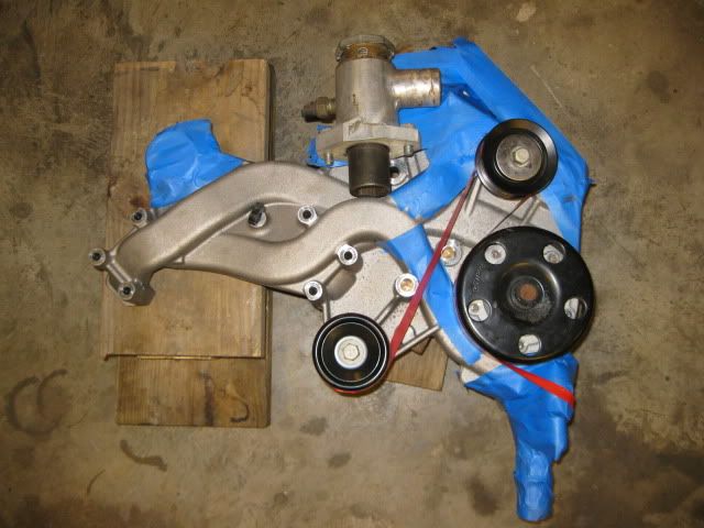

F355spider (nixon@itexas.net) MSG #249, 11-10-2011 09:37 AM

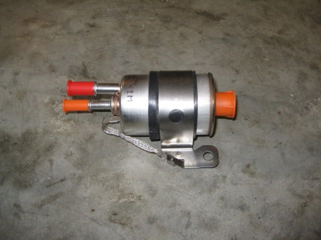

      Good news, my axels and mounts for the LS4 from Joe (Fieroking) are ready to ship. I want to thank Joe for helping me with this part of the build. Gianina already told me I have to finish the body first before I can pull the 2.8. Thanks to Blake I have a lead on a spare cradle so I might be able to have the ls4 swap going as the body is being built.

      I was able to get some time to get the other side done.

      I was able to get some work done on the rear bumper today. thought I would add the pictures of what I did to fit the top of the bumper to the car.
F355spider (nixon@itexas.net) MSG #254, 11-13-2011 07:37 PM
      A few more
KVCFIERO MSG #255, 11-14-2011 07:56 AM
That has to be one of the best looking rear bumpers I have seen on a Fiero.

      A little update to the build. I was looking around for what to do with the spoiler and decided to use the top of the rear bumper I cut off. I wanted something close to the IMSA one. This will giveme a nice head start.
F355spider (nixon@itexas.net) MSG #259, 11-21-2011 08:41 AM
      A little more shaping and glassing.

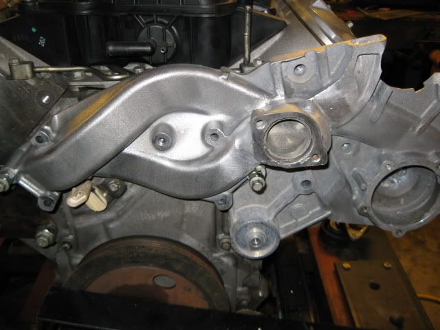

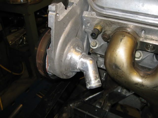

      I do not have any more work to show but I did get a package from Joe while I was away. I opened it today and thought I would share. Joe put together a kit for me for the ls4 swap.

I started on the doors today
Set up for some glass
With the first coat

      OK you guys motivated me to work on the car a little today. I test fit the taillights.
I like the way they fit with the new bumper.
I worked on the bumper also
the other side

      Did a little more work on the rear bumper after I got home.
put some more glass over the foam.

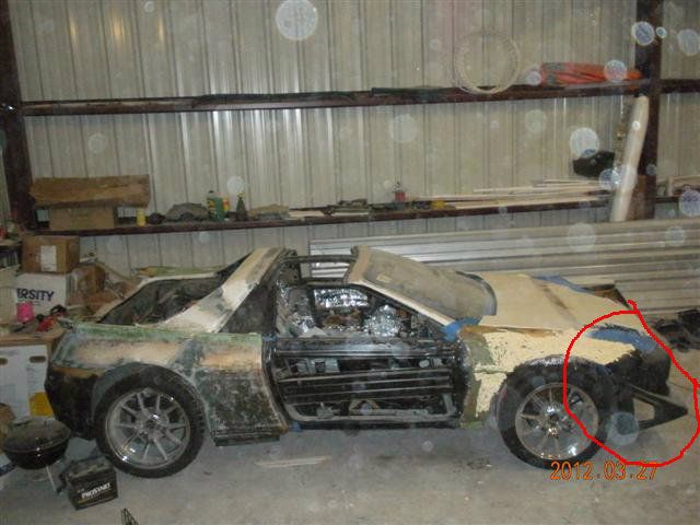

      Was able to do a little carving today. A Lot of work to go not sure when I will get the body finnished.

      I'm no expert at designing body mods so this may be stupid so bare with me. The angle of the front bumper seems to almost match up with the A Pillar body panel next to the windshield. If you fill that vent area up or at least make it to where you can't see through it. Then make the angle match the one of the A Pillar as well as it's shape it might flow better. Like I said, I'm no body guy but just my thoughts. Hope they help.

      I had a little time today so I made two more fender skins. I will mold them on to get me out to were I need to be. I will have to be in San Antonio this week but hope to have a little time to fit them next weekend. I will keep working on it as I can.
Gianina and I dug out some old molds from some GT side windows I made a few years ago. I'm thinking of making them and cutting to fit the notchie. If I mold them in I could have an emblem on each hole needed to put the bolts in for the rear clip. I have always done my own paint but Gianina and I got to thinking if we have the body close if we take the car to a body shop to paint it should be there a while and would buy some time from storage. We could do the same with the engine with the place in San Antonio building the harness they might let us take the car and they build it in the car. It would be a better fit that way also and might add some more time out of storrage also and keep the build going. Even with the HOA we should be able to do the interior in the garage.

      Did a little work on the car this weekend. Here are the new pictures.
PM sent...
F355spider (nixon@itexas.net) MSG #387, 06-11-2012 07:50 PM
      As you can see the side vents were cut out and filled. I droped the bumper a little in front and she got a little wider. I will try to do a little more next weekend.
Marine1981 MSG #388, 06-11-2012 10:59 PM
      Still looking good! The vents being filled looks a lot better IMHO.

F355spider (nixon@itexas.net) MSG #398, 06-25-2012 09:19 AM
      A couple more pictures on pulling in the fenders I only got started on one side.
Real ruff but gives an idea of how I am doing it.

      talked to speed scene today about wireing the Ls4 up. When I get it in the car I will run it over to them to get the fit. then take it to the house to work on the body again. I will just keep the door close.

josef644 (josef644@hotmail.com) MSG #421, 07-28-2012 10:15 AM
      Excellent. Becca with a shotgun?
Here is a picture of the front fascia that you used to make the mold on 7-23-11. I got it from Tom Slick a few months back.
Cleaned and repainted.
[This message has been edited by josef644 (edited 07-28-2012).]
F355spider (nixon@itexas.net) MSG #422, 07-29-2012 09:26 AM
Looks most excellent. Nice to see it recycled.
F355spider (nixon@itexas.net) MSG #423, 07-29-2012 09:37 AM
      I'm done for the weekend heading back to SA. This is what I did and it does not look like a lot but this LS4 is huge. I found out it uses every once of cradle and then some. It was a hot and tiring last two days. Ben your shades are here they are on the table.
Here is were I had to cut out for the oil filter.
How I used the mount
F355spider (nixon@itexas.net) MSG #424, 07-29-2012 09:44 AM
      I had some three-inch pipe so I cut out a piece and dusted off the welder and plasma cutter.
F355spider (nixon@itexas.net) MSG #425, 07-29-2012 09:57 AM
      I got hit with a few other issues also and had to trim more of the cradle is a couple other places. I also had to make a front bracket that I did not have so I did not get to finish getting the engine mounted. I will have to finish at another time.

F355spider (nixon@itexas.net) MSG #433, 08-04-2012 09:31 AM
      Working on the front mount again taking a lot of time.
I have to cut the bolt off it hits the axel.
Getting ready for first test fit. I was hoping with the kit it would just be done but I still have a lotof work to do.
Finding out the alt bracket has to be removed it hits the strut tower.
F355spider (nixon@itexas.net) MSG #434, 08-04-2012 09:41 AM
I removed oil filler and back bracket. Looks like rear pipe is close also.
More problens the Batt tray has to go.
This was it. Next time I get to work on the car
I will strip out the rear engine area and clean it up.

You are on the right track. You cannot cut that much because it will weaken the windshield frame too much. There is a thick metal bottom on the T-Top frame that you do not want to remove also so you can only remove about 1/2 inch in the area you are talking about.
engine man (fieroa8@gmail.com) MSG #483, 09-22-2012 05:49 PM
      Then did you do it in 3 places first you moved the t top back 1/2 an inch then cut a 1/2 inch up front and kick the bottom of the windshield forward 1/2 inch . This way nothing looks really off
[This message has been edited by engine man (edited 09-22-2012).]
F355spider (nixon@itexas.net) MSG #484, 09-22-2012 09:40 PM
I measured my windshield to the T-Top it is 3.25 inches. I will post picture when I get back to the house next week. You got off track again on your last post.
engine man (fieroa8@gmail.com) MSG #485, 09-22-2012 09:53 PM
      don't know how you did it but it still is good to see it can be done. I hate hearing those words of you cant do that
engine man (fieroa8@gmail.com) MSG #486, 09-23-2012 10:52 AM
      Well i just wen out and looked at it i think i would just cut the T tops down by 1 1/2 inches and be done with it i dont know if the glass can be cut easy
[This message has been edited by engine man (edited 09-23-2012).]
F355spider (nixon@itexas.net) MSG #487, 09-24-2012 08:28 AM
I agree .
engine man (fieroa8@gmail.com) MSG #488, 09-24-2012 10:45 AM
      let me ask this are the side windows cut any different then the normal chop windows and this is a 3 inch chop and you are not shortening the t tops . If you can only remove let say a maximum of 3/4 a inch from the area between the T tops and windshield and you are not kicking the bottom of the A pillars forward then it must move back or there is just enough play from the factory to squeeze the opening down for the t top assembly
F355spider (nixon@itexas.net) MSG #489, 09-24-2012 08:33 PM
This is the picture I told you I would post for you.
I will use the set of windows I have left. same as in my other Chop-Tops.
thanks,

fieroguru MSG #500, 09-27-2012 01:27 PM
I did not cut the tower. I just made two or three "dents" in the places that were to close or touching.
I rerouted the belt drive so I didn't need the idler pulleys and could remove them... no mods to the strut tower.

fieroguru MSG #504, 09-28-2012 06:34 AM
Thanks, I will check into the thermostat. I would have not thought of that at all. I would like to do it the way you did. Do you have any pictures of how you cut and were on the lines?
It was a lot of work hacking up the water pump and welding it all back together...
Stock:
Everything in with blue tape was removed:
After the first round of cutting:
After welding:
Original accessory drive:
My modified version:
F355spider (nixon@itexas.net) MSG #505, 09-28-2012 06:00 PM
Stock:
After welding:
Thats some nice work. I did not know it was so much work to do that.

      I was going to order some parts and was wondering what parts are needed for hooking up the fuel line? Thought I would see if anyone had a list with part numbers? Need fuel pump, filter, fittings, line size and connector for injector rail.
fieroguru MSG #532, 10-29-2012 05:29 PM
      Here is my parts list:
Fuel pump:
98 L31 Vortec 350 (fits stock fiero fuel pickup assy.
Fuel Filter/regulator: (converts fiero fuel system to returnless)
The thread in adapter for the engine side of the fuel filter:
My fuel filter will be in this general location with the supply/return being fuel injection rated hoses (picture is from one of my previous swaps):
Fuel rail to 6AN (also works for the fuel filter - so need 2):
http://www.ebay.com/itm/LS1...em1e71e63063&vxp=mtr
Hose ends and PTFE braided fuel line:
FRA-601006
http://www.summitracing.com/parts/fra-601006
FRA-680106-BL
http://www.summitracing.com/parts/fra-680106-bl
FRA-689006-BL
http://www.summitracing.com/parts/fra-689006-bl
I might be working on finishing my fuel system this coming weekend and can post actual installation pics.
[This message has been edited by fieroguru (edited 10-29-2012).]

      Just wondering if that fuel filter would work for a 3800 swap!
F355spider (nixon@itexas.net) MSG #535, 11-01-2012 03:23 PM
I have no clue we need a 3800SC person to step in on that.

      I put some mud on the rear bumber.
I also got all the parts in for the fuel line.

      Well I had a rough weekend but I did a little sanding on the car. At one point I was thinking about cutting the car into pieces. But I just kept sanding.
I was able to find one of those rare deck lid sticks also.
A few more pictures. Gianina decided she is going to call the car Frankenstein. She had named the old silver car problem child.
There is still so much work to be done.

      I got a day to work on the car. I cut the hoop off and moved it as far forward as i could. I like the change. I also changed side vent location and worked on the rockers. I like the changes.
I matched the vent with the one in the rocker.
F355spider (nixon@itexas.net) MSG #548, 11-30-2012 07:49 PM
      Vents cut out in new location.
Then as always the parting shot of leaving untill next time.

      Gianina and I worked on the windshield and fit.
I wanted to add some filler under it to sure it up more.
I did some more work on the front clip.

F355spider (nixon@itexas.net) MSG #582, 01-22-2013 10:06 PM
Originally posted by Marine1981:
I forgot to check on the car today! Oh well, always next time.....
I thought about that when you left. I had to take some pictures of the engine swap for the harness maker so I thought I would post a couple of them.
This was the email I got today.
Sweet. I have your base powers and grounds down and will be moving forward. The routing is perfect but I will see about tweaking some more tomorrow.

      I found a little time to take the gas tank back out today. I need to replace the fuel lines with longer hoses to fit the fuel filter. I plan to set it up like Fieroguru showed. I'm also kicking myself I had the cold air st up bought but it is way to big. Thinking if I can not make it work I wasted a couple hundred bucks.
F355spider (nixon@itexas.net) MSG #615, 02-25-2013 10:33 PM
      I got the fuel filter/regulator installed today so I hope the tank is in for good. I will make the fuel line to the fuel rail next.
fieroguru MSG #616, 02-26-2013 06:37 AM
If you flip the bracket around that is holding the fuel filter/regulator, it will tuck up close to the backside of the tank and keep it out of the engine bay area:
F355spider (nixon@itexas.net) MSG #617, 02-26-2013 10:14 AM
You da man I will do that. Thanks
F355spider (nixon@itexas.net) MSG #618, 02-28-2013 06:06 PM
      I swaped the fuel filter around. I was going to finish the fuel line but I ordered the wrong an fittings. I keep ordering the wrong stuff. I guess I'm getting old. I ordered a radiator hose and it was a heater hose size. Same thing with my cold air intake it is huge not near the right size filter.

      I worked on the engine some last night. I got the MAF in so I installed it.

      I got one of the radiator hoses finished tonight. I have the hose to finish the other side so I hope to get it done tomorrow. I am trying to get something accomplished every day I can work on the car until I get to start it.
I cut the 2.8 tube and recycled it. I found a great mounting point for it.
