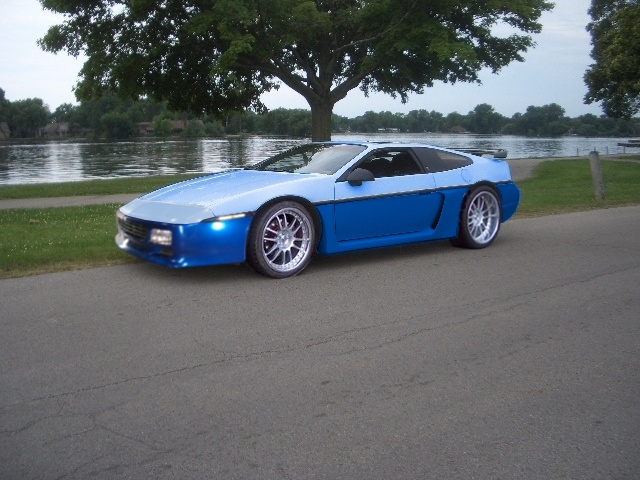

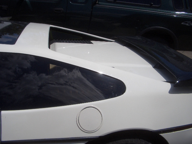

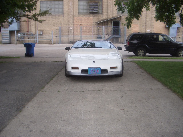

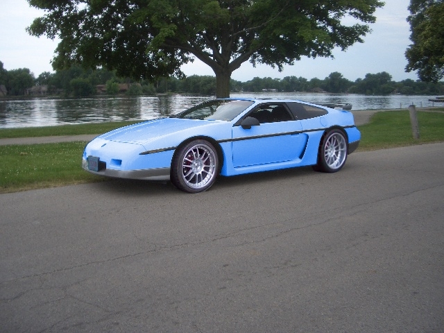

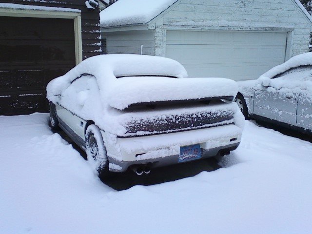

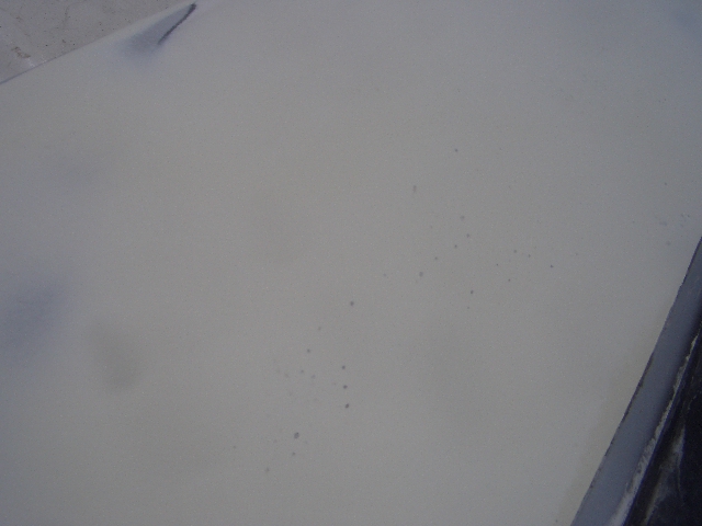

      So, today I am finally getting underway with my chop now that all the snow has gone (crosses fingers) Yesterday I prefitted the Archie rockers I am going to do everything at once I decided so I can just hammer out all the bodywork at once.
This is what I am thinking for a color combo

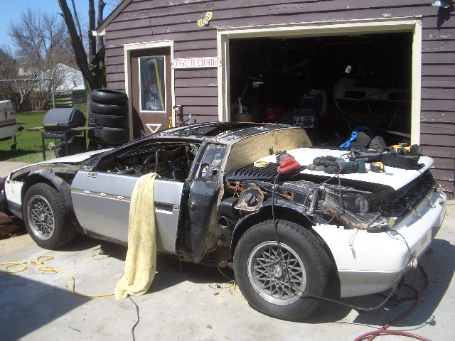

jetsnvettes2000 MSG #4, 04-24-2011 07:45 PM

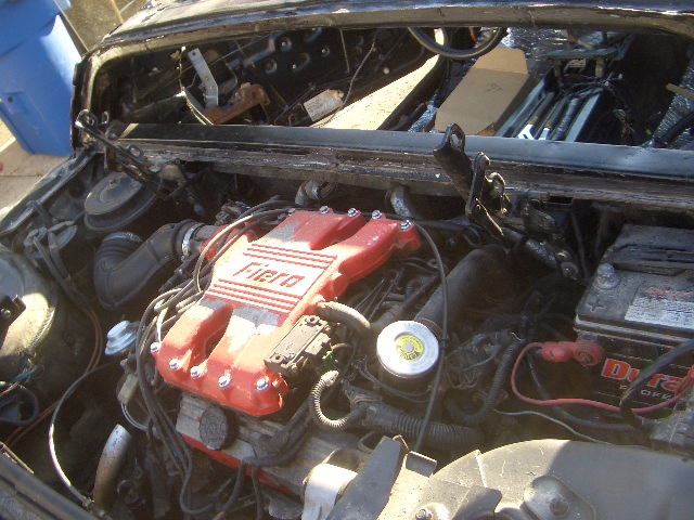

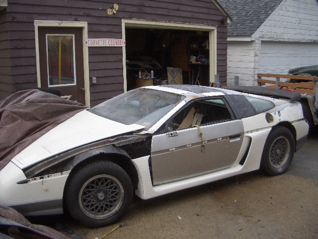

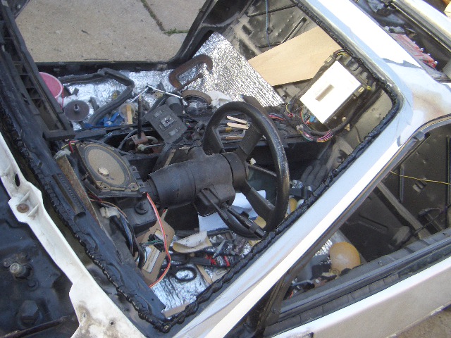

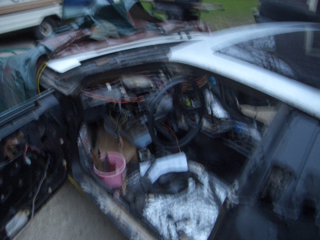

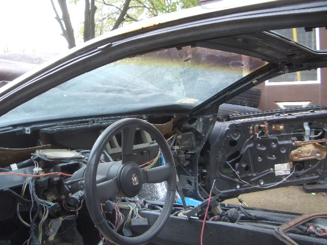

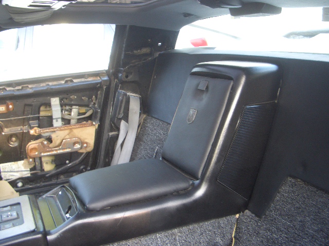

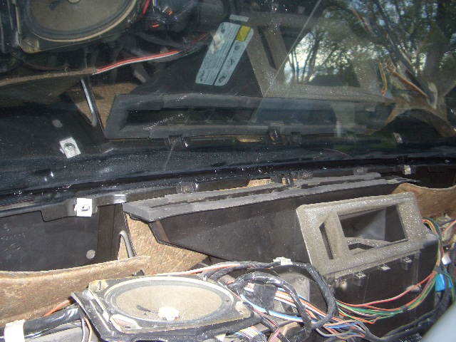

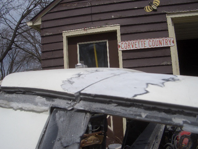

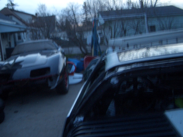

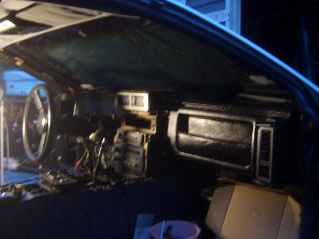

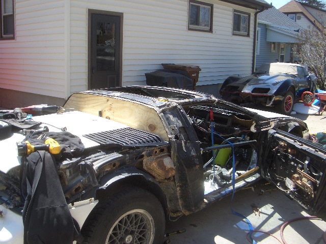

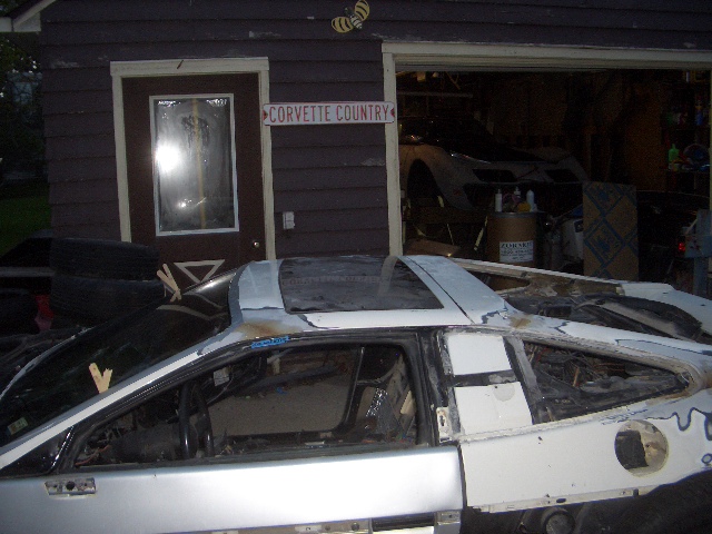

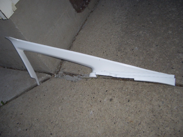

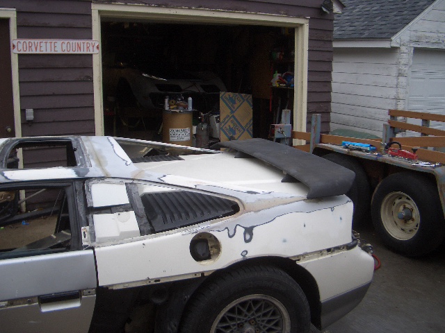

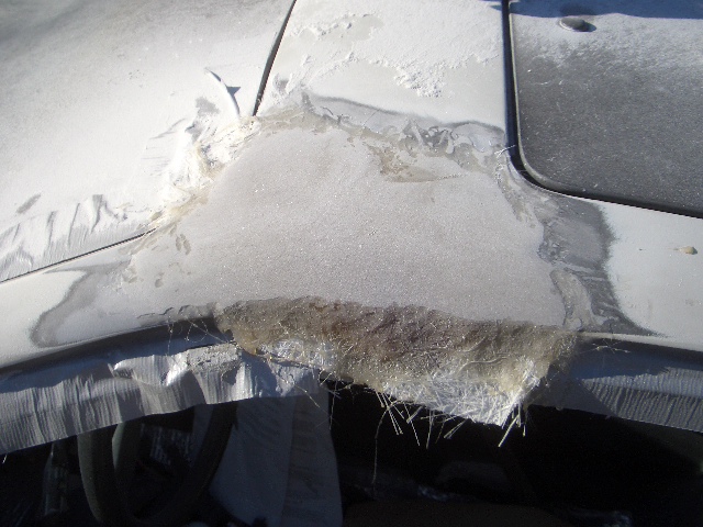

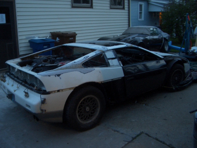

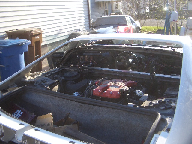

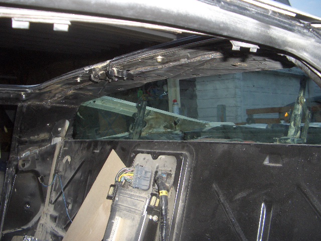

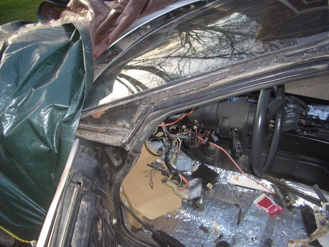

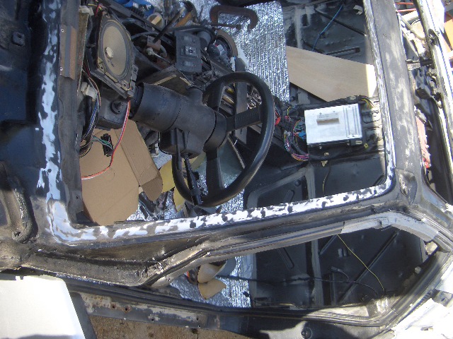

      Yup I am doing a total home brew chop using the Archie kit Today made huge progress all I have left is to remove the front and rear windows and to weld in support braces then its Chopin time!!! I had a bit of a pain in the ass with two of the roof hold down bolts one on the fast back part and one on the roof panel both of them spun outta the fiberglass so I will have to fix those later but otherwise just being slow and careful I didn't break nothing! did all this myself today in just a few hours.

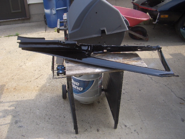

Sail panel fail oooops!

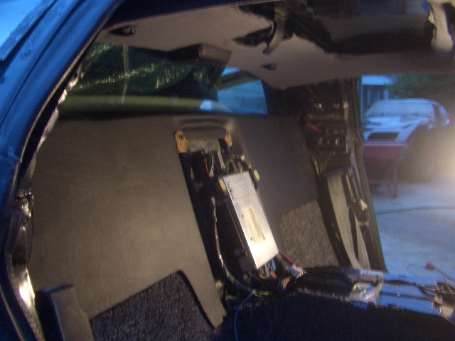

Pain in rear to remove!!
took entire interior out
Found my short! grrrr mice!

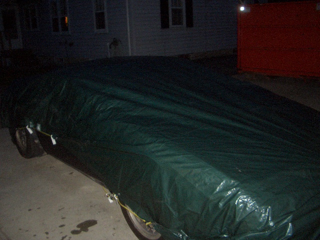

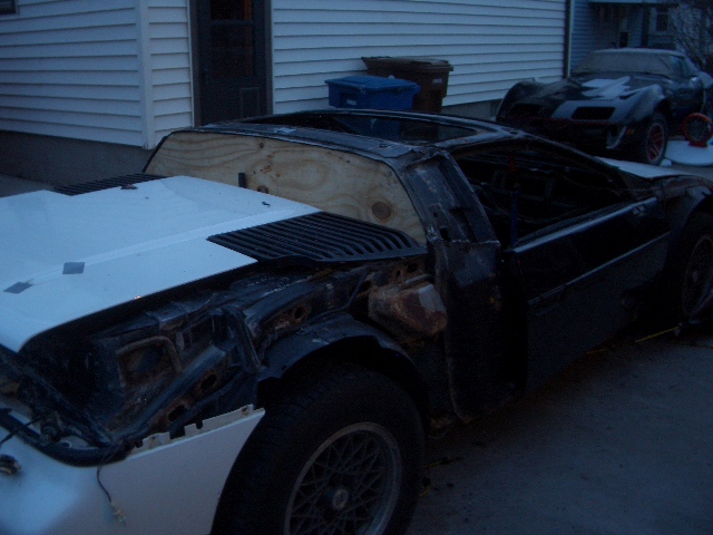

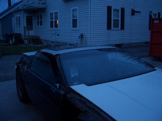

Temporary roof to keep rain out
Join us!!

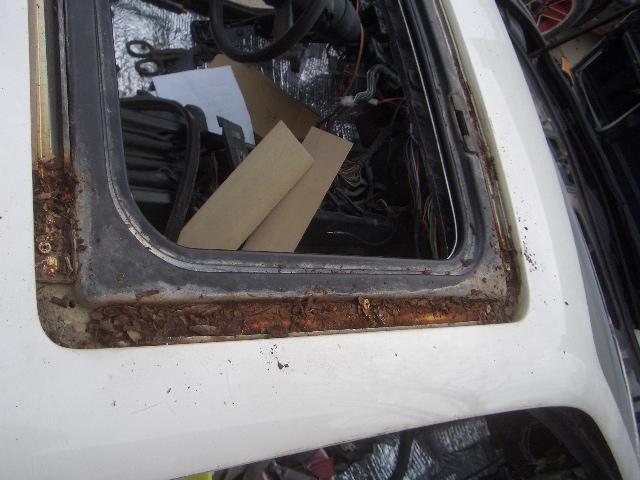

Damn thing bit me!!!

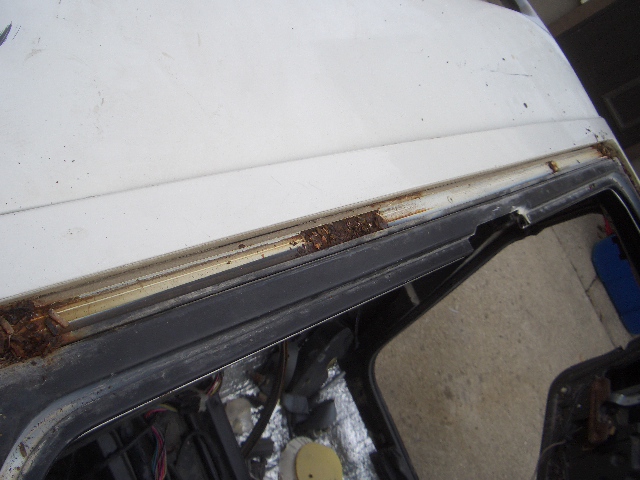

minor rust

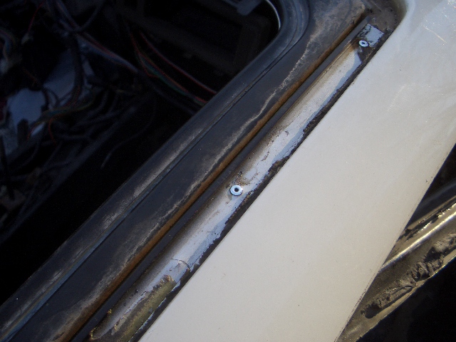

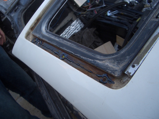

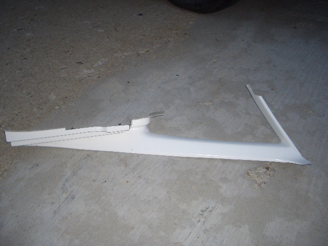

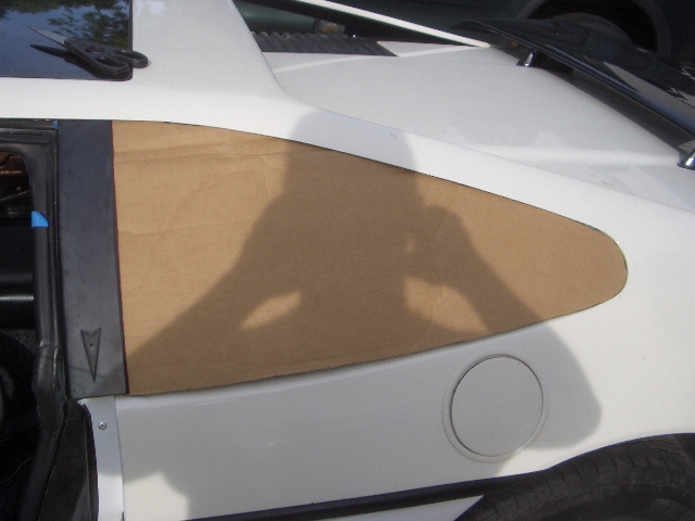

jetsnvettes2000 MSG #7, 04-24-2011 10:22 PM

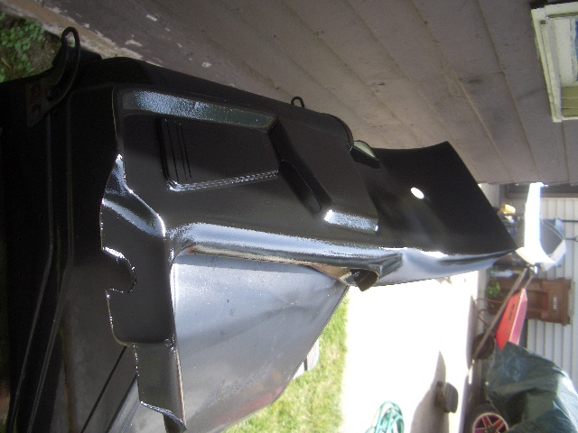

      So I like the look of the sail panels shown on the outlaws thread, but my question is were can I find a set of smoked sail panels to cut up so I can do it since mine disintegrated when I tried to remove them, granted mine were really cheap knockoffs and didn't even have a curve to them they just were bent over on the front. I need a set of not so nice ones if anyone has some they can be totally junk I think i am going to use them as a mold and just make a set of fiberglass delete ones with a scoop in it. kinda like the ones on a lotus esprite.
[This message has been edited by jetsnvettes2000 (edited 09-15-2013).]

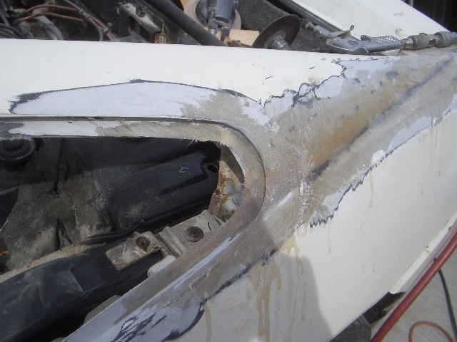

jetsnvettes2000 MSG #8, 04-25-2011 09:39 PM

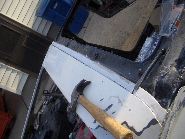

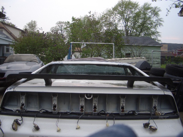

      So I got a little farther today and let me tell ya the back window glue is one hell of a pain in the ass to remove!!!@!
[This message has been edited by jetsnvettes2000 (edited 01-06-2018).]
86soon3.4 MSG #9, 04-25-2011 10:05 PM
Originally posted by jetsnvettes2000:
So I got alittle farther tonite and let me tell ya the back window glue is one hell of a pain in the ass to remove!!!@!
Soooooooooo, what's the hammer for?
Steve
jetsnvettes2000 MSG #10, 04-25-2011 10:21 PM
      Well its the instant window remover tool!

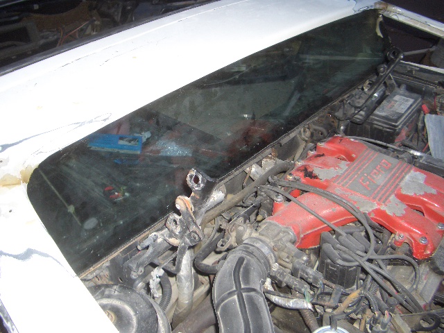

jetsnvettes2000 MSG #12, 04-27-2011 11:20 PM

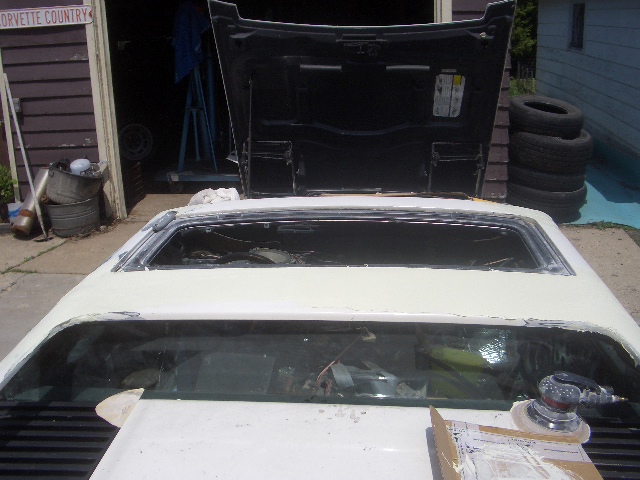

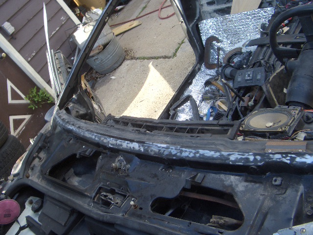

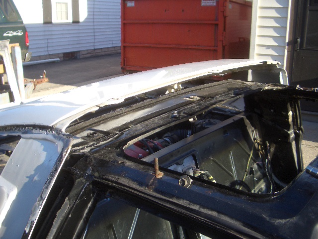

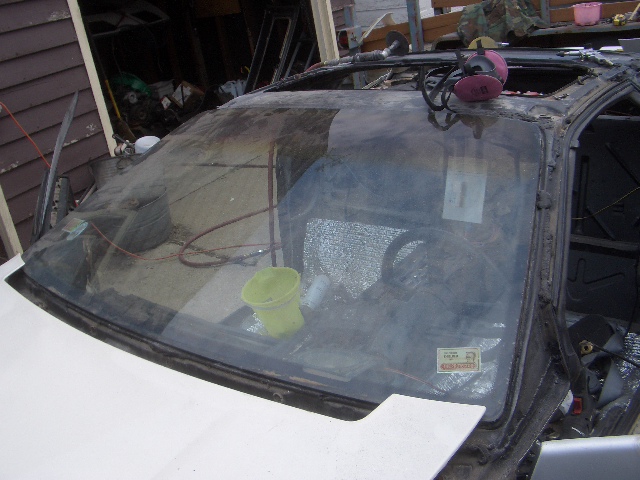

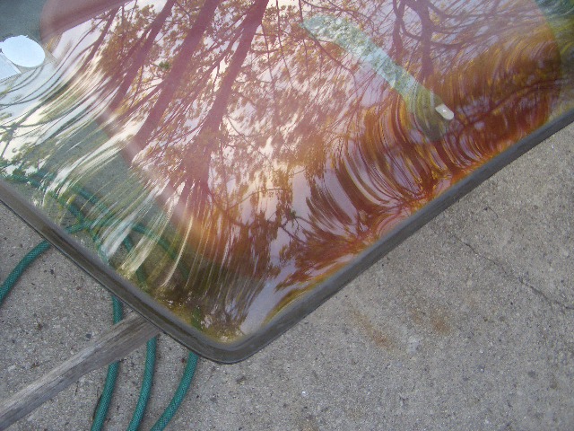

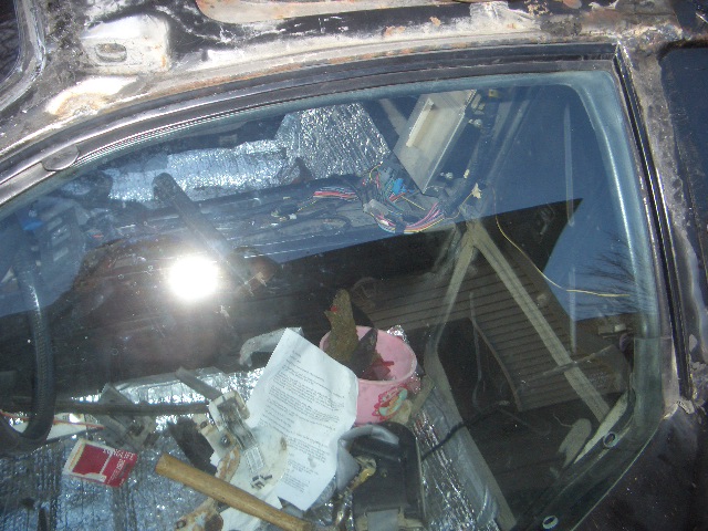

      Got alittle farther today, the front window was coming out really good till I got to the part with a chip in it and just like that it cracked grrrrrrrrrrrr well I wanted a new one anyway guess I am forced to get one now! tomorrow I will be making a internal frame for inside the car to hold it square and temp welding it in, prob overkill but my driveway is un-even so I dont want to use the block it up method.
[This message has been edited by jetsnvettes2000 (edited 04-30-2011).]

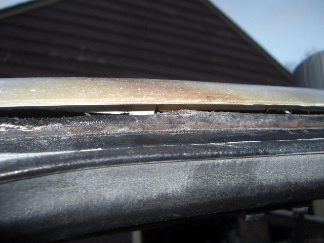

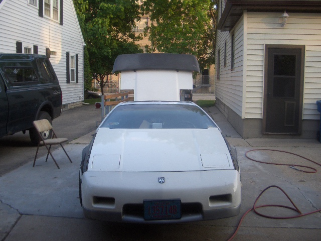

      The chop starts now! pics soon to follow as it were I am a bit nervous but confident it will be a snap!
scott0999 (scott099@juno.com) MSG #14, 04-29-2011 01:38 PM

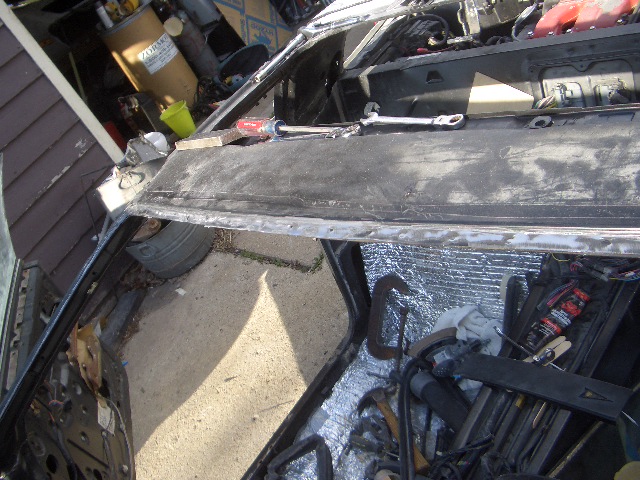

jetsnvettes2000 MSG #15, 04-29-2011 10:19 PM

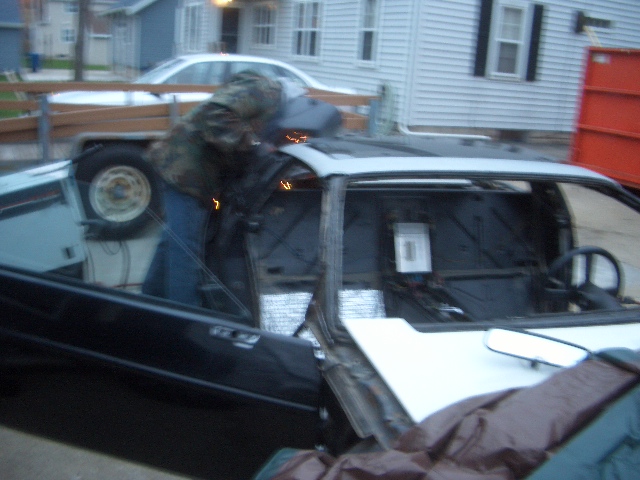

      Got pretty far today but ran out of co2 so I need to wait till monday to finish welding grrr!
Asleep for the nite or untill I can find a place to fill my co@ bottle for my welder tomorrow or I I am done working till monday

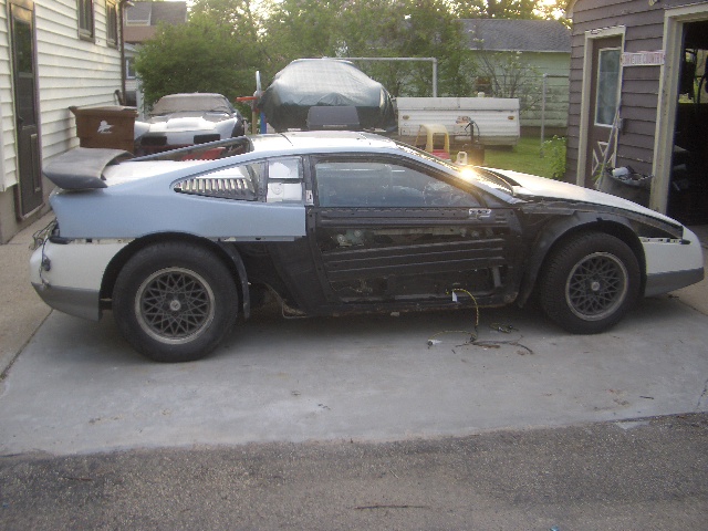

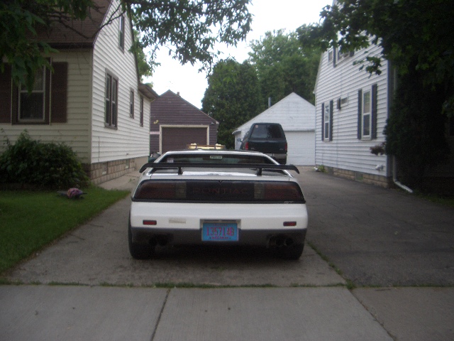

jetsnvettes2000 MSG #26, 05-01-2011 12:46 AM

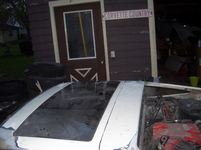

      So did alittle more welding tonite but the weather was not being kind again so I came in and started on my front bumper ideas, this is what I am kinda thinking:

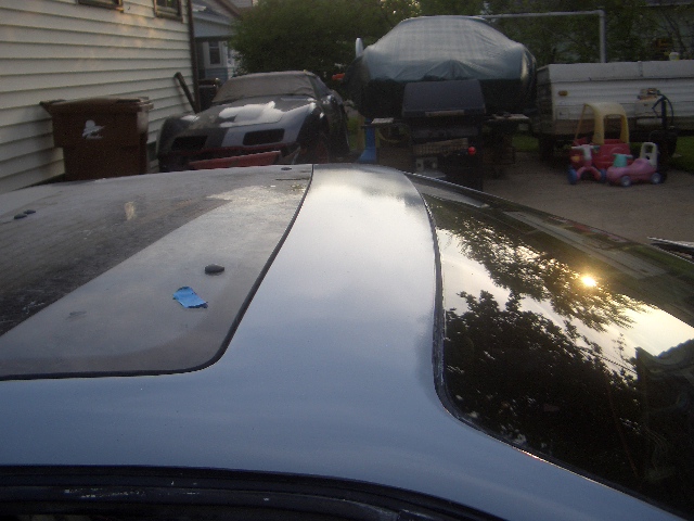

jetsnvettes2000 MSG #27, 05-01-2011 08:49 PM

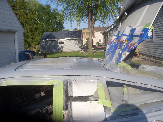

      Did alittle more work today, since I am out of shielding gas for the welder I decided to fix all the rust damage to the rear clip, it took me all of 20 minuts to wire wheel all the rust off and it was good! I then got some good 3m rubberized undercoating and coverd the rear frame rails inside and out, that should take care of any future rust!

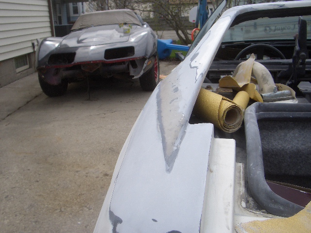

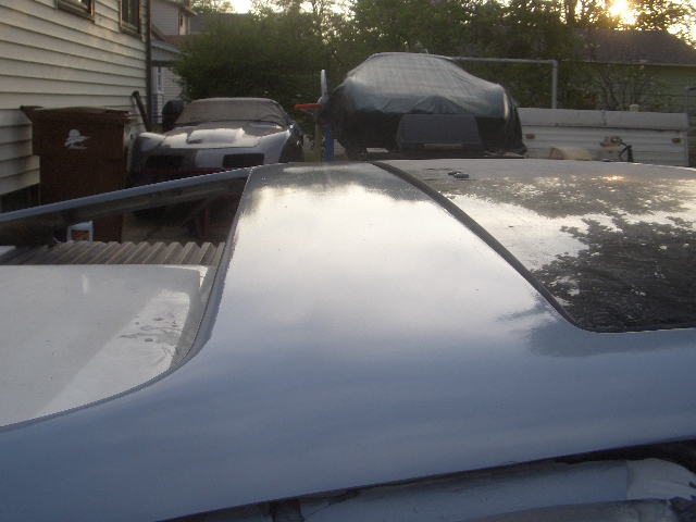

jetsnvettes2000 MSG #31, 05-02-2011 10:05 PM

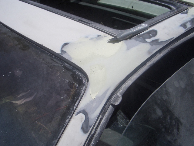

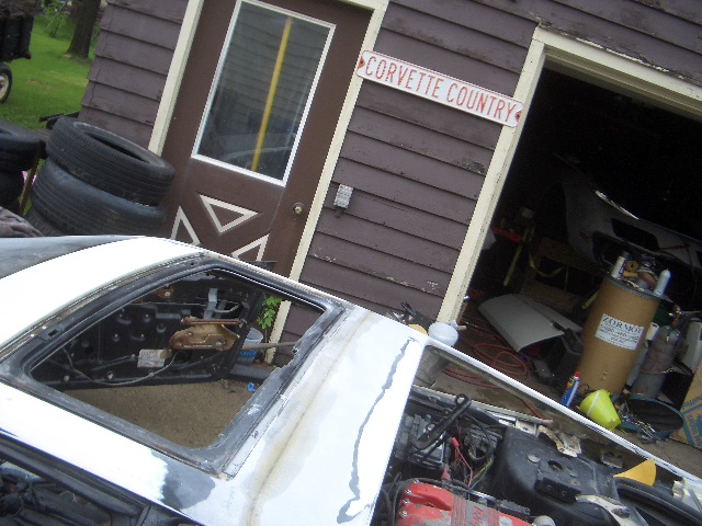

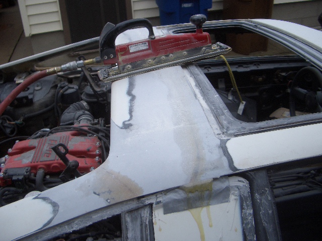

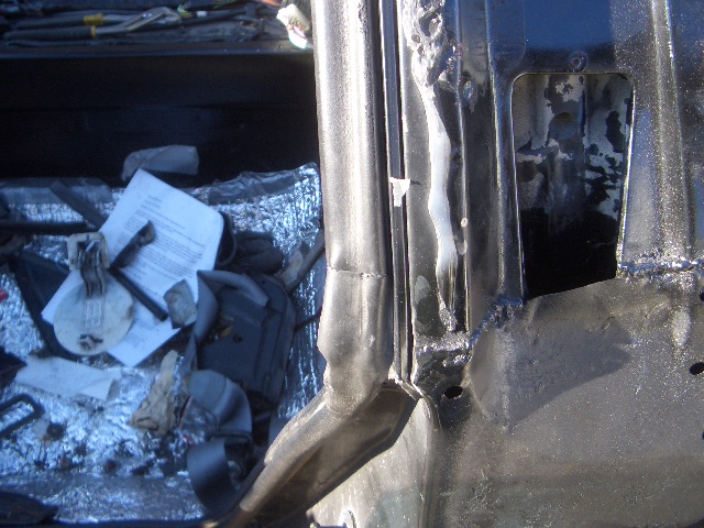

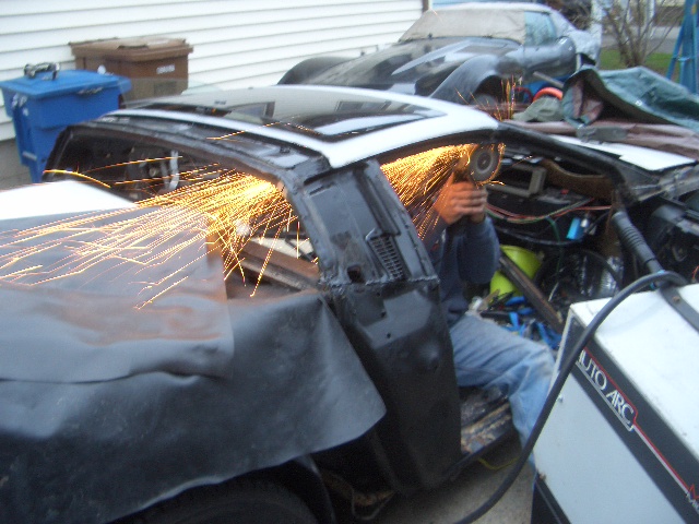

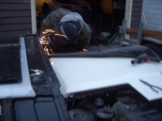

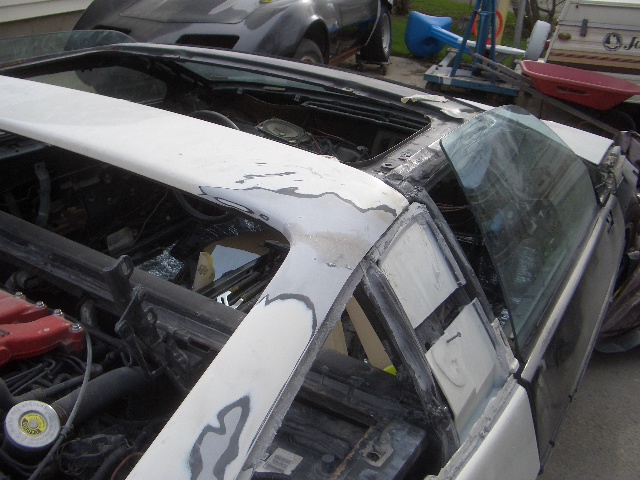

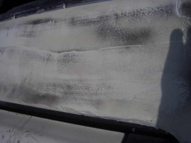

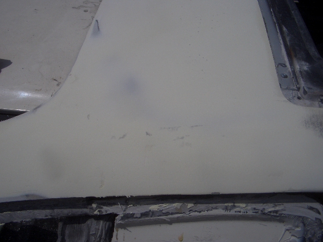

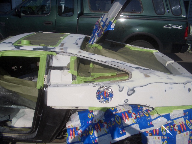

      Well fellas, all the welding is done!!!!!!!!! now to grind it all smooth and throw the glass in it! I think by friday weather permitting ill be well on my way to having all the fiberglass work done.
Av8fiero is grindin some of my welds
All the rust is gone!!
its so great its sparkling!
Av8fiero is really lovin the grinding just alittle to much!

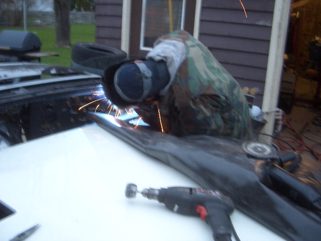

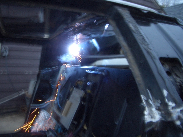

jetsnvettes2000 MSG #32, 05-02-2011 10:10 PM

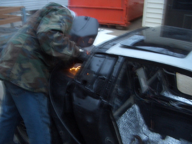

      Me welding a bit!
av8fiero (crmikulski@gmail.com) MSG #33, 05-02-2011 10:12 PM
      Hey put up a pic or two of you welding! lol! Grinding is easy, the welding is the hard part.
edit to add---Oh you got em up there while I was typing. I guess I'll have to learn to take a better pic
[This message has been edited by av8fiero (edited 05-02-2011).]

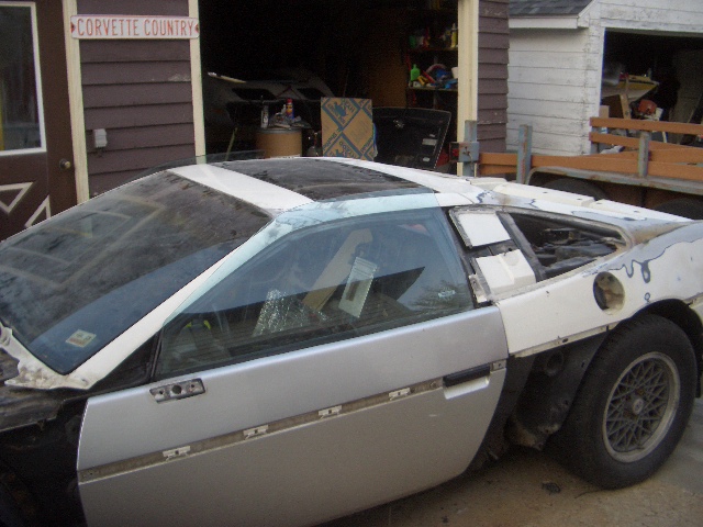

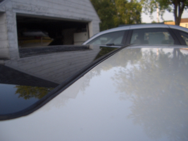

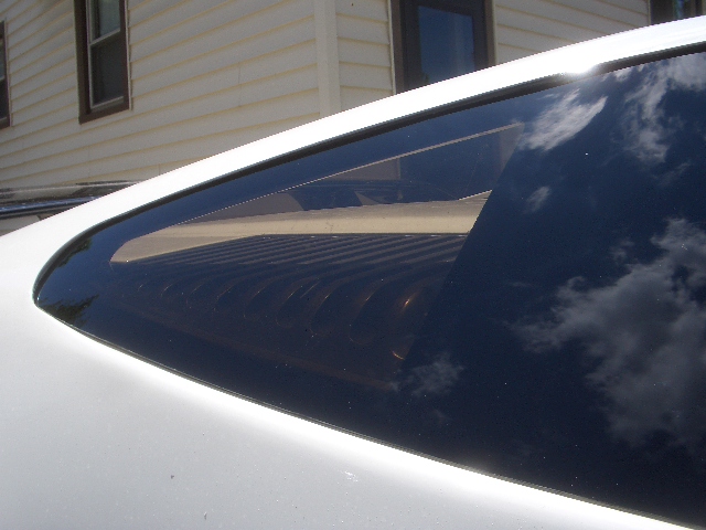

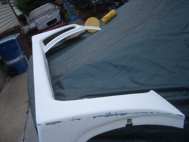

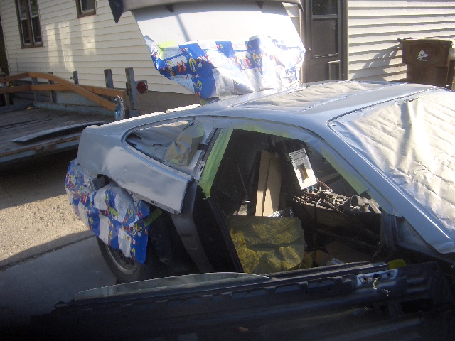

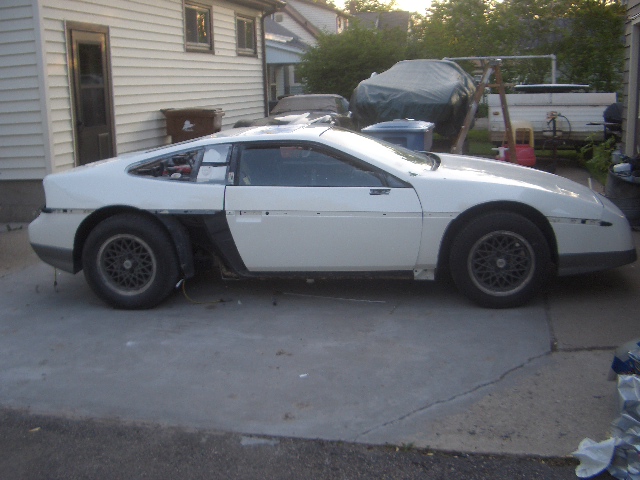

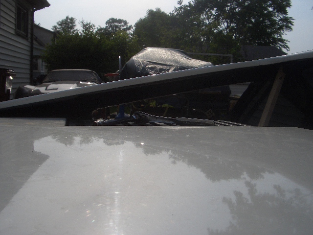

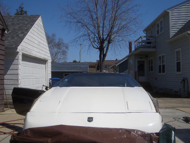

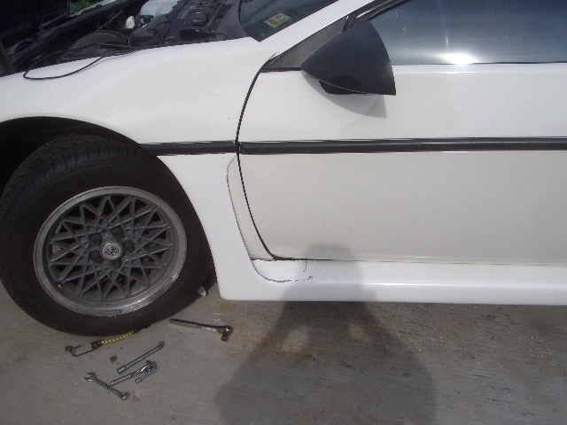

jetsnvettes2000 MSG #36, 05-04-2011 10:54 PM

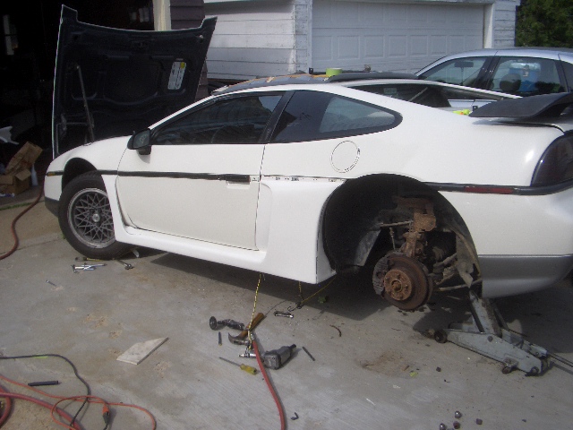

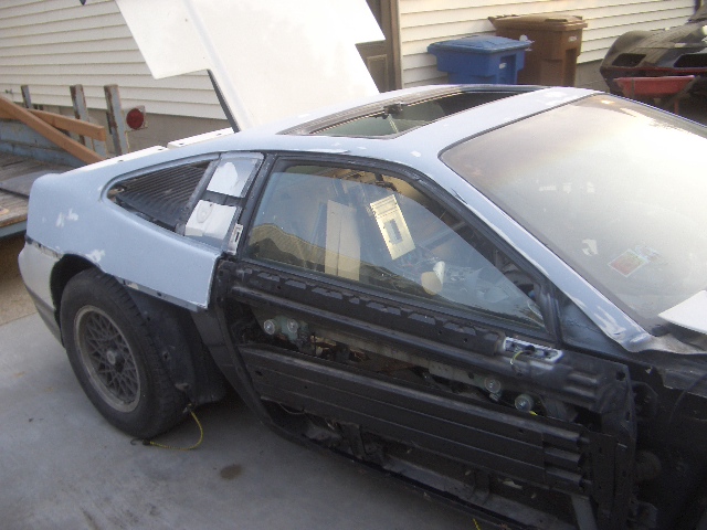

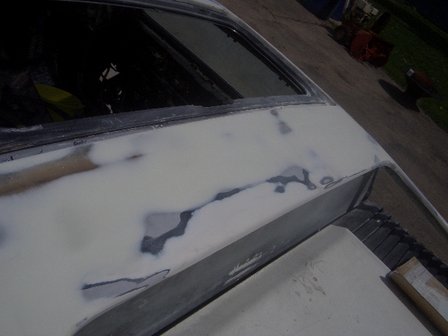

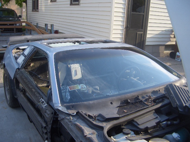

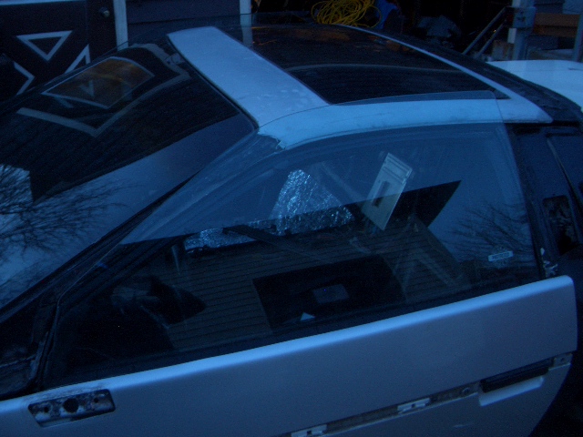

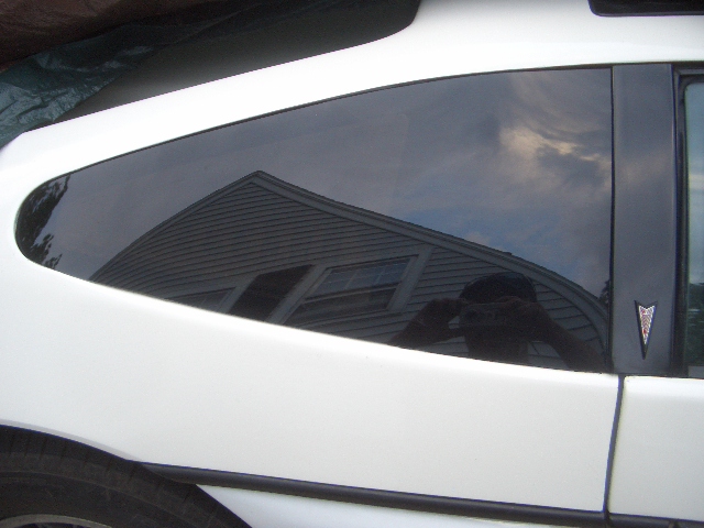

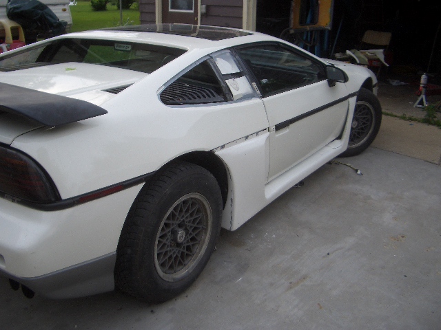

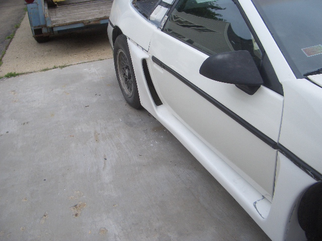

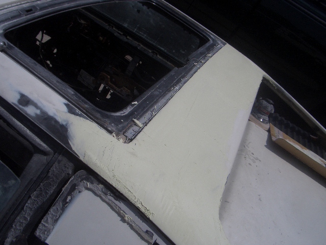

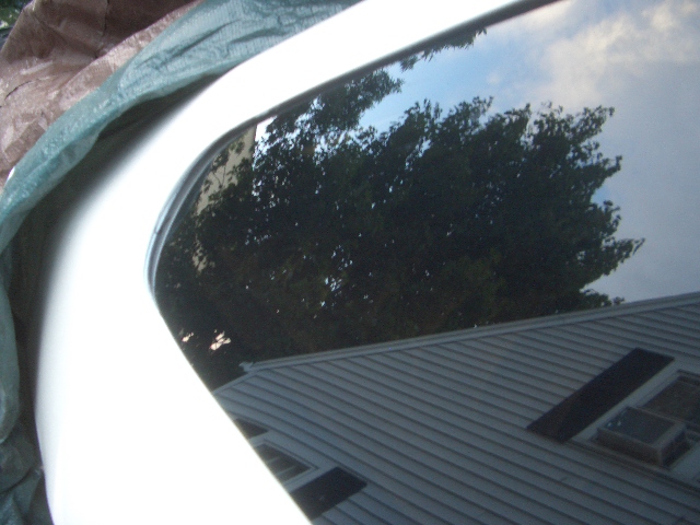

      So got alittle more done tonite, I modified the left track the seal sits in and fitted it. Tomorrow I will be doing the other side weather permitting!
Here you can see the diffrence between the stock window and the chop
[This message has been edited by jetsnvettes2000 (edited 05-05-2011).]

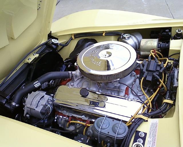

1988holleyformula MSG #37, 05-05-2011 12:04 AM
So cool to see such a well-documented homebrew choptop! Great progress.

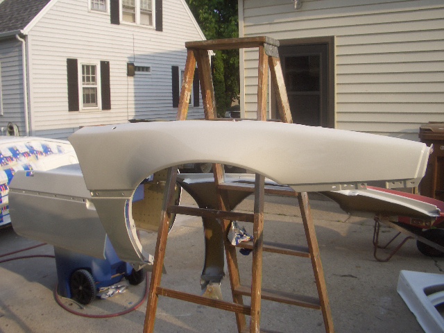

btw, do I spot IROC-Z wheels on a Stingray back there? That's gotta be a different look.
Foxy Fiero13 MSG #38, 05-05-2011 01:07 AM

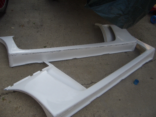

little dirty but all intact lmk if u want them i can bring them to u this weekend maybe
jetsnvettes2000 MSG #39, 05-05-2011 01:09 AM

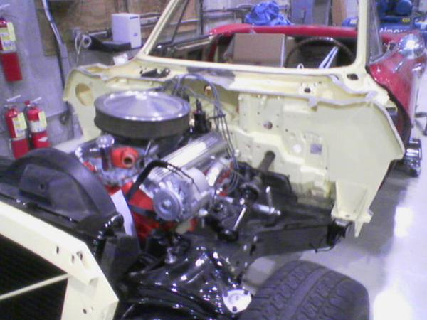

Yup those are 85 iroc rims they are just on the vette to move it around, I have the good original corvette rims in storage till the car is done. I have another vette in the garage also ass deep in restoration thats why the chop is being done out in the driveway I just ran outa room!
right now I have three corvette resto's going and the fiero chop.

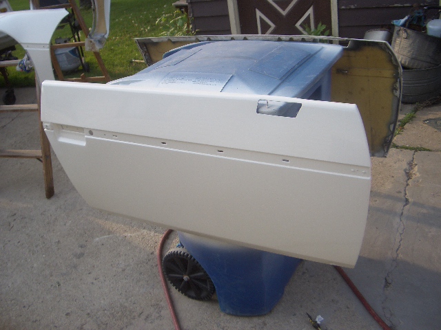

jetsnvettes2000 MSG #40, 05-05-2011 01:12 AM
Yup perfect!! Ill take them!! now just to find white door panels and my job gets alot easier!

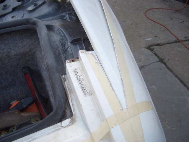

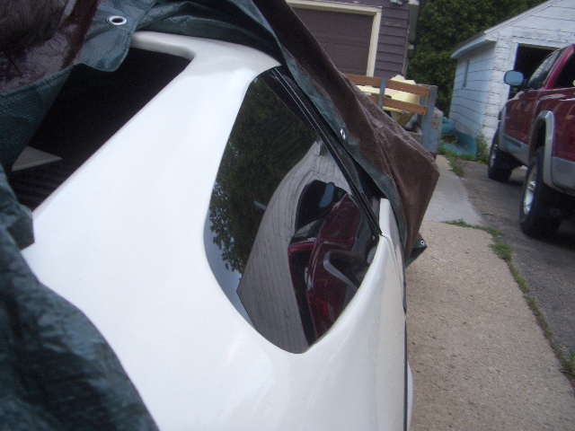

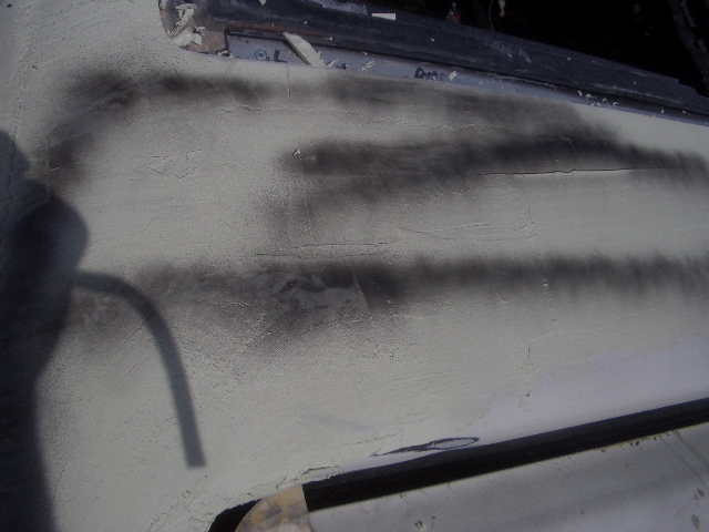

jetsnvettes2000 MSG #49, 05-06-2011 10:32 PM

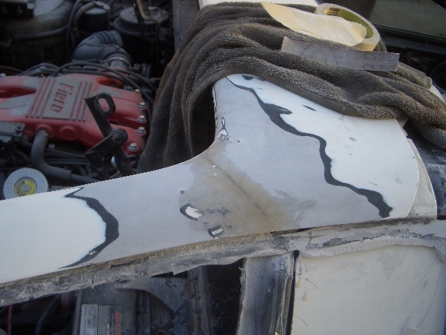

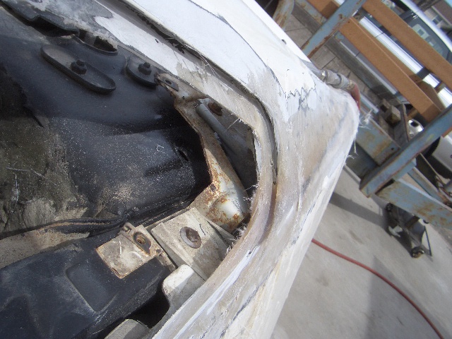

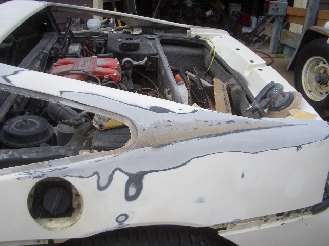

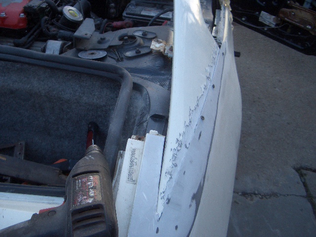

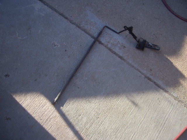

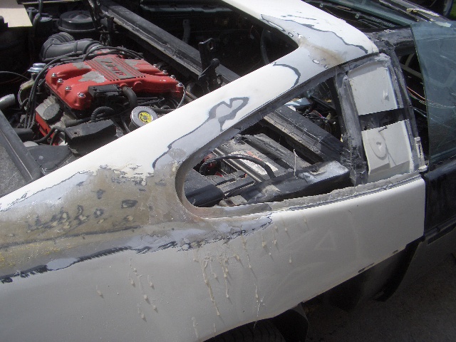

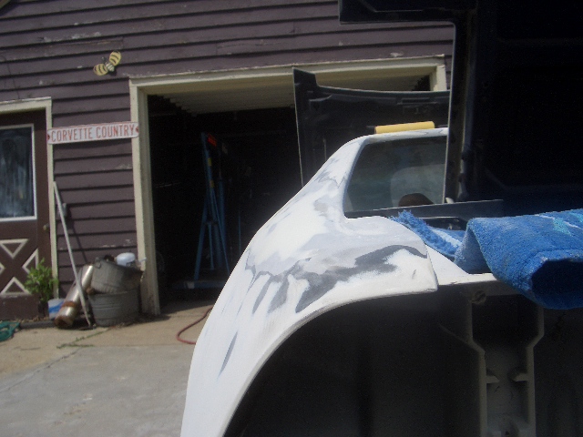

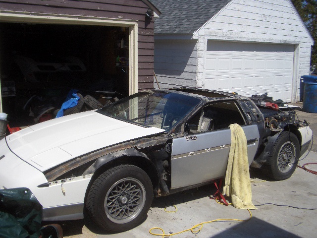

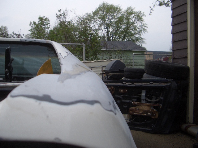

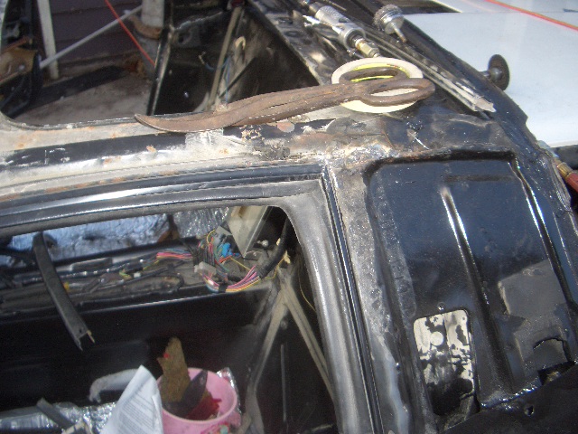

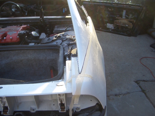

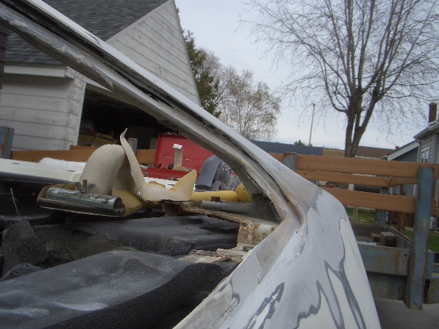

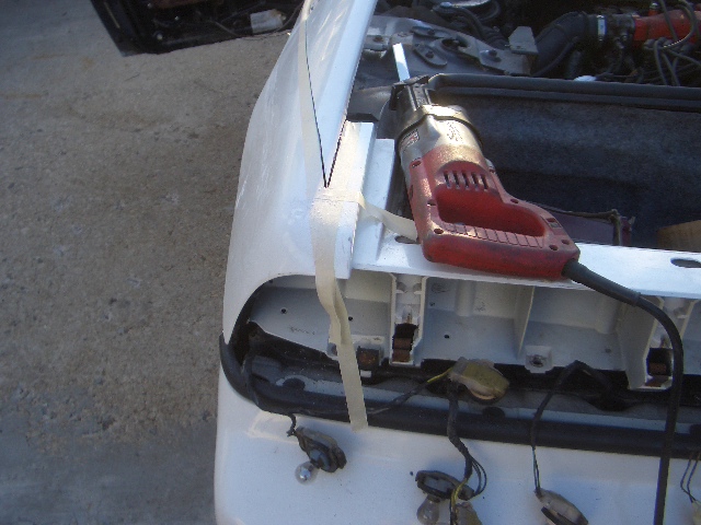

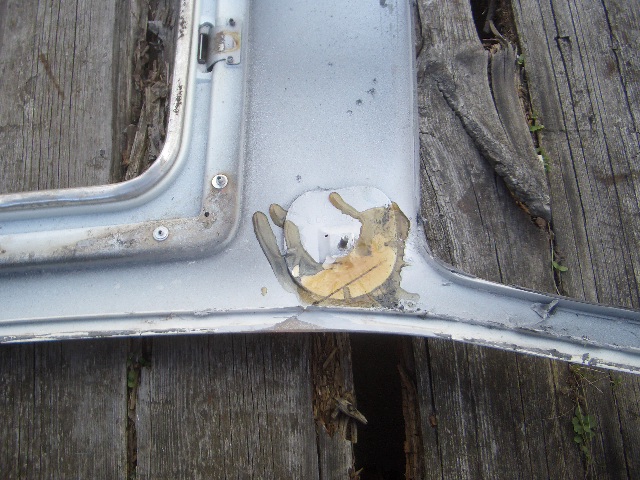

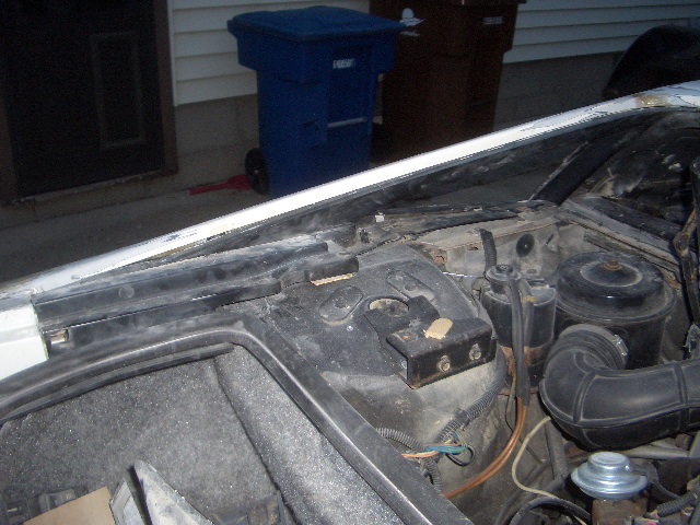

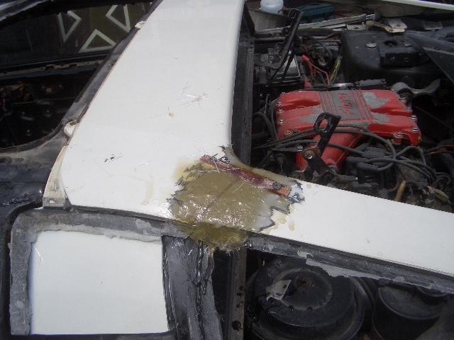

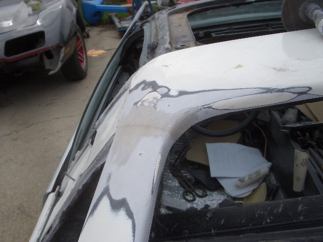

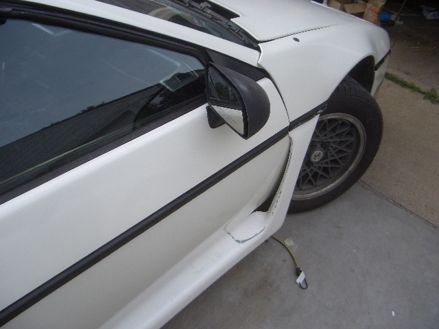

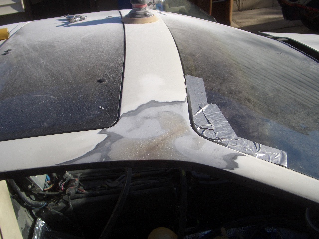

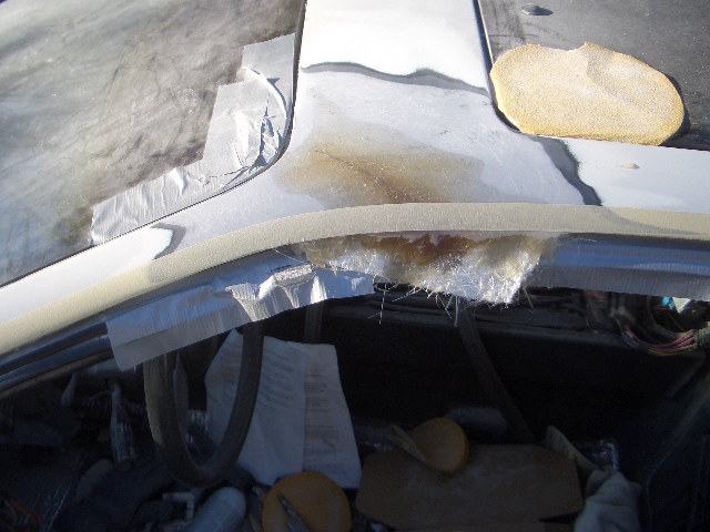

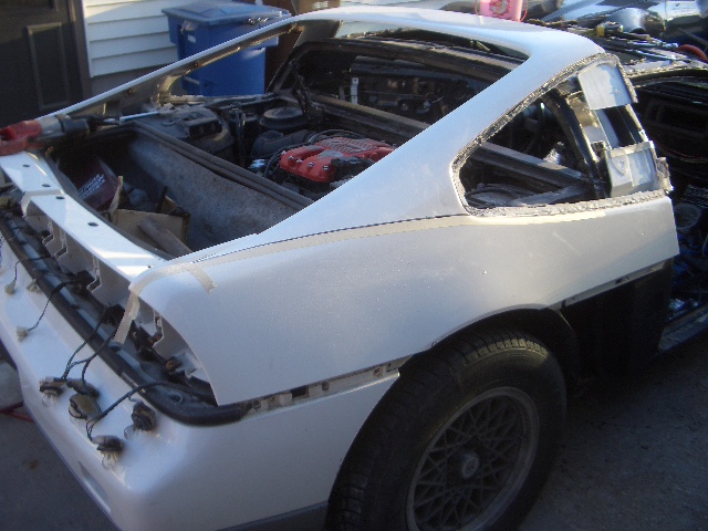

      OK, so I got a little further today. I started with changing the right deck lid hinge since the spring was busted, I figure it was a good time to change it since there is no back window in the way. It was really easy to change with a naked car! After that I started to work on the fiberglass and well I am not following the directions at this point.
I want a more boxed look towards the rear of the sail panel, kinda like a hip but more subtle and not a wide body. Also am doing the fiber-glassing different, since I am changing the shape of the sail panel totally I don't need to use the straps u commonly see in everybody's chop pics for holding the glass together. To bond my sail panel areas back on I will be doing it with a combination of 8115 3m panel glue and then fiber glassing them into the shape I am going for.
I haven't cut the roof part yet, don't worry it will be cut to match the angle of the forward roof I just ran out of daylight so had to stop for the night. Here are some pics.
Must have done it right the window fits!
the old busted hinge
first cuts

86soon3.4 MSG #52, 05-07-2011 07:28 AM

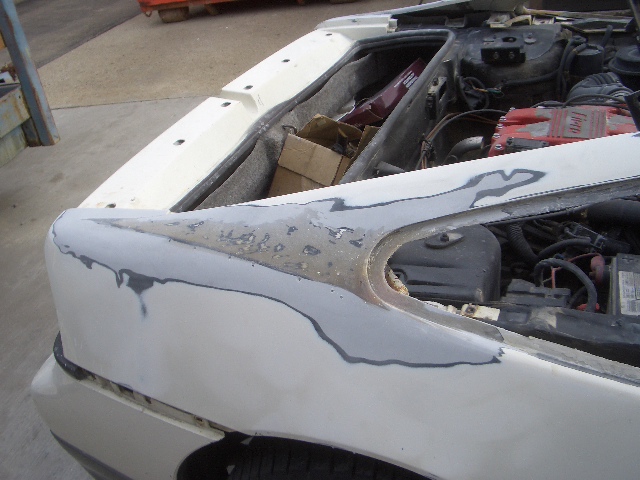

OK, so I got alittle further today. I started with changing the right decklid hinge since the spring was busted, I figure it was a good time to change it since there is no back window in the way. It was really easy to change with a naked car! After that I started to work on the fiberglass and well I am not following the directions at this point, I want a more boxed look twards the rear of the sail panel kinda like a hip but more suttle and not a widebody. I also am doing the fiberglassing diffrent since I an changing the shape of the sail panel totally I dont need to use the straps u commonly see in everybodys chop pics for holding the glass together. To bond my sail panel areas back on I will be doing it with a combination of 8115 3m panel glue and then fiberglassing them into the shape I am going for. I havent cut the roof part yet dont wory it will be cut o match the angle of the forward roof I just ran out of daylight so had to stop for the nite. Here are some pics.
first cuts
Ahhhh.......surgery. Got to love it!
Steve

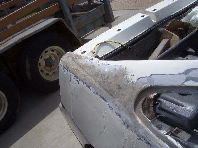

jetsnvettes2000 MSG #53, 05-07-2011 10:32 PM

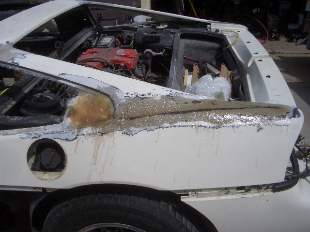

      Got even more done today!! I started doing more of the fiberglass and planing out how I am doing the sail windows different.
I am in the staged of ruff fiberglassin so its not pretty yet that will come later. I haven't decided how I am doing the back of the sail window yet, since the way I am doing it makes the window a little longer than a stock one.
I also got a new windshield today from Av8fiero and the window seal channel from the bone yard that I mesed up!.
Had to re bond the stud, it got stuck in spaceframe
Here you can see how I cut the top away to redo the angle so it lays right
this tye was pulled out too of the roof panel so I bonded in a new one
new windshield thanks av8fiero!
ready to glass
first layers of glass and resin
A huge tip, I use these all the time at work to mix resin in, its a jello pudding cup. My grandmother eats like a pack of 6 a day of these so she keeps me well stocked up at work and home with the cups. Buy your kids jello the cups work perfect! the tounge depressors are from a medical supply company costed 3 bucks for 500
final layer of glass
Right side just about done, needs a light skim coat of resin to fill a few air bubbles but otherwise done and shaped perfect!
Tomorrow I will be grinding down the other side and then starting on the back half of the sail panel area I think ill be mocking up the new form out of balsa wood to get the shape I want then ill glass over it pics to follow!
[This message has been edited by jetsnvettes2000 (edited 06-26-2012).]

jetsnvettes2000 MSG #57, 05-08-2011 07:16 PM
      Got alot more done today, I am beat I have been at it since 8 this morning! time to rest, here are some progress pics, I extended the sail panel window back about 1 3/4 inches. I did this because I wanted the window to match the profile of the car more and it deepens the factory hip a bit the way I bonded it and fiberglassed it. I prob need to do another layer of glass yet in spots but I have the general shape were I want it.
Looks like I have alittle fixin to do good thing I have the extra top panel.
More to come soon! well if it dosent start to rain again!
[This message has been edited by jetsnvettes2000 (edited 07-08-2011).]

I have been keeping track of the time, so far I am just shy of 50 hours but that includes alot of mechanical fixing mixed in with the chop, I am dividing my time, as the resin drys I fix somthin else thats broke or wore out, ya cant rush the resin or u weaken it. I would say to get it to the point of being able to start throwin it back together ill prob be in it 60 total hours for the chop end of it, I am doing a few things diffrent than a typical chop so Its going to make it take a bit longer.
If ya notice the back of the sail panel area I extended the curved part back about 1.75 inches, I wanted to reduce the width of the c pillars"?" base to make it look alittle nicer. I m planning on filling the gap with a hybrid notchy/fastback sail panel using the front part of a notchy sail panel cut down and re shaped a bit.

jetsnvettes2000 MSG #69, 05-15-2011 10:25 PM

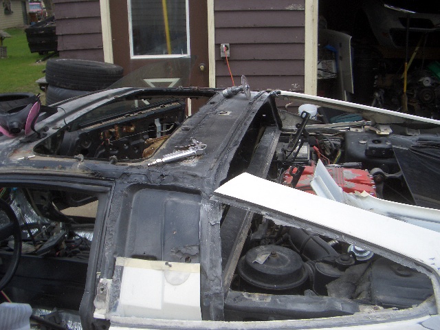

      Hey!! I got some work done today but as with any custom project I have ran into a few speed bumps I need to adress, I have a few ideas to fix it but I am open to suggestions so here are the pics:

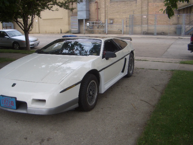

here is a pic of gtkieth standing next to the chop he is 6'4"
We had to fix the seal channel it was rotted out , luckly I had a a spare set
here kieth is helpin install the new seal channel
Here is were I cut back the rear clip for the roof panel to sit on, but here is also were I ran into a snag, now that I cut it back the roof fits and sits flush but, the roof flattens out in the middle a bit now and the sunroof glass has a bit of a arch to it, should I just shim the roof section to match the glass I will have further pics
U can see in this pic how I alterd the roof line just slightly diffrent from the others my sail panel area is about 1 3/4 longer than the other chops I didnt like the stock look so I rounded off the back of the sail panel area and will be making it so the glass lays flat in the new shape so I can add a scoop later on with the glass.
Here u can see how the sunroof glass bows higher than the rest of it, I need to figure out shiming it but I have an idea how to deal with it, I also noticed I need to do some trimming of the fiberglass on the bottom side of the rear clip, it is hitting a bit in the corner of the roof making it not line up right. its a easy fix just annoying now I need to take it back off yet again!
Here u can see the glass arch higher than the rest of the roof line in the middle I need to shim it I guess.

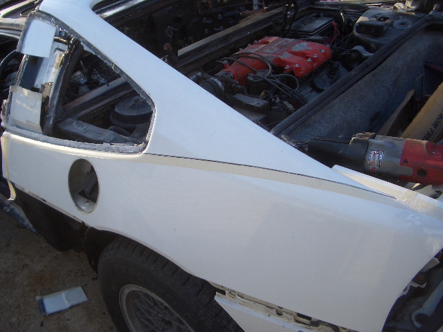

      Got alittle more done today, I went to the bone yard and picked up a nice set of sail panels from a notchy to cut up for my hybrid sail panel.
Here are some pics for ya, only two tonite I had stuff to do so didnt work long on it.
I laid alittle glass tonite too and started grinding it but it got too dark to take a pic so I will tomorrow of the aftermath of sanding
Here is my concept of the hybrid gt/notchy sail panel, I did this due to extending the sail panel area, the stock sail panel is too short so this is my way of making it longer, ill post better pics of how it all goes together tomorrow if I get time to work on it. The front part uses the stock mounting clip on the back to hold it down.

      Welll got alittle more done tonite, I was able to come up with a way to fix the issue with the sunroof glass and now I just need to bond the panel. Working hours tonite 2
The force is strong with this one tonite!
Begining the forming of the front roof
All done forming and ready for a skim coat of filler then on to highbuild
Forming the new radius
her ya can see the roof line as we reshaped it
Thats it for pics tonite, Tomorrow I wont be gettin much done on it I have to work on the house a bit.

jetsnvettes2000 MSG #81, 05-19-2011 11:27 PM
      Well howdy everyone!! I got some more done tonite, I glassed the back side of the roof panel to make it stronger, then I glued the floopy seam on the rear clip solving my issue of the sunroof glass! after all that I glued in the windshield and started workin on the inner sail panel trim parts a bit. I decided to not use the archie ones so if anyone needs a set I have some.
Here I ground of all the old glue junk so the glass had a nice surface to bond to
Here I added a bit of glass and resin to make it a bit stronger just in case.
Here I pumped 3m 8115 panel bonding glue into the seam to hold the shape I wanted, after it drys ill be bonding the roof panel to the lip I made for it to sit on, then I will be fiberglassing the seam.
glue in and waiting for the glass
On the back side of the glass if your going to install your own u really need to buy glass primer before u glue it or u take a chance of it not sticking right
This is the glass primer, u rub it on with a dobber were the glass urathane goes
this is the glue, its really expensive for a tube u will need two to do the windshield, also dont loose the little triangle shape rubber parts under the glass, they set the height of the glass.
Here the windshield is glued in and u can see the glue seam on the bottom of the window from the inside.
This pic is for me to remember to grind the weld so the roof panel sits in the groove better
Here I am test fitting the sunroof glass for the last time before I bond the panel, it finally fits right!
Gettin closer

      Got alittle farther tonite, the back glass in now in, I had to do alittle constructive hammering but at the end of it it fit! then I put the car top back together and bonded the roof panel to the rear clip!

      Got alittle more done today before it started storming yet again! geez what do I live in the jungle now? daily rain storms!!
New wipes via diy-stu
The glass is in but ran outa time before storm to adjust

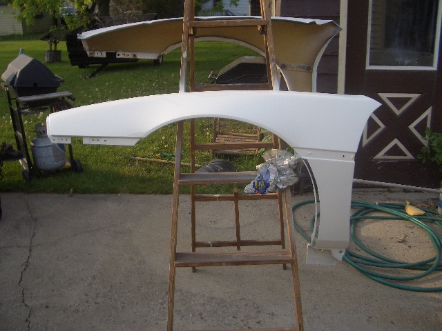

      Took a break from the chop tonite and let my daughters take a crack at some fiero doors, they did pretty good!! the doors are apart!

      Finally got back on the chop today, Had to take a week off from it to get some work done on the corvette in the garage. And now for the show............
Started the day off with mud work

jetsnvettes2000 MSG #97, 05-30-2011 10:19 PM
      Thanks!! oh for the ones keeping time I had 6 hours in it today and 5 a few days ago but with that 6 hours today I was stoped a few times to fix my brothers car real quick.
Here are a few more pics for ya
Yup the corvettes multiply like rabbits around here, the next project is on the body cradle behind the fiero next to the 77 its a 79 vette.
I think the seam delete looks good, I am glad I decided to do it!
[This message has been edited by jetsnvettes2000 (edited 05-30-2011).]

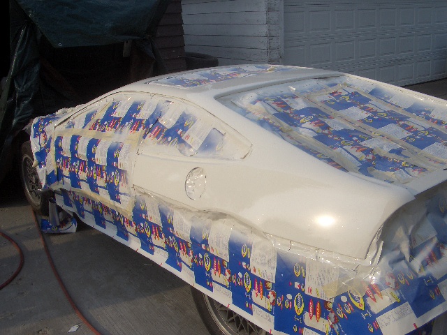

jetsnvettes2000 MSG #100, 06-03-2011 11:33 PM

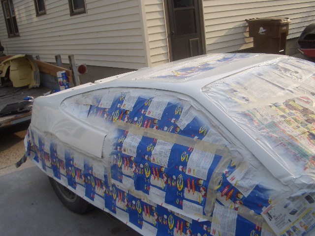

      Did alittle sanding tonite I think its about 98% ready for paint! I just need to fill a couple of bo-boos and time to shoot if the weather acts nice tomorrow
Next time I post pics I hope its of painted parts!
jetsnvettes2000 MSG #101, 06-04-2011 09:32 PM
      SO I said I woulnt be postin till its painted well.........
Ran outa base so these didnt get painted this time around grrr.
Tomorrow ill be able to finally start puttin some of it together!! but not too much tho I need to get the vette body back on frame tomorrow too!

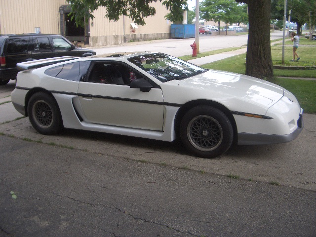

jetsnvettes2000 MSG #103, 06-19-2011 11:19 PM
      So I finally got back to the chop project tonite and started to modify everything for the interior. The head liner was really easy to mod to fit, all I had to do is cut it back about a inch on the fiberside and pull the backing board away from the headliner cloth, then I just simply folded it over the new cut line and done had it in in ten minuts!
the dash went in really easy too altho i had to wiggle it past the steering wheel a bit now that the windshield lays so far back.
I am hoping to have it done within the next two weeks with phase one of the build, next summer ill start phase two with new bumpers a engine swap and tail lights.
phase three will be a diffrent hood and possibly a wide body kit, I am not shure yet tho I kinda like the look it has now without the widebody. In the future it will also be getting a color change, the white is just temp to keep it all sealed up.

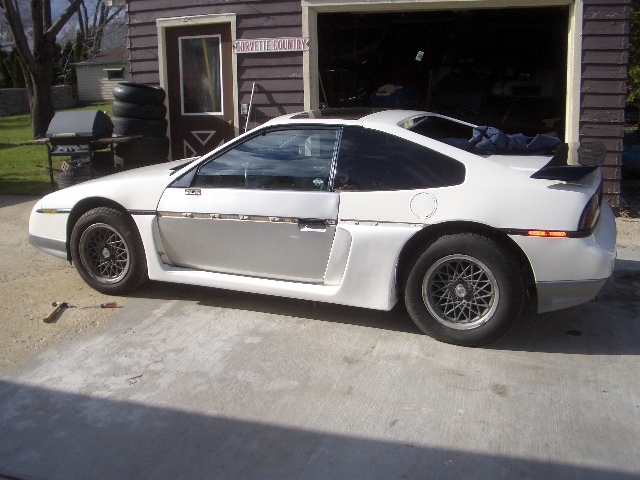

      Got alittle farther w the chop today, I spent most of it trying to get the rockers to fit better, they need Alot of work to make them look right and well I am picky so I have alot to do yet before I am happy with how they will fit in the end product.
[This message has been edited by jetsnvettes2000 (edited 06-25-2011).]

jetsnvettes2000 MSG #109, 06-27-2011 12:09 AM
      Well after a awesome day I think I finally made noticable progress in the interior! I had to take most of it all back out when I decided I wanted to do a black border on the back window to hide some of the glue and back side of the interior bits. I then got brave and decided to tackle my nagging sunroof seal issue and made a fat spacer for the clamp wich in turn seems to have finally done the job.
here are a few pics nothin much tho was so busy workin forgot to take pics!
I decided to add even more padding to my arm pad I made and boy is it ever comfy!
Av8fiero here is a pic for ya I managed to get the sunroof glass to conform to the seal!! boy is it under alot of tension!

      Got alittle farther tonite, I finished up making the sail panel trim panels but I am not verry happy with the fit. I ended up using the Archie parts after all but I need to do somthing about the back edge of the panels were they meet the rear clip, they are uneven and well I just am being picky. I am not bashin the Archie panel tho its not his fault they are uneven, the rear clip from the factory has some defects in it and it makes them apear to be off a bit ill fix that later when I give the car its final paint job.
I had a bit of damage fitting them too I knicked my temp paint up and chiped a bit of the corner above the rear window were the body curves around grrrrrrr guess ill fix that later on when I give the car its final paint job next summer. For now ill just fill in the problem with a bit of resin and touch it up I didnt think this paint would last forever and well I guess its thinner than I had first suspected, it chips pretty easy ugh! I am not a fan of chroma base its so brittle! prob coulda stood to give it a few more coats of clear, it prob would have held up to chips a bit better but free is free and I didnt have much to use.

here is alittle eye candy for ya of two of the corvettes I have completed over the years
this is a 1966 corvette vette rod I built
Thats my bud scott he was givin me a hand droppin the body
the 68 427 vetterod I just finished up 2 weeks ago

      Tonite I got alittle further and finished up the sail panel trim parts and painted them, then I started to prep the rocker/scoops for paint. Saturday I will be spraying the rockers and by sat nite ill be able to install them for the last time finally!
I can finally see the light at the end of the tunnel I think! I have a few water leaks to adress yet with the top around the windshield and I need some sail windows yet but all in all its almost ready for the road!

jetsnvettes2000 MSG #126, 07-05-2011 01:15 AM
      Lol yes I know I owe ya 20, will you be home tomorrow ill stop by with it!

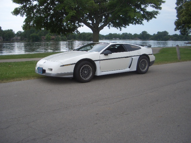

so today I decided i was going to make the car road ready for the 4th and busted ass gettin it done!
The overall progress is done now I just need to figure out a trim seal for the windshield, the one I got dosent fit well and I think I found a way to fix it using a 2001 grand prix gt rear window trim. Off o the bone yard in the morning to see if its going to work!
Yes I know the rockers are the wrong color the paint is just temp till next summer when I paint the whole car.
happy 4th everyone!
[This message has been edited by jetsnvettes2000 (edited 12-27-2011).]

Pete Matos MSG #130, 07-05-2011 07:40 PM
      Hey man,
How did you make those sail panels? Where do you get plastic material like that? I really like the way you did that. Was it pretty cheap to do in lieu of replacement ones? They actually look pretty damn nice. I wonder how hard it would be to try to mold the front edge with a heat gun to be at least CLOSE to factory look. I know I have bent a lot of plexiglass for stuff and it bends pretty easy. Mine look like crap and I still have a lot of body work to do to the car and it would be nice to be able to make at least that part look good until I get the car painted. Would you mind sharing your secrets/sources? Peace
Pete

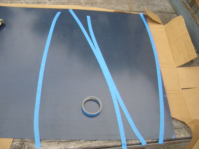

jetsnvettes2000 MSG #131, 07-05-2011 09:35 PM
Originally posted by Pete Matos:
Hey man,
Pete
Howdy!, the sail panels were way easier to make then even I expected, I got the material from Menards.
First I made a cardboard template that fit into the grove I made in the sail area.
Second I cut out the shape using my ban saw, a sawzawl will just destroy lexan id stay away from using one.
After a bit of sanding the edges I simply 3m taped them into place like the originals would have.
When I did all the fiberglass work I changed the angle of the lip the panel sits on so I could use a flatter piece of lexan without the need to have a extream bend in it, I then used a notchy sail panel front and cut off the back side with my ban saw.
The notchy sail panel has this little bracket built into it on the back, kinda a little tab thingy wich acts perfectly like a holder stop on the gt rear clip front edge were it used to be rivited to the body before the chop.
I simply slid the bracket on the sail panel front piece under the existing tab on the rear clip of the car and then held it all down w a bit of the 3m tape on the back edge of the notchy sail panel part ill post some close pics of it.
Back to the lexan, I then put the cut out part into its place in the car w the protective plastic on it and traced out the hole in the quarter u see thru making shure I was covering anything I didnt want to see. Then I removed the panel and pulled the protective tape on the other side and transferd the pattren thru the lexan w the tape and then taped out the center were I didnt want black out paint.
After all that I sprayed it w vynal and plastic paint so it would stick really good but, first I sanded it w 240 grit paper to give it good tooth. after it dryed I pulled my tapes and walla a perfect home made panel!
86soon3.4 gave me a aftermarket fiero store cheapo one and looking at it I relized all they do to make theirs is kinda how I did mine only they prob use a vynal sticker to get the dot matrix pattren before they spray it w the paint.
Far as making the front edge round over like the original it can be easily done w a heater bar, I have one at work, we use it to make machine guards with and I suspect the aftermarket makers use one to to form their panels. With my car, my sail panel area is about 1 inch longer than a stock one into the curve I did at the back so I needed to make a custom one and thats how I came to the hybrid notchy gt sail panel I created. Ill go out now and grab a few more close ups. they will be at the end of this set of pics I took today.
SO my first drive in a choptop, I first noticed its a b!itch to back up lol I need a camera but After I got it out of the driveway I started to notice things right away like on the hi-way cabin wind noise is crazy less than a stock fiero. I then started to play around a bit since my arm hangs out so far of the window and yes guys the heat off the back of the car is incredible at the back edge of the top! i can reach my hand back that far now and when I aproach the end of the roof I can feel the heat!
I then noticed I was gettin tons of looks and a thumbs up from a guy in a 911 lol.
custom sail by me!
I almost forgot to say the cost to make the sail panel. the lexan was 32 dollars the paint was 5 and the notchy sail panels I cut up costed 5 bucks at the bone yard and came out of a 88 the 84 ones will not work.
[This message has been edited by jetsnvettes2000 (edited 07-06-2011).]

jetsnvettes2000 MSG #147, 07-12-2011 07:41 PM
      Did alittle more work to the chop yesterday, after driving it for a few days now on the highway I had a really bad shake in the rear end, I discoverd the right rear tie rod was bad. I had a spare here I got from the bone yard and threw it in and walla the big shake is gone! now I still have alittle shake left yet but I think I have a tire outa balance.
On the photoshop thread my car got the workover and well I love it and I have decided this is going to be the color I paint it when I do the final paint on it! I was wondering tho what rims are these? they look so good I think next summer I am going to buy a set. I also need to know the tire and rim size so I get somthin that fits.
[This message has been edited by jetsnvettes2000 (edited 07-12-2011).]

      So over in the photoshop thread my car is taking on a wholenew look and I like it I am 99% shure I am set on a two tone blue after seeing this, Ugh this is going to be brutal waiting till next summer to paint the car after I am done doing the rest of the mods! does anybody have any idea who makes these rims? I defidently am set on them they just look too good to pass up.
The rendering as of today ooooo lookin good!

      Today I got back on the choptop and decided to fix a few lingering things it had issues with one being the brakes! The back brakes sounded like loose change clanking down the road and apon taking them apart I discoverd a jacked up mess. First whoever had the car before me put brake lines off somthin big like a truck and had hte hose corled up to make up the diffrence in size then the retaining clips that hold the bak pads on was missing ugh... well is fixed now and what a diffrence the car stops!
I have had a bit of a problem with the door skins, right at the back of the dor were the panel curls over on the top both door skins are splitting a bit, I guess I will be looking for a new set of skins next summer before I do the final paint job.
After gettin the brake mess delt with I started to change the motor mounts but only managed to get the big one done, it looked like rain so I gave up for the day.
jetsnvettes2000 MSG #154, 07-17-2011 12:32 AM
      Dang it the left rear brake is hanging up bad, I took it for a drive and by time I limped it home my rotor was glowin and it melted my valve stem a bit so now the tire is going flat geez! stuipd thing time for a gran am brake upgrade!

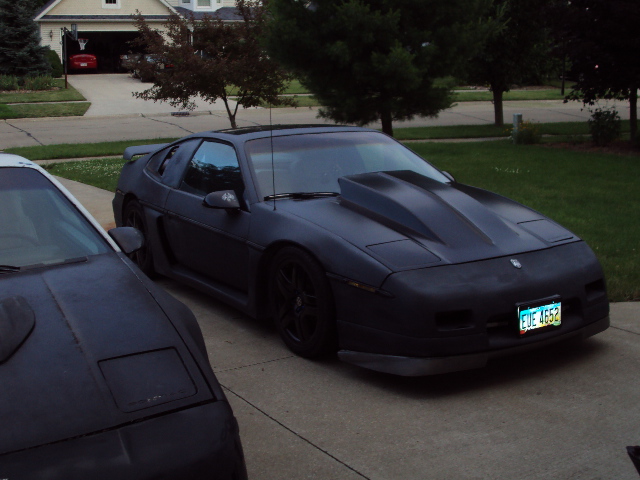

      OOOO look what I picked up for ol Robochop today! Intrax lowering springs! all nice and shiny fresh powder coating! I will be starting to put them in soon! I need to get off my butt and work the dells show is sooner than later!
[This message has been edited by jetsnvettes2000 (edited 02-04-2012).]

jetsnvettes2000 MSG #170, 06-20-2012 12:07 AM
      Finally, getting some work done again on ol robochop. Here we are redoing all of the suspension with poly and intrax lowering springs that were re powder coated black.
Cut down the bump stop a bit and re welded it for more room. I will then be making bigger bumpers to fine tune it.
We had one hell of a time with the lower A Arm bolts in the front, * hours later we had 2 bolts out!!!!
Finally found the shaking in the car, the steering rack shell was busted in half behind the mount so I could not see it. Scary!!!!!! I drove it to the dells and back like this!!!
[This message has been edited by jetsnvettes2000 (edited 06-20-2012).]
jetsnvettes2000 MSG #171, 06-22-2012 08:43 PM
      Well I picked up the car from the alignment shop today and well the lowering is done!!! no more pickin on me about it being way up in the air!!!

jetsnvettes2000 MSG #174, 06-28-2012 08:40 PM
      Ok I can do that, may be a bit dark tho its getting late! Hey Chris, no worries I have been hiding in the house the last few days instead of working on the Fiero and Vette, I hope to get back to work soon as this heat wave breaks!
jetsnvettes2000 MSG #175, 06-28-2012 09:28 PM
      Here ya go, a few pics from the side, Took a few of the wheel to fender as well
Here is a pic of whats holding up the progress on the Fiero. soon as it cools down I will be back on finishing up the engine then throwing the windshield in and starting body work.

jetsnvettes2000 MSG #187, 07-14-2013 10:32 PM
      Back to work on the ol chop finally!!!!!!! Todays fun was removing the engine!!
images.fieroforum.com/2012/CIMG7045.JPG">
The old engine, it will be going into another club members car and replaced with a nice fresh 2.8 for now. I could not pass it up a nice rebuilt powder coated engine for 200 bucks!
And finally the new engine!!!
