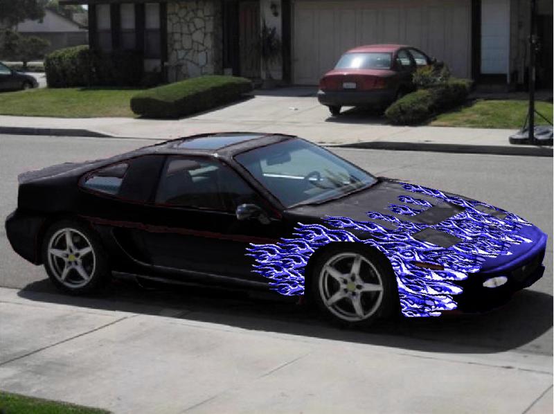

      very nice man... i could do a lowering in photoshop but my rgb colors are not working for some reason.

      sorry i tried doing the color for you but it didn't work... i guess i really need to learn how to use photochop. if you wanna buy me the photochop 8.0sc for dummies i'll get to reading and applying.

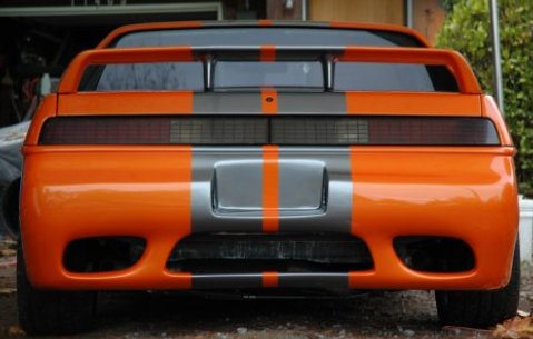

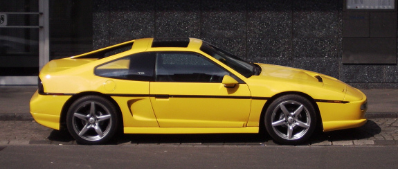

yellowstone MSG #33, 02-12-2007 08:43 AM
      I don't know but the concept applied here seems familar :-)
Originally posted by whadeduck:
exoticse (exoticse@netzero.com) MSG #34, 02-12-2007 11:01 AM
Nice side by side shots !
Wadeduck it is really coming along. The rear lip spoiler really adds something.
Yellowstone your car is fantastic as always, but i can't help but wonder how it too would look with the lip spoiler and some lambo doors.
Great job both guys !

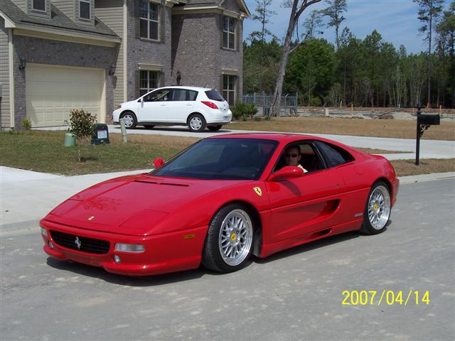

Not photo shop, but I thought this thread of Wmacs car might help. Yours should look real nice!
http://www.fiero.nl/forum/A...030531-1-024033.html
Forrest
whadeduck (richardjborton@gmail.com) MSG #42, 02-16-2007 10:49 AM
      Definately similar. His car is very nice and was actually one of the inspirations for mine. Thanks for the link.

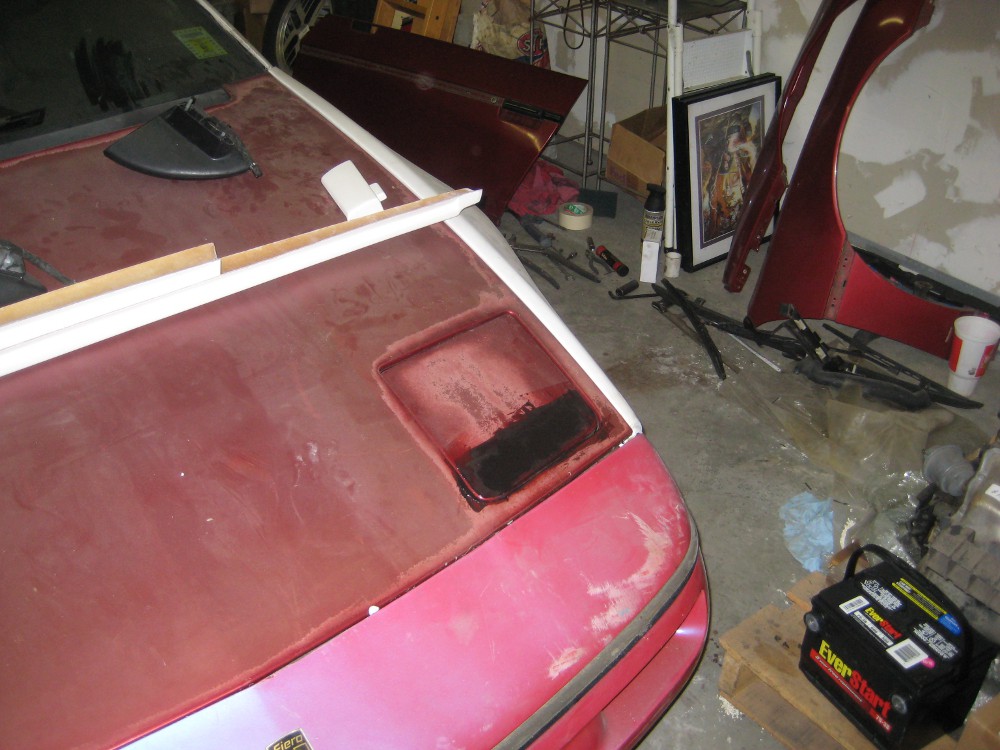

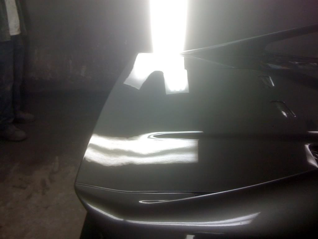

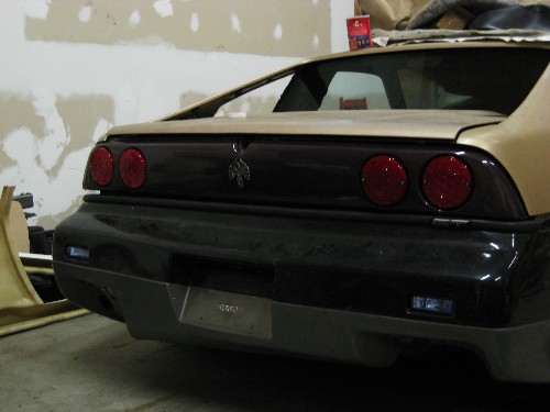

whadeduck (richardjborton@gmail.com) MSG #43, 02-17-2007 03:36 PM
      Just wanted to post a couple of shots I got today. Kind of liked the shot from the rear quarter.
And here's a closer shot of the rear lip spoiler for another member who requested it. Masking tape and all.

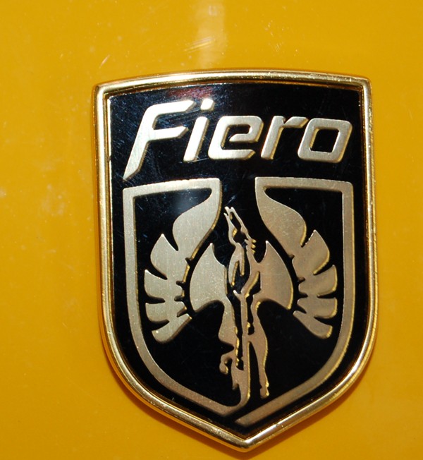

      I like what you're doing but I'm critical of the Ferrari emblem. I think you make a fool out of yourself and your Fiero. If you leave it off, you'll have a great-looking Fiero. With it, you'll have a half-assed replica. What's better?
I'll tell you a story: today, I parked my Fiero in a car park downtown. I hung around because I was waiting for the elevator and three guys show up. They notice my Fiero, walk over. One says: "Look, a Lamborghini!". The other says: "It says GT! What is it?". They circle the Fiero, look inside, look at the emblem on the nose: "It's says Fiero!". They clearly haven't heard of such a car before. They keep circling the car and talking about it. Then they leave...
I think that this was much cooler than having a fake prancing horse on your Fiero and people pointing out to each other that it says Ferrari but clearly isn't.
Just my opinion, please don't take it wrong.

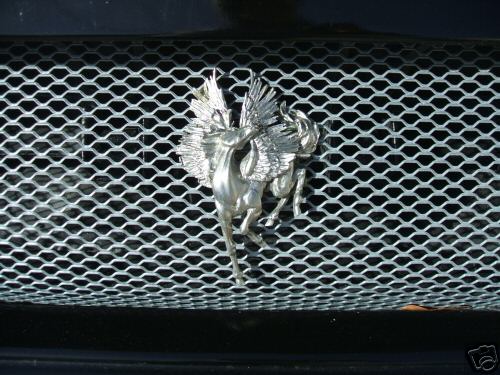

whadeduck (richardjborton@gmail.com) MSG #46, 02-17-2007 04:28 PM
      Yousa point is well seen. Gives me something to think about. Maybe I could use the Pegasus symbol instead. Nothing saying Fiero. Just the Pegasus. Maybe I could get F-I-E-R-O to work up something for me. That would keep people guessing. Especially if I had something using that new symbol of F-I-E-R-O's.
TorqueWench MSG #47, 02-17-2007 05:08 PM
      i agree, use the pegasus.

      Yeah, definatly lose the prancing horse. I was thinking about the lip spoiler, but I don't want you to think I'm trying to copy your car so I guess I can't now.

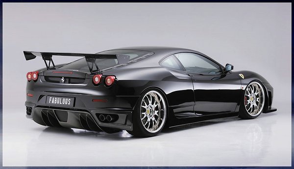

exoticse (exoticse@netzero.com) MSG #50, 02-17-2007 10:01 PM
Like most i agree,...LOSE THE FERRARI EMBLEM.
The car looks fantastic otherwise. Very good mods.

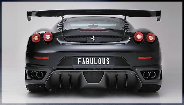

About the only other things i might consider are a ferrari style rear diffuser simlair to what blacktree or 4.9 have done.
I might also mold in the those side rockers.
Finally definatly LOWER IT, hehehe ,...but i see you are already on top of that.
Keep up the good work. Car looks great.
whadeduck (richardjborton@gmail.com) MSG #51, 02-17-2007 10:02 PM
      I can lose the horse. But I gotta come up with something to fill that big blank spot in the tail light panel. Just needs something to kinda break it up. Same for the nose. I know, I can come up with something like a prancing pegasus. That'd really leave people with a puzzled look on their faces. Anyone have a link to the what and how of the difuser? I want to leave the panels all separate though in case of future damage.

On the rear panel? Not sure I follow.
TorqueWench MSG #54, 02-17-2007 11:01 PM
      yes. an insert, along with the pegasus emblem, in yellow, framed in black.
break the grill/mesh in the dead center in the shape of the shield, into which will sit the emblem.
you get the look of the ferrari, with the identification of the fiero, with an added stylistic flourish.
[This message has been edited by TorqueWench (edited 02-17-2007).]
randye (randy@enerson1.com) MSG #55, 02-17-2007 11:04 PM
I concur with others regarding the Ferrari emblems. Lose em. It's a Fiero.
Next best thing is to leave it devoid of emblems and let them guess like Yellowstone related.
If you simply MUST have a something on that rear panel, consider doing what I was going to do when I had my Euro rear panel. Use the small gold Fiero nose emblem (1984-85 I believe)
You can snag a new one in the GM box on ebay or from Doug at Fiero Warehouse.
randye (randy@enerson1.com) MSG #56, 02-17-2007 11:12 PM
      Forgot to say that I'm liking your car more and more with every pic.
VERY nice job duck, you're on a roll.
Randy

      or if you wanted to stick with the Pontiac theme,
you could use honeycome hex mesh in a grill over the whole panel, and black out the panel. the taillight lenses would really stand out, as would the black against the red, and would complement the black in the fastback inner 'butress' inserts and vents.

exoticse (exoticse@netzero.com) MSG #65, 02-18-2007 02:40 AM
Diffuser ?
Something like this would be cool to go along with the theme u are running with !
Here a picture and a link to blacktree's thread and build.
http://www.fiero.nl/forum/Forum2/HTML/077457.html
Here is what fourpoint9 did.
http://www.fiero.nl/forum/Forum1/HTML/061545.html

yellowstone MSG #73, 03-01-2007 12:40 PM
      Actually, the nose on my car is similar but not the same as the "Dietmar" nose. You could say that they share ancestry. I never found out who actally made the first mold of this type of nose (the Germany 355 style) but anyways...
There *are* differences - but that doesn't matter since the vendor I bought mine from is no longer in business...
@Pacethis - have a look at http://www.yellowfiero.com/fiero_pix.html for more pix.
Originally posted by pacethis:
Okay guys, I'm assuming the front bumper is the 355...but looks better than nearly all others I've seen installed. How come most of them dip off so steeply, yet this one flows with the body lines... THIS IS THE ONE I WANT, WHERE DO I GET IT?
[This message has been edited by yellowstone (edited 03-01-2007).]

Australian (istworld_@hotmail.com) MSG #170, 09-23-2007 07:39 AM
      similar car for sale http://cgi.ebay.com.au/PONT...QQrdZ1QQcmdZViewItem
whadeduck (richardjborton@gmail.com) MSG #171, 09-23-2007 02:49 PM
      I've seen that one before. I think it was on Fiero.de.

Fiero1Fan (fiero1fan@fieros.eu) MSG #201, 11-13-2007 08:05 AM
      PM sent. What kind of logo are you thinking of using to replace the pony?
Do you have a good close up pic of the pony logo and possibly a pic of the logo you want to use?

whadeduck (richardjborton@gmail.com) MSG #210, 11-16-2007 06:49 AM
      I'll see what I can come up with and compare them. Don't want to just have the Fiero shield either. The only other update is that I got two 4-wire connectors in the mail yesterday from Painless. I'm using those to make connections for the instrument panel. Instead of eight separate wires, I'll have two plugs to undo.

      Whichever nose I put on the car, I'm going to try to build a grille similar to the 355's and put a mesh grille behind it. Any suggestions on how to build one? I'd like to build it out of aluminum. But I want to paint it black and I thought I heard that aluminum doesn't hold paint very well. I probably heard wrong. =\ Oh yeah, and I can't weld so that option is pretty much off of the table.
I like this grille because it'll put the new emblem where everyone will see it. If I stick with just a mesh in the grille opening, the emblem will be kind of tucked away. Opinions and suggestions are welcome as always.

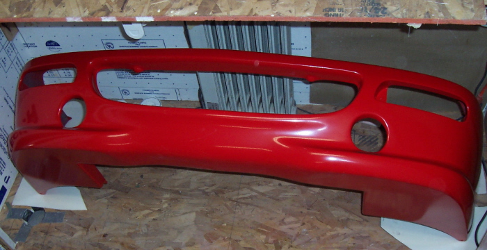

Look at what's coming out of the oven. Fi355 nose #!1 is finally painted & going onto my Formula test mule today. Building a jig right now for the grills and that will finally complete the design work for this new nose.
x
x
Newbfiero (bobby_0958@hotmail.com) MSG #299, 04-11-2008 12:40 PM
      Nice work Amida

      Whos tail light panel do you have and how do you like it?
whadeduck (richardjborton@gmail.com) MSG #314, 06-12-2008 07:32 AM
      I'm using Kenneth Hines generation-one panel. (www.kahines.com) Bolts right in. Top quality piece.

Swedish Fiero (fiero@live.se) MSG #341, 10-20-2008 12:48 PM
      Whadeduck... Were did you buy the Steel Pegasus that you have on the taillights in this picture ??

whadeduck (richardjborton@gmail.com) MSG #343, 10-27-2008 05:57 PM
      The Pegasus on the back came from F-I-E-R-O. But he's not making them anymore. Progress on the interior is slllllllooooooowwwwww. Got sick for a little while and other things keep take up my time like my job and family. But I should be able to get back at it soon.

I want one of these F-I-E-R-O steel Pegasus emblems
Anybody knows of anyone who has one for sale ?
Sharkman MSG #355, 12-09-2008 06:38 PM
I'm thinking I fried the power mirror switch in trying to hook it up the wrong way several times. But I'm sending the panel back to Amida (Rob) tomorrow. He said he'll check it out and replace the switch if needed. So that leaves me to do other things on the car. Like wiring up the new backup lights.
Where did you get those backup lights. web adress?
whadeduck (richardjborton@gmail.com) MSG #356, 12-09-2008 07:04 PM
      Click here http://spacecoastfieros.com/lindsey/ and go about half way down the page. He includes the lights and wiring. Really easy to do.

      While I haven't got anything done worth taking a picture of, I had a new paint idea I wanna see how it'll look. EMC209i did this mock up for me by painting it black and puting the C6 mirrors on it. Here's my idea. Black with a very subtle blue/white/silver real flame pattern. Anyone up to the challenge to see how that'll look? Also, the front turn signals are amber.
Amida (robert.kusakabe@comcast.net) MSG #367, 12-15-2008 12:29 PM
      That photo has too much shadow in it, try using a better shot with the car in better lighting.
85SEnochie (eqoflife@hotmail.com) MSG #368, 12-15-2008 12:44 PM
      Flame on here is a quicky are you thinking of something like this? If you have a picture of what you would like for a flame job post it and I will try again.
[This message has been edited by 85SEnochie (edited 12-15-2008).]
Sleek (blaster2008@aol.com) MSG #369, 12-15-2008 12:54 PM
      Please please don't put flames on that car.
whadeduck (richardjborton@gmail.com) MSG #370, 12-15-2008 01:06 PM
I was thinking more around the very front of the car and very subtle. Something you wouldn't really see unless you were within ten feet or so of the car. I don't know if you could even get it to show up.
whadeduck (richardjborton@gmail.com) MSG #371, 12-15-2008 01:07 PM
Because it's not my car (It's MaxQ's), I can't really get a better shot than that. Would it be better to start with the red version?
85SEnochie (eqoflife@hotmail.com) MSG #372, 12-15-2008 02:21 PM
      I could not get my program to make it transparent so I brought it more to the front and maybe a little less decal?

I'm not a flame guy, but if you make it subtle enough, like a ghost image, where you'll need to do a double take before you notice it then that'll be cool.
whadeduck (richardjborton@gmail.com) MSG #376, 12-19-2008 05:19 AM
      That's what I was thinking of. May be really difficult to do in photoshop though.
Is this what you're looking for?
Let me know it you like it/can't see it/etc
Amida (robert.kusakabe@comcast.net) MSG #384, 12-24-2008 12:47 PM
      Black looks good, or even black purple.
fieroboom (fieroboom@gmail.com) MSG #385, 12-24-2008 04:38 PM
For the color of the car...?
Are you saying black car & purple flames, or black purple, as in the awesome really dark purple for the car?
whadeduck (richardjborton@gmail.com) MSG #386, 12-24-2008 07:31 PM
Getting there. That's pretty much what I was thinking about. Keep working your magic.
Amida (robert.kusakabe@comcast.net) MSG #387, 12-25-2008 01:36 PM
Really, really dark purple...almost black with ghosted purple flames. Wouldn't that be cool?
Tony Kania MSG #388, 12-25-2008 02:21 PM
      My 89 Mustang might be that color. Was always called purple, black, blue, etc...
whadeduck (richardjborton@gmail.com) MSG #389, 12-25-2008 11:27 PM
      Wanna keep it black or red. Keep in mind that I have to keep colors that will go with the tan and black interior. One idea I'm throwing around is having it wrapped too. The flames might be easier to do that way too.

      Some updates. Working on getting the nose mounted. Ran into a little snag. When I initially mounted the top part of the nose, the wider fiberglass fenders didn't line up. So I checked everything out by removing the new fenders and reinstalling the old stock fenders. Then everything lined up. So, after reinstalling the new fiberglass fenders, I commenced getting everything to line up. What I found was that the driver's side fender was warped. The passenger side is fine. So Paul (War Hammer) recommended that I clamp the fender in the appropriate position and then hit it with a heat gun. So far, so good. The fender is relaxing under heat. Then, once it cools, it's in a better position than before. I want to go through the heat/cool cycle one more time and then it should be good to go. I also want to add some metal backing along the beltline between the fender and nose to aide alignment and support.

Originally posted by Sharkman:
I think this is the best one
If the car in red had wide rear IMSA fenders on it with that color it would be Fiero p0rn .

CETICARS MSG #399, 06-03-2009 05:08 PM
Wow. Just saw the last time I updated. Anyway, here's a little something I did today. Won't get a chance to work on it tomorrow. Gotta go outta town for training. I finally got the tail light panel back with the carbon fiber on it. Got the LED tail lights all hooked up too. I also have Fiero1Fan's third LED brake light. Everything's REALLY bright.
trying to find one of these tail light panels
[This message has been edited by CETICARS (edited 06-03-2009).]
Scipio MSG #400, 06-03-2009 05:32 PM
      http://www.kahines.com./
Or another alternative.
http://spacecoastfieros.com/lindsey/gtstyle.html

whadeduck (richardjborton@gmail.com) MSG #439, 10-30-2010 07:45 PM
      Whadeduck has a lot going on right now so I thought I would post a couple of pics.
Pontiac filled in with panel adheasive. (This stuff is tough)
Work that has been done on the rear of the car. (new spoiler and back bumper installed.

2Sly4U MSG #454, 07-29-2011 02:39 PM
      Hope this inspires you to keep going. I am new to the forum, and saw your post asking for some photoshop work. Maybe this gets closer to what you are looking for.
whadeduck (richardjborton@gmail.com) MSG #455, 07-29-2011 08:08 PM
      Wow! Nice work. I haven't decided on a color quite yet. I'll obsess over it more, see a therapist, drink heavily, then come to a conclusion about what color to make her. So I may call on your mad skilz later on. Welcome to the forum.
Amida (robert.kusakabe@comcast.net) MSG #456, 07-30-2011 01:25 AM
      I like those rockers.
BlackThunderGT MSG #457, 07-30-2011 05:10 AM
      Wow that fire is awesome!

2Sly4U MSG #461, 08-09-2011 02:59 PM
It is called "True Fire" by Mike Lavallee. Check out his site http://www.killerpaint.com

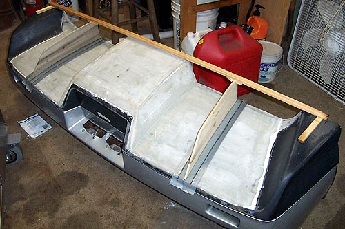

War Hammer (oldsouthphoto@yahoo.com) MSG #478, 10-26-2011 09:51 AM
      Richard "Whadeduck" isn't the only one giving Ferrario some lovin'.
Here is some of the spoiler work I have been doing for him.
I am installing a MadArch spoiler on Ferrario to give it a slightly more aggressive look than the sage one that he had before.
First I bonded the spoiler on using structural adhesive. The 2 layers of mat and resin on top.
Next I will glass the bottom and sides.
The end caps will take the most work as they were designed for the wide body. I will have to cut them up an reshape them.
I will keep you posted.
Paul
