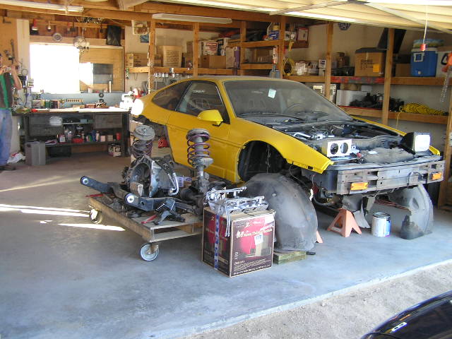

      I have owned my 87 GT since i was 14 years old and i decided that the 3800SC was a good place to start a build thread on my car. I bought my car 5 years ago as a bone stock 87 GT 5 spd. Below is a pic of what it looked like when i picked it up in Dayonta beach FL.
Me and my dad decided that we would completely rebuild it from the ground up.
On its way to the paint shop
After the paint
This is when it still had the stock 2.8 in it

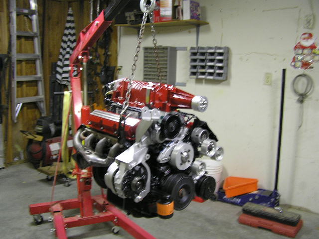

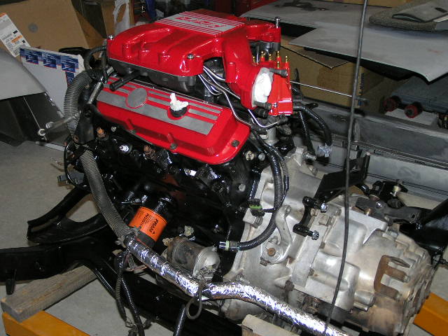

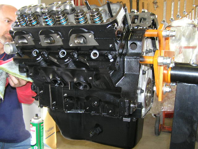

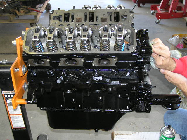

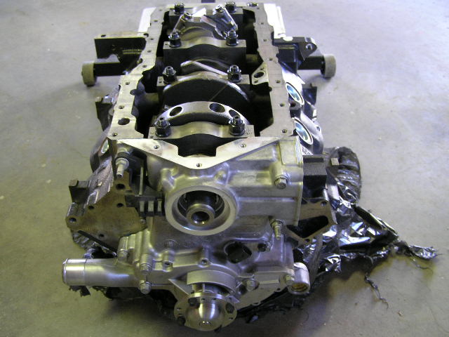

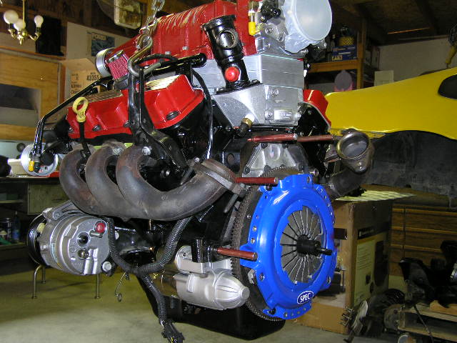

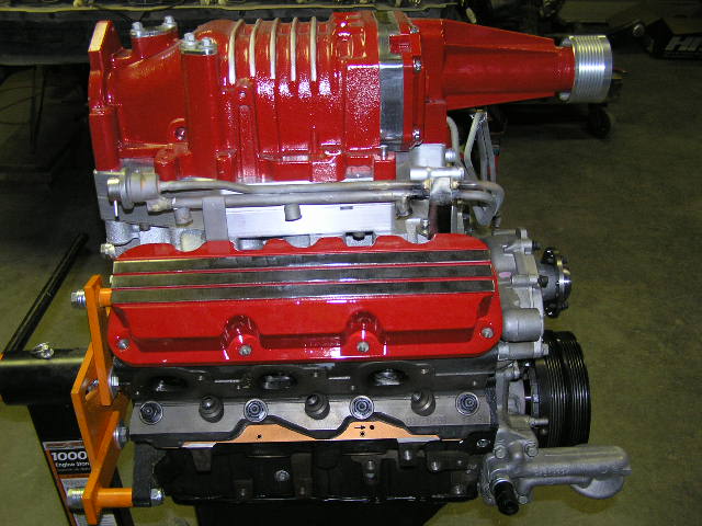

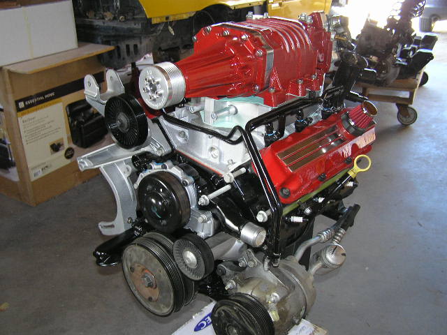

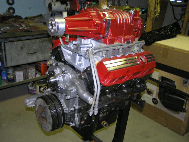

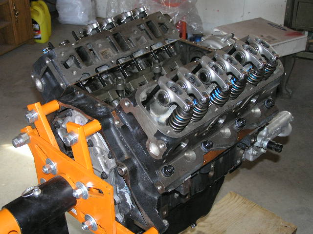

      This is when i decided that it was time for a engine swap so one year ago i started looking on carparts.com and i found a 3800SC close to me that had 45,000 miles on it. So i went and picked it up. The engine came with everything but the PCM and wiring harness. It came out of a 99 buick regal. So i tore the motor down and had the short block completely rebuilt with ARP fasteners throught and clevite 77 bearings. I also had the shop port and polish the heads. They flowbenched the heads and they came out equivelent to the ZZP Stage 3 heads. Here are the pics as of tonight what we have got done on the motor. There is a list of mods also.
Speed Pro Moly Rings
Balance shaft removed
Rollermaster double roller timing set
XP cam (520" intake, 536" exhaust)
Comp Cams pushrods
Comp Cam modified retainers
Comp Cam valve locks
Pro magnum roller rockers
Comp cam OE-R lifters
ARP Head studs, main studs, rod bolts
Clevite 77 bearings
4 layer Cometic gaskets
ZZP Stage 3 heads
130lb springs
Ported Intake
balanced & blueprinted

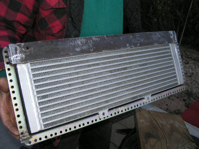

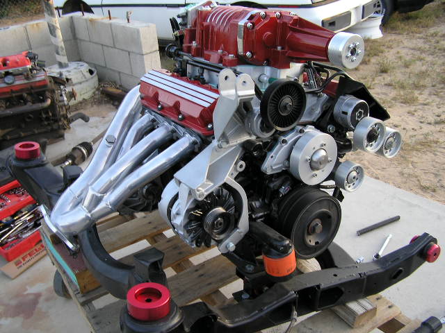

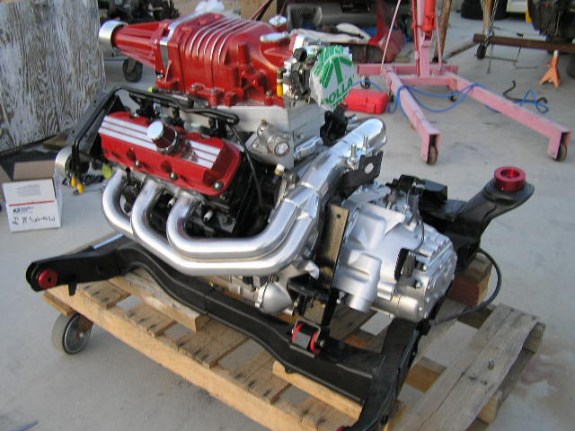

ZZP Stage 2 Fullsize Intercooler
Ported intake
42lb Lucas injectors
Custom fuel rail
Autolite 103's
MSD wires
Triple Edge inlet and outlet ported M90
Northstar Throttlebody
3.0 - 2.55 Supercharger pulley
8 Rib Blower belt
85 mm Maff
4" CAI

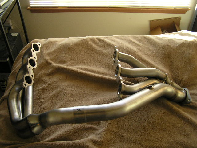

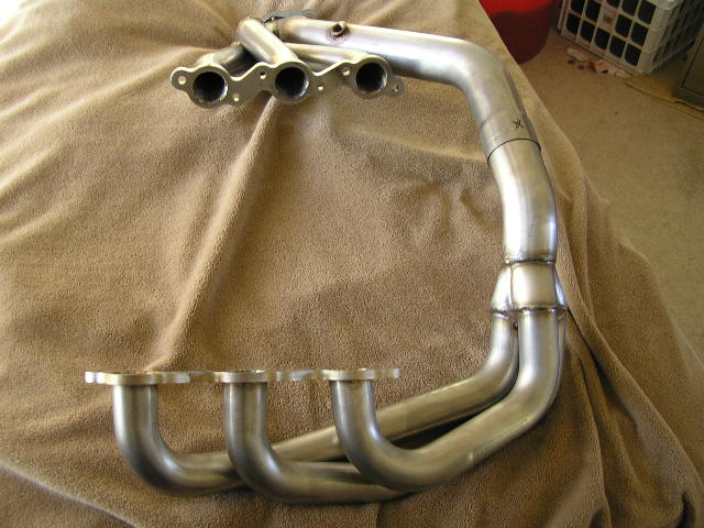

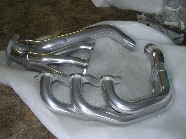

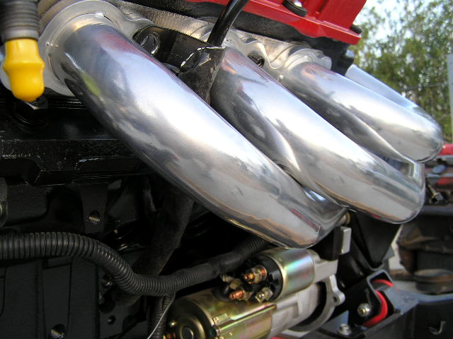

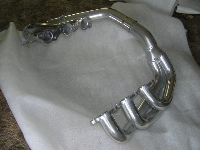

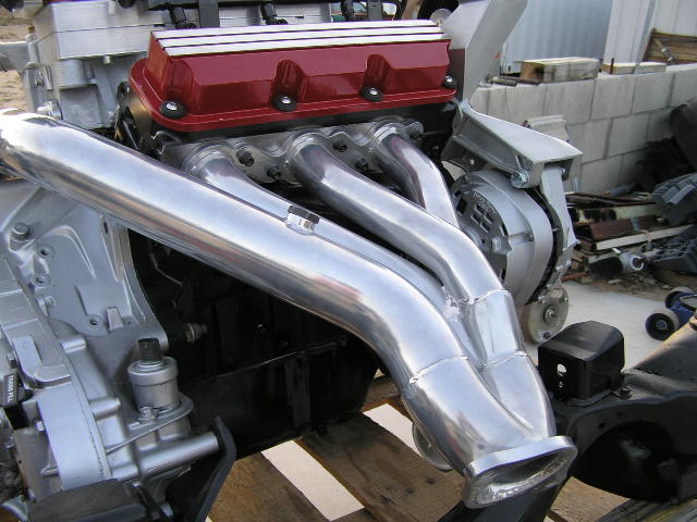

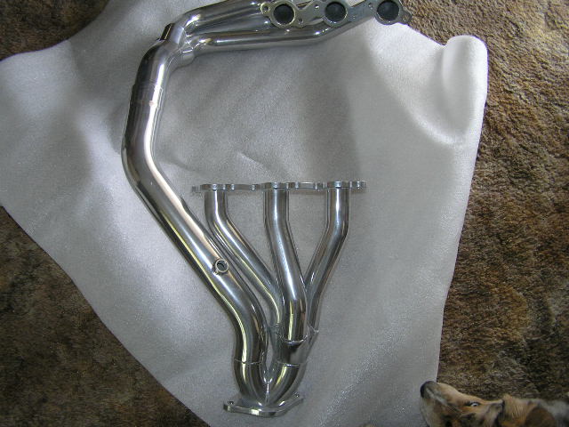

Pacesetter Headers
3" madrel bent exhaust, hooker aero-chamber muffler
Custom PCM by Loyde at Fastfieros

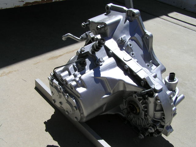

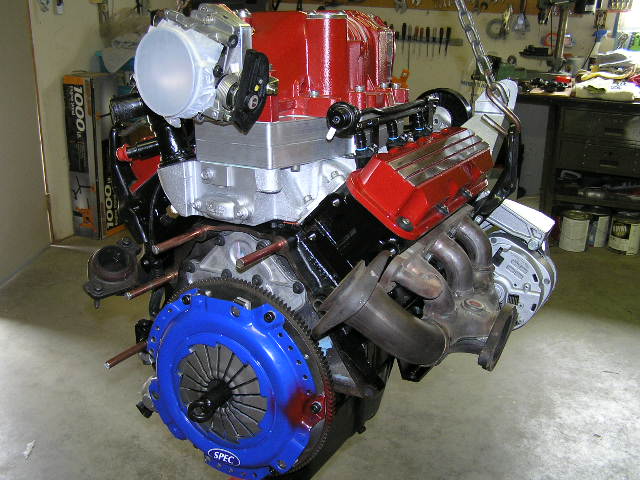

5 Spd Getrag with Spec Stage 4 clutch

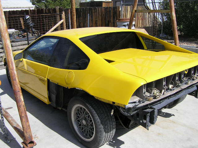

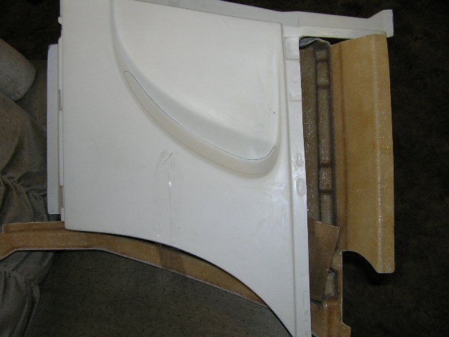

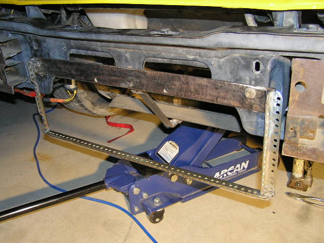

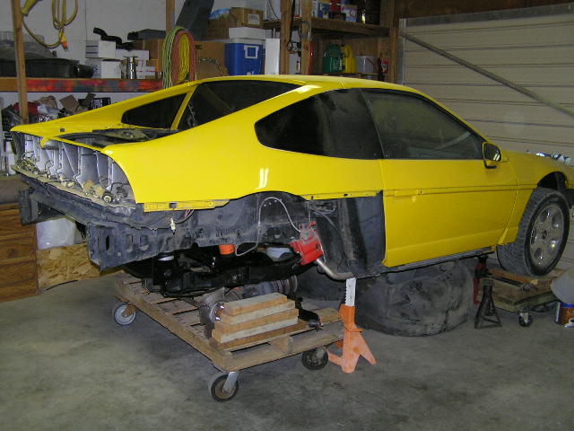

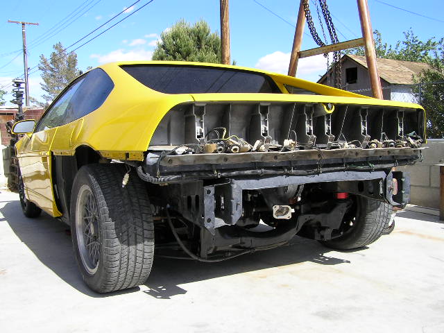

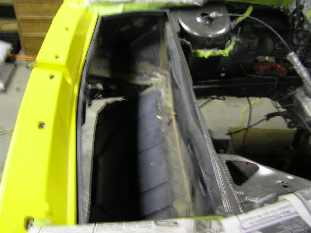

Here are pics of the trunk while in progress of cutting the bottom out. We basically cut the back out and then folded the front section up into the trunk to make the flat floor all the way across now. More pics when i get it sealed up and re-carpeted.
ignorant prodigy (ignorantprodigy@aol.com) MSG #4, 02-17-2008 09:32 AM
      do you have bigger valves for your ported heads.. if so what valves are you going with?
Friend of mine had the 130# springs with aftermarket valves and the valves failed.. creating all kinds of damage

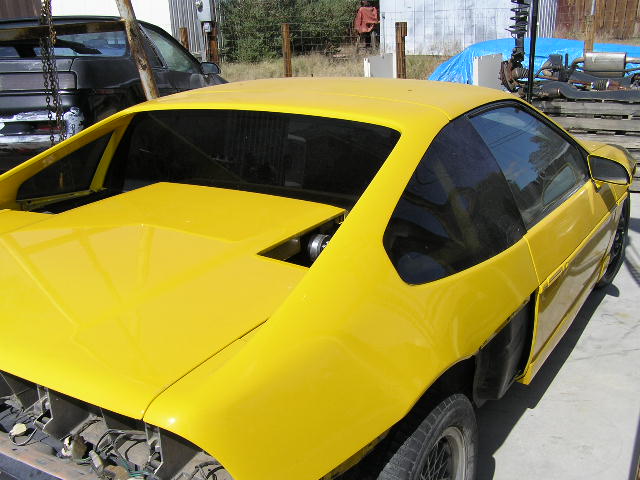

      Wow, the car looks fantastic in yellow with those wheels. Nice engine work as well. That thing is pretty frickin' sweet...for a v6 car that is...jk jk NICE WORK!!!

      ignorant prodigy-I am using the stock size valves and they are the stock GM valves. I was going to upgrade to manley severe duty valves but then i decided that i am waiting for the ZZPerformance Stage 4 alluminum heads to come out so i didnt go to larger valves.

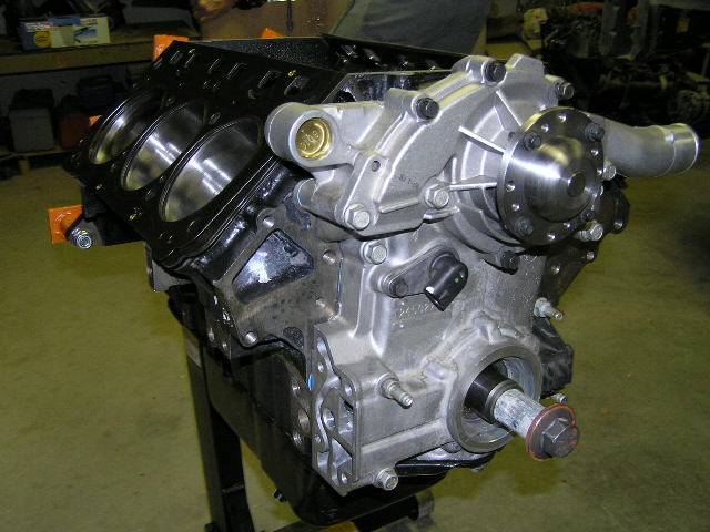

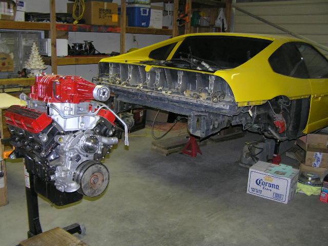

daniel87fierogt (dltraylor@hotmail.com) MSG #12, 02-20-2008 03:38 PM

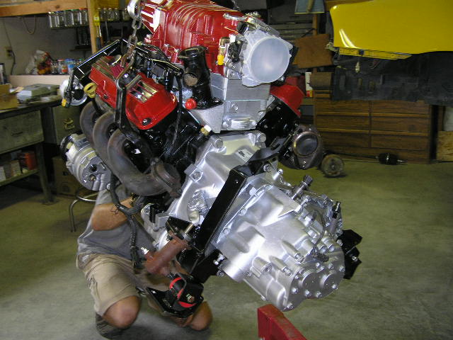

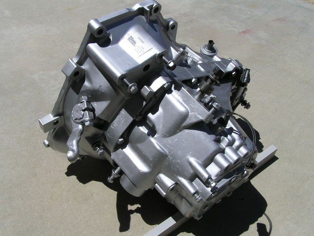

      I am going to be posting a bunch of pics on friday and saturday. We are going to be mating the engine and trans together and then mounting it on the cradle.

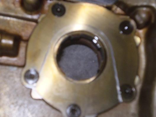

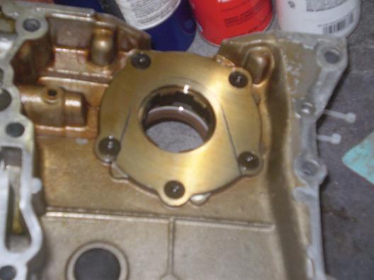

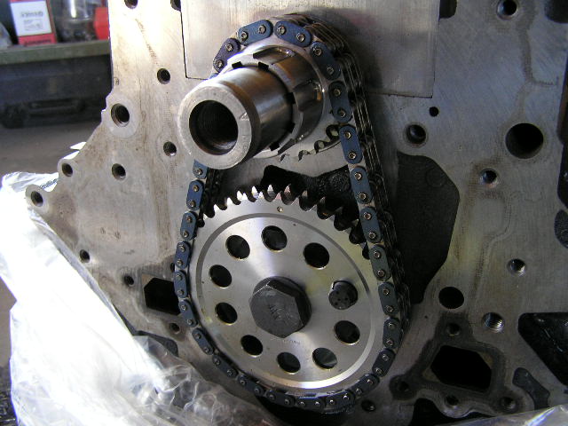

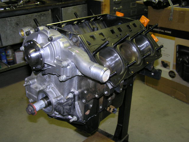

      Did you have the block machined for the increased oiling efficiency? I hear there are issues with casting flashing in the front cover, and that the oil supply holes for the center mains are smaller than they should be.
What did you do to block of the oil supply after removing the balance shaft?
Build looks great!!

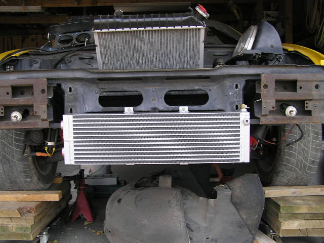

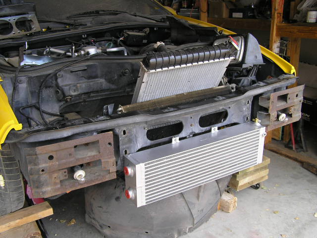

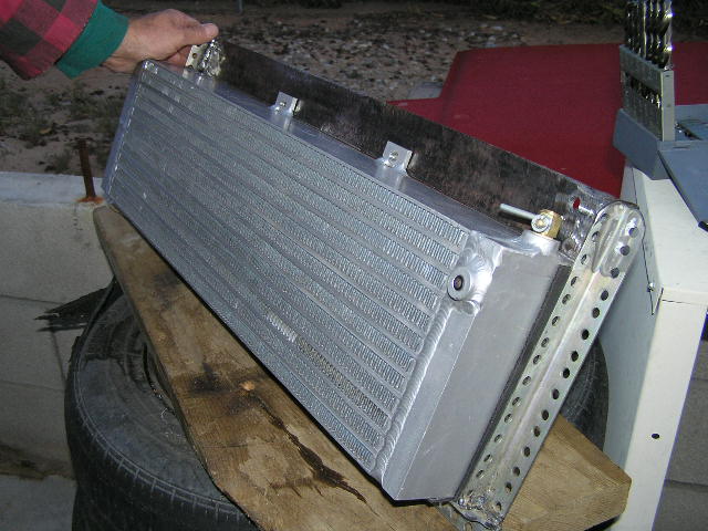

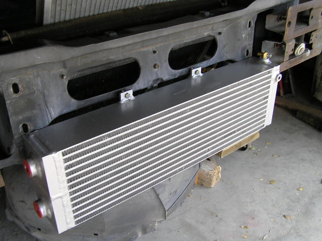

EDIT, can you please show install pics of how you plumb your intercooler?
[This message has been edited by Jncomutt (edited 02-20-2008).]
daniel87fierogt (dltraylor@hotmail.com) MSG #14, 02-20-2008 06:24 PM
      Jncomutt- Thats funny that you mention the oiling issue. When we had the front cover off we looked and we didnt see any casting flashing but the machine shop that assembled the shortblock told me that they did enlarge the main bearing oiling holes and they cleaned up some other oil gallery ports also. The removed the balance shaft myself before i took it down the the shop and then they drilled and tapped the oil hole. Yes i will be sure to take lots of pics of the intercooler install. I am using the same FMHE that Tampalinc is using on his Air to water setup. Its the upgraged FMHE for the 03-04 cobras. Its made by fluidyne and it has 3 cores with each core being 1 inch wide. We havent decided whether we are going to run the 3/4 copper IC lines down the middle of the car or if we are going to run them down the outside of the car. Most IC setups i have seen they have run the IC lines down the sides of the gas tank but we are thinking of running the lines down one rocker and the return coming up the other rocker. We will have to see what works out best when we get ready to do this.

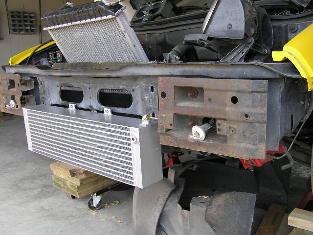

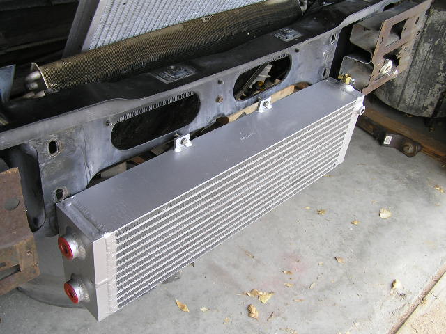

      Daniel, thanks for the intercooler information. I too am going to be running an A/W intercooler and I need something thats going be very efficient up front. I have a spearco 2-230 like FieroX is using on his turbo setup as well. I thought about using PVC for the main straight pipes, is it non-compatible with the coolent? Just wondering if you knew whether I had to run the copper IC lines or if a rubber/synthetic/plastic would work as well.
brandon87gt (traylor88@yahoo.com) MSG #17, 02-21-2008 01:13 AM
      The pics aren't working for me and I'm interested in seeing the car Is it just me?
Edit : Pics started working after I posted that.
The car looks great! How much would you say you decreased the depth of the trunk by? Is it ridiculously small now?
[This message has been edited by brandon87gt (edited 02-21-2008).]
daniel87fierogt (dltraylor@hotmail.com) MSG #18, 02-21-2008 02:31 AM

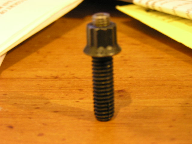

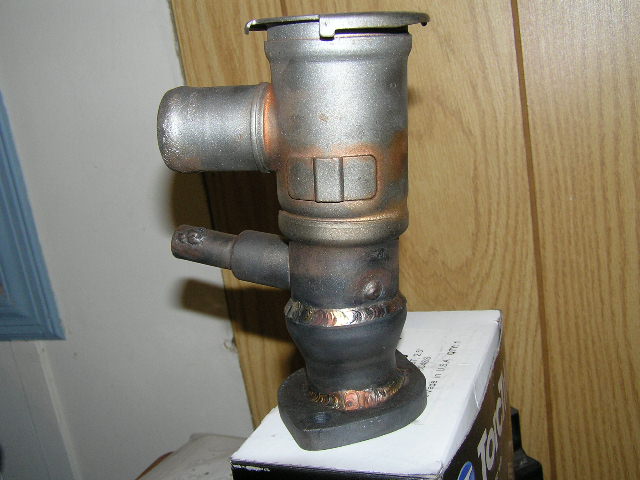

      Black88fiero-Actually when we were intstalling the front timing cover we checked the clearance between the chain and the oil pump cover and i had ten thousandths of an inch of clearance. I read on club gp about people double gasketing or machining the cover and im kinda worried. Is ten thousands enough clearance because i really dont want to take that timing cover off to go get that machined down.
Jncomutt- you know to be totally honest i wouldnt think that the antifreeze would react badly with the PVC but who knows. Are you trying to use the PVC because of the ease of putting it together? Its pretty easy to braze the copper piping together with silver sodder. It only took me a couple of joints practicing to get the hang of brazing. I was just curious because the copper will dissipate alot more heat than PVC.
brandon87gt- Thanks for the complements. Taking out that bottom section is not too bad. You are really only taking about 1/3 of your trunk out and since it was so small down there i didnt really use it in the first place. To me there are alot more pros than cons to taking that bottom 1/3 out. There is tons more room to fit a large un restrictive exhaust in there and with my pacesetter headers i wanted to run 3 inch so i didnt want to cram my exhaust in there with tight bends. And also i dont have to raise the car near as high in the air to put the cradle in because of the trunk not being in the way now. Lots of people dont want to lose any trunk space because we already have so little but the car is not a daily driver for me so im fine with it.
MstangsBware (stephen_p38@yahoo.com) MSG #19, 02-21-2008 03:38 AM
For the lines going up front, I used 2 of the larger heater core lines from a few parts Fieros I had. They are the correct length, size and they fit up in channel like they where meant to be there. From where the lines end, I ran rubber hose to the IC/back and then the same up to the HE that is mounted infront of the condensor.
Jncomutt (jncomutt@hotmail.com) MSG #20, 02-21-2008 11:46 AM
      Wow, what an obvious solution. Why reinvent the wheel? I'll see what I have for spare heater lines around here. Thanks!

      i had clearance too. i checked with the pan off.. i assembled mine cranked it with the starter to check oil press.. then i was told that you dont need a timing chain dampner with a double roller so i took the front cover off to remove it and heres what i found:
so i bought a machined plate from http://www.prjperformance.com/
i dont trust a double gasket thats a weak point and a chance for a leak.. looks good so far
Jncomutt (jncomutt@hotmail.com) MSG #22, 02-21-2008 10:21 PM

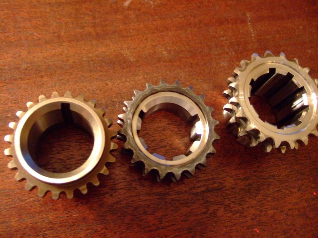

      The problem, I've read, is that the crank gear doesn't get pressed on far enough. If you look at the back side of the supplied lower gear, you will notice the chamfer is a lot smaller than the factory gear. This doesn't allow the gear to fully seat on the crank, which is why you see that pattern more aggressive at the bottom of the plate.
I machined my plate (and haven't ever checked on it), but if you aren't fully assembled yet, it might be best to check the clearance 'behind' the gear and see if it isn't seated back far enough on the crank.
(not my image)
That shows a stock gear, a machined gear, and then a RM gear as supplied.
[This message has been edited by Jncomutt (edited 02-21-2008).]

      mines already assembled and in the car and running with a machined plate

      Black88fiero-Well i agree with you that going double gaskets is the shoddy way of doing it and i wouldnt do it that way because of the more likely chance of getting a leak. How much are people taking off the oil pump cover? I thought i read somewhere that it was ten thousandths but im not sure. What i am worried about is that i have ten thousandths of clearance right now but after i start it up that crank gear might move or the chains deflection might be enough to make it rub that cover then.

      not sure if it is right but a stock plate is .157 somthing and a machined plate was close to .115 i think, i measured it but for got what it was exactly. i see the difference on the gears.. manufactures are getting cheap aren't they cant even machine a darn gear right... daniel87fierogt who did you get your fuel rail from?

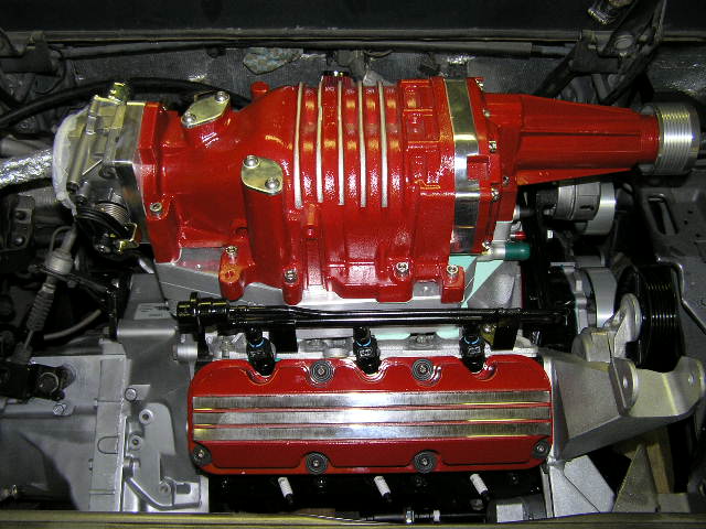

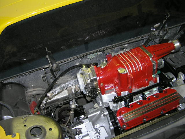

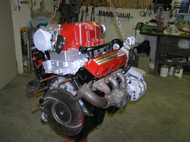

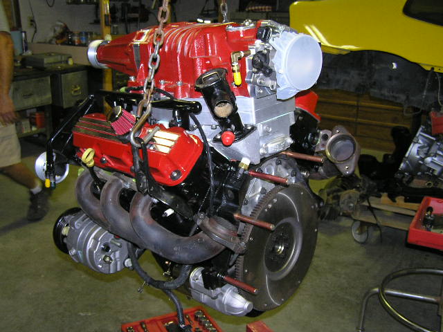

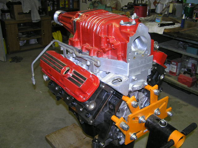

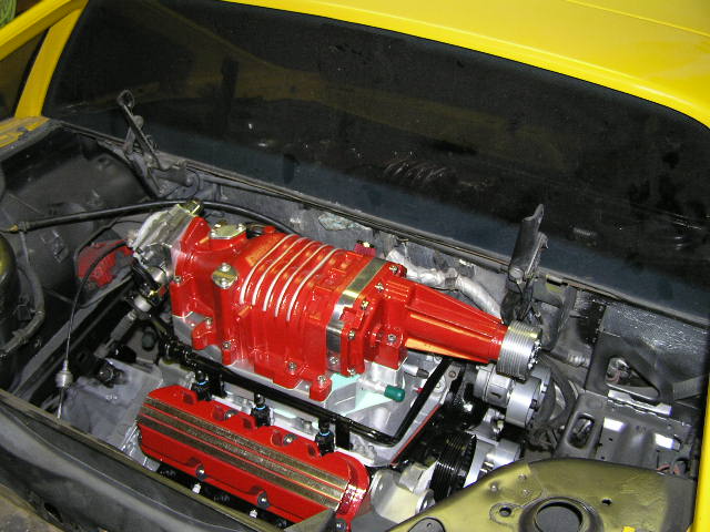

daniel87fierogt (dltraylor@hotmail.com) MSG #28, 02-29-2008 05:52 AM
      Some more pics of todays progress.
Jncomutt (jncomutt@hotmail.com) MSG #29, 02-29-2008 11:31 AM
      That thing looks awesome!

      You might find that those fuel lines are going to situate the rubber right in the path of the blower belt, but I might be wrong depending on the angle I am seeing it from.
I hope you went with 1.7 rockers, as 1.6's would seem like a waste with that small cam you have.
ignorant prodigy (ignorantprodigy@aol.com) MSG #32, 02-29-2008 10:39 PM
      since when is an xpcam a small cam?
darkhorizon MSG #33, 03-01-2008 01:51 AM
      Since you can run it on stock heads without any problems... Its small in the lift department, obviously the duration is significant, but just because zzp does not sell a cam inbetween the "max stock heads" and "max modded heads" does not mean there is not a middle road.
Intense happens to offer some very nice "light head work" cams out there, like the turbo stage 3/4 and blower stage 2/3.
There is plenty of lift left in a stock 3800 head, and if you have ported heads, why wouldnt you take advantage of the larger port size?
daniel87fierogt (dltraylor@hotmail.com) MSG #34, 03-01-2008 02:21 AM
      Yeah i know i was thinking the same thing, since when is the XP cam a small cam? And no the fuel lines will not contact the supercharger belt. Why would you say that the comp cam rockers are a waste at stock 1.6 ratio. I dont ever have to worry about rocker failure or deflection with the 130lb springs. I didnt have the valve guides machined down. I am using modded retainers and the extra clearance viton valve seals. So i am good up to about .565" lift. With the 1.7 rockers and xp cam that would put me at .558" intake and .570" exhaust. I had the heads flowbenched after they were ported and polished and they still didnt flow that much more after .500" lift. Why stress the valvetrain more when that extra .030" lift isant going to make much of a difference. I was actually going to use the XPZ cam and get the heads clearanced for up to .600" but instead i went with the XP and im sure i will be over 350 whp with a good tune. Probably when the aluminum heads come out, i will switch to a bigger cam and go whipple or turbo.
darkhorizon MSG #35, 03-01-2008 02:33 AM
      i dont like the deflection excuse that the rocker manufactures parade around, but I do agree that it is similar to taking the weight of a piston out of the rotating assembly, inherently increasing horsepower by at least %1.
heads flow alot different when boost is applied, I rarely see heads flowtested by pushing air through them, most benches pull air through the valves.
My secret setup involves a VS cam and 1.7 rockers. It makes for cake tuning, and really maxes out the stock lift heads.
daniel87fierogt (dltraylor@hotmail.com) MSG #36, 03-01-2008 03:28 AM
      Actually its not comp cams that say that stock rockers have rocker deflection but ZZP has a couple articles on there site saying that in there testing they have seen up to .020-.040 lost to rocker deflection. So i dont know but ZZP does do alot of R&D. I wasent aware that there would be a difference in the way the air is either pushed or pulled through the heads. If i would have went with the VS cam then i would have went with 1.7 rockers.

      Some more updates and pictures tomorow night. We are going to be reinstalling the fuel tank with the new walbro 255 and running the intercooler piping and i can also provide pics of the relocation of the slave cylinder to clear the header crossover.
daniel87fierogt (dltraylor@hotmail.com) MSG #38, 06-02-2008 10:40 PM

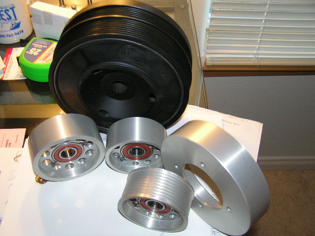

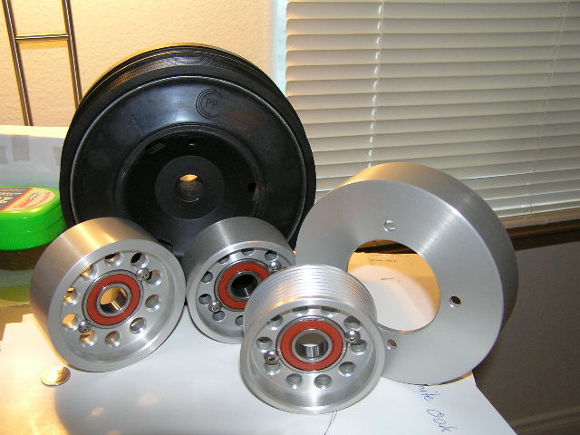

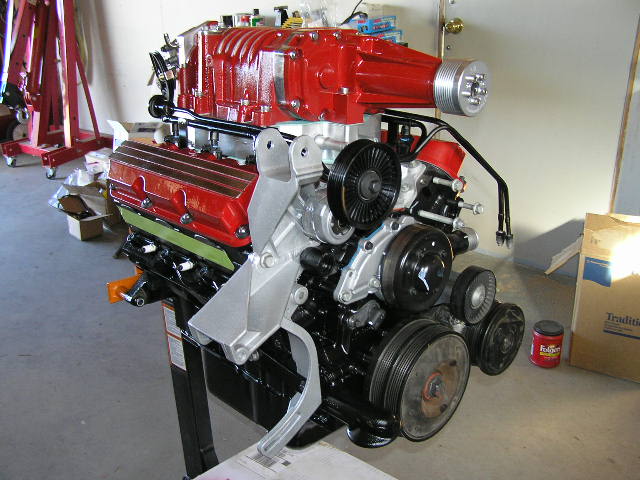

      I just recieved my new idler and tensioner pulleys from nate herbst and the 8 groove powerbond harmonic ballancer from ZZP so progress is moving along. I got the tank reinstalled but havent got the intercooler piping soddered up yet.

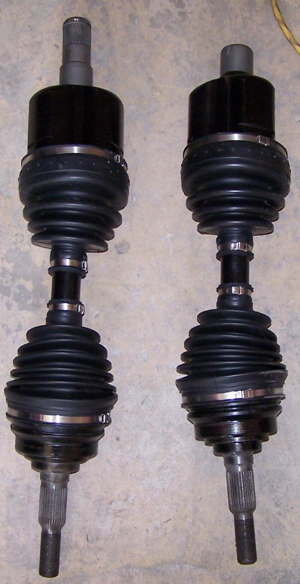

      the whipple is neat. i was doing some preheating of my tires today in the driveway and found the limit's of a stock axle... it was louder then i expected! neat stuff though. it sounds insane over 7k rpms. it actually sounds good!
daniel87fierogt (dltraylor@hotmail.com) MSG #44, 07-19-2008 02:07 AM
      Nice I knew you would break an axle, it was just a matter of time. Now go get some bulletproof axles and CV joints I am curious about since you dont really need CV joints in the rear of the fiero since it only goes up and down and not side to side and up and down like a standard FWD car does, you could probably have some custom axles built and use U-joints instead of CV joints. I dont know if it would work or not but i highly doubt you would break another one then.
Billybo455 (billybo455@aol.com) MSG #45, 07-19-2008 02:14 AM
      i have a set of hubs and axles that are suppsed to be able to take 800. i want to throw another stocker back in. i don't know what the deal with it was. i had a reman on it, but the boot tore. so discount upgraded to a new one for free. the new one had a 1.25" shaft. Looked 100x better then the reman. i think it was a fluke. not to mention i was on my 235/35/18's vs the 275/40/17 drag radials. which also pushes me towards fluke. either way, back on track. need a whipple, you won't regret it either :P
Billybo455 (billybo455@aol.com) MSG #46, 07-19-2008 02:17 AM
      btw, you need c/v's because they move in and out. you could do a slip joint like the rear of the trans, but in the shaft itself. doing that would lead to issue's of strength also. the best bet is what i had made. i'll email you some pics of them if you like. i think they are built using porsche joints and the hubs just look like stockers, but redrilled and splined. could be wrong through.
daniel87fierogt (dltraylor@hotmail.com) MSG #47, 07-19-2008 02:25 AM

      Here is a pic of the custom axles that were installed into my car.
JR/Kitcarman claims that they are rated for 600ftlbs of torque. He absolutely refused to tell me who made them though. If they break I quess I will have to find a shop that can reproduce them for me. They appear to have a much thicker shaft than the stock Fiero shaft.
daniel87fierogt (dltraylor@hotmail.com) MSG #51, 07-19-2008 03:06 PM
      Very nice looking axles Jimmy. I have a feeling that i will swapping the built auto in very shortly after i grenade this getrag. Instead of pieceing together axles im going to talk to the same transmisson shop that Cali-kid had build his bulletproof axles for his SBC.

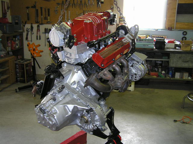

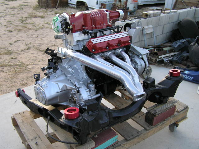

daniel87fierogt (dltraylor@hotmail.com) MSG #57, 08-03-2008 09:32 PM
      Allright everyone lots of pictures of the engine sitting on the cradle hooked up to the getrag coming soon. And then the fabbing and running of the Intercooler lines and frozenboost FMHE. Stay tuned, getting alot closer to the startup video
Bubbajuju MSG #58, 08-03-2008 11:08 PM
      Outstanding swap!
Looking forward to those pics and dyno numbers.
If you get a chance shoot a pic or two of your exhaust.
Really nice work.

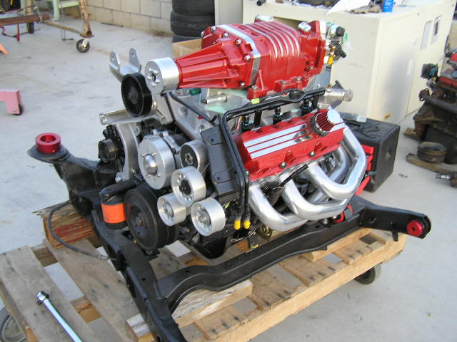

daniel87fierogt (dltraylor@hotmail.com) MSG #60, 08-12-2008 05:26 PM

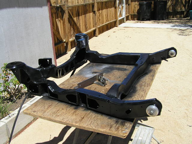

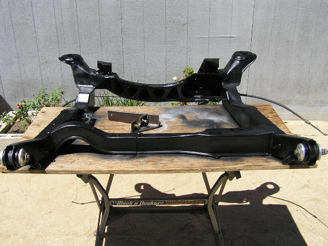

      I have some more pics from yesterdays work. I got the new transmisson and cradle painted and then i took a couple pics of the bracket that we fabbed up to hold the slave cyclinder. We rotated it 90 degrees so that the pacesetter crossover will clear the slave. More pics on thursday and friday. We should get it mounted on the cradle and a test fit is possible.

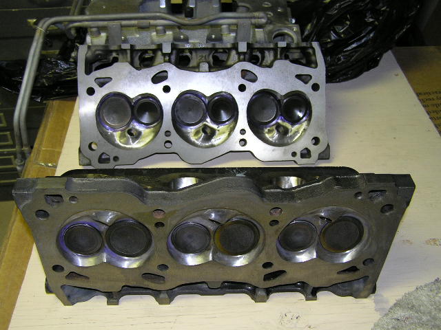

ignorant prodigy (ignorantprodigy@aol.com) MSG #62, 08-12-2008 10:09 PM

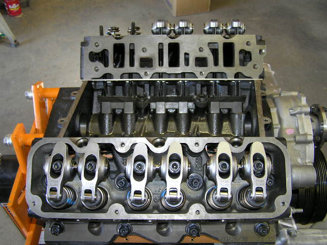

lol Dave I asked the same question
crab daddy (dtucker@aquahealth.com) MSG #63, 08-13-2008 06:47 AM
      You know frankie had the same failure with gm valves. He was running an s3 cam and 130lb springs and the dish broke off the valve.. same way mine did with SI valves and 105lb springs... It makes me sketchy on all valves besides manley. I have never heard of a single case of manley valves breaking. Not just in 3800s but in all applications.
daniel87fierogt (dltraylor@hotmail.com) MSG #64, 08-13-2008 03:02 PM
      Yes i know what you mean about the stock GM valves. I have seen over on Clubgp a couple of times where guys were running 105 or 130lb springs and it broke the valve, but then on the other side of things you see alot of guys running them with many thousands of miles with no failure. ZZP just needs to hurry up and get the Aluminum heads out so i can get rid of these stock valves and actually get something that flows.
darkhorizon MSG #65, 08-13-2008 06:40 PM
      alum heads from zzp are looking sorta bleak... The flow numbers coming out of there right now are quite poopy.
daniel87fierogt (dltraylor@hotmail.com) MSG #66, 08-14-2008 03:21 AM
      Yeah Dark i would have to agree with you on the flow numbers for the aluminium heads as cast. They say that they flow less than there Stage 3 head which is just a ported and polished stock cast iron head. But they also said that the ported aluminum heads will flow far more than the stage 3 heads so when i buy the Aluminum heads i will take them over to my machinest and have them port them out and throw them on the flow bench, then they will be a nice set of heads combined with a XPZ cam or a stage 3 turbo cam
[This message has been edited by daniel87fierogt (edited 08-14-2008).]

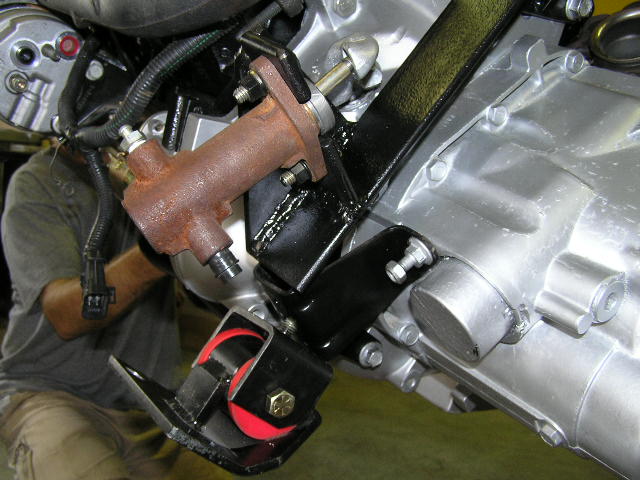

daniel87fierogt (dltraylor@hotmail.com) MSG #67, 08-16-2008 07:27 AM

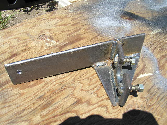

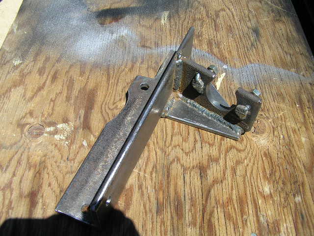

      Got alot done tonight. Put the stage 4 spec clutch in and mated the tranny and engine, got all the mounts on and it sits perfect without any problems. We got the engine in and test fitted for the first time, next up is running the intercooler lines and getting all the little stuff done like coolent hoses, vacuum lines, putting the wiring harness and PCM in. Getting closer to the first start

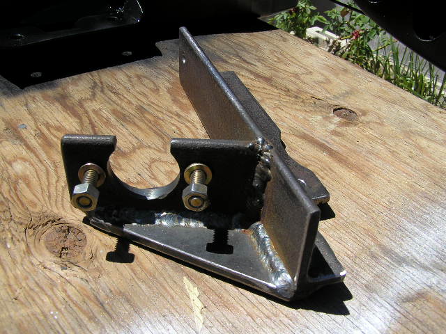

This is the bracket we fabbed up to reposition the slave for clearance for the headers
daniel87fierogt (dltraylor@hotmail.com) MSG #68, 08-16-2008 07:30 AM

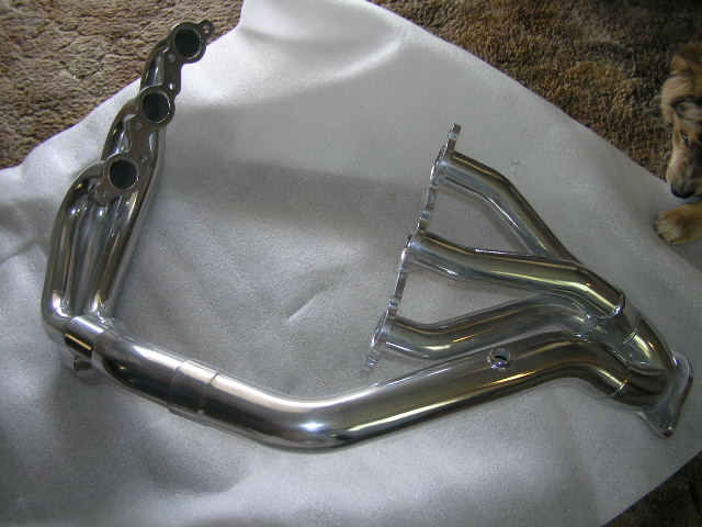

      I sold the pacesetters and purchased one of the first sets of ZZPs new 304 stainless 2 peice headers. They are top notch and i cant wait to install them, i did a full write-up on them here in TD&Q also. More updates are coming soon, next is running the intercooler lines and mounting the new frozen boost heat exchanger.

      Got a little more work done today on the swap, we mocked up where the Frozenboost FMHE is going to be. We put the front facia on to check clearance and everything cleared. We will make some brackets up now to secure the bottom of the core and then we will permanentely mount the top also. We had to cut out the center section of that piece that the turn sigal lights bolt to cause that core is so thick, its 3.5 inches thick plus there are going to be 2, 7 inch puller fans mounted on the core so we needed quite a bit of room to fit all that up in there.

      Allright well Jet-Hot is shipping out the coated headers tomorow so i will have some nice shiny pieces in my possession by friday hopefully. Will post pics and my thoughts on dealing with JetHot when they arrive.
85duke- You might just get to see this car someday, i have applied for CHP and im awaiting my physical and oral interviews next month so if i get accepted into the academy i will move up there to sacramento and the car will come with me. So probably by August or September is when i will move up there.
daniel87fierogt (dltraylor@hotmail.com) MSG #94, 02-23-2009 02:05 PM

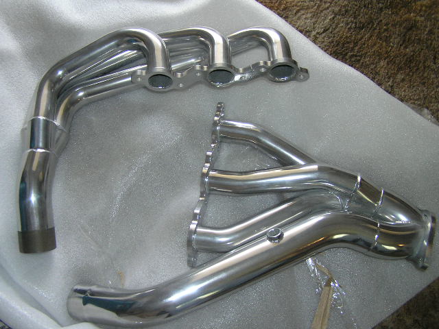

      Allright well i finally got pics of the coated headers. I posted a review about how it went with Jet-Hot and i am very happy with what they did. Heres the pics for everyone, now we just have to get them on the motor and then it will go back into the car for the final time. Getting closer to the first start

      Well today the big brown truck brought me my side scoops from Fiero fiberglass. They are the GT Style #1, and they arrived very well packed and they look great. I will be taking them to the paint shop very soon to have them painted. I have to cut the openings out and the mounting holes first. After they are painted i will put the 1/4" black honeycomb mesh in the openings. The swap moves foreward steadily and i want to thank Jimmy for providing these to the fiero community.

      Allright well the header bolts from Percys high performance came in, and rodneys alluminum cradle mounts came in also The car next week is going up to West Coast fiero so they can make the A/C lines up and build the exhaust for the swap.
daniel87fierogt (dltraylor@hotmail.com) MSG #113, 05-12-2010 04:44 AM

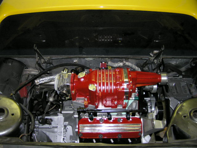

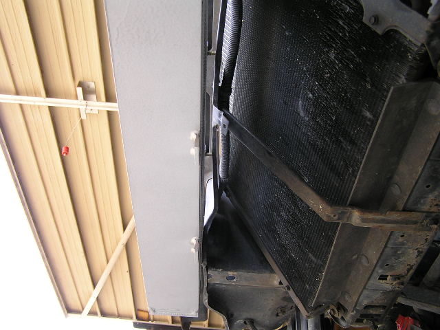

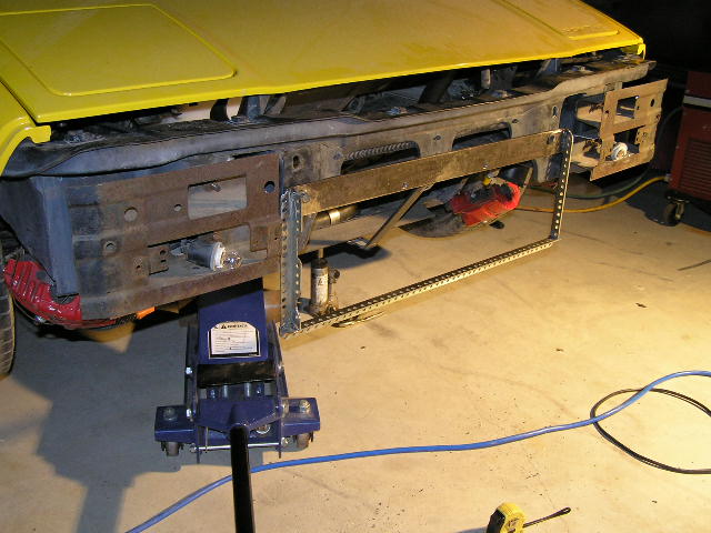

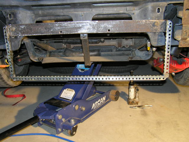

      Got the front mount heat exchanger mounted today. We welded a frame together that goes all the way around the HE so that it uses the two top mounting tabs and the two lower mounting tabs. This thing is very heavy duty, it weighs about 20-25 pounds so we wanted to support it very securely. All thats left to do is mount the pump and run the lines.
daniel87fierogt (dltraylor@hotmail.com) MSG #114, 05-20-2010 05:15 PM
      Making steady progress now, Got the JetHot coated ZZP headers installed last night and we notched the decklid out for the supercharger snout. We will put the rear suspension back under it so it can go up to West Coast Fiero, they will be making the A/C lines, the exhaust system and a couple other needed pieces for the swap.
This picture shows the dipstick and you can kind of see the insulation we put around it. Thanks Rick for the idea!
doublec4 (doublec4@hotmail.com) MSG #115, 05-20-2010 07:50 PM
      Wow, that looks extremely clean and well put together.
Congratulations!
88GTS (avanvuuren@shaw.ca) MSG #116, 05-20-2010 11:11 PM
      Hi Daniel,
What size and water capacity is your heat exchanger and how did you determine the capacity for your application?
Thanks.
daniel87fierogt (dltraylor@hotmail.com) MSG #117, 05-21-2010 06:03 AM
      Thanks doublec4 for the kind words, it has been 3 long years since i started this swap and it finally in the next few months is going to get wrapped up. It will be finished in time for the coast run in october so that will be its first spirited drive
88GTS- Im not exactly sure on the total capacity of the intercooler system yet but we figure it will be between 1-2 gallons and thats without a 1 1/2 gallon ice box that will bring the total system capacity up to atleast 3 gallons. The frozen boost heat exchanger has been pretty widely used by the Grand Prix GTP guys and they have excellent results using it. I will have temp guages on the in and out of the intercooler HE so we will see just how well it works.

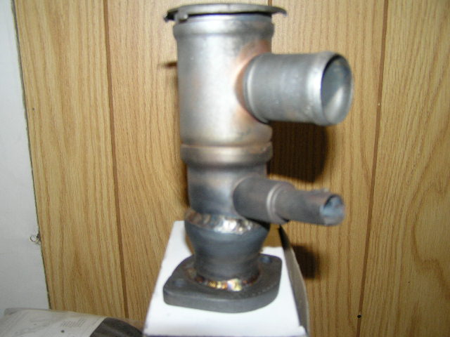

daniel87fierogt (dltraylor@hotmail.com) MSG #118, 06-01-2010 06:11 PM

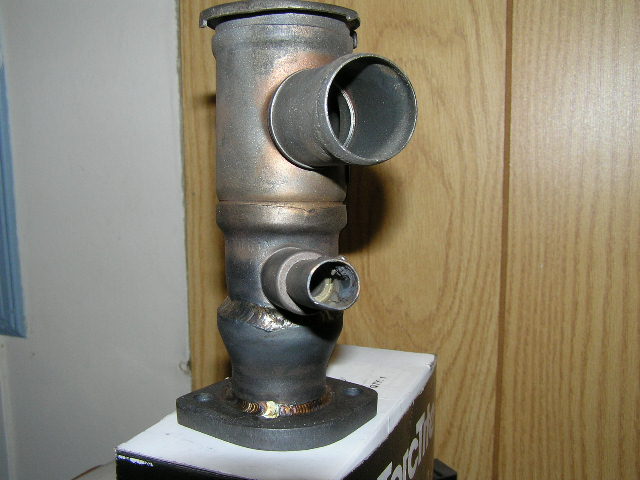

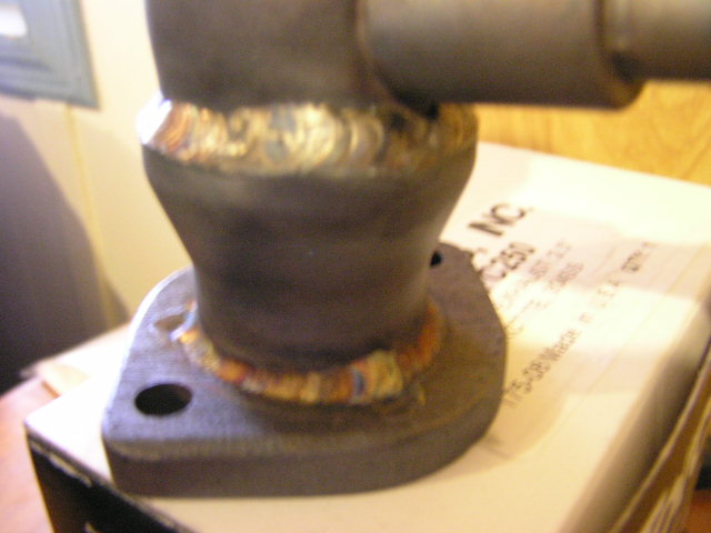

      Here are pictures of the thermostat housing we made up for the swap. It uses a 3/8 flange with the bottom of a 4 cyl duke welded to the flange and then the 2.8 V6 thermostat housing welded on top of the duke piece. We used this reducer so that we could use the factory o-ring that seals the thermostat housing to the lower intake manifold. I like using o-rings wherever possible instead of paper gaskets and this utilizes the factory o-ring. Another reason I also wanted the top of the thermostat housing taller because im running the ZZP fullsize intercooler which raises the supercharger up 2 1/4 inches. Another must have was being able to use the factory fiero thermostat for ease of replacement so i got that also. We finished up putting all the rear suspension back on it and it is ready to be trailered up to west coast fiero. Hope you guys enjoy the pics. Thanks Daniel

      Update on the progress: Since we got the headers installed the only thing left to do is to take it up to West Coast Fiero so they can make up the full 3 inch exhaust for it and make the A/C lines. We still have to run the intercooler lines and mount the pump also. Progress has stopped right now because in a month i am going in for shoulder surgery. Hopefully i will be back and taking it up to west coast fiero right around the begining of the new year.
Nosrac, PBJ did my harness. We will be routing the harness as hidden as possible, the coils are going to be mounted down low where fastfieros mounts his. We are going for the cleanest look with no wires seen.
Jimmy- I will be sure to send you some high res pics when they get painted and installed. Thanks for the kind words, it keeps my motovation up and keeps me wanting to finish it. It will be dynoed after it is broke in and we are shooting for 375 WHP.

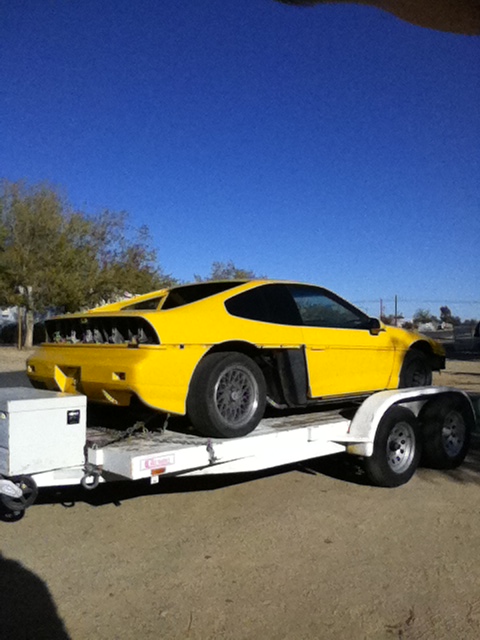

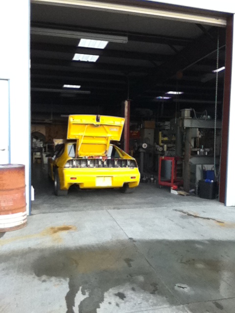

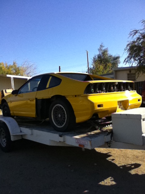

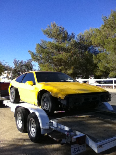

      Allright everyone we trailered the car up to West Coast Fiero today!!! Chris and steve are going to work there magic on my car. There going to make up the exhaust, the ac lines, fab up a couple brackets, make the offset dogbone, and make the coolant pipe for the drivers side. All i will have to do is put some heat shielding on some wires and hoses and put the wiring harness on and the swap should be running and driving. Im so happy that this is almost done, its been 4 years since i started this 3800 swap and it almost finished. I thought i was going to beat qwikgta on the longest time to complete a swap but it looks like in the next few months it should be done.
PRFiero- The rail i am using the stock rail but very modified, it uses the stock pieces of the rail that the injectors clip into and the fuel is routed around the supercharger instead of over like stock. The write-up is here on the forum, its fairly easy to make, just takes time and you have to know how to solder. I will upgrade to the zzp rails or the prj rails when i need a adjustable fuel pressure regulator.
Odin- On paper the car should be a high 11 sec car but in the real world and since im running the getrag i dont know if i will ever take it to the dragstrip. I will get it dynoed so we will be able to theoretically see what kind of time it would do but who knows i might decide to take it to the track.

      Awesome build so far. I'm curious to see how WCF runs your exhaust with the ZZP headers as I will be installing a set on my L67 swap. Look forward to more updates!
daniel87fierogt (dltraylor@hotmail.com) MSG #133, 03-23-2011 05:59 PM
      Well the car is back in my possesion now, the exhaust looks really good. I did have to cut the bottom 1/3 out of my trunk because the ZZP headers dump so far down and out. WCF used full mandrel 3 inch in and 2 1/2 dual outs. I used the quiter larger spintech muffler they offer. I would have taken some pictures when i picked it up but it was raining and sleeting so i didnt have time. All i have to purchase now is the champion radiator and the belts and then i will get the first startup on video. I lost my job a couple of months ago so next week i have an interview so the progress is slow right now. I will take some close-up pics of the exhaust when we do the first startup. Thanks Daniel

      Did You Solder Or Tig Weld your Fuel rail?

      Okay well we are finally in the home stretch with finishing up the swap now. I just moved into our new house that has a full garage so the progress has been steady. In the last few weeks we removed the cradle one last time to wrap the headers, I bought the DEI titanium wrap which looks to be a pretty good product. I ordered the Nitto Invo tires and the new wheels are on there way. I did take pictures for the people that were asking about what it looked like. Just have to put all the heat protection on the wires and install the wiring harness and then I will video the first startup. The fuel rail is soldered not tig welded. I am using a different low mount alt bracket since I am using the 99+ alternator and the dogbone mount has been moved to the back of the head where the EGR is normally mounted. I am using the WCF mount which is very nicely made.

      I may have missed it, but did you wind up going with the F40 trans? I'm starting my 3800 SC swap (gonna take a very long time, limited budget and all) and I got it with the stock automatic trans, and I've been looking at that F40 for a while, but if it's too much hassle I'd rather save the headache.

daniel87fierogt (dltraylor@hotmail.com) MSG #149, 11-23-2013 09:50 PM
      I finally started it up for the first time today. It ran great, only minor things to get done and then it will be ready for a test ride. I am using the getrag for now and I have the brand new F40 waiting for when the getrag decides to let go.

      I just saw your startup post, the car sounds good, did you need to cut the trunk out with those headers?
daniel87fierogt (dltraylor@hotmail.com) MSG #151, 11-25-2013 05:59 PM
      yes I cut the bottom 1/3 of the trunk out. As small as the trunk is on the fiero and I don't use my fiero as my daily driver so I don't even miss that little bit of space I lost.
daniel87fierogt (dltraylor@hotmail.com) MSG #152, 12-01-2013 08:56 AM
      Working on getting the intercooler pump, lines, and heat exchanger mounted so I can take it out for a test drive

Tweeder MSG #154, 02-28-2014 12:21 AM
      Sweet. Any probs with the clearance between the supercharger and deck lid due to the added height if the intercooler?
