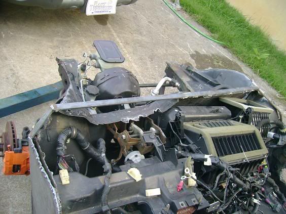

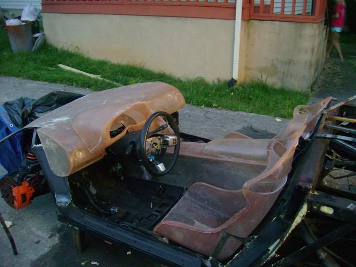

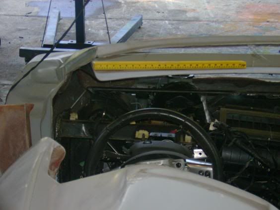

      ok well the dash frame would not fit to save my life. so i had to remove the airbox and mount it alone. which included plasma cutting alot of **** out of the way..... so hey all i had to do was diminish the structural intergrity of the car..... small price to pay. so tomorrow i have to weld some braces in. i also mounted the steering column with some small modifications to the brackets but its in.

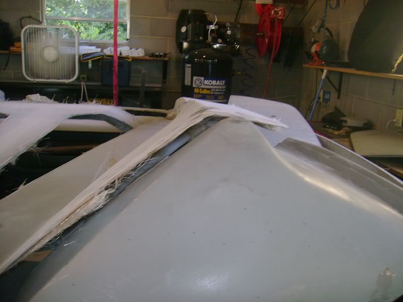

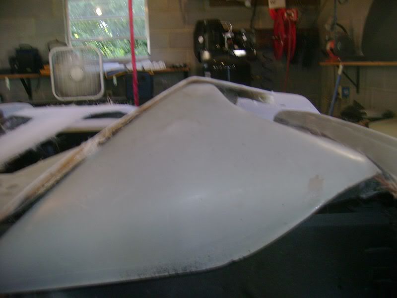

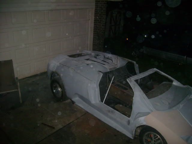

merciero (kelly21am@charter.net) MSG #13, 04-19-2009 01:42 PM
i have never posted pics on a forum before so if this doesnt work ill try again

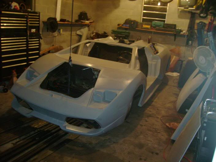

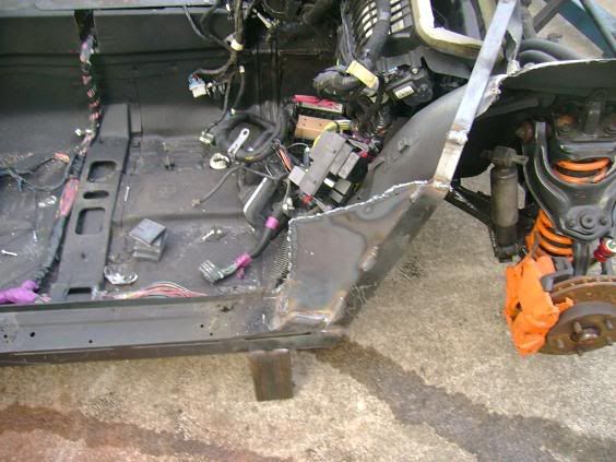

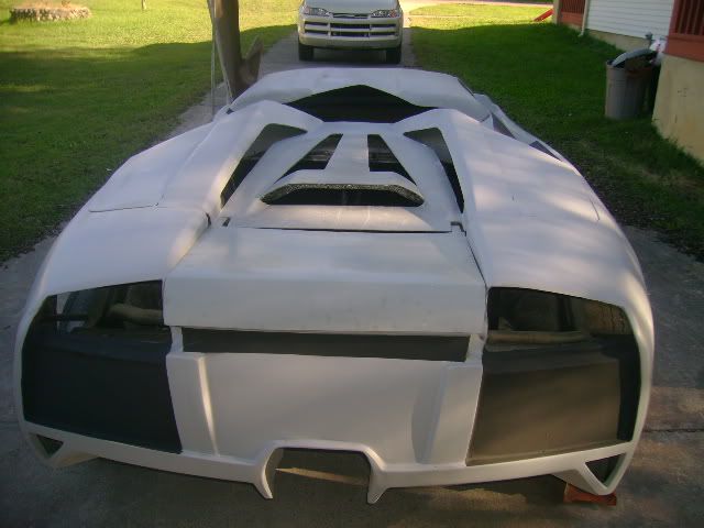

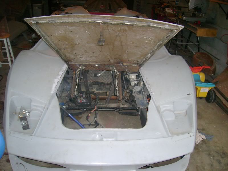

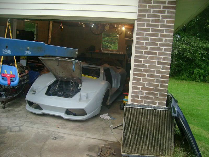

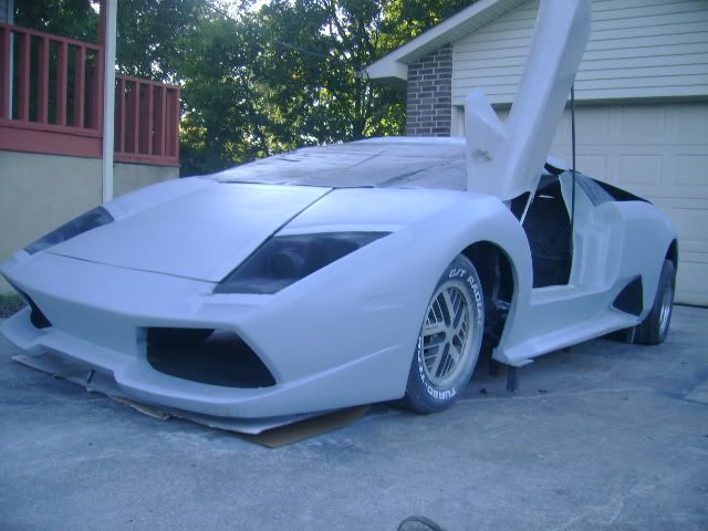

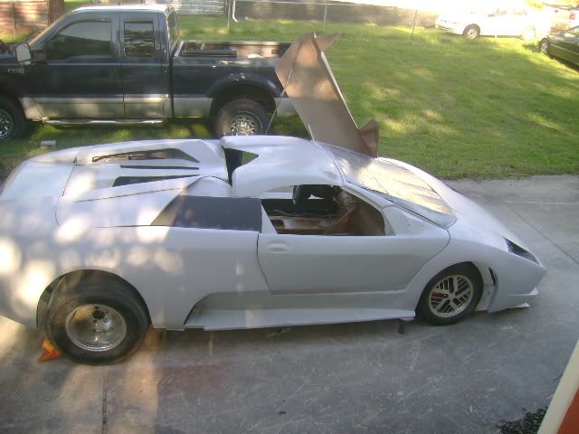

<a href="http://s273.photobucket.com/albums/jj230/brandon86jones/?action=view¤t=kitfront-1.jpg" target="_blank"><img src="http://i273.photobucket.com/albums/jj230/brandon86jones/kitfront-1.jpg" border="0" alt="Photobucket"></a>
heres the front
<a href="http://s273.photobucket.com/albums/jj230/brandon86jones/?action=view¤t=kitside-1.jpg" target="_blank"><img src="http://i273.photobucket.com/albums/jj230/brandon86jones/kitside-1.jpg" border="0" alt="Photobucket"></a>
the side

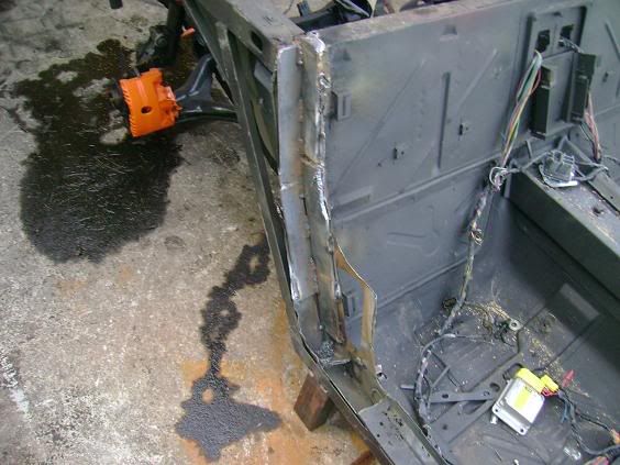

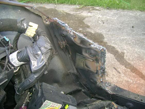

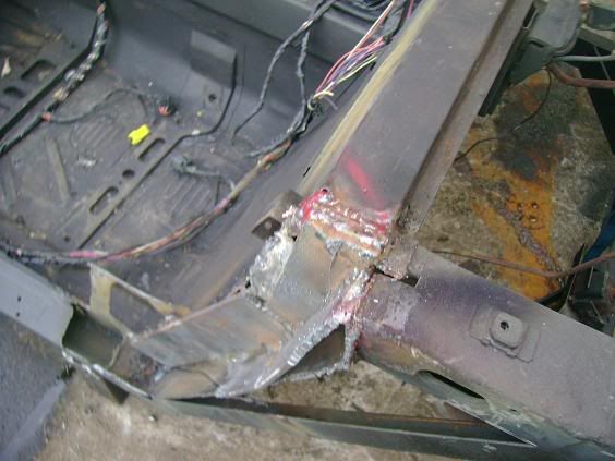

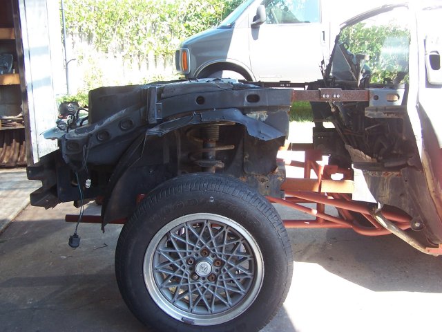

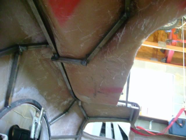

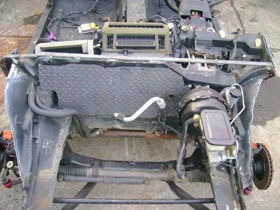

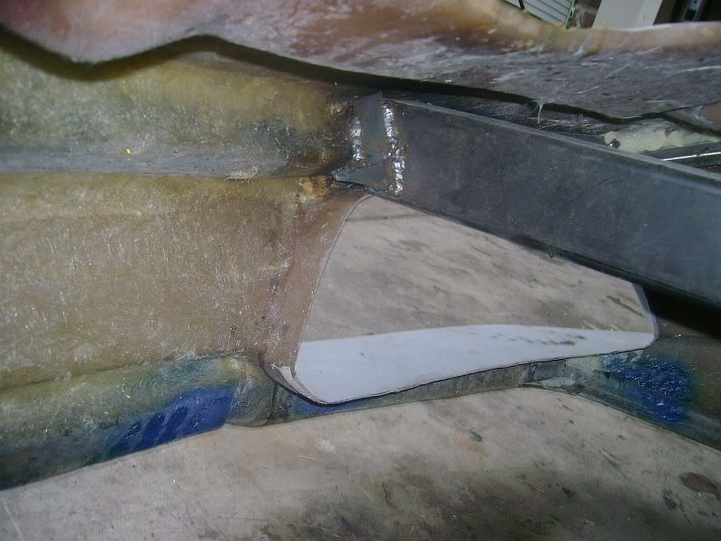

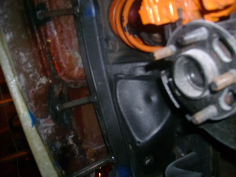

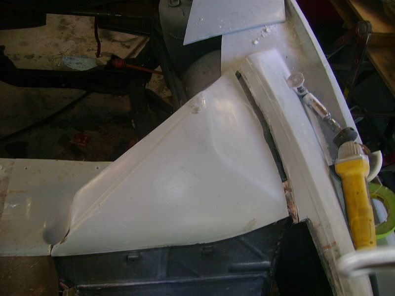

<a href="http://s273.photobucket.com/albums/jj230/brandon86jones/?action=view¤t=kelsoldstuff074.jpg" target="_blank"><img src="http://i273.photobucket.com/albums/jj230/brandon86jones/kelsoldstuff074.jpg" border="0" alt="Photobucket"></a>
this is with all the air box pulled out and i cleaning up the wiring so none of it is in there at the moment

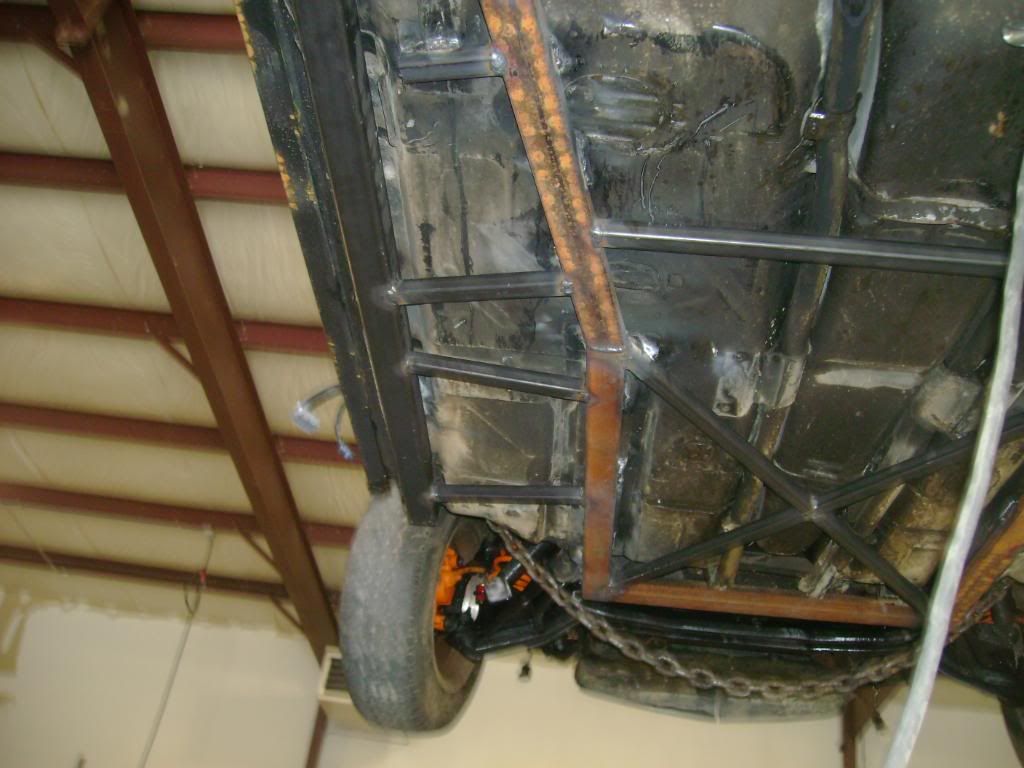

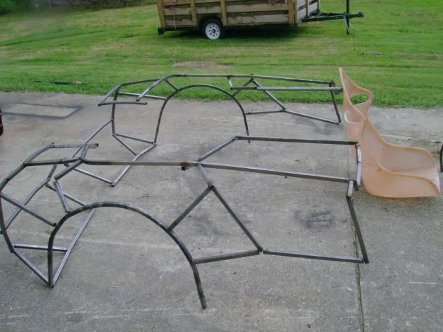

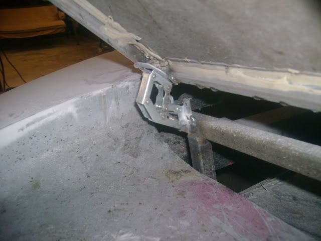

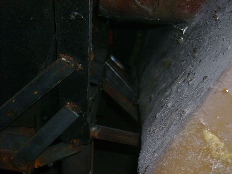

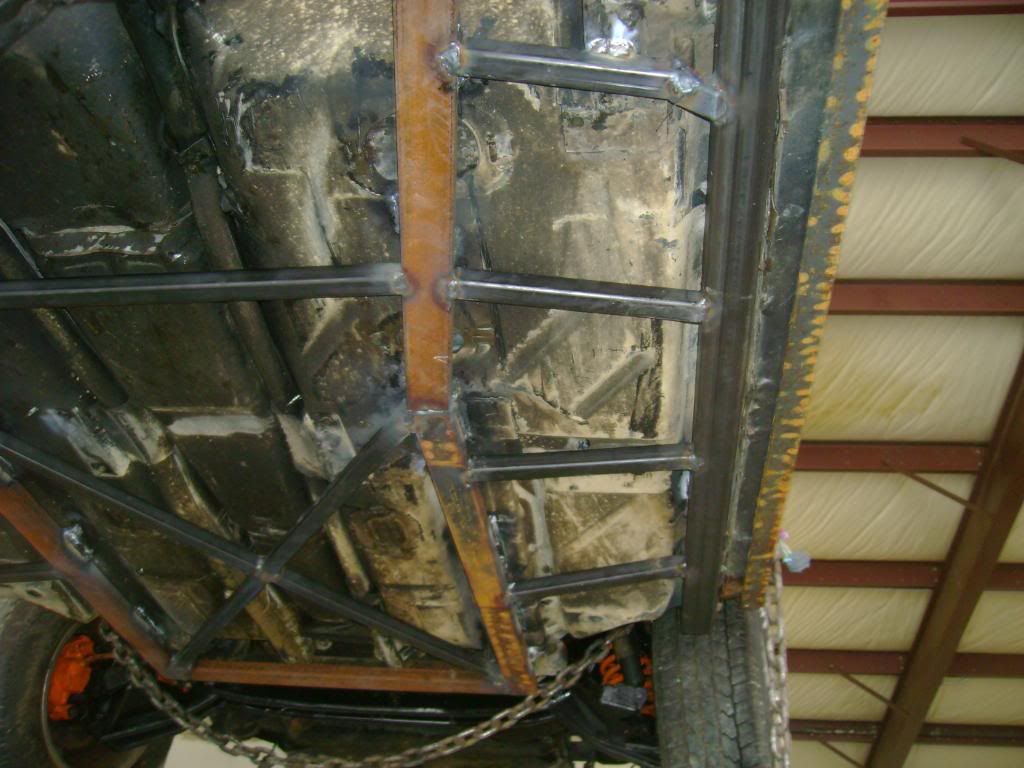

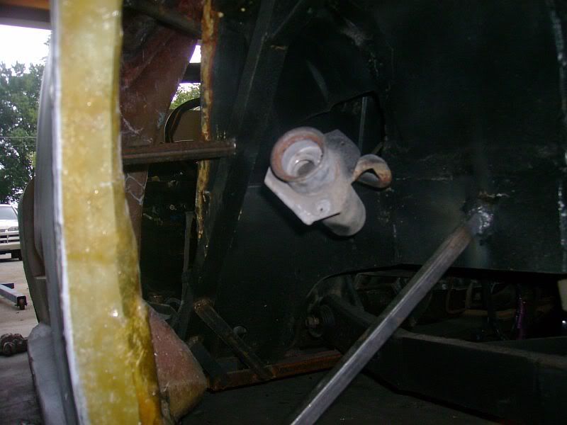

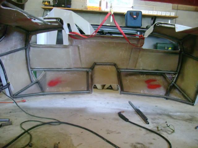

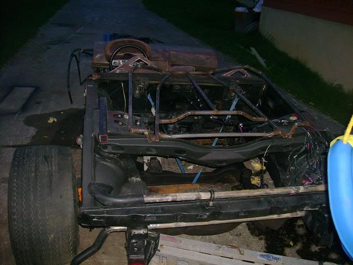

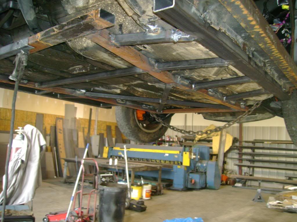

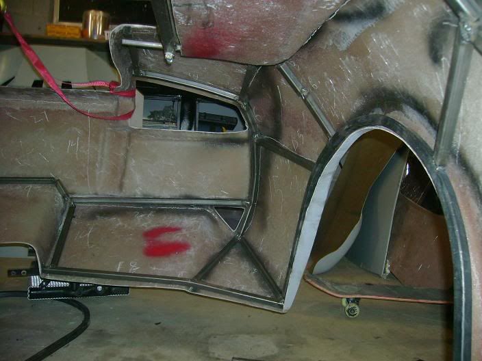

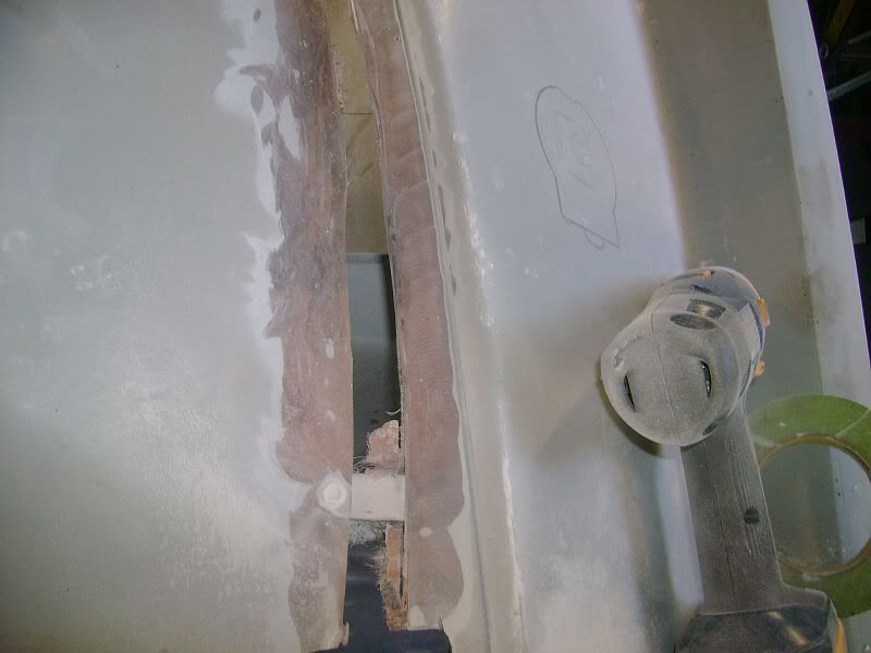

<a href="http://s273.photobucket.com/albums/jj230/brandon86jones/?action=view¤t=kelsoldstuff078.jpg" target="_blank"><img src="http://i273.photobucket.com/albums/jj230/brandon86jones/kelsoldstuff078.jpg" border="0" alt="Photobucket"></a>
here is the stretch and the rear bracing that will be used for my batwings

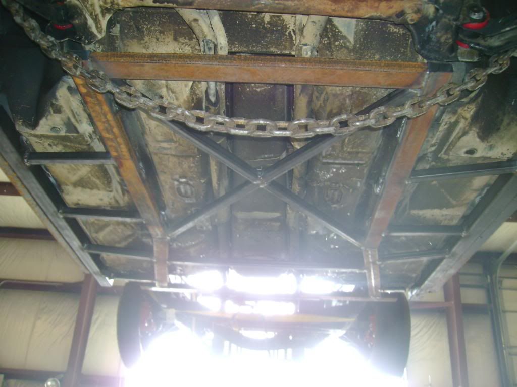

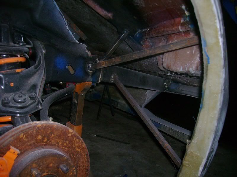

<a href="http://s273.photobucket.com/albums/jj230/brandon86jones/?action=view¤t=kelsoldstuff082.jpg" target="_blank"><img src="http://i273.photobucket.com/albums/jj230/brandon86jones/kelsoldstuff082.jpg" border="0" alt="Photobucket"></a>
the inner stretch keeping the steet metal stock look

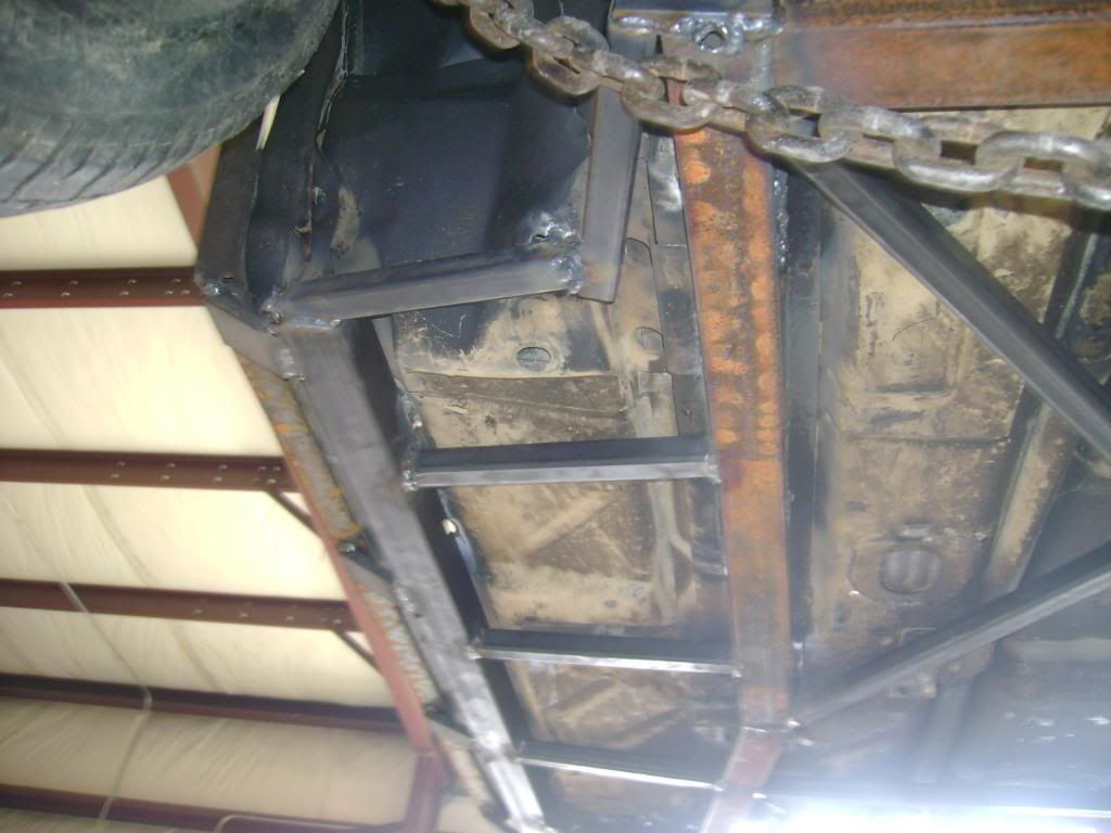

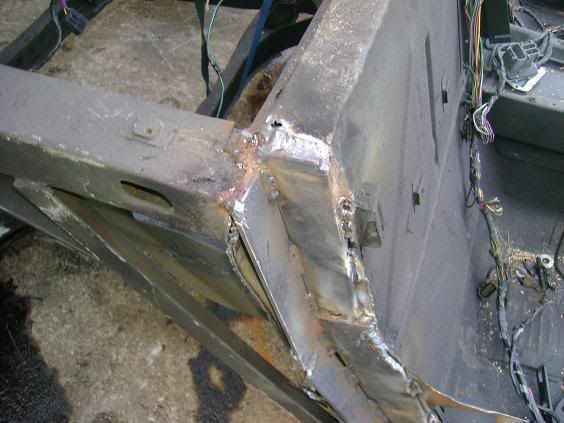

<a href="http://s273.photobucket.com/albums/jj230/brandon86jones/?action=view¤t=kelsoldstuff081.jpg" target="_blank"><img src="http://i273.photobucket.com/albums/jj230/brandon86jones/kelsoldstuff081.jpg" border="0" alt="Photobucket"></a>
upper inside stretch

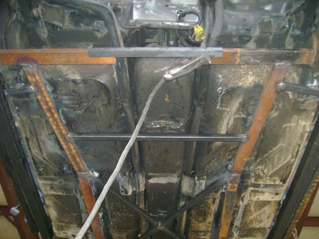

<a href="http://s273.photobucket.com/albums/jj230/brandon86jones/?action=view¤t=kelsoldstuff088.jpg" target="_blank"><img src="http://i273.photobucket.com/albums/jj230/brandon86jones/kelsoldstuff088.jpg" border="0" alt="Photobucket"></a>
cradle stretch
<a href="http://s273.photobucket.com/albums/jj230/brandon86jones/?action=view¤t=kelsoldstuff079.jpg" target="_blank"><img src="http://i273.photobucket.com/albums/jj230/brandon86jones/kelsoldstuff079.jpg" border="0" alt="Photobucket"></a>
lower stretch once again keeping the stock look
<a href="http://s273.photobucket.com/albums/jj230/brandon86jones/?action=view¤t=kelsoldstuff140.jpg" target="_blank"><img src="http://i273.photobucket.com/albums/jj230/brandon86jones/kelsoldstuff140.jpg" border="0" alt="Photobucket"></a>
all the grand prix wiring i took out to clean up
<a href="http://s273.photobucket.com/albums/jj230/brandon86jones/?action=view¤t=kelsoldstuff123.jpg" target="_blank"><img src="http://i273.photobucket.com/albums/jj230/brandon86jones/kelsoldstuff123.jpg" border="0" alt="Photobucket"></a>
a bunch of air ducts and window motors, ect.
<a href="http://s273.photobucket.com/albums/jj230/brandon86jones/?action=view¤t=kelsoldstuff128.jpg" target="_blank"><img src="http://i273.photobucket.com/albums/jj230/brandon86jones/kelsoldstuff128.jpg" border="0" alt="Photobucket"></a>
the air box

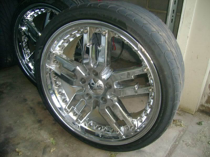

by the way does anyone have some good rims they wanna get rid of

couldahadaV8 MSG #16, 04-19-2009 04:07 PM
      Very nice metal work on the stretch!
RWDPLZ MSG #17, 04-19-2009 04:55 PM
That's what I was thinking, too, I've seen so many that look like they were done by drunken amateurs with no welding skills or common sense.

      That's exactly what I was talking about. I have looked at a few stretch jobs that do not look too good. This one looks to be done right. Very nice. Thanks for the pics.

      well thanks guys. i could of done a lil better on the stretch but i did it in like 2 hours at my work im a heavy duty truck fabricator. but the kit is a lil more affordable then people think. but yeah that dsm i got it when i was 16 my first car. it was a non turbo automatic. i raced it around thinkin i was fast and got a 600 dollar ticket so my parents took it away. so it sat in my driveway. so i put a kit on it. then that started my obsession. after like 4 kits it now has a widebody i blew the motor so i put 12 Gs into building and boosting the motor. then i shattered my tranny. an auto made for 115 HP had 435HP didnt hold up so i did a manual conversion on it. ive been working on that think for 7 years and everytime i get it done i wanna change something else. lol if you care ill take some pics of it.... i fiberglassed the whole interior, air cylinder suspension, 400+ motor its, not bad. but this was a GM forum so i didnt think anyone would care bout it.............
anyways update i got the harnesses all laid out with all the components hooked up there are a few places i had to cut the wires to get it out. so i just got done soldering like 100 wires together, i am missing an on star antenna in the rear so im looking for a grand prix around here i can look at.

      i need some rims cheap but nice so im not rockin a flat and a dog-nut
Dash (aalasmar@uwm.edu) MSG #24, 04-20-2009 10:05 PM
      PM sent about wheels man

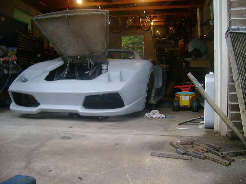

      ok i just go my radiators in so tomorrow i will make brackets and start mounting the radiators in the back

I love the the quality of workmanship on that stretch........I hope mine turns out half as nice as yours!!!
Any tips for me??? I know the tricky part is keeping everything square. What's the best method to use?
I should be pulling my motor this weekend, so I can get going on my stretch.....wish me luck!!!
merciero (kelly21am@charter.net) MSG #41, 05-10-2009 05:40 PM

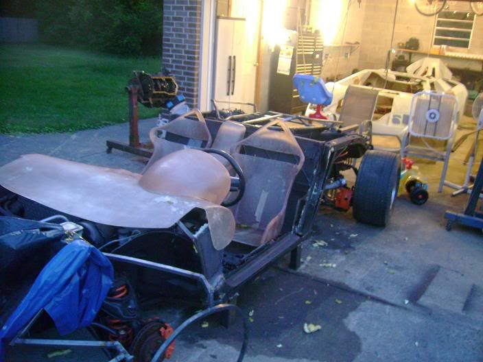

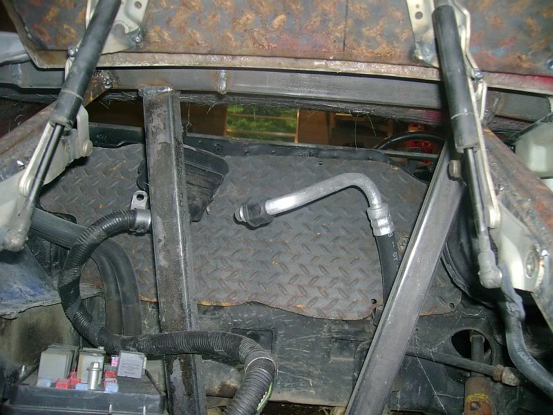

      ok got the wiring in as you can see i had to remove the stock gas pedal and put the 06 in since its drive by wire. i had to fabricate the brake switch to work on the fiero pedal. i had to fabricate the 06 master cylinder to work. and the air box is in, all the wires and dash components are in now im just cleaning it up. i also have the 2 radiators on im using civic radiators. and now i have to extend the wires for the engine bay to the rear.
merciero (kelly21am@charter.net) MSG #42, 05-10-2009 07:21 PM
      safastro take a pice of flatbar metal about 1inch wide and weld a tab at each end about a inch and a half in. make the tabs the length of your stretch apart. mine was 10.5.... cut the frame and put the pacer into the frame rail, one on each frame rail. push the frame up to the tabs.. clamp them into place then start your welding. this will keep everything in line i have done many stretches and this is the best way to keep it square. but cross measure before welding just to double check, it sounds like you know what your doing. but if you need any help let me know. ill do what i can

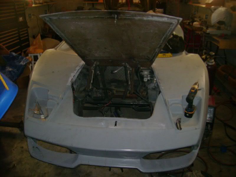

      im diggin the twin radiator set up
it looks sick dude

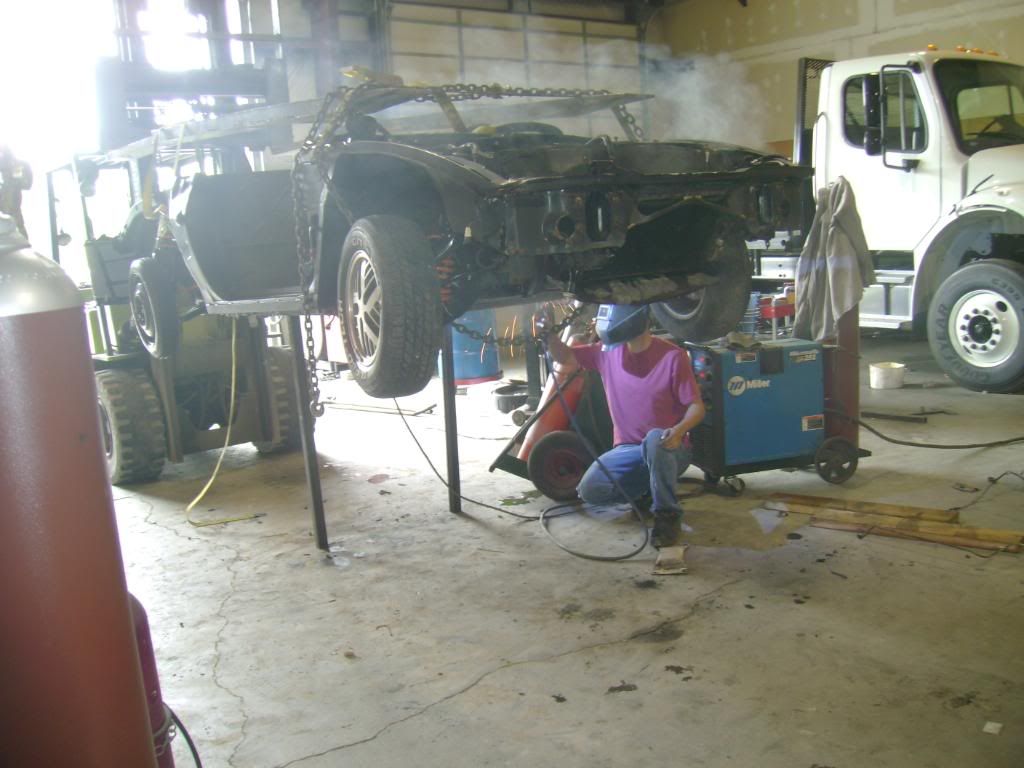

merciero (kelly21am@charter.net) MSG #47, 05-15-2009 08:36 AM
      im welding the x brace and runner pipes in tomorrow ill have my wife take lots of pics.... BY THE WAY DOES ANYONE KNOW HOW TO GET AHOLD OF MURCI-ME I GOTTA ASK A FEW QUESTIONS

Rickady88GT (rjkmfam@sbcglobal.net) MSG #49, 05-15-2009 11:15 AM
Originally posted by merciero:
I have the same HVAC you are installing, but I could not fit my foot in between the HVAC and gas pedal with the system were you have it. I placed mine a little diferently so I had greater foot room. And still used the adjustable pedals.
I used the Fiero steering shaft but removed the "U joint" and instaled the aluminun "U joint" onto the Fiero shaft.
BTW that "aluminum" beam that was under the dash IS NOT aluminum. It is magnisium. DONT burn it. I had fun with some of the shavings in a metal can and a lighter. DO NOT DO THIS AT HOME if you get hurt or burn some thing down, dont blame me

merciero (kelly21am@charter.net) MSG #51, 05-16-2009 10:33 PM
      nice that is exactly how i have to do mine the steering shaft and all..... good work. did this thread inspire you or were you already in the process. what did yo do to your hvac to make more room for your feet?
Rickady88GT (rjkmfam@sbcglobal.net) MSG #52, 05-17-2009 02:38 AM
I have had the HVAC system for a a year or so. I have cut the box up in several pieces trying to avoid cutting the car. But I wound up cutting the car and then plastic welding the system back together.
I think the key to foot room is to move the HVAC closer towards the passenger in all three axis, X,Y and Z. If you move it towards you in the Y, that will allow you to move it further over to the right. And lifting it up a little will give you even more room.
Mine is not under a Fiero dash so I think I have room to move it around.
I cut the top off of a diferent HVAC al plastic welded it together to fit it under the new dash.
merciero (kelly21am@charter.net) MSG #53, 05-17-2009 06:51 PM

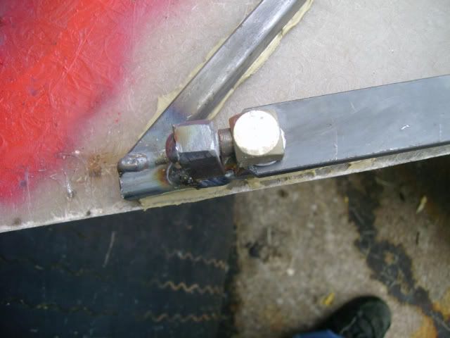

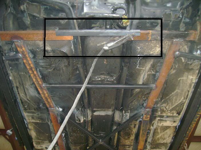

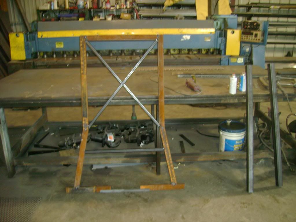

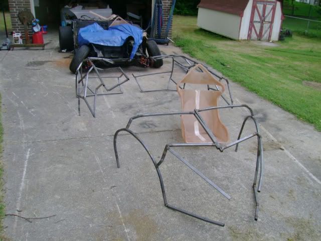

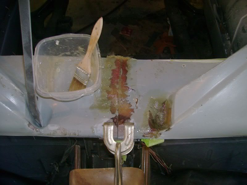

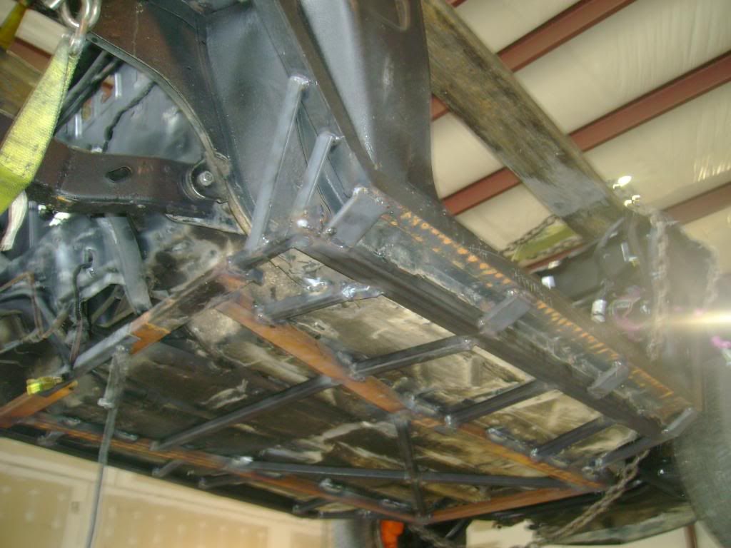

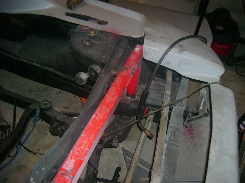

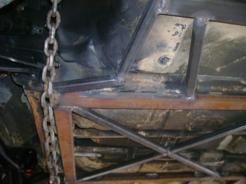

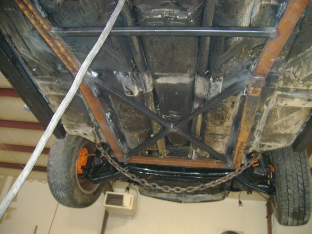

      ok guys i just got done welding the x brace under the car and added supports all around. this is the stoutest fiero ive ever seen.... i went a lil over board with the bracing but heck there is no such thing as too strong...
Dash (aalasmar@uwm.edu) MSG #54, 05-18-2009 12:41 AM
      really diggin your work dude
but dont you think that x-brace on the bottom might be a little troublesome come time to change the fuel pump?
PaulJK MSG #55, 05-18-2009 12:49 AM
[B]Originally posted by Dash:
that wasn't his biggest mistake so far (but i have no interest 'cause it's not my car)
[B]Originally posted by merciero:
did this thread inspire you ....
c'mon Rick - you WERE inspired, weren't you ;D
[This message has been edited by PaulJK (edited 05-18-2009).]
whodeanie (dean@glassworksga.com) MSG #56, 05-18-2009 01:41 PM
      I hope you never have to do anything under that car any time soon! I think if I was going to do that I would have replaced everything under their first and then given myself an easy way to drop the fuel tank just in case.
I like the build don't get me wrong but sometimes function comes before form
merciero (kelly21am@charter.net) MSG #57, 05-18-2009 06:44 PM
      the back brace is going to be bolted on it just tacked right now so i can drill it. the middle brace also has a bolted on section.
but by the way what was my biggest mistake? and what could i replace under the car there is nothing left but the tank all brake lines hoses ect have been removed for steel braided lines to go in.
merciero (kelly21am@charter.net) MSG #58, 05-18-2009 06:51 PM
      and by the way. the middle stock brace was removed. once i have time i will drill the back angle and bolt it up. and the middle brace about a foot and a half in front of it will be the same way...... but i did think about that since i have to put a performance pump in the tank. but everything is removed besides the a/c lines and heater lines which i checked and are perfect.... dont take this as me defending. i actually enjoy critisism. thats the only way for a builder to perfect, is through anothers piont of view....
whodeanie (dean@glassworksga.com) MSG #59, 05-18-2009 11:12 PM
from the pic's I could not see that you were going to make it removeable. I have seen others that never thuoght about it till it was too late.
I try very hard not to critisis. I would rather try to help before something becomes a problem. as long as you know what you are doing all is well.
I love the build I can't wait to see the body on the chassis.
D.

merciero (kelly21am@charter.net) MSG #61, 05-19-2009 09:54 PM
      oh its cool guys ide rather somebody notice now then me have to cut it later..... but i just cut the front end off to clear the kit and i had to trim the door jams......... which i reallly reallly did not want to do..... but pics will come tomorrow

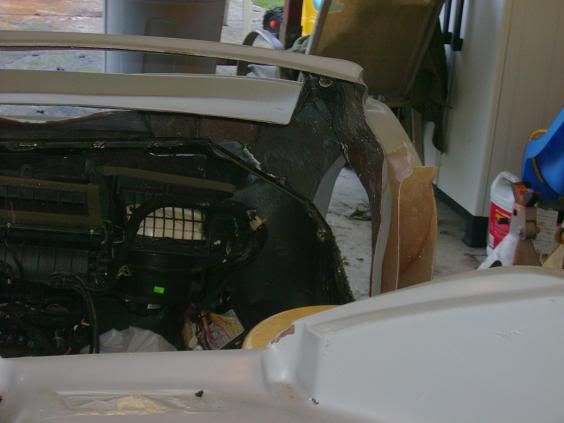

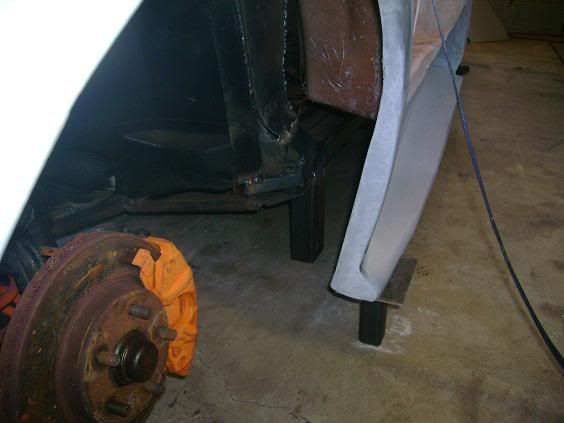

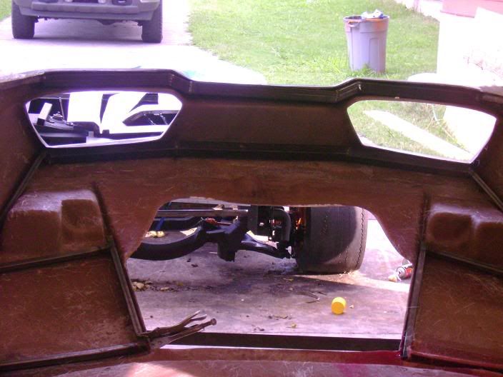

      ok back on the build im working out some kinks with the body being mounted.... i had to cut alot off the dash and front... so im taking it to the shop sat morning and weld up all that i cut... and cut a lil more.... but ill take pics and explain everything as im doin it.

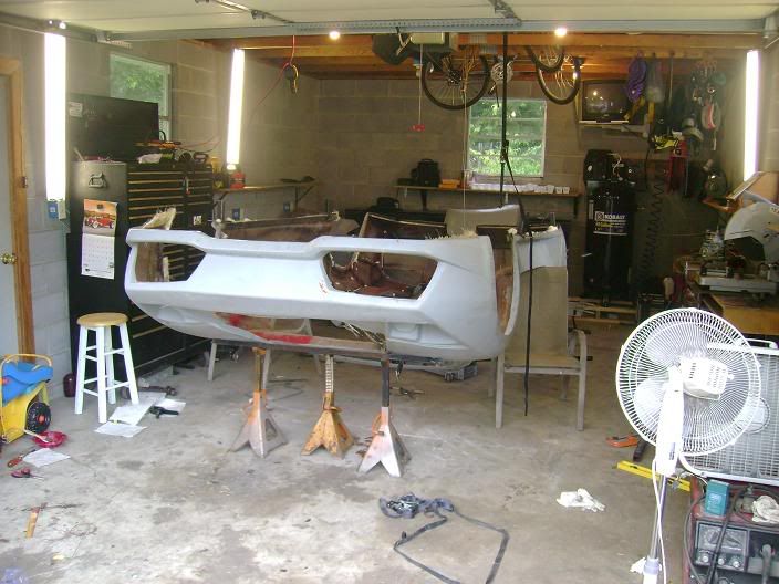

      the kit is sitting on there... ill take some more pics today... i gotta lift the body off.... my problem is .. there is no motor or wieght on the car so the suspension is maxxed all the way up... if i put the kit on and set it to ride hieght. then when i get the motor in and put the wieght of the kit on the car will squat and sit too low.... so now i made some tube spacers to sit the fiero chassis and stock ride hieght of 7.5 inches and then i made some spacers to sit the kit at 5 inches. so the ride hieght will be set when the fiero squats for the motor..... so ill pull the body off glass some metal to it. weld on the spacers and take a bunch of pics........ hopefully tonight

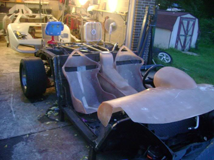

merciero (kelly21am@charter.net) MSG #71, 08-08-2009 11:59 AM

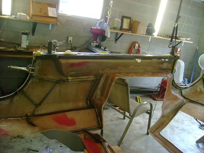

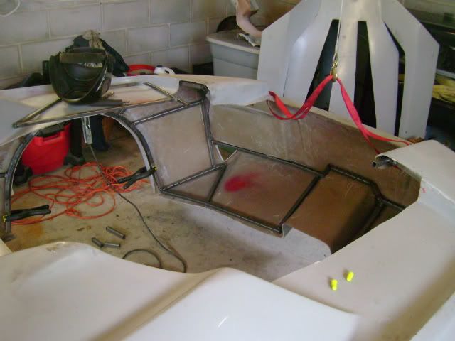

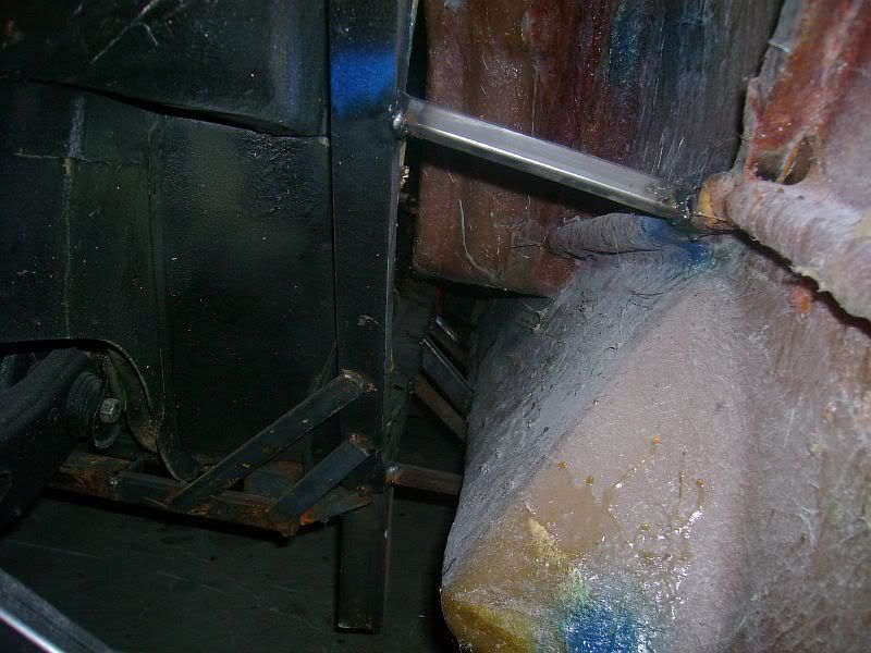

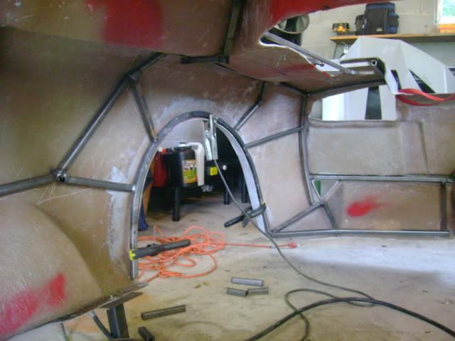

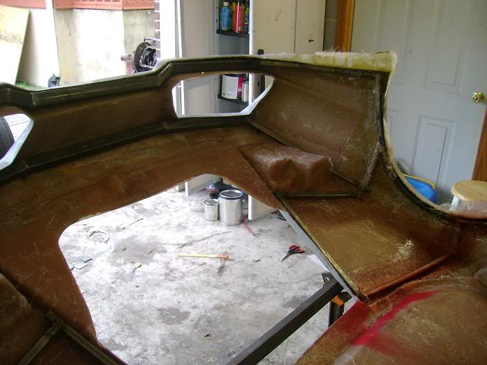

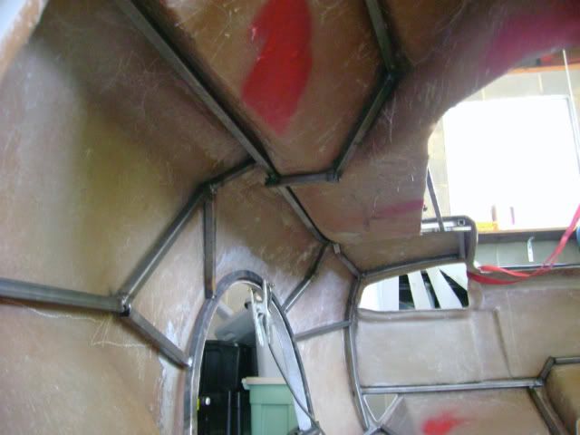

      ok i got a few pieces framed up with metal. now i just have glass it to the body piece........ i have the body off so i can clean up all my welds and edges becuase they look rather crappy... here are some pics of the trouble areas that had to be cut
Rickady88GT (rjkmfam@sbcglobal.net) MSG #72, 08-10-2009 09:02 PM
      That is a lot of work.
You might want to put a seat in and check the steering wheel to driver (chest) clearance. Mine was about 2-3 inches closer with the new column and wheel. I am not sure exactly how much longer the column is but the steering wheel definitely "thicker" because of the deep dish for the air bag.
merciero (kelly21am@charter.net) MSG #73, 08-11-2009 08:29 AM
      yeah i need to check it but i gotta get the body on so i can check the steering wheel to windshield space also.... im cutting metal for the body right now so ill post picks of how to get the body ready for mounting in a day or so.

      Nice work! A very clean stretch too. I'd like to have my 3"-er come out as nice as yours. I saw that the passenger foot well is bashed in, I hope the frame wasn't warped during the impact.

      When are you going to add the window frame support? Make sure you tie that to all the undercarraige stuff you are doing. You will get some movement from side to side if you don't. Also make sure you use a thicker wall tubing in this area.

merciero (kelly21am@charter.net) MSG #76, 08-11-2009 07:19 PM
      well im going to frame the entire body and glass the metal to it.... then ill sit the body on the chassis and weld the 2 together.. and thanks RUNDLC i never really thought about that... attaching it to the undercar supports will strengthen the windshield area so much and stout up the whole upper half of the kit...... very good idea. i like the metal work on those 2 builds. once mine is cleaned up and all together i hope its half as clean....... but im waiting to do my skeleton of the body.. i need my wife to get off my ass for a day or 2..... and when she works i gotta watch our 14 month old...... so my build is starting to slack......

      If I were you I would not f.g steel into the body, they expand at different rates you only need to use window urathane to mount the body to the steel, that the way it been done for a long time, once curred it's not going anywhere. Study the pics that I emailed to you and they should help. Do you have the correct tires and wheels yet? I would want them on prior to bonding the body down.

      RUNDLC i like you, your a real stand up guy........ another thing, you say bold the metal to the body with the urathane.......... it wont come loose down the line? my body doesnt touch the chassis anywhere..... i am building an entire skeleton of the body.... so i will have alot of metal on it...... i doubt it is going anywhere but..... i just wanna be sure.... MikeV. does his like that...... he is who i got the kit through... his kits come out very good... but he also told me to put coremat in between the metal and body.... im using very thin foam.... in between the metal and kit..... but can you send me a few pics of your build how you mounted the diablo. other kits like mercie me, mercenary, and anyones else kinda sits on the frame in certian places to help hold it.... but mike modified this one to fit a boxster so everything was removed..... now nothing touches the frame..... so i have to suspend it in the air with the metal i add....... im just worried bout the kit coming loose..... what do you suggest

merciero (kelly21am@charter.net) MSG #82, 08-18-2009 09:07 PM

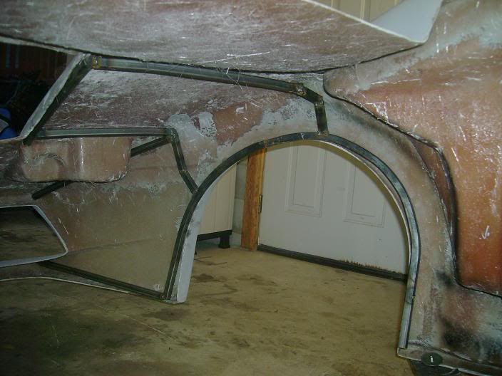

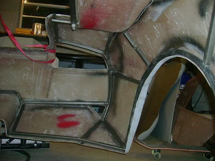

      here is a lil bit of the metal in the rear not all of it is in there but you get the idea. its alot of metal but it doesnt wieght as much as you think. i want it to be strong. but the interior is sitting on the car as well... for reference
merciero (kelly21am@charter.net) MSG #83, 08-21-2009 04:54 PM

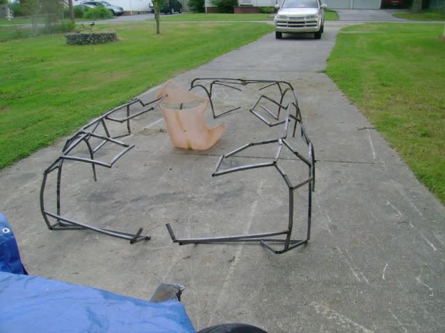

      ok sat i weld up the other side and then pull the skeleton out to grind it up

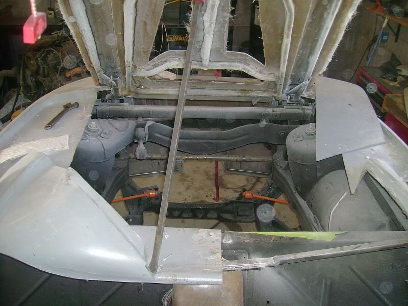

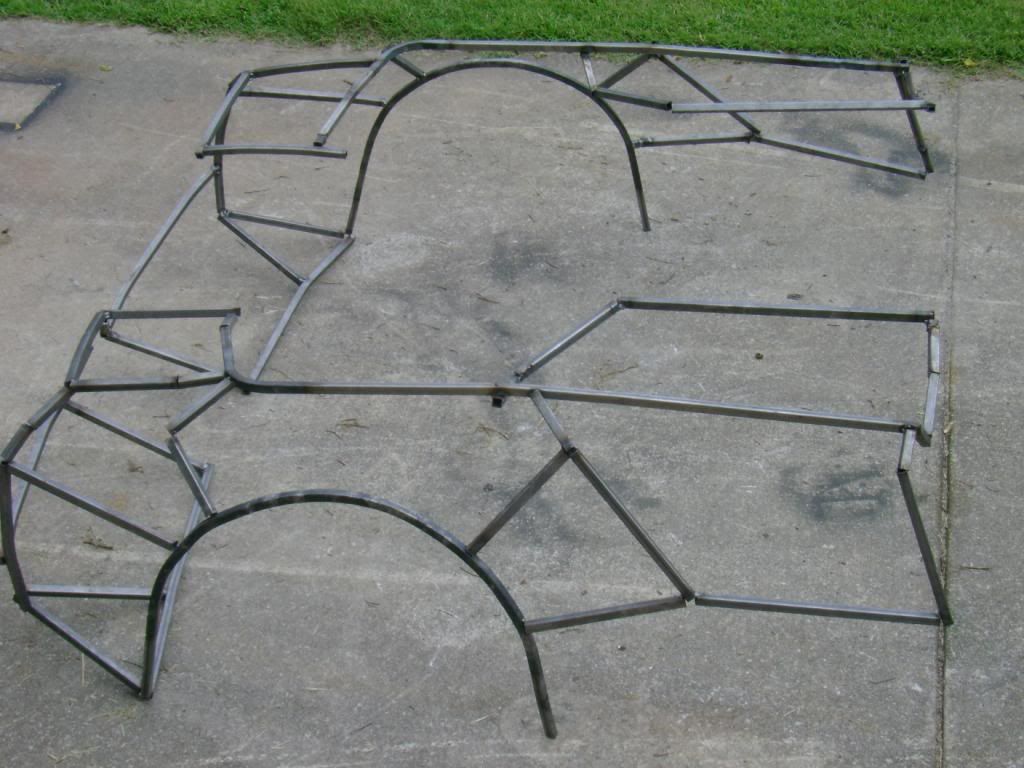

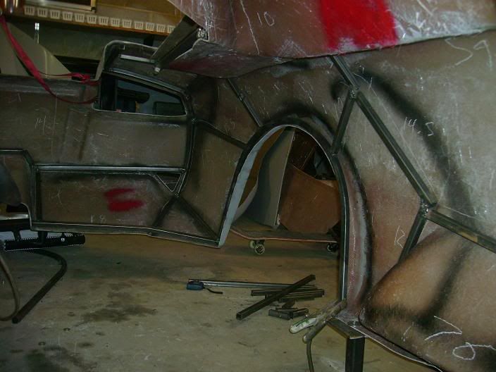

      ok i got the rear all mocked up and pulled the frames out to get welded and grinded down... then i will epoxy the frames in the car weld the 4 frames together with some braces and 1 1/2 tubing that goes under the door jam. so it will be one large solid subframe... and then fiberglass the frame to the body. .. here are a few pics of the frames you can kinda get an idea of where im coming from..... also the batwings i just got done with... i framed it up and designed a hinge so they will actually be functional.....
merciero (kelly21am@charter.net) MSG #86, 08-24-2009 09:52 PM
      welding up the gaps and joints, grinding and just got done attaching the deck lid to the frame.... hopefully it turns out good in the morning

What happens if you need to remove the Gas tank for any reason?

      the skeleton is looking awesome ,it should give the body a strong feel,if i were wearing a hat it would be off to you right now sir.
you are kicking ass dog

      thanks guys im glad your enjoying the build....... first the gas tank can come out the braces are removable under the tank...... next, i just got done fighting the skeleton pieces back into the car.... very tight fit..i put a thin foam strip on all the metal that is touching the kit to keep a tiny gap between them .. now i will connect all four pieces together, then glass them in............. yeah!!!!!!!!! almost time to mount..

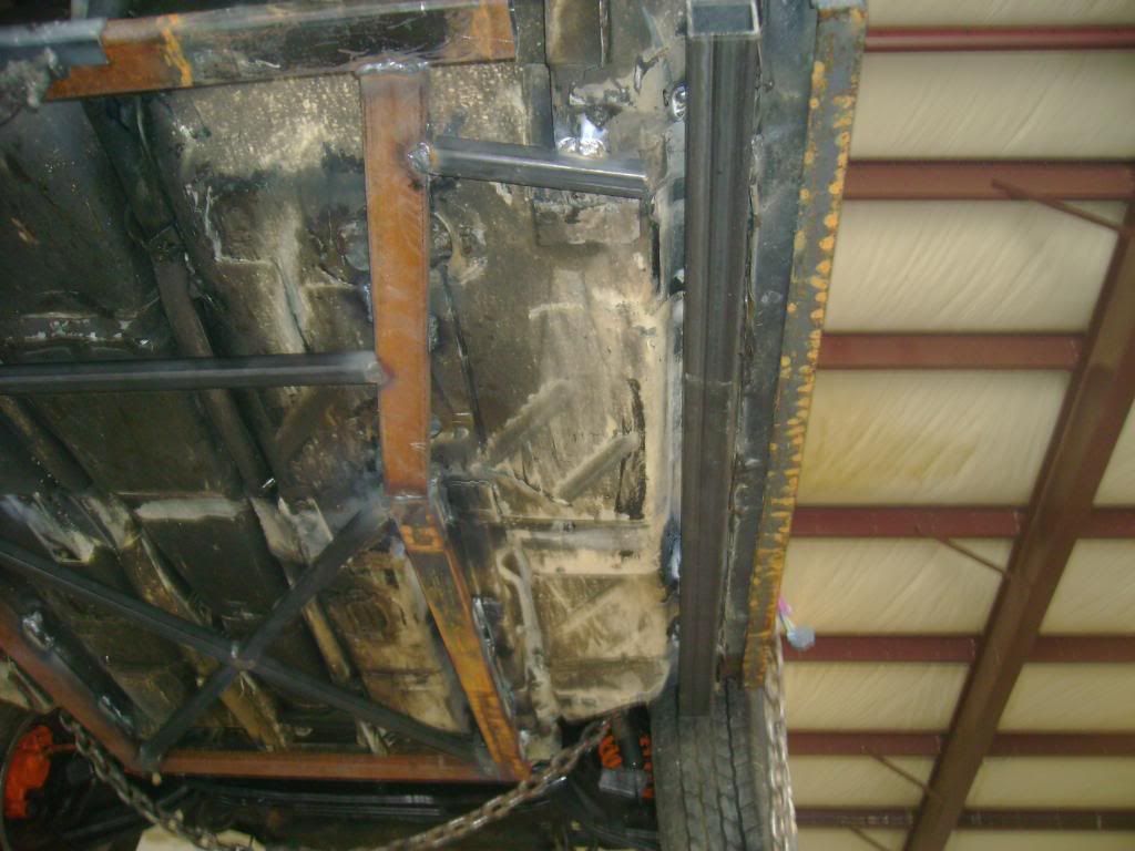

merciero (kelly21am@charter.net) MSG #92, 08-29-2009 09:29 PM

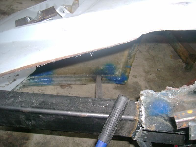

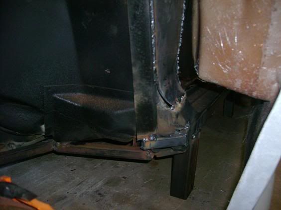

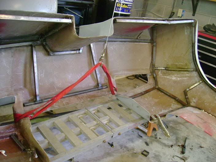

      ok just got all the subframe connectors done, all the front done and all the rear done... everything is connected..... its freakin solid.... ill get some pics tomoorow
Amida (robert.kusakabe@comcast.net) MSG #93, 08-30-2009 10:00 AM
      Wow! Is this a lightweight sportscar you're building, or an armored personnel carrier?...JJ. Nice metal work.
[This message has been edited by Amida (edited 08-30-2009).]
merciero (kelly21am@charter.net) MSG #94, 08-30-2009 03:24 PM
      lol well i was waiting for someone to ask that or say something about the wieght... its actually very light. put it this way every bit of the metal im putting on is lighter then one firero door. so im not adding much wieght at all. i carried all 4 pieces or frameing out to the driveway all together at one time..... and it was no heavier then maybe 1 wheel. so its very light.. and its only like 18 guage metal
merciero (kelly21am@charter.net) MSG #95, 09-01-2009 07:13 PM

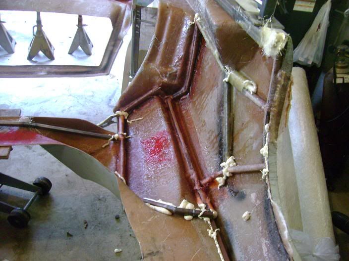

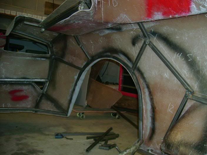

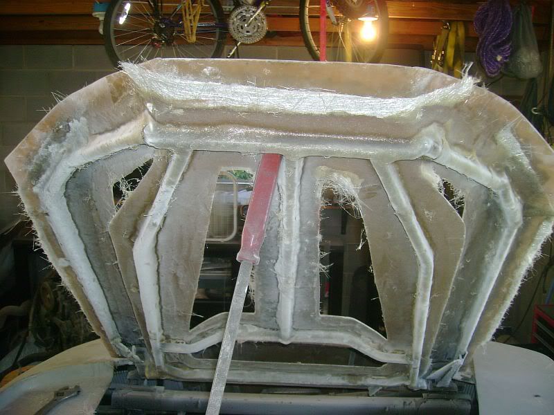

      ok got the body flipped over.... which was very hard to do.... glassing the metal to the kit..... i sprayed expandable foam in all the gaps and holes so its solid.

merciero (kelly21am@charter.net) MSG #101, 09-04-2009 10:08 PM

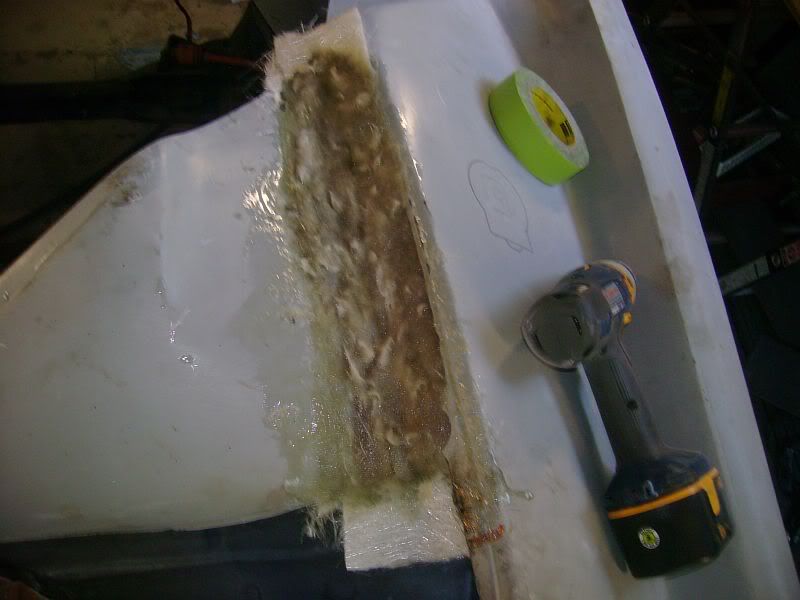

      thats a sick lil bunny........ but i got all the fiberglass on the rear done ill take some pics tomorrow... now im welding up the windshield frame... pics comin soon.. im calculating metal wieght. and im somewhere close to 250 lbs for all the metal i added thats bought the wieght of the stock doors. huh?
merciero (kelly21am@charter.net) MSG #102, 09-07-2009 08:14 AM
      yes good luck fast...... ill post some pics of a step by step way to do the stretch the best way................. but i finally got all the glassins done, all i gotta do is finish the wimdshield frame and im ready to mount. pics later today

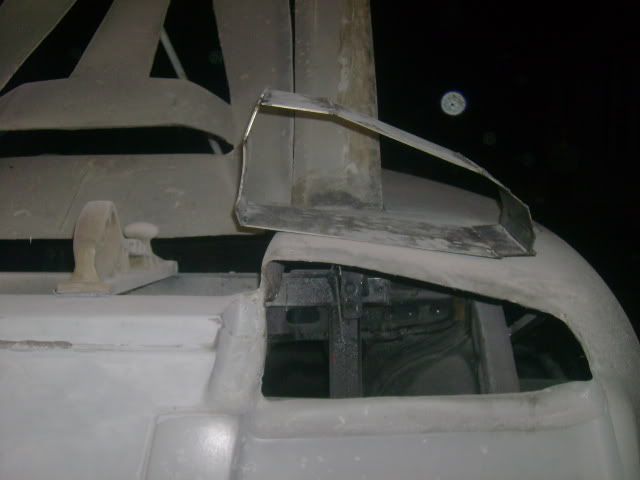

      yeahhhhh window frame is all welded up and glassed in.... now its time for squaring up and mounting........ pics friday

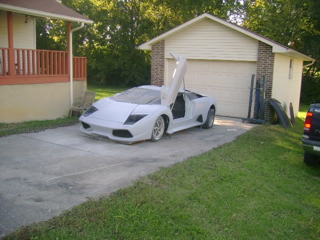

merciero (kelly21am@charter.net) MSG #105, 09-26-2009 02:54 PM

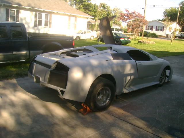

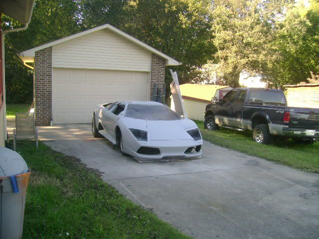

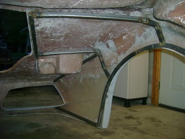

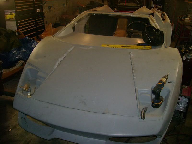

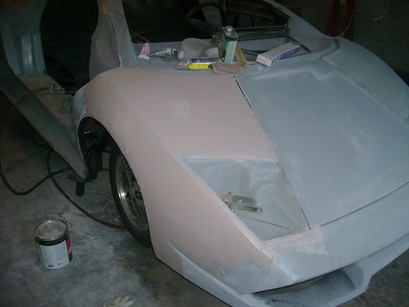

      ok i got the entire kit mounted, all brackets, everything.... i got the hood done, and the latch is just a normal latch off a utility tool box. works very well. i had to straighten the kit, the area behind your head was crook-ed, so i straightened it up but that made the decklid and batwings not line up.... so i gotta fiberglass them. i also got the decklid hinges welded up. here is a diagram of where i put metal for the skeleton, ill get some pics tomorrow. i also undercoated the entire underside of the kit, to protect the metal, make it look pretty, and to quiet down road noise...
merciero (kelly21am@charter.net) MSG #106, 09-26-2009 02:56 PM
      black is 3/4 tubing and grey is 1 1/2 tubing
exoticse (exoticse@netzero.com) MSG #107, 09-26-2009 03:45 PM
Merc,
Did you talk to MM on the kitcar forum about getting a set of his working bat wings ?
merciero (kelly21am@charter.net) MSG #108, 09-26-2009 11:17 PM
      i already made my batwings work,,, its a lil different then MM. but the hinge was inspired by his work...

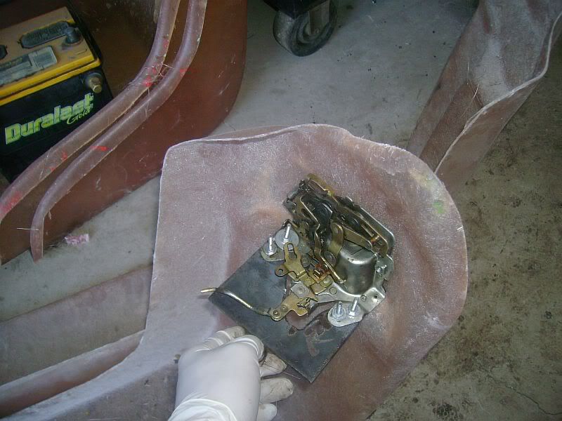

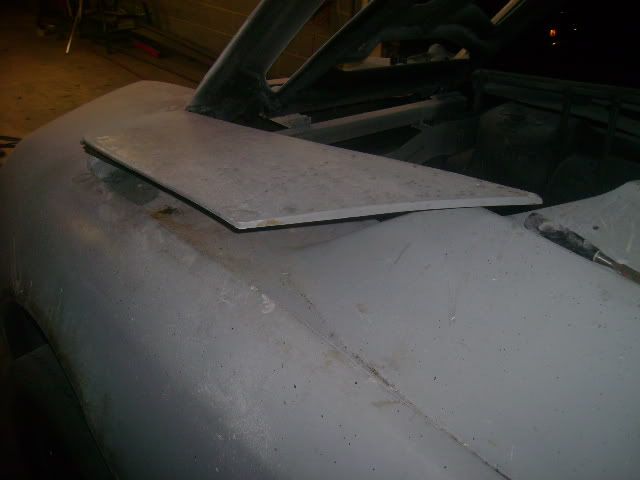

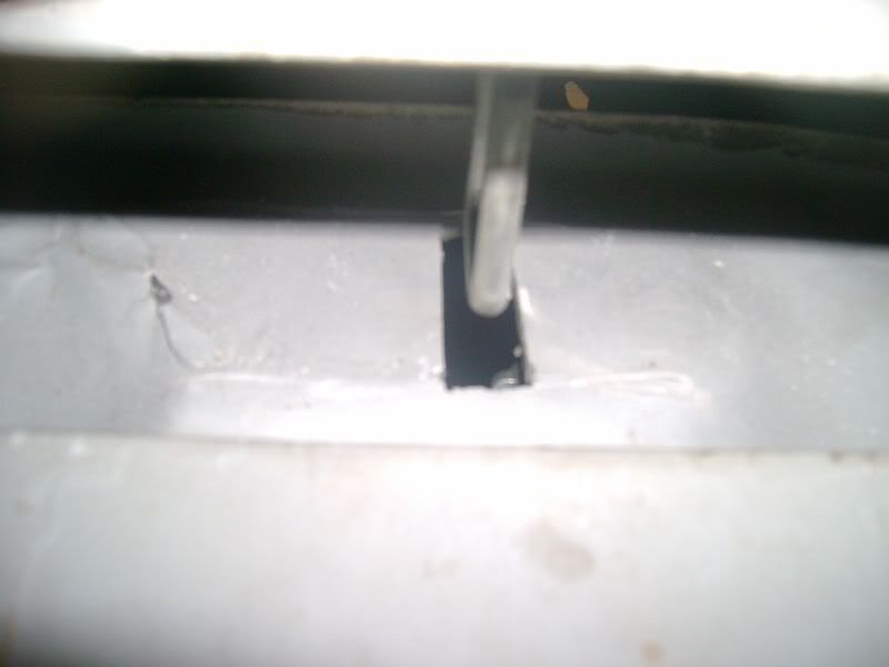

merciero (kelly21am@charter.net) MSG #109, 10-01-2009 08:55 PM
      heres the hinges i used.... older jetta
hood attached
bracing to hold the body
body now mounted
hood latch done

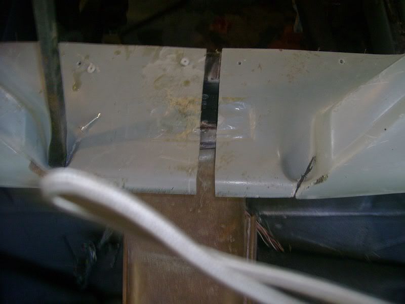

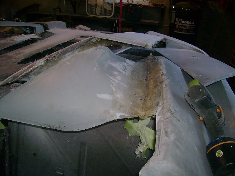

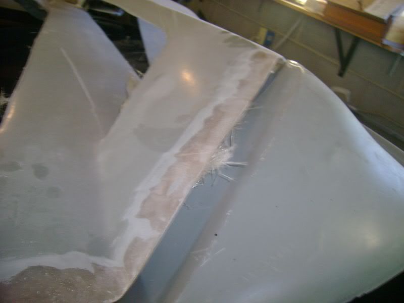

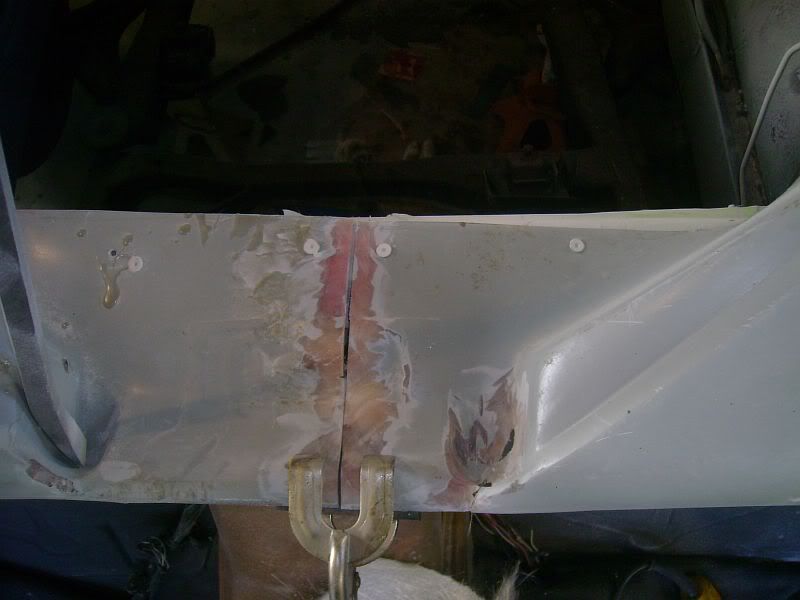

now here is my trouble area.... the kit was molded not square, so when i mounted the body the upper rear portion was off... causing the deck lid to no line up.... instead of reworking the decklid, this is what i had to do..
heres before
heres after
glassed in the metal for the decklid
my merc latch ill be using, i made a plate to bolt to it to help with mounting strength
my wheels im using... decided to go with 19 giovannas bc i got them from a guy hard on cash for $300!!!!!!!!???????:::::"""""""""
skin wiped the fender to test the body

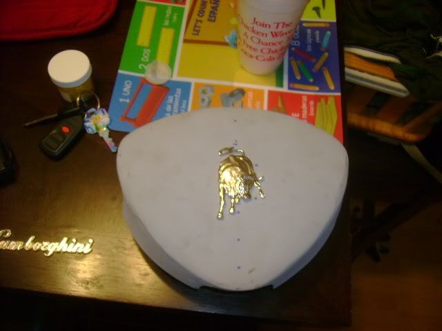

i glassed up the blown airbag off the GP steering wheel and put a bull badge on..ill paint it the same color as the car... im deciding if i should leave it or glass onto it to make the bull look kinda 3d in the airbag, you know so its all kinda flush looking

      ok big problem.... i put the wheels on the car to move it and my damn rear wheel fell off.... the hub seperated..... do i have to have the axle in to hold it together or is my hub just shi**y... now i need another asap
fieroguru MSG #112, 10-03-2009 07:34 AM

      ok well today ive been at battle with the batwings....... because of how i did the frame on mine and how i did my hinge, it would open and shift inward pushing the wing into the decklid...... so i spent 3 hours trying every kind of hinge i had.. cutting welding nothing worked...... so as i was about to downshift to defeat, i noticed a hinge inside our cabinet.... i pulled it off and went outside and tried it.. that was followed by me yelling at my wife to suit up and get in the car... were heading to lowes.... i found a 3 axis butterfly hinge very wierd... but i removed the spring out of it.... and it would open up and out at the same time.... so i bought 4 of them... welded them up and presto.. it worked flawlessly.... ill get some pics tomorrow....

merciero (kelly21am@charter.net) MSG #118, 10-12-2009 07:48 PM

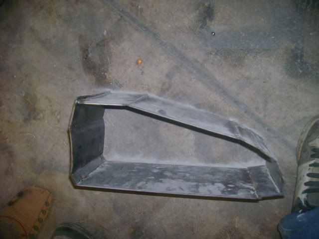

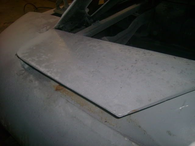

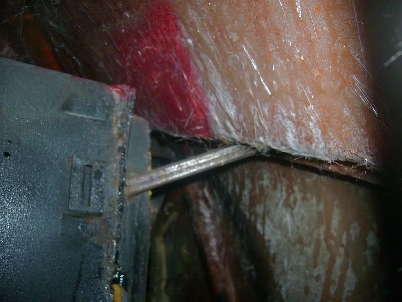

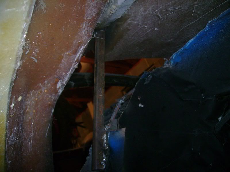

      here are the pics of the batwings....... i also made a template of my tailight... and made a metal bucket to hold the sonota taillight guts...... this allows me to mount the light so it is removable
and the taillights

merciero (kelly21am@charter.net) MSG #121, 10-20-2009 04:52 PM
      here are some pics of it kinda back together.. i got bored so i black primered some spots just for the hell of it... and i mounted a door. its not mounted just there...

      Nice work on the car!!!! I have also been looking at rims, and had seen other rims somewhere in a link in this thread that was suggested by another member here . Maybe it was Dash, the rims looked like diablo or murcialago style, I also think i remember the kitcar being yellow, not sue Can you point me out to the link, or who ever remembers the rims i am searching for, THANKS GUYS!!!

      wow been a while since i was on....... on the wheels im not sure on here but.. if you want some deelow rims, lemme know. i can get you a set or piont u in the right direction. but i had to take a hault on the project for a lil. we're buying a house, and i get to finally build my dream garage so once its done ill jump back on it.

      Hey merciero, so I finally found the style of rim i am looking for, Except the particular manufacturer only makes 15" and 16". Now that i have a photo showing exactly what i had seen somewhere in this post maybe you or someone will recognize it and help me get a name, thanks and keep up the good work!

      well im back on the build after a long break. i just got one of the doors done. pics come soon. i used the doors of a 92 saturn sc1. i cut the doors all to pieces and left only the main metal guts/sheet the window motor a tracks. and im glassing it to my inner door fiberglass piece
