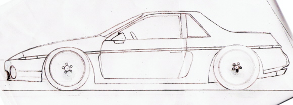

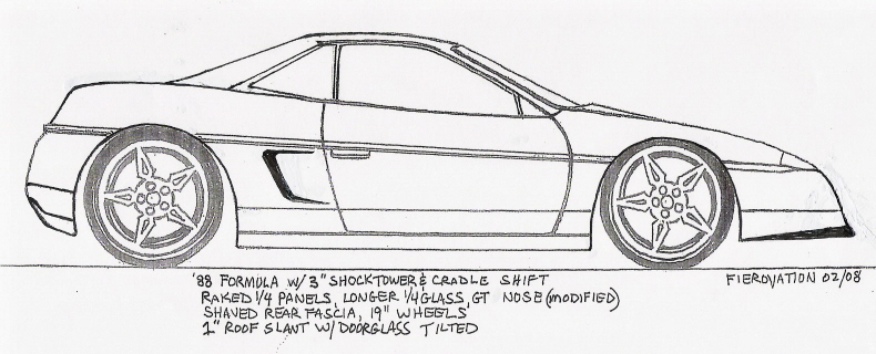

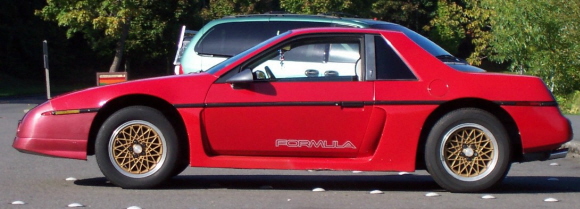

This is just an idea I had for a long wheel base Fiero. The photo of the Fiero is one that I found on this forum and then ran it through Photodeluxe for modifications. It's still a work in progress, but the extra length gives the Fiero a whole new look. Next I'll try curving the windshield, and the roof needs to be lowered at the rear to give a more tear drop look. Any thoughts?

This is another idea for the notchback. It's a 3" cradle shift with modified body line & curved windshield. The nose is actually a panel that I'm currently working at re-designing afterwhich I'll produce in fiberglass.

      It's nice, but if I were going to stretch a Fiero I would stretch it enough to make a 4 seater.
Arns85GT (arnellen@rogers.com) MSG #4, 02-11-2006 06:35 PM
      Stretch looks good in profile....but......
You end up with the chassis geometry so changed that you have serious handling issues. The balance of the car is completely changed with increased rear end bias. Good for straight line but a problem for maneuvering. Just my .02
Arn
Custom2M4 (custom2m4@hotmail.com) MSG #5, 02-11-2006 06:37 PM
      Its been done many times for kit cars, and twice that I can recall on fieros. Do a search for Bubba Joe (I believe), he stretched his car like that, dropped in a big motor, a porshe transaxle and a big rear end .

Amida, that's pretty nice but I think it has a loooong nose which was long enough to begin with

      The length of the nose is actually still stock Fiero, but I did remove the IROC type rake at the very front and lower the bottom edge.

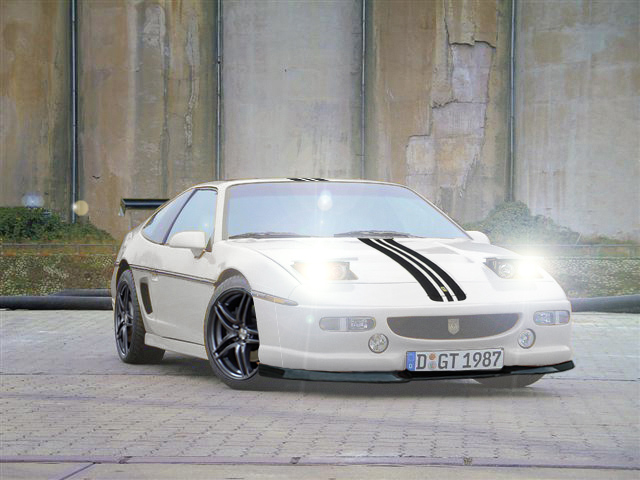

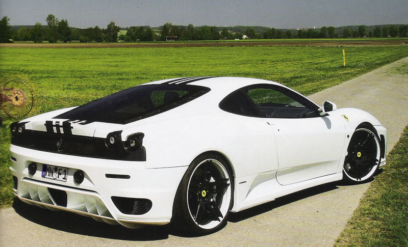

Automoda MSG #8, 02-11-2006 11:28 PM
      I've posted this before but why not again. The subject is perfect for it....
Amida (robert.kusakabe@comcast.net) MSG #9, 02-11-2006 11:40 PM
Wow! Very nice. Is there more info on the forum for that car?
jscott1 MSG #10, 02-11-2006 11:53 PM
photoshopped

o wow... i like that alot..fiero lambo hybred hehehe {/evil thoughts]

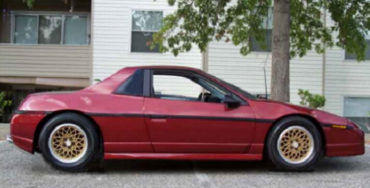

Amida (robert.kusakabe@comcast.net) MSG #21, 02-27-2006 02:40 PM

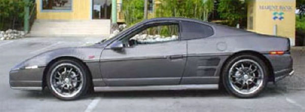

This is what I had in mind for the coupe from my previous drawing. It's a stock '85GT with some bodyline modifications. In addition the drivetrain/cradle is shifted 3" back and a new curved windshield is added. My design goal is to give it a slightly modified look while maintaining a stock factory appearance.
Custom2M4 (custom2m4@hotmail.com) MSG #22, 02-27-2006 03:04 PM
      Personally I'd say the rear looks a little funny now.. maybe if you lengthened the rear bumper a few more inches it would look about right.. and you missed the tail lights :P.

Amida (robert.kusakabe@comcast.net) MSG #25, 02-27-2006 07:18 PM
It does look funny. This time I put the stock rear bumper pad back in the photo. Not bad.

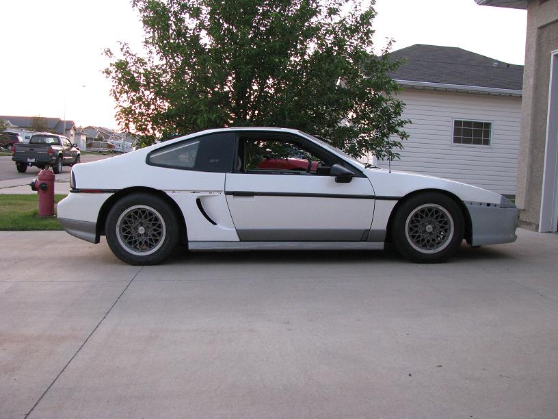

86GT3.4DOHC MSG #30, 02-28-2006 01:56 AM
      Unfortunately you would have the cronic tranny and engine mount problems found in the dodge applications, lol.
As far as a stretched Fiero, I took this pic last summer of a stretched and slammed 88 GT
ugh I cant get it to upload, ill post it later
crzyone (crzyone@cablerocket.com) MSG #31, 02-28-2006 06:35 AM
      My intrepid has 130k miles on it, no trani or mount problems. My 3600lb intrepid used to wax my 2.8 fiero from a 40mph roll. The fiero being 1000lbs less would mean less stress on the transmission, until you turbocharge it.
86GT3.4DOHC MSG #32, 02-28-2006 09:45 AM
      Working at NTB I saw a lot of dodges longitudinal FWD cars, almost all of them with any miles on the had bad or loose engine and tranny mounts. I always thought the whole idea was kind of retarded, when you hit the gas, the engine torques to the side and the tranny torques to the front, throwing stress on the mounts from all angles. Nor could I ever figure out what advanatge this setup has. Seems to me it has even more power loss because the power has to change directions, a *90 gear angle takes more power to turn then a straight angle.
But anyway, heres the pic
crzyone (crzyone@cablerocket.com) MSG #33, 02-28-2006 09:59 AM
      Since the engine is directly bolted to the trani there is no twisting forces at all. The only forces are those applied from the trani to the axels, just like a fiero. Since it has equal length axels, there are even less forces being applied than in a fiero. You are correct about the parasitic loss though, you do loose some efficiency transfering the power 90*.
You only get twisting forces when you have a driveshaft. Some newer cars such as the corvette have a solid shaft around the driveshaft that is directly bolted to the motor and trani which is at the rear of the car. This neutralizes any twisting forces on the frame.

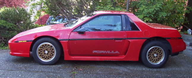

Amida (robert.kusakabe@comcast.net) MSG #34, 02-28-2006 01:03 PM
A transverse drivetrain in a FWD layout? I wonder if a 3800sc could be mounted to this tranny.

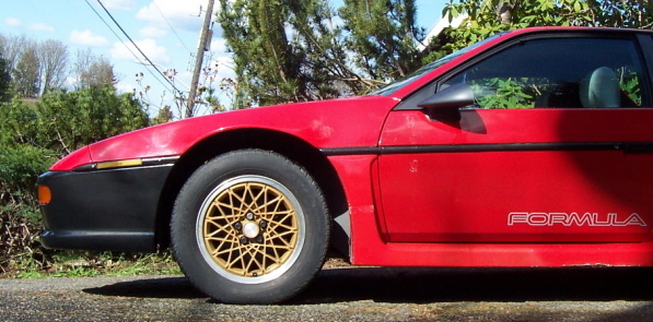

I have a stock '88 Formula that I'm thinking of modifying. l'll probably start with the stock wheel base ideas in the above image. Modified rear qtr panels, upper door panels, & front nose. Also, replace windshield with more rounded piece & shortened bonnet.

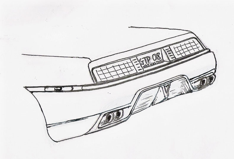

Thanks. I'm still working on the XLR version; will post drawings when I have something. But I am working on a design buck for a new GTP replacement front fascia. It's similar to the one in this photo but without the Sunfire headlights and it's for the stock Fiero.

I like where your going with this , show us more plz. Joe

pavo_roddy MSG #42, 03-02-2006 02:13 AM
HI all,

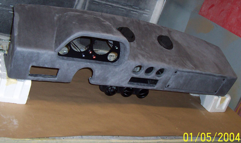

Amida is the extended windshield in the above pic installed, or is it photoshopped in?? If it is installed I would love to hear about it, and see some more pics..... Particular interest is cold air return function with the new windshield and wiper mods......

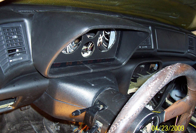

edit: Amida do you have a website?? Also, did you know that the website for your interior is not working anymore??
[This message has been edited by pavo_roddy (edited 03-02-2006).]

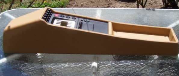

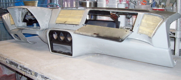

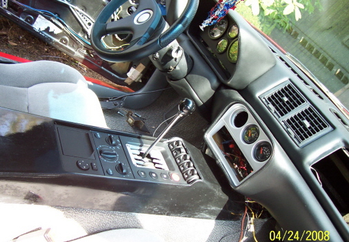

Amida (robert.kusakabe@comcast.net) MSG #43, 03-02-2006 06:28 PM
      My interior photos were put up courtesy of Jim Dinner. He may still have his build diary webpages but under a different link. I will be putting up a few webpages for my front fascia designs: GTR(512tr), GTP, & GTO. I'll have the 355 interior pics on there as well. It'll save me alot of time instead of having to e-mail pics all the time over a dial-up connection. I've had this bug in my ear to do the curved windshield thing to the Fiero. The image is Photoshopped, but I'm looking into having a few pieces made for me. The wiper mods looks simple enough to do, according to the kitcar guys.

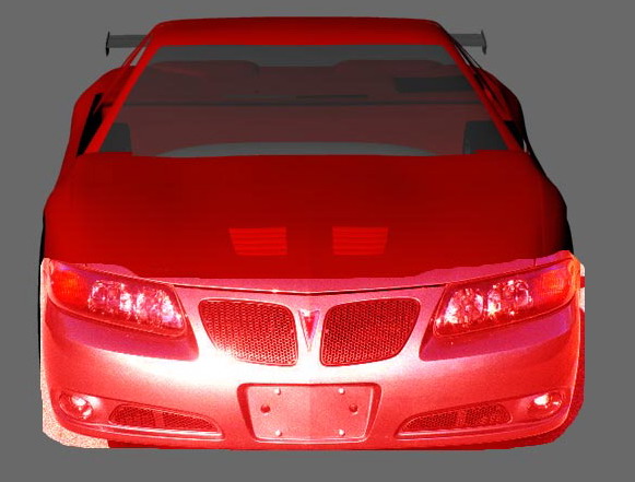

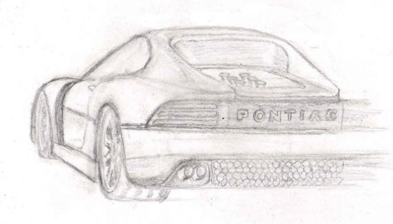

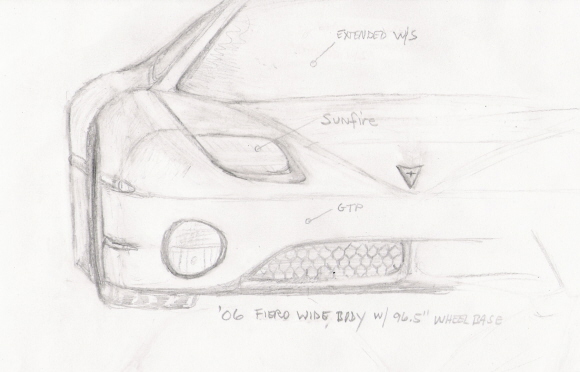

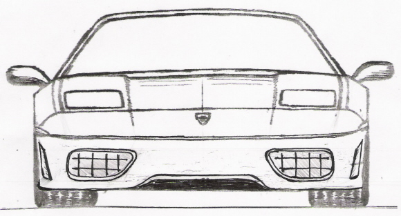

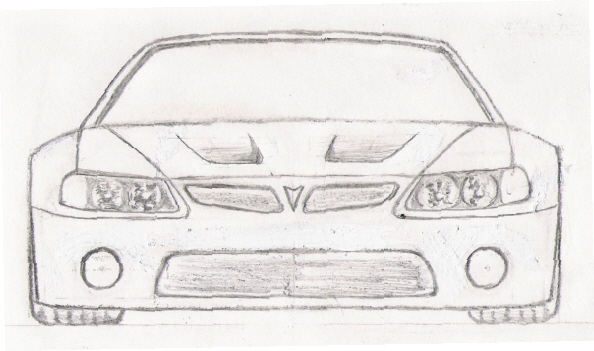

Amida (robert.kusakabe@comcast.net) MSG #45, 03-02-2006 10:45 PM

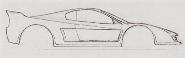

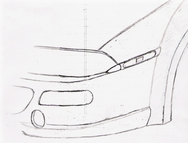

This is just a very rough sketch of the full frontal view. I just needed to get some ideas down on paper. I'd like to start a project like this sometime. My design goal is to achieve a look that is very Pontiac & Identifiable as a Fiero while blending in more current body lines. I'll try to utilize existing off the shelf parts too.

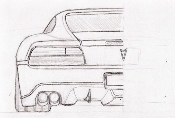

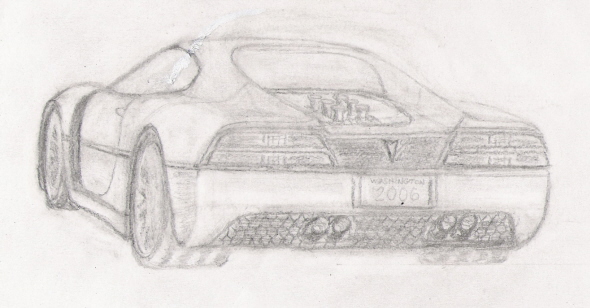

Amida (robert.kusakabe@comcast.net) MSG #47, 03-03-2006 06:11 PM
A little adjustment to the rear sail panel; much better. Notice that the layout is mid-engine, changed from front engine on the original XLR. I actually think I'd buy it- if it existed. Perhaps it should be called Northstar XLM.
[This message has been edited by Amida (edited 03-03-2006).]
pavo_roddy MSG #48, 03-03-2006 06:43 PM
      Hi all,
Your photoshop skillz are great, and your ideas are off tha hook!! 1 question that is bugging me, why the 3 inch stretch??
Amida (robert.kusakabe@comcast.net) MSG #49, 03-03-2006 07:51 PM
      The 3" stretch is mainly to lengthen the look; to give it a more cab-forward bias. I understand that 3" is about the limit for shifting the cradle back & leaving enough room for coil-over struts. No chassis cutting. I suspect that with a Northstar that the towers will need to be notched for pulley clearance.

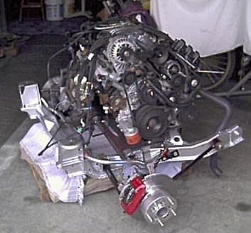

crzyone (crzyone@cablerocket.com) MSG #50, 03-03-2006 08:28 PM
      Only on 88s. My N* doesn't interfere with my strut towers, but then again I only have about 1/4" clearance on the passenger side.

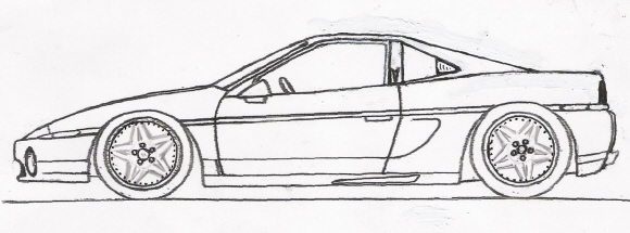

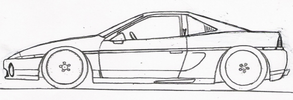

doublec4 (doublec4@hotmail.com) MSG #51, 03-03-2006 08:59 PM
      cool drawing...
I outlined it so if somebody wants to splash some color on it they can
Amida (robert.kusakabe@comcast.net) MSG #52, 03-03-2006 09:49 PM
      Hey, that's cool man! What program does that outlining? It's nice to see it cleaned up.
That's pretty darn tight. I'll have to comb through these topics to find out more about N* in Fieros.

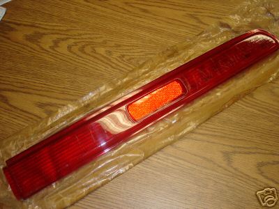

      I think I found your taillights
Amida (robert.kusakabe@comcast.net) MSG #65, 03-06-2006 05:42 PM
      Close, but actually from '78 Pontiac Firebird.

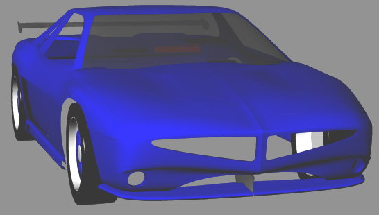

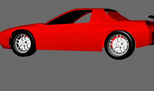

RCR (rcrabine@comcast.net) MSG #69, 03-07-2006 06:23 PM
      Well, this is kind of what I was thinking. What do you think????
I tried to keep some old school Pontiac, along with the original Fiero lines. I'm partial to Notchies, too. It's preliminary and rough. Feedback welcome.
Bob
Amida (robert.kusakabe@comcast.net) MSG #70, 03-07-2006 07:25 PM
      Looks Good Bob. I like the slant of the bodyline & sail panel. I see the Pontiac style nose vents as well, pretty nice. Maybe add an airdam underneath for ground effect. Cool.
I think Custom2m4 is on the same page.

Amida (robert.kusakabe@comcast.net) MSG #71, 03-07-2006 07:34 PM

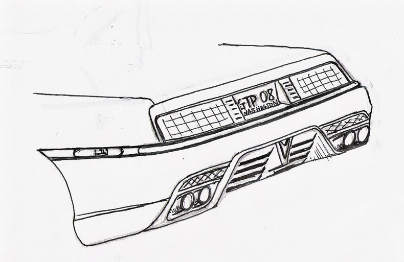

      I had to finish sketching the rear end before I lose my vision. I've incorporated a Toyota MR2 rear window & Firebird taillights. Cleaned up some of the lines. With both the front & rear drawn on paper, I think I can visualize what a side profile will look like. Next, I'll try to sketch something to connect both ends.
[This message has been edited by Amida (edited 03-07-2006).]
GonsaiPK MSG #72, 03-08-2006 12:32 AM
Bob
The part I like most about this are those side scoops. Would lookamazing translated to a shaved Fiero, and it wouldn't be too hard to do (assuming you had the skills to shave it in the first place).
RCR (rcrabine@comcast.net) MSG #73, 03-08-2006 12:40 PM
      Thanx....
I agree. My splitters are too small. Maybe I'll bring it all the way across with a stand in the center. Hmm??? I also want to round off the edges of the front fascia to the fenders.
Also,
It's hard to see in the pics, but the back pic shows that I'm using Mcaanda's styled rear decklid vents. I need to finish them up and get better models printed.
Bob
[This message has been edited by RCR (edited 03-08-2006).]

RCR (rcrabine@comcast.net) MSG #81, 03-09-2006 09:35 PM
      Fieroman: I'm using Rhino3d.
Amida: I like your idea. I was just looking at the inlets on the 69 & 70 Firebirds, too. I might go more like that and incorporate 99+ Grand Am head and tail lamps, or the newer Bonny tail lamps. So many decisions. Good thing it's just in the computer. This could get expensive trying to do it for real.
Bob

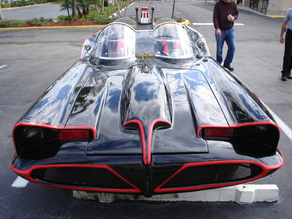

exoticse (exoticse@netzero.com) MSG #83, 03-09-2006 10:35 PM
      [QUOTE]Originally posted by qwikgta:
I always liked this stretch concept.
Rob

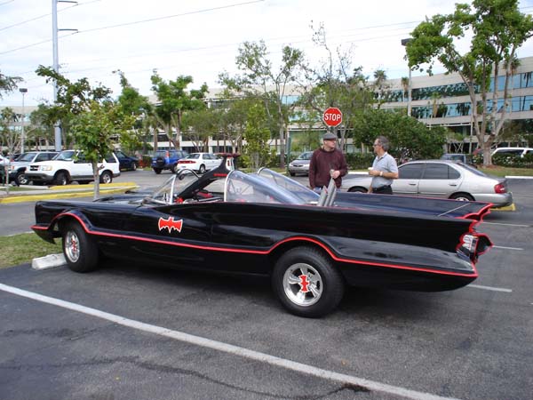

i have been trying to get ahold of this guy to see if this project was ever finished, and i am pretty close to getting ahold of him.
Apparently this guy, Mark Towle, is one of the world's leading builders of reproduction Batmobiles. This is one of his recent cars built for a customer (here in Florida i believe ?).
His shop is in San Bernardino, California and apparently fittingly it is pretty stealth,..the only thing that reportedly might catch your eye, is a bat logo on one of the doors hehehe.
** edit to update, i have made contact with him, see below **
http://www.fiero.nl/forum/Forum1/HTML/058013.html
[This message has been edited by exoticse (edited 03-10-2006).]

engine man (fieroa8@gmail.com) MSG #86, 03-10-2006 12:20 AM
      I like the strech that Automoda posted on page one did you chop the top when photo shop or is it just steched and how much of a strech do you think to get that look i am realy thinking of buying an imsa gt body then having it streched and the top choped like v8 archie's i wonder if he would strech the car for me to
Amida (robert.kusakabe@comcast.net) MSG #87, 03-10-2006 12:30 AM
      If the silver 4-seater had a chop top it'll look like the red one that was photoshopped. I wonder if that project in the driveway photo was finished also; looks pretty exotic.
[This message has been edited by Amida (edited 03-10-2006).]

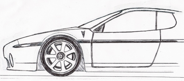

      A coupe with a longer stretch, 9" or so, may look like this drawing. Sail panels adjusted with slight body slope.

Amida (robert.kusakabe@comcast.net) MSG #93, 03-11-2006 12:27 PM

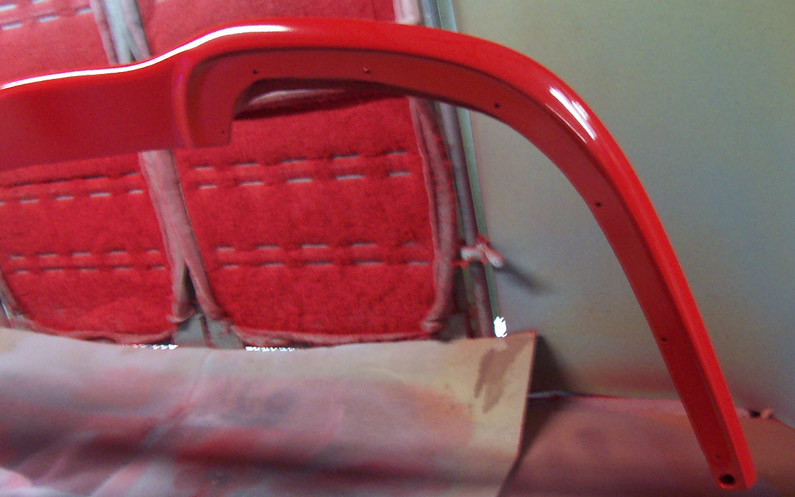

      Thought I'd add a fender flare kit to widen the track a little, & to keep things in proportion.
[This message has been edited by Amida (edited 03-11-2006).]
Amida (robert.kusakabe@comcast.net) MSG #94, 03-12-2006 11:58 AM
      Front view: Slight fender flaring, not much, maybe by 1" front, 2" rear. Lower chin spoiler as well.
[This message has been edited by Amida (edited 03-17-2006).]
Amida (robert.kusakabe@comcast.net) MSG #95, 03-17-2006 03:22 AM
      Here's the rear view of the stretched coupe with 2" flares, 9" rims, new taillights & honeycomb engine grill. Does anyone know what is the minimum stretch required to get a N*/Audi trans to fit into the Fiero?

      Thought I'd update my concept. What do you think...
Bob
Amida (robert.kusakabe@comcast.net) MSG #99, 03-26-2006 12:13 PM
      Like the front spoiler Bob. How about opening up the grill more for projector headlights? Also, like the broadened shoulders over the wheels.

Scott-Wa (smcelhiney@comcast.net) MSG #100, 03-26-2006 12:32 PM
Bob
I think it looks good... but also think it's turning into a corvair :-)

Amida (robert.kusakabe@comcast.net) MSG #111, 04-07-2006 04:52 PM
      Here's what I came up with for your side view:

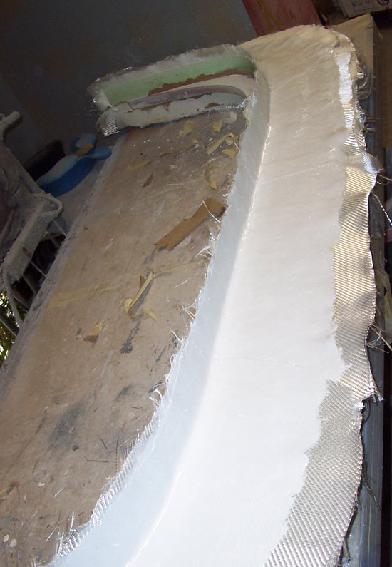

Custom2M4 (custom2m4@hotmail.com) MSG #112, 04-07-2006 05:00 PM
      I modified the rear end to how I will create it. The build up has already begun. It is only a matter of time.
Take a minute and follow my build, it too might give you a good idea on how you can build yours.
http://www.fiero.nl/forum/Forum1/HTML/058546.html

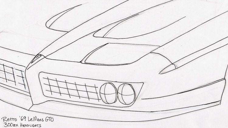

Amida (robert.kusakabe@comcast.net) MSG #114, 04-08-2006 12:48 PM
      Bob, That looks pretty tight! I'm gonna guess Bonneville ? Ya know I think the 300zx headlights will be perfect for that design due to the sharper/flatter angle of the bonnet/fascia. Even better yet the Vette C6 lights will better compliment the front intakes. It's amazing how you can update the look of the Fiero so much from just changing some details on the front & rear fascias.
Cleaned up some lines & added wheels on the previous drawing:
[This message has been edited by Amida (edited 04-08-2006).]

motoracer838 (jmartin@musicunveiled.com) MSG #116, 04-08-2006 01:23 PM
      Is it just me or is this begining to take on the look of an F 50 Ferrari as it evolves? Joe
Amida (robert.kusakabe@comcast.net) MSG #117, 04-08-2006 01:55 PM
      Good eye Joe, F50, NSX & R8 influence on side mounted wing stands. With the long lines of the '84 TA tail lights in Custom2M4's design, a long wing seemed complimentary. I might draw up a version without the wing for comparison. Amida

      Amida,
I saw a Bonneville driving behind me the other day. I thought the front would look kinda cool on the Fiero. I was thinking of using the tail lights at one time, so I guess it was a natural progression. Now I have to figure out how to model it. Hmm?
Your last drawing is pretty hot. I think you lost the Fiero theme somewhere, but I'd take one, hands down.

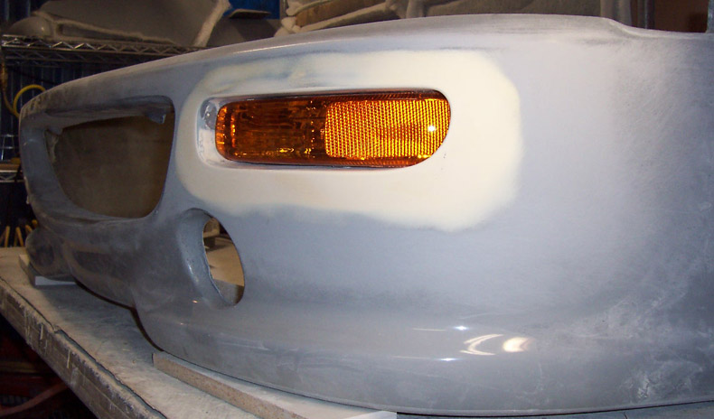

Amida (robert.kusakabe@comcast.net) MSG #131, 04-20-2006 03:53 PM
      This is a sketch of the new GTP type front fascia that I'm currently working on. It'll be a fiberglass replacement for the stock Fiero bumper cover.
Tusch (john.partusch@gmail.com) MSG #132, 04-20-2006 05:17 PM
      Thats a cool idea, I like the fiero like grill/opening. It looks stock but with a slight modern look, works well with the lights.
Amida (robert.kusakabe@comcast.net) MSG #133, 04-21-2006 10:28 AM
      That's exactly the goal of this design. To incorporate late model GTP lighting & styling cues into the Aero fascia in a way that will compliment the stock Fiero look without having to change anything else on the car. My thinking is if Pontiac designed a new Fiero aero fascia today that this is what it might look like.
This is a variation with top intakes. I haven't decided if I should include them. What do you guys think?
[This message has been edited by Amida (edited 04-21-2006).]
pavo_roddy MSG #134, 04-21-2006 11:53 AM
      Hi all,
I thinking that the snouts add that more agressive look to it that makes the fascia!! Also, Amida have you seen an extended windsheild installed in a fiero up close and personal like?? I ask cuz I am having a hard time seeing how to keep the spare tire compartment in a fiero sealed.... Have you thought about this at all??
RCR (rcrabine@comcast.net) MSG #135, 04-21-2006 12:11 PM
      Looks good Rob. I like the nose snout's too. I was trying to figure a way to incorporate them in my design, but I haven't quite figured out how to make them functional. I've played with adding the Bonny front to mine, but with the weather being nice, I've spent more time in the garage then in the dungeon (computer room in the basement).
keep up the good work...
Bob
Amida (robert.kusakabe@comcast.net) MSG #136, 04-21-2006 12:39 PM
      Pavo, I will have the windshield in my Formula hopefully in the summer. I'm going to figure out if it will make a feasible conversion kit.
I think the snouts still have a factory look, I could probably just make that an optional thing. To make them functional will definitely require fabricating a passage way through the framework; perhaps a duct that's about 1" tall. Thanks.

Kohburn MSG #138, 04-21-2006 01:03 PM
Arn
that would be somewhat true if it used a stock drivetrain
i did a few photochops years ago when i was planning to use a longitudinal tranny and engine setup in the mid engine layout - moving the wheels back without doing a stretch would allow it all to fit easily and would actually improve weight distribution over stock.
Amida (robert.kusakabe@comcast.net) MSG #139, 04-21-2006 08:20 PM
      A longitudinal power train would have a better weight distribution for sure, but if using Porsche/Audi tranny a longer wheelbase would be unavoidable.

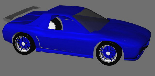

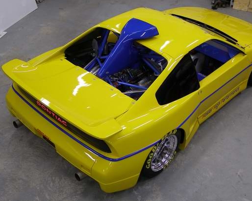

      Well, the Bonny fron was proving to be a real bi^#% to do, and what was coming out, I didn't like. So I scrapped it. I went back to my other design and refined it a bit. New nose, hood, skirts, etc. What do you think...
Bob
Amida (robert.kusakabe@comcast.net) MSG #143, 04-23-2006 02:06 PM
      Bob, Looks real good. I'd wrap the skirt around the rear bumper as well for more ground effect, maybe even make the skirt a little deeper. The hood looks like it has a cowl induction set-up. These wheels look alike.
fierogt3800 (fierochris@yahoo.com) MSG #144, 04-23-2006 02:10 PM
Bob
looks like the phirana to me
RCR (rcrabine@comcast.net) MSG #145, 04-23-2006 02:45 PM
      I will wrap the skirts around the back. Just not too sure how that will look, yet. I kind of modeled the skirts after Detmer's. I saw a post in the Mall and thought they looked cool. It just doesn't show up very well. I need to figure out how to do the "twist" function to make them right. I saw the wheels at tirerack a while ago. I don't remember the manufacturer, but I do have it at work. Now that the car is blue, it does look the Alex's Plazma. The Plazma is a little more outrageous, but although not intentional, I guess it was in the back of my mind. I could have picked a lot worse
Back to the drawing board...
Bob
Hmm, maybe the cowl induction can cool my amps....

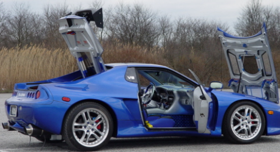

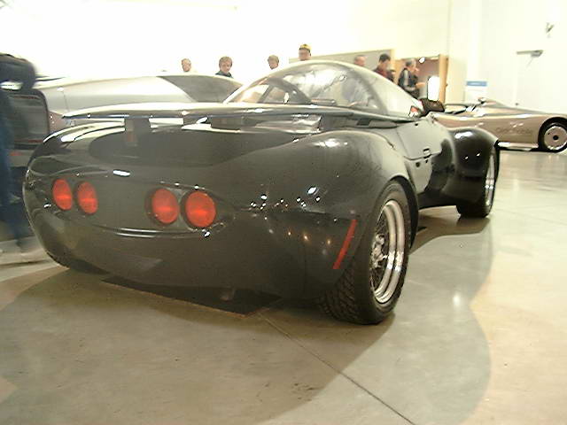

Amida (robert.kusakabe@comcast.net) MSG #146, 04-23-2006 02:52 PM
      Look at the size of those tires on the back of that car ! I'm not familiar with the Pirhana, but it sure looks beefy. Is that a body kit that's available?
RCR (rcrabine@comcast.net) MSG #147, 04-23-2006 04:14 PM
      Rob: The car pictured is the Plazma. Both cars were one-offs created by Alex Koulygine.
http://www.fiero.nl/forum/Forum1/HTML/041016.html
Alex was looking for financing for the Plazma when he died in a traffic accident. His designs were out of this world.
Bob
Amida (robert.kusakabe@comcast.net) MSG #148, 04-25-2006 12:04 PM
      That's an amazing piece of work he did on that plazma, but what a tragedy to go like that; so suddenly.
Amida (robert.kusakabe@comcast.net) MSG #149, 04-25-2006 12:11 PM
      I liked what he did with the 1/4 glass, I was on the same wavelength.

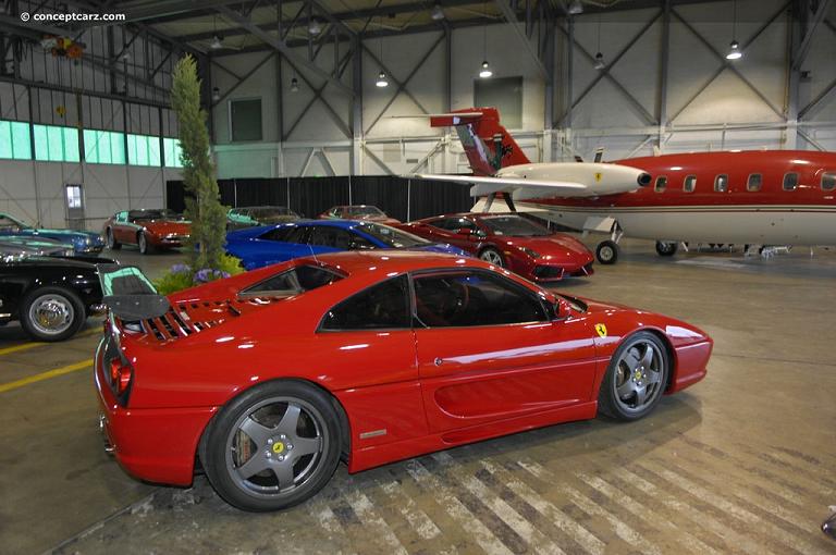

Amida (robert.kusakabe@comcast.net) MSG #150, 05-12-2006 03:04 PM
      I've been tied up lately with interior builds for the 355 rep builders. This one is going into a roadster in Canada.
I've worked on a couple of ideas for the final shape of my new GTP fascia. Although keeping the rake angle of the stock GT aero fascia would have been the closest to the stock look, it wouldn't work right with the new fog lights since the cups would be way too deep on the bottom side & would look strange. So I came up with two designs: 1) Smooth, rounded, one piece aero look with under cut angle simillar to '06 GTP. 2) Straighter, flatter, two piece look similar to Ferrari bumpers. I'm leaning towards the '06 GTP look, but I'll get a better Idea once I start building the plug.

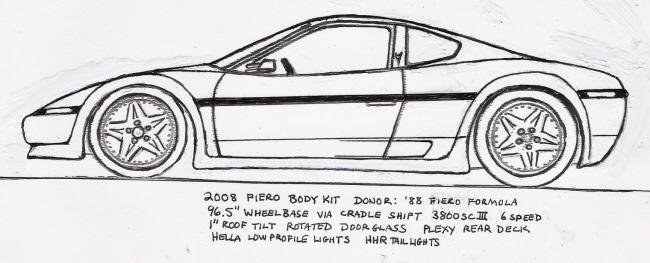

Amida (robert.kusakabe@comcast.net) MSG #153, 06-15-2006 12:06 PM
      This is a revised draft of the previous drawing. It seemed a little too long so I shortened the nose a couple of inches. So far on the project I have formed some intermediate moulds for the top, front & sides. I'm currently shaping the foglight cups afterwhich I'll begin blending it all together.

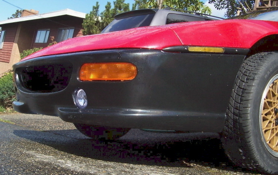

Custom2M4 (custom2m4@hotmail.com) MSG #154, 06-15-2006 01:26 PM
      Very nice. In about a months time you might be able to see pictures of my sunfire front end... Its going to be similar to that, exept the vents aren't going to look "fiero".

Amida (robert.kusakabe@comcast.net) MSG #156, 06-16-2006 02:13 PM
      That Sunfire nose should look pretty good. Here is an expanded side view of the new nose to get a better overall idea of how it will look.
[This message has been edited by Amida (edited 06-17-2006).]
Amida (robert.kusakabe@comcast.net) MSG #157, 06-17-2006 12:57 PM
      Here's a stock Fiero wheelbase version of the previous 2M8.

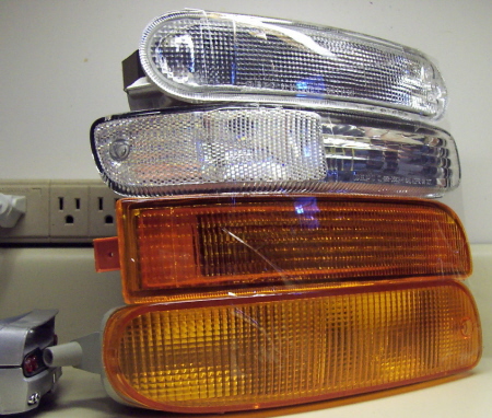

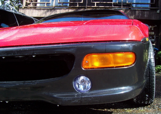

Amida (robert.kusakabe@comcast.net) MSG #158, 06-18-2006 10:39 AM

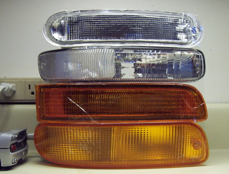

      Another front end idea this one with Prelude fog/turn lights & 300zx headhlights.

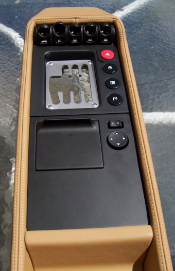

Amida (robert.kusakabe@comcast.net) MSG #159, 08-01-2006 11:46 AM

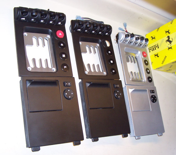

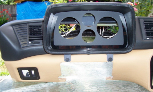

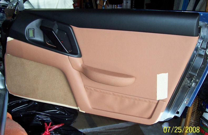

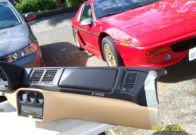

      Here's some new pics of one of the interiors that I've just completed in leather; color matched to MrMikes tan#13. A refreshing interior swap for a 355 roadster with a modified flat floor.
[This message has been edited by Amida (edited 08-01-2006).]
RCR (rcrabine@comcast.net) MSG #160, 08-01-2006 12:31 PM
      Wow, Rob!! That looks awesome. There was a post here yesterday about interior swap options. I gave you a plug. You need to get those pics over there. The only thing I see missing is Bob's (riceburner's) HVAC controller (I plug everyone )
Bob
Tom Slick (tom.slick@northtexasfieroclub.org) MSG #161, 08-01-2006 12:44 PM
      Dang it!!!
i knew i should've of had you upholstered my interior.
hopefully, i can find someone local who can do that good of a job.
motoracer838 (jmartin@musicunveiled.com) MSG #162, 08-01-2006 10:47 PM
      Who does your trim work, I just had one of my countach dashes done by a local shop and it's so bad that it's got me thinking about getting a comercial machine and giving it a try myself. I really think I can't do any worse than what the shop did. BTW those 355 parts look absolutly awsome.
Guns kill people, like spoons made Rosie O'donnel fat. Joe

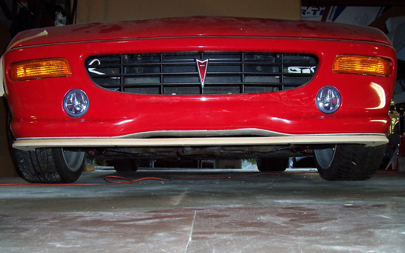

Amida (robert.kusakabe@comcast.net) MSG #163, 08-02-2006 11:01 AM
      Hey thanks guys. Fresh leather sure does smell nice. I guess I should have posted the pics on a different thread for easier searching.
RCR, How's your CAD design looking? My new bumper design will put a more modern face on the Fiero.
Tomslick, Any experienced custom upholsterer should be able to do a good job for you. It'll probably take them a 1 1/2 weeks to do. How far are you on coupe?

Silentassassin185 (silentassassin185@gmail.com) MSG #166, 08-02-2006 03:41 PM
I like this idea but what about a healight out of an S2000? Sort of like this
Just tossing around ideas.

Amida (robert.kusakabe@comcast.net) MSG #168, 08-03-2006 12:13 AM
Like the lights. I'll see if I can draw them in.

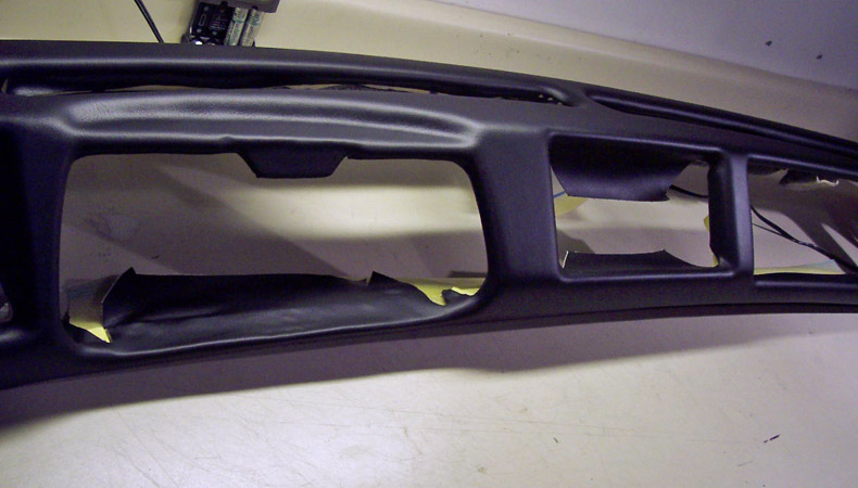

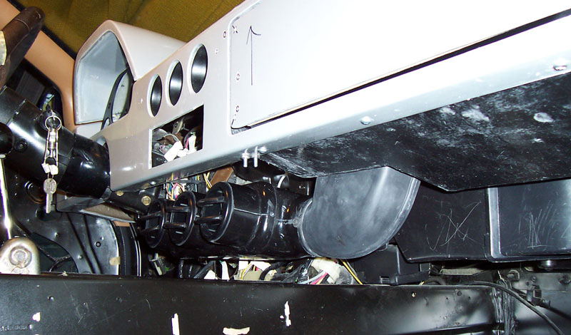

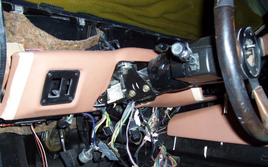

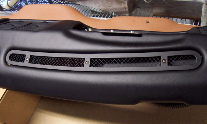

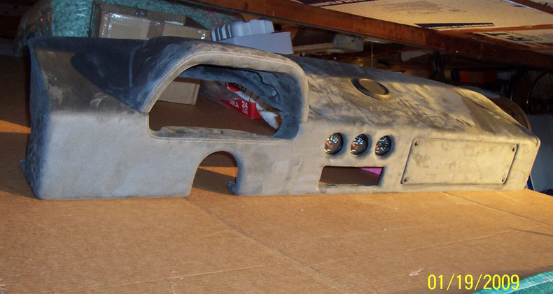

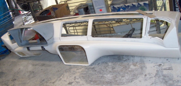

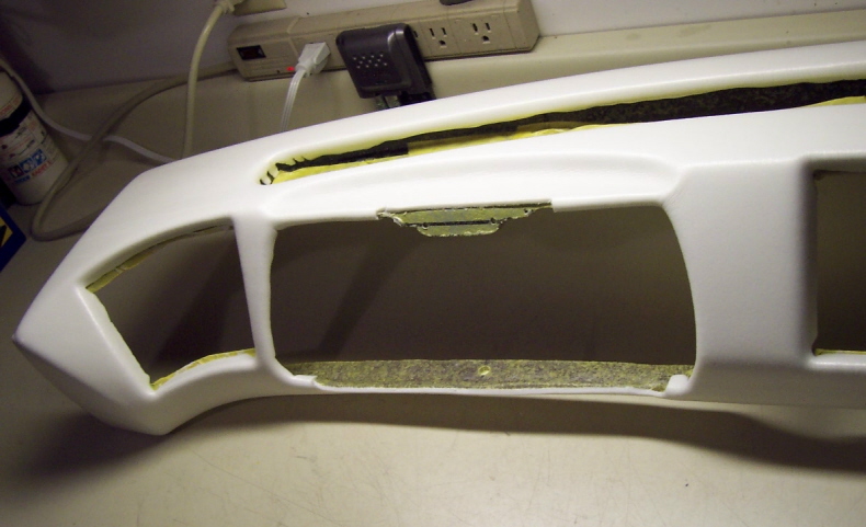

motoracer838 (jmartin@musicunveiled.com) MSG #170, 08-06-2006 12:27 PM
      Rob, you asked whats wrong with the work on my Countach parts, a better question might be what's right with them.
more to come. Joe
[This message has been edited by motoracer838 (edited 08-06-2006).]
motoracer838 (jmartin@musicunveiled.com) MSG #171, 08-06-2006 12:40 PM
      More pics.
This is probably the best looking veiw
In all fairness the shop only charged me $350 to do the three parts, but it did take more than six months and several tries to get to that point. Of course the car in geneal is such a POS that these parts are a huge improvement over what the car had in it when it arived at my place, it goes away this week( Hooray) I can hardly wait.
It's good to have an open mind,
just not so open that your brains fallout. Joe
Amida (robert.kusakabe@comcast.net) MSG #172, 08-06-2006 07:09 PM
      Joe,
I think if it wasn't for all the little cut-outs, the Lambo dash would be a relatively simple piece to cover. It took several tries huh? Fabricating some bezels around all the switches & controls will help clean-up the look, and the wrinkles around the edges & corners can be pulled out and re-glued. If you're selling the car, then I suppose you could leave that work to the new happy owner.
Rob
Fiero Interior Conversions
Seattle, WA. USA

motoracer838 (jmartin@musicunveiled.com) MSG #174, 08-06-2006 08:08 PM
      Rob, the car belongs to a client of mine, who bought the car off of Ebay. When it got here it took me about five miniuts to hang the name, the Steaming Pile on the car. Wich of course has stuck.
I think that if the padding was relived where the selvige lies would have helped, I sugjested this when I saw one of the earlier attempts ( I use attempt loosely ) he didn't listen. this is such an improvment over what came in the car that I'm going to let it go ( I'm so far out time on this thing that it has to go ) if it was for one of mine it would be completly unacceptable.
Joe

Amida (robert.kusakabe@comcast.net) MSG #178, 09-04-2006 12:29 PM
      Went on a tangent on this idea after seeing pics of the T-Rex...thought it looked more like a toad, actually. Thought a jetfighter streamlining would make it look sportier w/ inboard F1 susp.

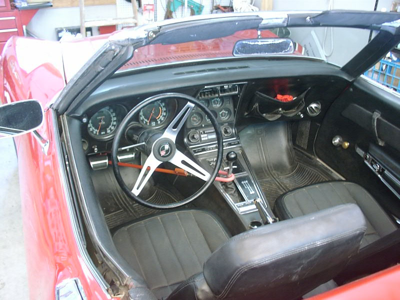

I took these at the GM Heritage Museum last fall when the Michigan Fiero Club got a chance to tour the facility.
Bob
Amida (robert.kusakabe@comcast.net) MSG #180, 09-04-2006 11:57 PM
      I've not seen that one before. Real cool. It looks to have a Fiero instrument cluster.
RCR (rcrabine@comcast.net) MSG #181, 09-05-2006 07:38 AM
      Yes...It used the cluster/instruments, seats, drivetrain, and front suspension. Corvette tail lamps.
Bob

      I'm getting closer to finalizing the design of the modernized front aero bumper. It'll utilize the late model GP & Solstice combo lights. To add more definition to the bull-nose look of the stock aero fascia, I've incorporated a horizontal split line/seam extending from one side moulding to the other. It fits in well with the existing side mouldings and continues the division line around the nose. I've finished fabricating the intermediate moulds for the design, and the next thing is to position the sections onto the chassis and blend it all together into one full size model. When the modelling is all done I'll save the design in an epoxy master mould.
[This message has been edited by Amida (edited 10-31-2006).]

Amida (robert.kusakabe@comcast.net) MSG #189, 10-30-2006 06:56 PM
      The bumper from Dietmar uses the Fiero side mouldings which is how I like it as well, and is how I'm doing my bumper. I'd like to keep it looking like a factory Fiero, but with some late model Pontiac features.
jmbishop (jmbishop05@aol.com) MSG #190, 10-30-2006 07:23 PM
      the biggest difference is the length, demietar's looks best IMO because its shorter. I'm pretty sure you have to cut the ends of the steal bumper when putting his bumper on.
Amida (robert.kusakabe@comcast.net) MSG #191, 10-30-2006 08:39 PM
      I know what you mean. I wasn't sure if it was due to the overall length, or just due to the division line dipping downward creating the 'smiley face'.

Amida (robert.kusakabe@comcast.net) MSG #198, 11-20-2006 03:02 AM
      A little more work on the 3" stretch notchback. My new GTP nose with lengthened sailpanels and GT rear fascia with shaved bumper pad. Decklid raised about an inch to create more rake in body line.
jmbishop (jmbishop05@aol.com) MSG #199, 11-20-2006 03:34 AM
      I hope to see you start a real car like these drawlings.
[This message has been edited by jmbishop (edited 11-20-2006).]

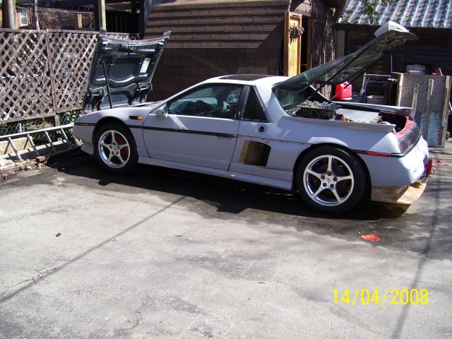

Amida (robert.kusakabe@comcast.net) MSG #200, 11-20-2006 10:17 AM
      You mean like this trusty subject ready to get a face lift?
Here I chopped the B-pillar by just 3/4" & layed the roof down to get more teardrop shape. This is do-able with stock doorglass because it's been done on the 512TR replicas. I feel like "Dr. 90210".

Amida (robert.kusakabe@comcast.net) MSG #206, 12-19-2006 02:18 PM
Did a little clean up on the sketch & added Mustang-like tail lights. I'll have to look at some Porsche photos to see what a lower hood looks like.
[This message has been edited by Amida (edited 12-23-2006).]

I've been focused on interior projects lately. Couldn't get much done over the holidays, and & then followed by freezing 20's F. weather over the new year. Try doing gelcoat/fiberglass work outdoors in sub-freezing temps with numb fingers...forget it!...it won't work. I spent a couple days building a heated curing locker to deal with the cold.

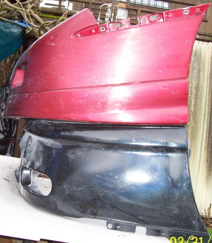

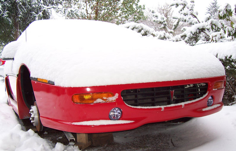

Amida (robert.kusakabe@comcast.net) MSG #212, 02-27-2007 03:50 PM

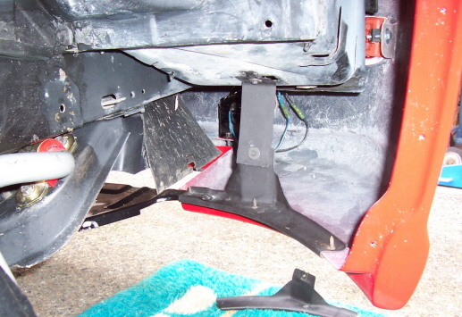

      I've finally got the intermediate molding of the upper fascia back on the car. The original urethane noses all seem to get warped/ sunken in at the top which I'll have to fix for the final plug. I also had to rebuild the upper mounting lip due to severe warpage. My idea is to see how a real two piece fascia ( upper & lower ) will work on the Fiero. If it doesn't then I'll go back to the normal one piece design. I'll be using the original 355 bumper as a donor to help shape the mating surface and create the FI355 fascia. Couldn't get much done this time due to the rain.
[This message has been edited by Amida (edited 02-27-2007).]

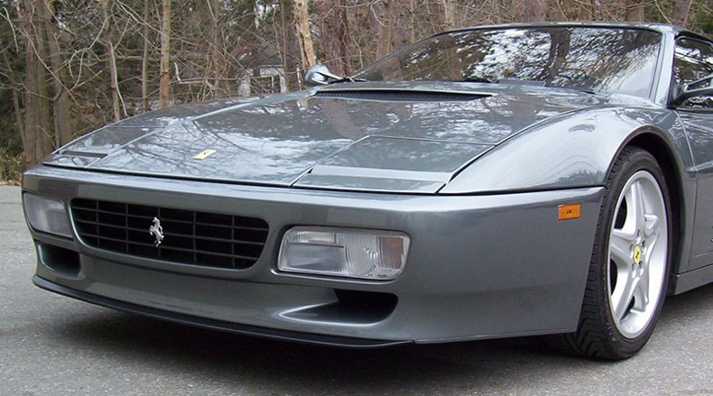

Amida (robert.kusakabe@comcast.net) MSG #213, 03-03-2007 11:40 AM
      This is a 512tr type nose that I'll also work on fitting to the Fiero. The fascias will retain the stock Fiero side mouldings to fit & look like a stock replacement.
RCR (rcrabine@comcast.net) MSG #214, 03-03-2007 04:55 PM
      Hey...You got the 512 stuff from the last drawings I made!! The cool thing is, I never posted it. It's still on my desk at work.
<chanting> Go Rob Go...Go Rob Go...
Bob
PS Who made the 512 bumper?
[This message has been edited by RCR (edited 03-03-2007).]
Amida (robert.kusakabe@comcast.net) MSG #215, 03-06-2007 12:13 PM
      The bumper is part of a 512tr kit. It's real wide at 69" so I'll have to take out about 5" to make it fit. My idea is to make it modular to give it a true separate panel look which can also be swapped with the different nose styles that I'm thinking of doing.

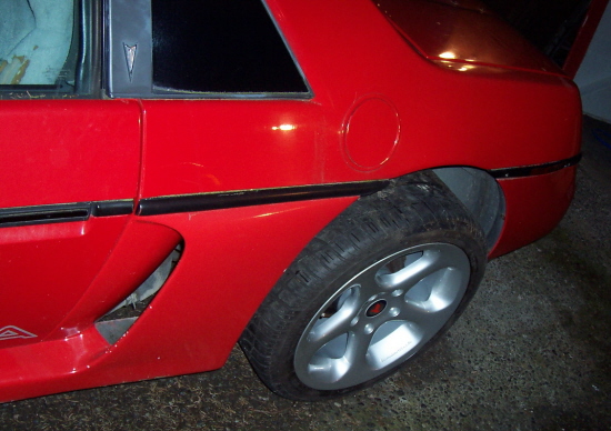

      I did a 3" stretch behind the firewall in '98. A hundred measurements using levels straight edges & a plumbob checking & rechecking for level & square. Next time I think I will build a chassis jig to eliminate the guess work & hold everything in precise alignment. I welded 14ga. tubing inside the railings & capped it off with plates on the outer sides to make a sandwich. It might be overdoing it but I wanted to make sure it wasn't a weak point in the chassis.
I'm leaning towards this idea here for my red '88 Formula. The 1/4 glass & sail panel seem to fit well with the stock door glass. Also it wouldn't matter if it started off as a coupe or GT since new sail panels would be installed anyway. This would also be easier to do than a full body mod. Toying with the Wide body idea by using attachable fender flares. It would be a cleaner look if only the side mouldings weren't there, but the whole idea is to keep it a Fiero with a slightly different look.
[This message has been edited by Amida (edited 03-07-2007).]

Amida (robert.kusakabe@comcast.net) MSG #221, 03-28-2007 02:49 PM
      Been laying around getting over a bout with microbrew poisoning, thought I'd finish this 9" stretch Fiero. Played off the 3" stretch drawing previous and switched to GT type sails, notchy rear, pushed out front fenders w/ rear edge vents, extended windshield, .075" roof tilt. Can't make too many changes because this is supposted to be Fiero ideas.
96.5" wheelbase
[This message has been edited by Amida (edited 03-28-2007).]

Amida (robert.kusakabe@comcast.net) MSG #224, 03-30-2007 02:22 PM
      Bob, How about something like this with Acura Legend lights. Tear dropped the sail panels and added a rear diffuser.

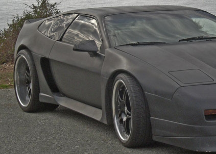

SAFASTRO MSG #225, 03-30-2007 03:55 PM
      Hey Amida....how about something like this??
RCR (rcrabine@comcast.net) MSG #226, 03-30-2007 04:12 PM
      I like it Rob..

Amida (robert.kusakabe@comcast.net) MSG #227, 03-30-2007 05:00 PM
That's got a nice wide, aggressive stance. I like that.

kwagner MSG #232, 03-31-2007 11:04 PM
      Amida, some nice design ideas again!
And whoever's red widebody that is looks really sharp!
do you sell the top picture ,the fiero upper top bumper no sides
Amida (robert.kusakabe@comcast.net) MSG #245, 06-13-2007 02:46 PM
The 355 nose design is underway right now. I'll be posting a new thread on that when I get the model finished. I've been a little tied up working on interiors so I only get to work on the nose on weekends. The top section may/maynot be a separate piece; depends on how well it fits when I mock it up on the car. It would be more cost effective to build it as a one piece unit, but for me, personally, I like the separate panel look so I'm hopeful that it'll work.
[This message has been edited by Amida (edited 06-14-2007).]

Amida (robert.kusakabe@comcast.net) MSG #247, 06-14-2007 01:58 PM
Originally posted by whadeduck:
Yes, yes. Let him finish the interior work he has going on. I'd like to see you work on the 355 nose though. Will you be using real Ferrari lights? Or a cheaper replacement?
On the frontal view you'll notice that I rounded the ends of the turn signal lights. The original 355 lights are ideal, but I believe they are priced around $250 each. So, I'll be using the Avenger/Sebring units that are a very close match & can be bought on Ebay for about $20 each.
