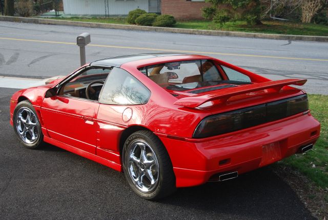

In August of 2000, I was thinking of getting a sports car again. Since I was able to drive I had always been into fast cars. After looking into getting a Mitsubishi 3000 GT VR4, I decided that I could not afford one. Needless to say, my insurance company was not thrilled about it either.
I had an 87 Fiero GT from 87 to 91 and decided to get one again. The 87 GT I had then was a summer project for me. I am a technology education teacher in a high school. I was looking for a project to spend the summer working on. I found a rebuildable wrecked 1987 GT in mid 1987 and the car only had 2000 miles on it and was still under factory waranty. It was sweet with all options including the rare suede tan leather seats and looked much like this one. I kept the car till 91 when my two daughters were too big to strap in side by side.
In my search to find one again, I looked up information about Fieros on the Internet. I found out by luck the Fiero Dutch Classic show was going to be happening in two days and was only 10 miles from my house. Vonnie and I attended the show just to see them. I saw Jeff Dedays car, which was a mint 88 red GT t-top. It was the first t-top I had ever seen. I didn’t know they were even made. Here is a picture of Jeff with his low mileage sweet 88 GT. It had only 6000 miles on it at the time. I knew that was the model of car I wanted. Finding a good red 88 GT T-TOP is not an easy thing to do and it took months of looking.
That day at the show Vonnie also decided she wanted an 88 GT. She found hers first, a sweet 88 GT she bought in September.
After looking at hundreds of Fiero photos I was determined to get a red 88 GT T-Top with the beechwood interior and gold wheels. I found one listed for sale in the Michigan Fiero club website. I emailed the person and they sent several emails some with pictures including this one.
I had a long phone conversation with someone that obviously knew a lot about Fieros. He told me that he was selling it for a woman in town that had the car for a long time. I was told it was in rough condition with only 66,000 miles on it. Well I know this picture does not look too bad but it needed a lot of work. The paint was fair but had been poorly repainted on the nose, left front fender and drivers door. The interior was very dirty and dingy from a heavy smoker. It was so heavily smoked in I had to disassemble the gauges to clean the white numbers because they were brown. The tires needed replaced, and the pin stripe had to go. Rocker panels and quarter windows needed replaced. The T-top weather stripping needed replaced in addition to the driver’s door panel and front fender. The car had been driven daily in Indiana year round. I decided to get the car sight unseen for a fair price.
I hopped a Greyhound bus for an all night trip from PA to Indiana. After a grueling 10-hour bus ride, a great guy, Chris Moore, met me at the bus depot in Fort Wayne, Indiana. At this point in my Fiero life I had not shown a car, and was unaware who Chris was. Well you could imagine my reaction when we went inside the garage seen in the above photo. Inside were three, yes three, red 88 GT t-tops. Chris also had his Northstar convertible but he made me promise not to mention it since he wanted to surprise the Fiero world with it that spring. Also he had his other awesome Northstar Fiero as well as his brother’s cool Fiero in the garage. Unfortunately the car I was buying was the worst one in the garage but I was inspired to change that. After taking care of the title, I started driving it home.
After 50 miles I needed to stop for gas and when I drove away I noticed the automatic trans slipped. Later while stopping for a turnpike toll both I noticed it slipped a lot. I stopped and checked the trans fluid and none registered on the dipstick. Yikes! I filled it up and had to stop every 1/2 tank and refill it. Now I was doing this during my Christmas vacation so wouldn't you know it, Great Lakes effect snows started blowing real hard. The Fiero was all over the road and I was only able to follow a tractor-trailer tire tracks because the snow was getting a few inches deep. Well after about 12 hours of driving I got home and the car was totally white from road salt. It had a front manifold leak so I tried to fix it and of course the bolt broke so the second day it was home the engine/trans/cradle were on the floor. I figured it was a perfect time to detail the engine compartment, engine, cradle and suspension. I spent two evenings sitting inside the engine compartment cleaning everything. Vonnie worked hard on detailing the suspension and cradle for me. The leaking automatic transmission leak was also repaired with a new pan gasket.

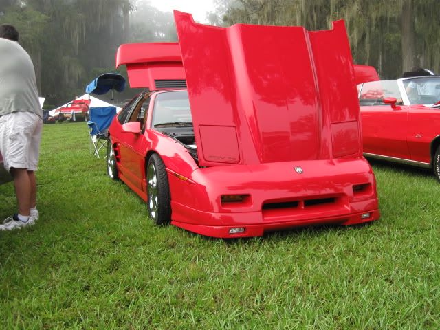

      After getting the engine back in I started working on the bad paint. I talked to some body shop guys I decided to do a panels off paint job. I bought a new GT nose and rocker panels and had a puncture on the rear bumper professionally repaired. Here is what it looked like when I drove it to the body shop.
I had a hard decision to make. Do I keep the car stock or do I start modifying it? The decision was made by accident. The body shop had painted the rear bumper all red. They forgot there was black trim. We discussed it and decided to paint all the trim and if I did not like it then he would paint the trim black. I also saw a picture of a cool red GT with a chin spoiler. I loved the look of the spoiler so I got in contact with forum member Lawrence. Here were the pictures I had found while doing a search for Red 88 GT
I learned he made it out of an old GT nose. So I made one too except I added driving light pockets by bonding rear reflector pockets off an old GT rear bumper.
I also had found a set of rare urethane Mecham side scoops. The Mecham racing team was authorized by Pontiac to use the actually Pontiac molds to make these scoops so they fit perfectly and are unbreakable.

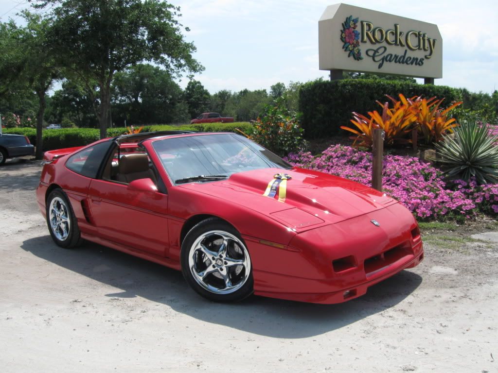

skitime (skitime@ptd.net) MSG #3, 02-04-2003 09:35 PM

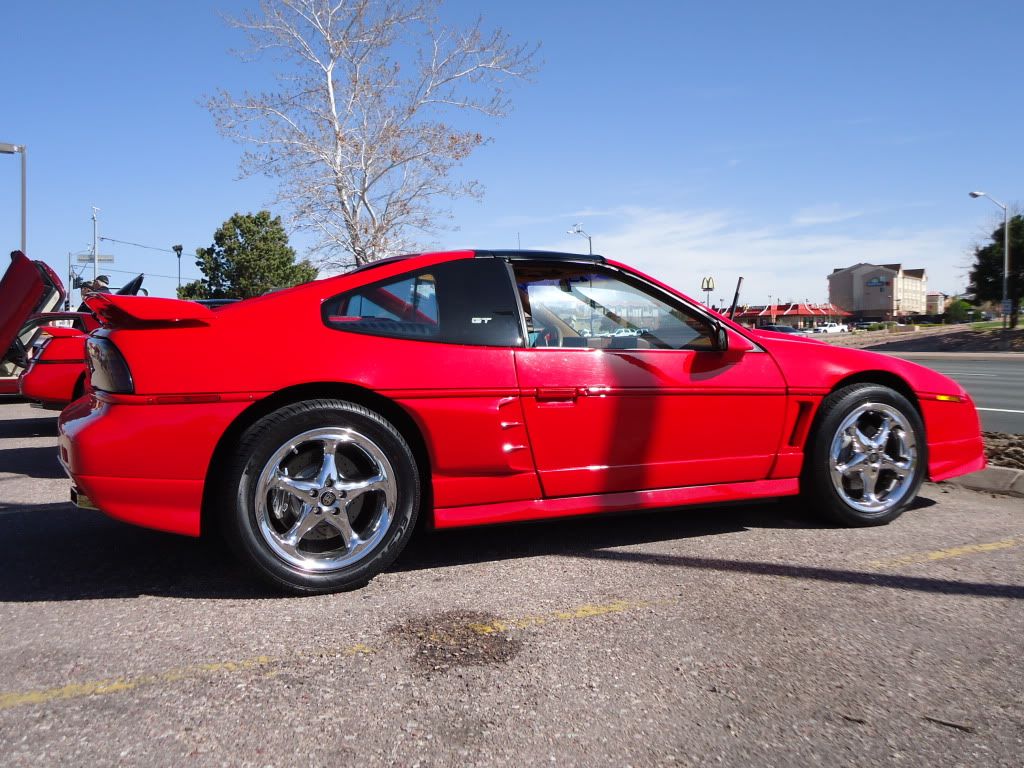

      Here is the car after painting it. I took it to spring Fiero show in Carlisle like this in 2000 and was in the tough custom class. It did not receive any awards but did have a lot of people checking it out.

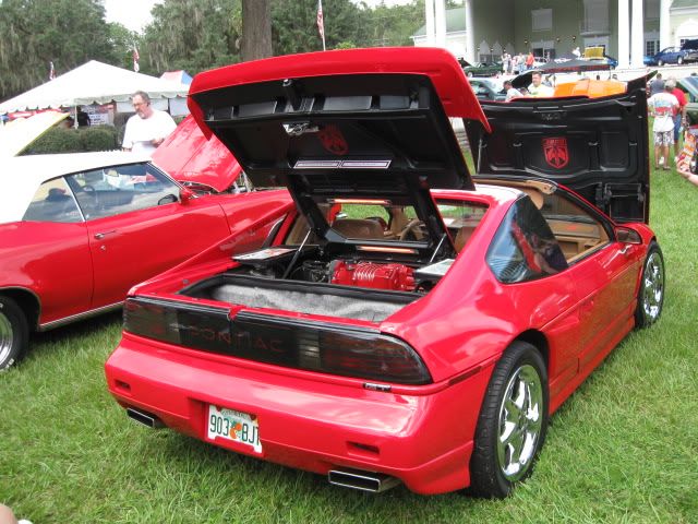

Later that first summer I had a crazy idea for the trunk. On the bus ride to Indiana to pick up the car, I bought a car magazine that had a picture of a Ferrari Spyder 360. The Spyder had an engine window and vents over the mid engine.

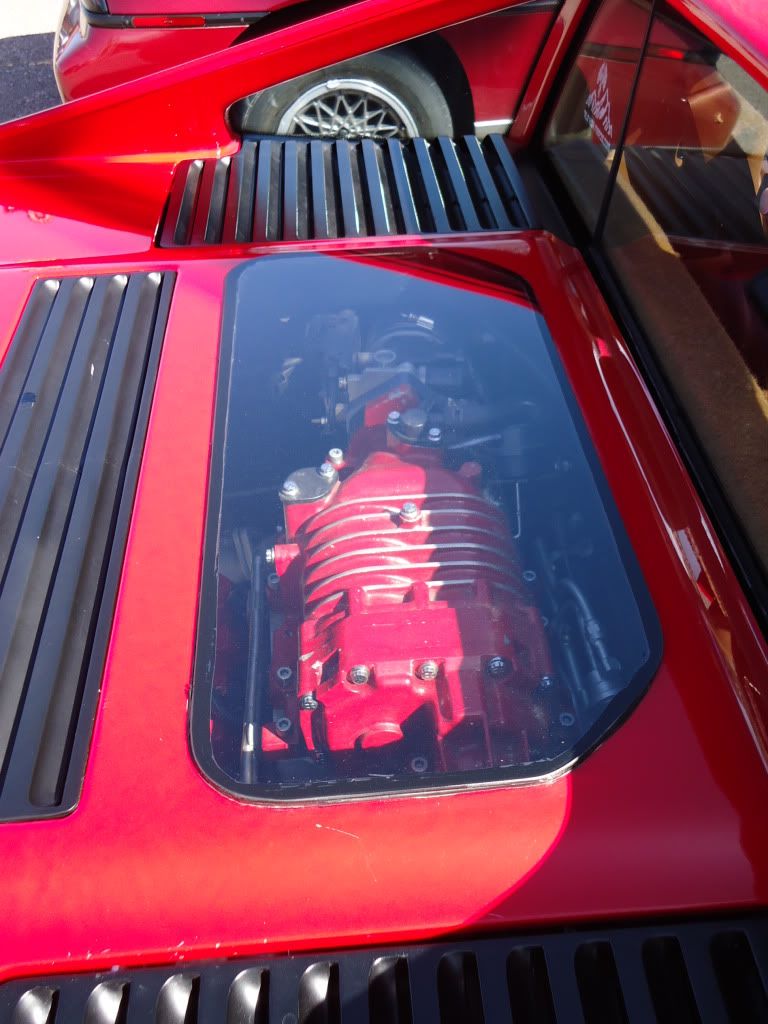

I decided that the Fiero had a cool looking engine too and I should try to show it off. I decided to create an engine-viewing window. Fleabit had a scrap trunklid for me to practice on.
[This message has been edited by skitime (edited 02-05-2003).]

      While working on this I decided to cut the next recessed area out on the underside to see if that would work for a vent. After going through two sets of grills and a whole lot of work on modifying a set of Fiero grills I got something that satisfied me. This trunk lid was also given to me by Fleabit.
I then returned to my painter to get the new modified trunk lid painted. Here it is with the new trunk lid. I have all the original body parts so I could restore to car back to stock. All the extra original body parts were also painted to match the new paint job. That was a lot of extra expense. I have finally come to the conclusion that I will never do that. So now my family room has nearly an entire set of nicely painted Fiero quarter panels, hood, trunk and front fenders.
After I had gone to a few Fiero shows and showed my car in the custom class I realized that I did not have a chance with my stock wheels in a custom Fiero class. I looked and looked for a set of wheels. I wanted something to give an appearance of being strong. I disliked the appearance of wheels with thin spokes. The car being monochrome really needed something to create some "pizazz" so I decided to go with chrome wheels. I found a set I liked through a shop that sold discontinued and clearance wheels. I think they were a good choice. They are 17" Prime wheels model 705. After I had them on I took it out for the first time to take pictures of my car. At my brothers place I took the now familiar photo of this car. If you compare this photo with the ones prior to the new wheels, I think you will find a dramatic change in the appearance of the car. In other words the wheels can really make the car.
The very next day this was my car.

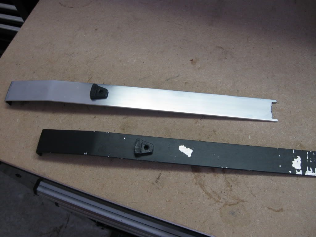

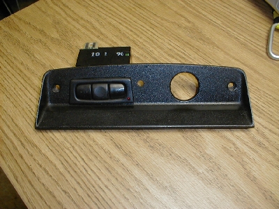

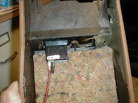

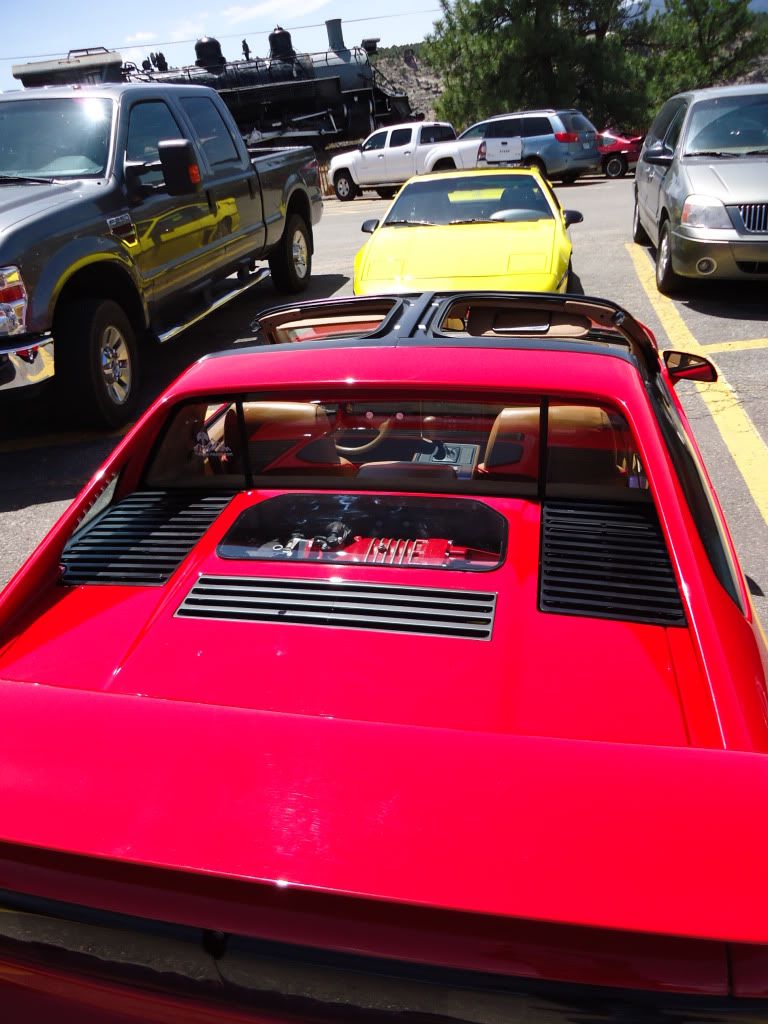

      Well next I found that with the t-tops I missed the option of popping open the sunroof. I was wondering what I could do about it when I had another idea: to make a removable rear window. Unfortunately in order to do this I had to remove the new glued in headliner as well as most the interior. Anyway it came out great. One of the few thing that went exactly as planned. (I noticed in this pic I was also working on another mod that did not appear till the next show season.)
This was as far as I got during the first show season with the car.

      I had no idea your rear window was removable sweet idea, I would have gone for the whole window though, any reason you didnt or couldnt do this?
skitime (skitime@ptd.net) MSG #10, 02-04-2003 10:24 PM
The whole window will not clear the rounded corners of the rear clip. Also the window does provide some body strength so leaving the smaller pieces glued in give strength to the body.

      thanks for the info skitime, its to bad the whole or close to it cant come out would have been sweet with the t-tops down and the back window out, now thats fun

      awesome story so far man, has anyone thought of trying to make the part of the rear window ski has made removable roll down? maybe like a power window? i think the honda del sol has this feaure and i think its neat. does anyone know of any reasons ahy it wouldn't work? thanks for any help
Well the wiring harness goes through the center, but I guess that could be moved. All in all it would be a huge project since there isn't that incredibly much space for movement.
I of course studied lowering it but quickly decided it was not feasible. If you go out and look at your Fiero you will see that if you follow the window surface straight down you will be into the manifolds of the engine of a V6.

Great documentation I didn't know about the removable rear window either. I do agree I miss being able to open the sun roof on my GT like I can on my SE with sun roof. Did you just take the stock window into a glass shop and have them cut it, or is it all new custom pieces ? I love these stories on how a car becomes to be what it is... Keep us posted
The original rear window is tempered glass. You cannot cut tempered glass so you have to make new glass. You choices are Lexan, inexpensive safety glass or expensive custom tempered glass. I tried safety glass for all three pieces but the center one cracked as soon as I closed the latch. I then got a custom piece of tempered glass made for the center piece.

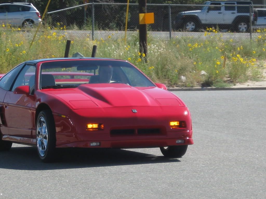

      I ended the first installment of the history of my car at the end of the first show season. I ended up doing fairly well at the shows as my first show season progressed and the car evolved. After the last show and the PA Fiero gathering in the fall I started in earnest to finish a fender modification that I had started earlier that summer. While I was at a junkyard that summer, looking for hardware to build my removable rear window, I noticed a 80s Trans Am with non-functional front fender vents behind the front wheel. The vents are made of urethane that was mounted in a recessed steel fender. After looking at them I thought to myself “hmmm I think I have a home for these”.
I got a scrap fender and tried it out to check if the contours would fit. It was almost perfect.
Since the piece is also urethane I used urethane panel repair epoxy to bond the two pieces.
My intention was to make the fenders functional. I was going to vent the air pressure behind the radiator to these vents with ducts and cutting through the fender wall beside the headlights. But as fate would have it another project came up that changed those plans so I have not made the vents functional yet. I really don’t like that since I sort of dislike non-functional vents. I may still make them functional. Here is a close-up after being painted.
skitime (skitime@ptd.net) MSG #32, 02-06-2003 08:09 PM

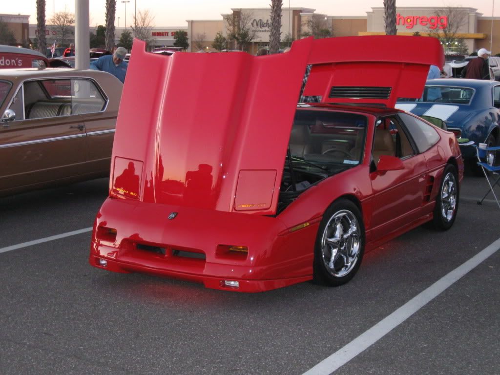

      I found a ZR-2 hood for sale in the Pennock’s Mall. I thought that I might be a great way to vent the pressure behind the radiator. After I received it I was very disappointed in the quality of the piece. I do not have a picture of the scoop when I first got it but it looks like this Ebay pic.
I had bought it second hand so I do not know who originally made it. I set it on the hood of an 86 GT I had bought to see how it changed the appearance of the car. I left it on there for a few weeks and every time I looked out the window at it there was something I did not like about it. Now I want to be careful here not to offend anyone so this is my personal opinion about the scoop and I am not trying to put down any one else’s car. I finally realized why I did not like it was because it did not work with the original bodylines of the Fiero. If you look closely at a Fiero hood there are three lines, which are all, carried down onto the nose. The scoop covered the two strong lines running past the headlight covers. Even worse it created a change of the raised centerline coming from the nose into a wide dip. Now these scoop lines look great if you use the whole ZR2 body kit but in my opinion not with just adding the scoop to a Fiero. Here is a ZR2 Fiero example and it does look good since there are no body lines coming off the hood.
skitime (skitime@ptd.net) MSG #33, 02-06-2003 08:10 PM
      So I was going to sell the scoop but decided I could at least see if I could modify it to work with the Fiero. I told Vonnie I was going to cut a $100 bill in half with a circular saw. I took the scoop in the garage and cut the center 4 inches out of the scoop. Now my scoop was laying there in three pieces. Wish I had pictures of that. I used my front porch as a huge sanding block to get the two large halves straight enough to bond them back together. I used the 4-inch center strip to reinforce the bond of the two halves by bonding it underneath. This created a scoop without the center dip and made the scoop narrower so I would not loose the sharp lines found on the hood. I got an extra hood from Foxgapfiero and proceeded to bond the hood and scoop together.
Let me discuss the opening in the hood and hope not to offend anyone. I see lots of Fiero hoods with the vent being the half moon shape on the underside. Here is the only pic of have of the underside.
I know why they use this but if you go out and look at your Fiero nearly all this shape is over the radiator and not behind the radiator. Obviously you want the opening to be in the air stream coming out of the radiator. I attemted to maximize the opening and work with the air flow which is actually upward out of the radiator. I followed the curve of the trunk wall as close as possible and create a shape that would assist extracting air. I also wanted to retain the body lines on the top of the hood so I did not bond the scoop to the top surface but recessed the bonding surface the retain the close by body lines.

I spent an unbelievable amount of time doing the bodywork to get the hood looking correctly. I prefer to do my sanding and contouring by hand so it took a long time.
The underside of the scoop was ugly sprayed fiberglass. I hate to see scoops that are added on that look great until you see the underside. Often you will see rough fiberglass or the hacked up openings where a hole was cut and not blended into the scoop at all. I spent weeks working only on the bottom to blend all surfaces to make it look like it was not added on.

      So in the end I ended up with what I felt was an extraction hood scoop that worked with the bodylines. Here is my car after another trip to the paint shop.

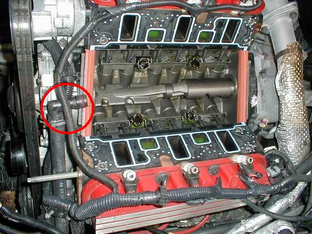

      While I was working on the hood project I had decided to do an engine swap. I was fortunate to drive Jelly2M8s V8 Fiero that summer while we were traveling in Nova Scotia. It was a real head snapping car.
I also drove Fiero38SC’s supercharged during the PA Gathering at the Gilberts. I was very impressed with the power this car had.
I also drove FieroF1’s turbo 2.8 GT at the fall club meeting. I could tell the extra power seriously changed the personality of the Fiero.
I had visited Rockcrawl to check out his 4.9 Caddy setup. Jon had convinced me into doing the 4.9 swap.
The install looked like it had a lot of potential. Therefore I decided to do a 4.9 Caddy engine swap and even visited several junkyards trying to find one.
One evening, I was surfing Ebay and found a new crate 3800 supercharged engine. I emailed the seller and he called me back to discuss the engine. Here is one of 32 pictures he sent me of the engine.
After the phone call I asked around what it would be worth and found out it was worth a lot more than the “Buy Now” price. So I did the “buy now” for $1400. Yikes! Just like that I had two major projects going at once so I decided to finish the hood before starting the engine swap.
The previous summer, Fleabit had found a wrecked 88 GT and asked me if there were anything I would want. It was a complete car. I was able to buy the engine, 5 speed Getrag, cradle, suspension, shifter, shifter cables and anything I needed for a automatic to manual trans swap all for $150. I figured it was certainly cheap and did not have any idea what I would do with it. It sat in the corner of my garage for over a year. It suddenly became obvious why I had bought it. This gave me the perfect platform to build the engine swap on. I could also convert my automatic GT into a 5 speed Getrag at the same time. I could do the complete conversion while leaving the GT alone until the swap was ready to go in the car. It was tough to let the new engine set as body filler dust kept building on top on it but I decided not to work on it till the bodywork was done.
Finally I was ready to start the engine work. There were lots of Pennock’s folk that assisted me in information on the engine swap but first and foremost was TerryK. He was so helpful getting me through the wiring and ECM stuff. Others that helped me were Eric at West Coast Fiero, Jelly2M8, Boilermaker, Phil, ToomanyFieros, Fiero38SC, Rockcrawl and I am sure I am missing some people. Many thanks to all. Let me say from the start about my engine swap. I plagued myself because I always think I have a better idea than GM. There was almost nothing on the outside of my engine that is still in its original place. I am in the Fiero chat room nearly every night and my friends constantly harassed me as to why it was not done yet. Good things take time. I was working in my garage usually from 4 o’clock to 9 or 10 o’clock every day from late fall till spring and I would use the Fiero chat room to unwind before bed. I often wondered what my neighbors thought with the garage lit up every night and the TV on. They must of thought I was banished to the garage.
Since I had the engine window I wanted to keep everything clean. I did not what anything interfering with the view through the window. When I announced that I was going to do a 3800SC swap, several people asked my why because the 3800 was too ugly to be in my car. I told them I would make it a pretty engine.
[This message has been edited by skitime (edited 02-08-2003).]

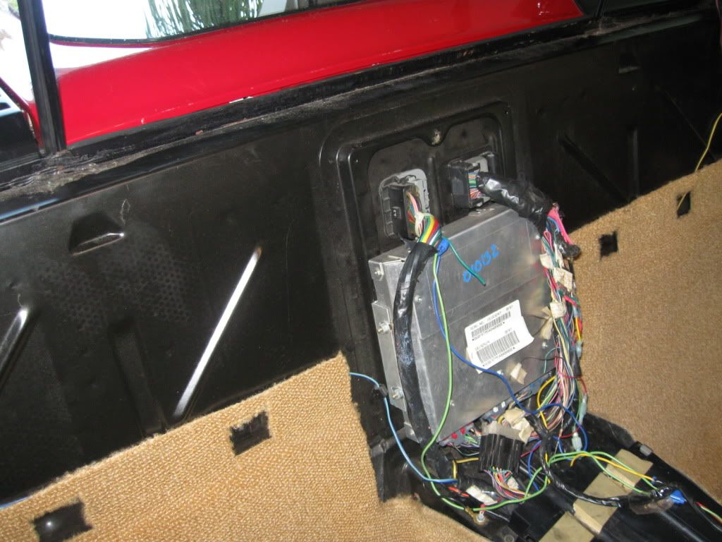

skitime (skitime@ptd.net) MSG #43, 02-07-2003 03:31 PM

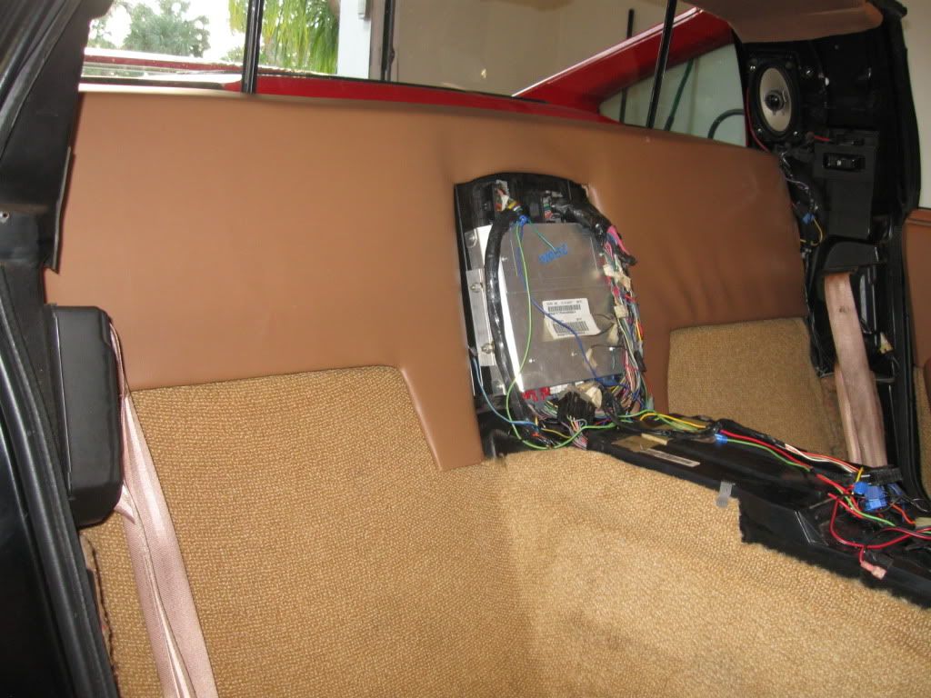

      This process took a very long time since I kept relocating parts and redesigning the harness. I would often just sit and stare at the engine for long periods of time and Vonnie would come down and laugh at me staring at the engine. One evening she sneaked up on me and took this picture while I was in one of these trances.
Now what I had to do with each wire was check what it was for and where it went on the 97 GTP engine wiring diagram then convert the connection as to which pin it would be on the 95 Bonneville ECM diagram as well as if it would connect to the Fiero harness and what pin it might be on the Fiero. I had the 97 GTP diagram blown up to four times its size so I could easily follow the wire path. This hung up over my work bench and is in fact still hanging there. This is only the diagram for the engine not the whole car.
The harness started to come together after a few weeks. Notice that the harness is now designed exactly like a Fiero harness. I have the sheathed bundle extending over to the battery the same as the Fiero harness does. I even used the Fiero harness support brace to hold it securely. In this bundle is all the wires for the 3800 coil pack. I had decided to relocate the coil pack off the engine and over beside the battery. This would allow a cleaner install since the associated wires and spark plug wires would not be on the engine.
The harness was almost done except for the connections at the ECM. I had decided to change to a 95 Bonneville ECM so the connectors would be different. I had to disconnect all the wires from two connectors like this and then solder them to three different connectors for the Bonneville ECM.
That ended up being over 100 wires cut spliced and soldered. I spent many evenings sitting like this splicing-soldering-testing each connection from both ends.

      Eric at West Coast Fiero was one of my Fiero Chat room buddies and one night he asked me what I was doing for exhaust. I said that I would love their headers but could not afford them so they decided to help me out. They also provided poly motor mounts and a custom dogbone. I would help them out by showing their products at the shows. I owe them a huge thank you for their support. Their headers allow you to design the exhaust system like the original Fiero exhaust system. I sent the headers to Jet-Hot to be ceramic coated prior to installing the engine in the car.
One of the important things I was trying to accomplish was to make the engine appear to have been installed by the factory. . I wanted to engine to look similar to the stock Fiero engine. I really dislike the cheap looking plastic cover GM chooses to hide the mess they made under it.
I felt that the supercharger should be something to show off through the window in the trunk lid and should not be hidden under plastic. Have you ever seen superchargers hidden on high performance show cars? So I removed the supercharger and painted it to match the red of the car, which is close to the Fiero engine color. The valve covers on the Series II engines are made of fiberglass. I wanted to have the look of the brushed aluminum of the original Fiero valve covers. I laminated 1/16th inch aluminum strips to the covers and finished them in the same luster of a Fiero valve cover.

      The fuel rails on the 3800SC engine crosses over the supercharger 4 times. Since I was concerned with the view through the trunk window I decided to redesign them.
What make this even more unacceptable is every 3800SC install then has to run long fuel lines from the inlet and outlet seen here all the way around the engine to connect to the fuel connections below the battery. That leaves ugly hoses running all around the engine compartment. I used the original Fiero steel fuel lines and brazed them into my redesigned fuel rails so no hoses are needed at all.
I also used the original 3800 manifold heat shields and modified them to use with the headers as seen above.

      It's such a pretty car! Here are some more pictures of it.
**edit- forgot the pics**

I put the trunk lid back on and pulled it outside for some trunk lid pictures with a 3800SC. Since I was waiting for the front end body panels I resisted driving it on the street but the clutch and trans seemed fine.

      Let me get back to my car but first I need to talk about my knee since it affected my car. In May of 2002 I had an arthroscopic operation to repair my meniscus. Some might remember me limping around at the Carlisle show. The operation did not fix the problem so in mid July I had a partial knee replacement done with a new procedure called Unispacer. That procedure did not go well either and on December 18th I had a third operation to repair the Unispacer position, which ended up being in the wrong position for 5 months. Well the knee problem prevented me from doing any more major projects. I did a few minor ones. Vonnie and I enjoy getting our cars out to the local cruise-ins to expose the Fiero to the automotive public.
I am often amazed how many people do not recognize my car as a Fiero. I decided that one modification I could do soon after the Unispacer operation while limping around was underbody neons. I know many of you think that is” rice” but at the cruise-ins we have noticed how much more attention cars with the neons have. I added the top of the line Streetglows in red. For the front neon I built a steel bracket to hide the direct view of the light but lets the light shine brightly on the ground and out the nose. The side neons created an interesting problem. The bulbs should not be visible.
The Fiero is nearly perfectly flat from the bottom of the rocker panel to the opposite rocker panel. So how could I mount them with out them being seen? Some tuck the bulbs into a tight crevice right behind the rocker panel. The problem with this is that it creates a sharp cut off of the light instead of a soft glow across the ground. What I came up with worked out great. I bought some 1-½ wide aluminum straps. I remove the fasteners along the bottom of the rocker panel and mounted the long straps painted black along the length of the rocker panel.
This piece does two things. It blocks the view of the bulb and provides a “bumper” to help protect the bulb. Since the strap is black it is almost totally unnoticeable. Most people never see it unless I point it out and even then they always go over to see it close up. The side bulbs are mounted about 5 inches from the rocker panel. The rear bulb was easily mounted between the trunk compartment and the rear bumper skin.
Sorry I have had a real hard time getting good pictures of the car with the neon lights on.

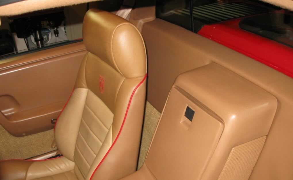

The next modifications I felt I could do with the bad knee was to the interior. Up to this point the interior was bone stock. I really love the way the beechwood interior looks with the factory bright red body. I always wanted the factory lumbar seat. I was lucky to find a set of 88 Beechwood seats with the lumbar option on Ebay and won the auction. I decided to put Mr. Mike leather seat skins on them. I contacted Mr. Mike and decided to get the custom made Sport model. This seat skin looks like the Italian model but has different stitching. That would allow the inflatable side bolsters to match the shape of the leather bolsters stitching. I also wanted to bring a touch of red into the interior without being overdone so I had red piping added to the seats. I ordered extra red piping to allow me to further add some more red touches. I really do not like overdone interiors and remember I like my car to look like it could have been done by the factory. I added the red piping around the door latch panels and the outside dash vents. The seats and trim came out great. I really liked the look that resulted.
skitime (skitime@ptd.net) MSG #196, 03-20-2003 08:46 PM
      By the end of August the seats were in and I was still limping with a cane. The doctor told me I would have to stay off work as a Tech Ed teacher for another two weeks, which meant missing the start of school. I decided that since we had no vacation because of this surgery that Vonnie and I would drive my car from PA to Chicago for the Fierorama show for a mini vacation. I had never driven my car for more than under a 100 miles at a time so I was concerned if my engine and my engineering of the installation would successfully make it the 1200 miles round trip. The car ended being a sweet car on the interstates. It could pass cars in an instant and got 30+ mpgs. We arrived in the Chicago area and proceeded to clean the car at the hotel. We met a lot of new Fiero folks while we were there. Here we are arriving at the show.

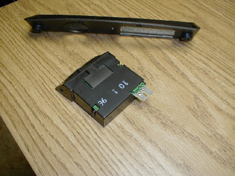

I also added a factory DELCO CD changer to a late model Pontiac radio. I love this setup. The lighting on the radio is really cool. The cassette radio looks fairly common and no self-respecting thief would risk stealing a stock cassette radio while trashing your car trying to get it out. The changer plugs into the radio and the radio buttons and display turns into CD changer controls. There are no tale-tale remote controls to tip a thief off that there is a changer anywhere. The radios sound awesome especially with the factory subwoofer I added. I have the CD changer mounted on the front trunk on the left fender. The sound is great and retains the factory look I like.

Thanks for the compliment. If your radio has a nine pin plug in the center of the back then you are CD ready. The radio does not display the CD stuff until the CD is plugged in. It is a sweet setup and only the 9 pin harness is needed to connect and power the CD changer so install is a cinch.

skitime (skitime@ptd.net) MSG #210, 03-21-2003 09:20 PM
Thanks! Yeah, I noticed in your pic it displaying the CD changer info. The one unanswered question I have is what button do you push to switch between radio/CD/and tape? I can see you hit "Tape Play" to start playing a tape, and you can hit "AM/FM" to switch back to radio if a tape is playing (without having to eject it). But if you're playing the radio, how do you switch to the CD changer?
I love how the lighting on the unit switches depending on if you're listening to CD or Radio. That's just too cool.
And thanks again for the info. Hope my question doesn't seem too obvious. I'm a bit confused. (It would probably all be pitifully obvious, if I had the changer plugged in)
After the CD is connected the following buttons do the functions listed below in CD mode.
TAPE PLAY - Starts CD if no tape is inserted
RECALL - Shows CD track and time in song
SEEK - Moves up and down in songs on CD
1 PREV - Moves down in songs on CD
2 Next - Moves up in songs on CD
3 PROG - Next CD is cartridge
4 RANDOM - Randomly plays songs from all CDs
5 REV - Moves back in currently playing CD song
6 FWD - Moves forward in currently playing CD song
Like I mentioned below this is im my opinion one of the best sounding radios and keeps it stock looking too. These are the same radios available in the current expensive GM cars like the Grand Prix and Bonnevilles. If you have the same radio only the CD model there is a plug in the back to add a cassette player too.

canadiangtfiero86 (gtfiero86@msn.com) MSG #221, 04-14-2003 08:51 PM
      In the one pic of rear of car looks like there is no window did u mod it some how so u can take it out!
skitime (skitime@ptd.net) MSG #222, 04-14-2003 09:02 PM
The removable rear window is covered on page 1 of the thread. Now pay more attention are reread my thead. lol

      Skitime, I love your car, but (sorry I can't help myself) I really don't like the hood. I know it is a vent, however it is venting into a high pressure area. I think it would be more effective, and more in keeping with a mid engine design, if it involved some sort of dropped centre design.
Given your flair for design you should be able to come up with a new variation on the "Warber" style vent like Archie's Stinger uses. I would like to see the hood show the level of originality you have displayed on the rear deck, side vents and front air dam.
As you have said yourself, everything needs to be functional, and I think there is a far more functional way to design a vented hood.
Yours is one of about a half dozen Fieros which have greatly surpassed their humble roots, good work.

How origional is it to copy the Warber design? I see he isn't the first to mount a zr2 scoop, but he is the first to mount it that it looks like it belongs on the Fiero. I think that takes a bit more work, and a bit more origionality. Just because you wanted to cut a hole in your hood, doesn't make you an expert on the cooling properties of mid-engined designs, or modifying vehicles to suit personal tastes.

Actually the hood design is very efficient at extracting heat. The windshield actually gets warm to the touch from it. I did study the air pressure to see if it would work. The base of the windshield actually is only a weak pressure area not a high pressure area. The air coming out of it during driving is easily felt if you put your hand about the windshield when the t-tops are off. The radiator actually redirects the air upward since it is tilted forward so that puts the pressure on the bottom of the hood while driving.

Skitime wrote: Actually the hood design is very efficient at extracting heat. The windshield actually gets warm to the touch from it. I did study the air pressure to see if it would work. The base of the windshield actually is only a weak pressure area not a high pressure area. The air coming out of it during driving is easily felt if you put your hand about the windshield when the t-tops are off. The radiator actually redirects the air upward since it is tilted forward so that puts the pressure on the bottom of the hood while driving.
Fair enough, the pressure differential is great enough for the vent to work. I guess the old cowl induction hoods only work with fairly upright windshields like the old Camaros, Corvettes and Chevelles had, not enough angle to the Fiero. Sounds like the airflow must be pretty significant, would be great for clearing windshields in my climate

I also added the ZZP throttle body spacer. It prevents the supercharger from heating up the throttle body.
I also add the ZZP underdrive water pump pulley to free up some horsepower. It is lighter and prevents turning the pump faster than is needed.
Here are some pics of the completed intercooler.
Now previously I shamefully was using the stock restrictive 2.8 air intake system and air cleaner. I decided to build a cold air intake box and intake system with a K&N filter. I have a one-piece 4-inch rubber hose running from the throttle body to the K&N filter. I am designing a cold air box behind the Mecham side scoop for some ram air effect. Most of the Fieros I have seen just stick a filter behind the quarter panel and let it suck hot air from the surrounds. Not good! I want a completely sealed compartment for the filter that will only take in cool air.
With the redesigning of the air intake system I was able to relocate two ugly items in my engine compartment. I relocated the emissions canister and the cruise control vacuum tank away from my rear engine compartment to being hidden where the old air cleaner was. It is much nicer looking without those ugly things being visible.
Well after driving my GT finally after completing the cold air intake and intercooler. It felt so much stronger. I drove it hard and it felt like it definitely has more power. The power was right there all the time. It reminded me of a tightly wound rubber band. After the spirited drive the intercooler was only warm and it would of been too hot to touch before. I was pleased with that. The new intake system really lets the whine of the supercharger come through. Sweet! I had the expected drop in boost but now it time to put the smaller pulleys on. hehe
Here is my cold air intake box. I made two panels out of steel to close the area. All seams were taped with metal duct tape as well as any factory openings. The original fender liner was cut in the middle so you only need to remove the front half to service. The liner is sealed with gaskets as well.
Here is the new large K&N air filter in place.
skitime (skitime@ptd.net) MSG #252, 06-20-2003 01:11 PM
My new air intake tube is awesome. It is heavy rubber with a steel coil inside to prevent collapse.
The custom rubber hose is so much better than PVC or metal. It reduces the heat transferred to the inside and does not transmit vibrations.
And here is the competed view through the engine-viewing window. The supercharger sure looks sweeter being 2 1/4 inches closer to the glass.
The last thing I have done was change the stock fuel pump to the 1989 Turbo Trans Am fuel pump. It will allow the pump to keep up with the higher demand of this engine.
So this is up to date I believe. Yes I still got lots of plans for the car. I need to get it dialed in with a new ECM chip burned for this engine setup. I have a few other ideas I might develop. I am planning to go to the 20th Anniversary Show and hope to meet lots of new people. Please stop by and check it out. Let me know what you think.

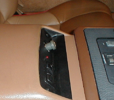

FieroAudio (blaine@korte.ca) MSG #269, 06-28-2003 04:18 PM
      Hey ski, you gotta get us some detailed interior shots...like for instance, where do you have all your strobe switches! lol
Yeah, I'd like to see some interior shots...
You really should do some stereo stuff in there...Your car would ROCK with a DVD player and Screen...not that it doesnt rock already ...
fieromadman (j_depies@hotmail.com) MSG #270, 06-30-2003 03:06 PM
      bump for interior shots..

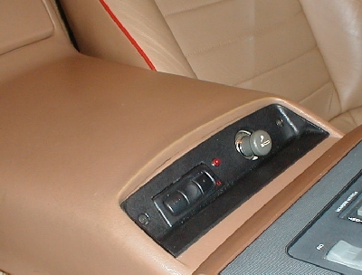

skitime (skitime@ptd.net) MSG #271, 06-30-2003 03:50 PM
      I covered my interior changes on page 5. What else do you want to see?
FieroAudio (blaine@korte.ca) MSG #272, 06-30-2003 04:01 PM
      ... A dvd player?
LOL
Sorry, didnt see those pics...LOL
skitime (skitime@ptd.net) MSG #273, 06-30-2003 04:35 PM

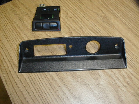

I have a defrost switch modified to be my switch for my driving lights. That way it appears stock and I always hated seeing that location being blank. It is wired so that the when the parking lights are off the driving lights are off too. I also have it wired so the indicator light on the switch comes on when the driving lights are on.
All my other switches are under the drivers ash tray door.
1. Main switch - turns off power to the rest of the switches
2. Engine lights switch
3. PONTIAC strobe switch
4. Headlight covers lights

The CD changer is available from any GM dealer. The radio can control either a 6 or 12 disc changer. I bought mine through Ebay for $85. The changer connects to a 9 pin socket on the back of the radio. You can see it in this picture near the center of the back.
This plug is not found on all Pontiac radios so be sure you have the correct radio before buying the CD changer. Be sure not to buy a 10 disc Delco changer. The 10 disc changer is not hard wired to the radio so the sound in not as good and you still would need a seperate CD control.

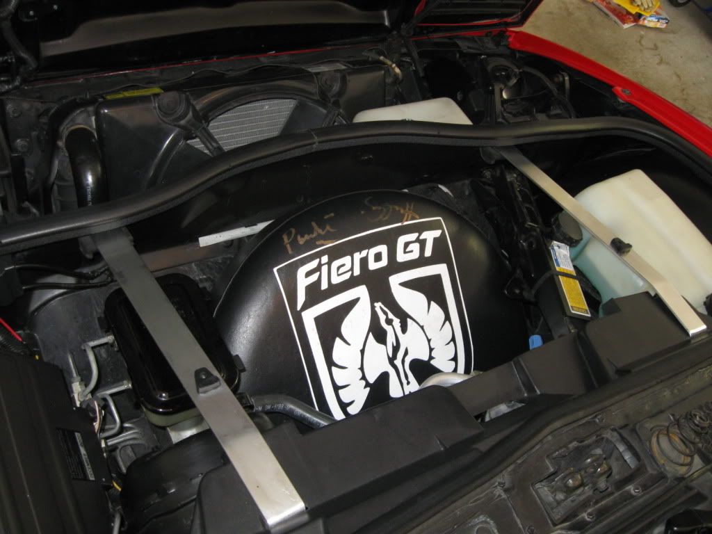

skitime (skitime@ptd.net) MSG #280, 07-05-2003 10:03 AM
Originally posted by Songman:
If you have a picture of the front compartment, I would love to see more on the placement of the CD changer. I'm getting ready to do my install as soon as I get adaptors. I also need the harness to go between the tape deck and the changer if you know any sources...
Sorry Songman it took a while to remember to take some pics for you. Here they are. If you have a sunroof you might have to move the sunroof storage mounts over to the right side slightly as we did in Vonnies car. I also had to slightly move the prop rod on her car to clear the changer.
I got my changer harness from a GM dealer. Be sure to get the one with the correct connectors. Sorry I don't remember the part number.
linenoise MSG #281, 07-05-2003 11:39 AM

Songman MSG #283, 07-05-2003 01:12 PM
Thanks Dave! That's going to help a lot. I didn't even think about mounting the changer at an angle like that!
My system came complete out of a Bonneville. I got it off of eBay for $91 for the radio, changer, and two 12 disc cartirdges! The guy said he didn't feel like digging through the car to take the wires out though.
I am putting this in my T-top so I don't have to worry about the sunroof. I'll go to a dealer and get the wiring I need. The only other thing I want for it is a steering wheel with controls!
skitime (skitime@ptd.net) MSG #284, 07-05-2003 01:33 PM
The CD changer is designed to be mounted horzontally or vertically and also 22.5*,45* and 67.5*
If you are installing a 12 disc changer I would think I would build a rack over the spare tire to mount it. You could mount it at the angle of the spare tire.

The engine window has been a tranformation. It has been made about 5 times with 4 different materials. I found the only material that is a long term solution is custom made tempered glass. Not cheap but the best. The fiberglass edge was filed into a curve.

skitime (skitime@ptd.net) MSG #383, 05-19-2004 09:20 PM
Originally posted by Red86SEautox:
So what are you working on now Ski? Anything new for the shows this year?
Well, I have been busy with non-Fiero projects all winter. My poor Fiero was neglected. So it is time to work on the Fiero again. Especially since Carlisle is next week. I just finished reinstalling the hood and front fenders after having them repainted. Last summer my motorcycle fell over and cracked the left fender. Nobody was near the motorcycle and it was a week before the 20th show. The hood did not suit me so it was reworked and the right fender had a spot where the paint got mysteriously cracked about the size of a quarter. So with all that repaired, I wanted to at least add one new mod. About a year ago FieroGT87 was advertising embroidery Fiero emblems for shirts, hats, sweats and jackets.
http://www.fiero.nl/forum/Forum4/HTML/013886.html
I contacted him about an idea I had and asked him to keep it between us. I really appreciated that he did because I am sure everyone will want this mod. I just like being the first. Well after I first communicated with him, I was suppose to get in contact with Rodney Dickman and order new beechwood speaker cloth and send it to FieroGT87. Somehow I never got around to it. One day FieroGT87 said he had a package being sent to me. Low and behold he ordered the beechwood speaker cloth and embroidered the emblems for me as a favor. What a nice thing to do. I really appreciated it and never expected it. Pennocks people are the best! Well his work is awesome with great detail. Today I finally got around to installing them. Wow, do I love them. We want to do it immediately to our other 88GT. So the rest of you get in line. So here are pics of the results.

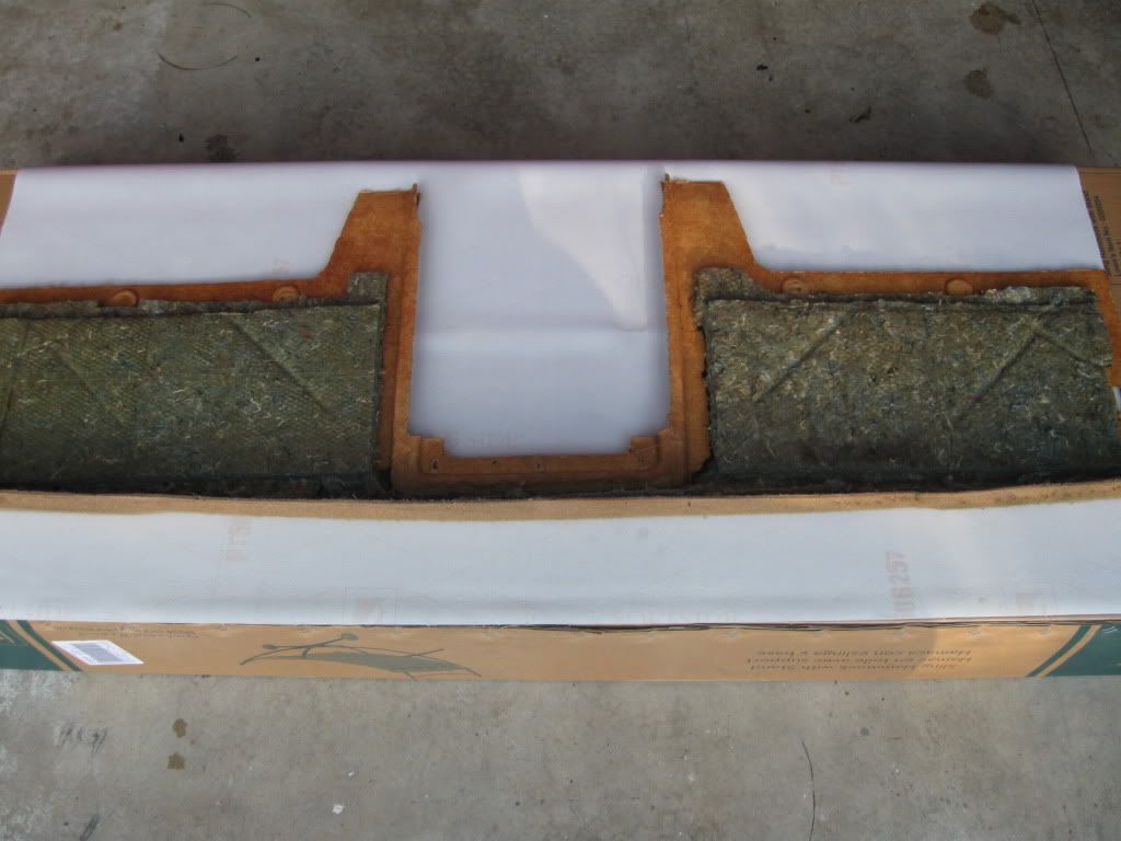

First shot shows my old faded speaker cover along side the new cover. Man were they faded. Funny how you don’t realize how faded they get.
Does the thermostat work with coolant flowing the opposite direction through the Fiero thermostat housing?
skitime (skitime@ptd.net) MSG #403, 08-31-2004 08:01 PM
Good question. I am only using the Fiero thermostat housing for a filler. The thermostat is still in the 3800 engine in the stock location.

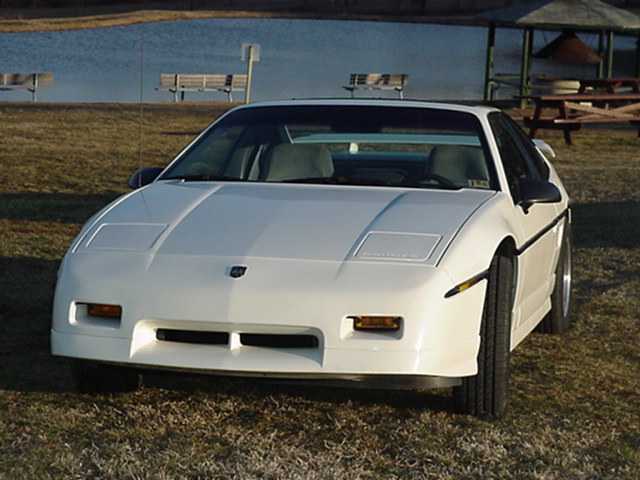

skitime (skitime@ptd.net) MSG #405, 09-01-2004 06:49 AM
Ski
Have you done or are you planning to do anything with your stock white 88 GT ??
Would you ever consider modding up a second car to the extent or beyond your red one ??
That is one sweet ride !
At this time the white GT remains stock, it is a good clean GT and even won first place at Carlisle in the Stock 88 GT class. I do sometime think of doing an engine conversion to it but keeping the stock look.

WingNut - MD (fiero25@sbcglobal.net) MSG #411, 10-01-2004 06:59 AM
edit to fix quote tags
I learn something new here everyday.
I have got to see a pic of the White GT. Can you give us some details on the car? I know I'm a broken record on this, but keep that one stock since the red one is your toy.

summerjim (jim@fiero.net) MSG #432, 12-07-2004 08:36 PM
What's keeping the heater core feed elbow from just popping out of the intake? Do you have a retaining clip or something to hold it in?
skitime (skitime@ptd.net) MSG #433, 12-07-2004 10:08 PM
      Yep
summerjim (jim@fiero.net) MSG #434, 12-08-2004 12:43 AM
      Could you post a picture of it and how it mounts? Thanks Dave

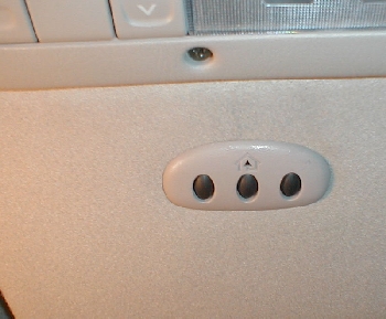

      Well, it has been a long time since I added anything to my car. I did a small fairly insignificant addition this winter so let me add it to the thread. I was playing around (Modding) with my Pontiac Vibe and it lead to a mod on my GT. I added a Homelink opener from a donor car sunvisor to my Vibe. Homelink is a permanently wired garage door opener that can "learn" to control three devices. I am sure that there are already people that made this type of mod to their Fiero since it is so easy and less expensive then even buying a replacement garage door opener. Simply get a visor with a Homelink control, remove the control from the visor, cut hole in new location for Homelink, connect two wires, put on the bezel.
[This message has been edited by skitime (edited 03-02-2007).]
skitime (skitime@ptd.net) MSG #514, 03-02-2007 09:23 PM
      I liked the Homelink so much that I decided to do it to my GT. I even bought a visor type Homelink that matched the 88 GT Beechwood interior. I was not thrilled to think about dropping the T-Top headliner to do the install so I then I started studying the different Homelink modules available on Ebay. I decided to take a chance and buy a console type I thought looked like I could make it work. This model is from a Cadillac Seville, Deville, or a Eldorado overhead console control. My plan was to install it on the cigarette lighter panel. After I received it I could not believe my luck. The cigarette lighter panel has an angled surface and so did the homelink control and the angle was an almost perfect match. To prepare for the install I removed the center Fiero console and relocated the service plug behind the panel. Then I cut a hole the shape of the Homelink control in the Fiero bezel. (Center hole is for the alarm warning light)
skitime (skitime@ptd.net) MSG #515, 03-02-2007 09:25 PM
That was it. Connected the ground wire and a constant hot wire then program the unit. You can wire it with a key-on hot wire if you are worried about extra security. Now I don't have to worry about a stolen opener during car shows and cruises. It never fails that when I came home from an event I could not find where the garage door opener was hidden. It works even better than the original opener with greater range and I don't have to worry about a dead expensive remote opener battery.
Fiero1Fan (fiero1fan@fieros.eu) MSG #516, 03-02-2007 10:46 PM
      Really nice. Looks like it belongs there. I've been thinking of doing something along the same lines so thanks for the tip on the Cadillac unit.
