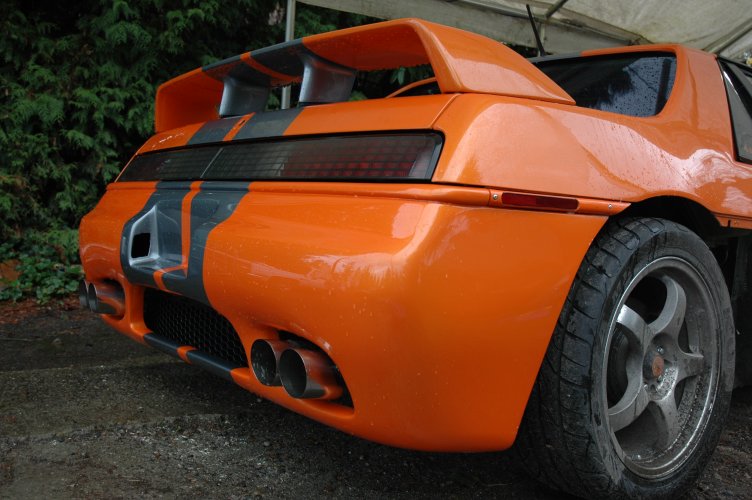

      The car is coming along so I thought I'd start the thread.
I really like the Lotus Sport Elise.
This images is larger than 100K. Click to view.
The Elise's Chrome Orange made me want a Orange Fiero. (I know this one's Yellow)
My Fiero will have the same dark silver stripes.
It's at the paint shop waiting for me to finish the bumpers and side skirts.

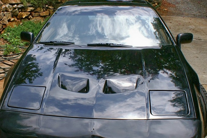

Here's the hood vents

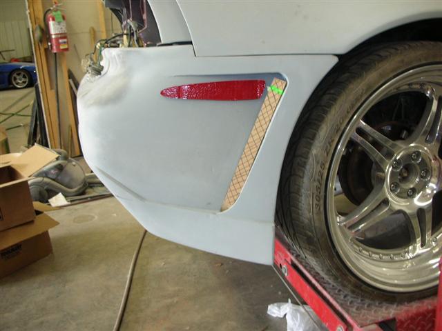

I have the molds made for the front and rear bumpers
Here's pics for the front bumper's plug, made from the top of the fiero bumper and the bottom of a civic's. (somewhat FieRo style)
fourpoint9 (stevenmsimpson@comcast.net) MSG #3, 09-07-2006 09:49 PM
      And here's the rear plug

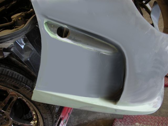

      And the Side Skirts plugs. Scoop panels and Rockers all one piece.
I still need to make the molds for these but the plugs are almost finished.

      Some interesting and creative work, very nice, keep it up. I really like that hood vent.
troyboy (mrtroyboy69@yahoo.com) MSG #10, 09-08-2006 10:23 AM
      WOW your car is going to look great! I love the hood vents, 2006 is proving to be a great year for fiero re-do's. I hope all the "New 2006 Fiero's " are ready for a show in 2007.

fourpoint9 (stevenmsimpson@comcast.net) MSG #17, 09-08-2006 08:09 PM
      Thanks for the nice replies.
The hood vents are Aerogear Universal NSX scoops
http://www.aerogear.net/products/Universal-NSX-air-ducts.htm
I have to agree with blackrams it's a lot of work (and cost) making these parts.
I will have molds for each piece and may sell some when my car is complete.
But my focus needs to be on making the first of each so the paint shop can have them.
FieroWannaBe I really like the first nose pic, the one you use for your avatar, looks sweet
I really need to thank XzotikGT who helped me with the rear bumper plug.
opm2000 (Mr. Pantero) gave me some great pointers to make parts release from the molds this weekend.
and my friend Jason who you see in the side skirt photo and here in this one spraying Gelcoat

fourpoint9 (stevenmsimpson@comcast.net) MSG #25, 09-10-2006 11:57 PM
Originally posted by mcaanda:
4.9 -
If you were wondering if the rear facia would fit on a GT - there's one here in Graham to try out on!
Looks good as well. When your ready for the possible sale of copies of 'er, please let me know. Shipping would'nt be too difficult.
--Allen
I'm 1 hour North of you near Burien WA
Did the Polish, Buff, Wax, Spray Mold Release and Gel Coat and first layer of fiber glass in the bumper molds. Should have parts to give the body shop by Friday.

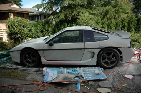

fourpoint9 (stevenmsimpson@comcast.net) MSG #34, 09-15-2006 03:42 PM
      Pics as promised. Fresh out of the molds with the mold release still on 'em.
I've got PARTS !!!

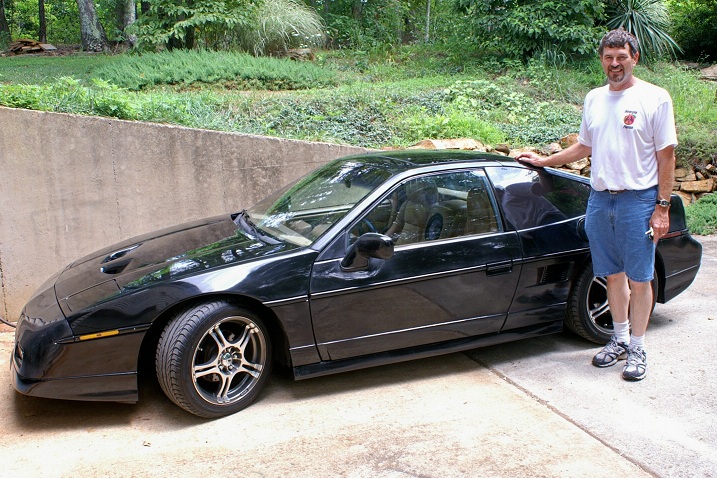

      Hey whats the suspension look like?

fourpoint9 (stevenmsimpson@comcast.net) MSG #42, 09-16-2006 12:46 AM
Intrax spring, Konis, Poly bushings, Alumium Cradle bushings, Suspension Techniques swaybars, Archie Big Brakes.
Oh, and Don't hate me under8ted, I do not have an Elise. I wish.

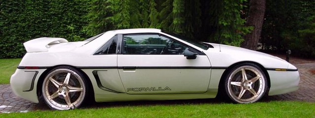

exoticse (exoticse@netzero.com) MSG #52, 09-19-2006 09:35 PM
Hey Fourpoint9,
Hope you don't mind, but i had Custom2m4, do a little photochop version of what your car might look like chopped. (note he had to use another notchie due to problems with your pic).
At any rate here it is with a liberty or two hehehe.
fourpoint9 (stevenmsimpson@comcast.net) MSG #53, 09-19-2006 10:07 PM
      That's cool thanks. I have wanted a choptop but I decided against it.
I want that extra head room for when I wear a helmet while autocrossing.
We'll have to photochop it again after the paint shop is done.
XzotikGT (marcellus_k@hotmail.com) MSG #54, 09-20-2006 01:48 AM
      I have always thought your car would be slick if it had 20's.....LOL
Fie Ro (roderick.baas@tros.nl) MSG #55, 09-20-2006 02:46 PM
Originally posted by fourpoint9:
Yeah that looks real good! Wish I could retain the trim but I only got a 84 nose to work with (which doesnt line up that nice with the civic's) so I skipped the trim and went a different route. So again: nice work!
(pic of mine here )
Tusch (john.partusch@gmail.com) MSG #56, 09-20-2006 03:39 PM
      ^I never realized that was a civic bumper down there haha. well disguised.
I can't wait to see this new notchie finished

fourpoint9 (stevenmsimpson@comcast.net) MSG #68, 10-31-2006 12:05 AM
      Cell Phone Pics.
No stripes, so far. But the bumpers are orange.
Should have silver stripes on Wednesday or Thursday.

fourpoint9 (stevenmsimpson@comcast.net) MSG #83, 11-04-2006 01:14 PM
Originally posted by madcurl:
Very, very nice. I really like the new VW plate light. What type of material was used on the bumper to prevent cracking since the bumper if flexable?
Thanks, I was in traffic one day and looked over at a newer bug's rear bumper and saw those plate lights and thought they would be just what I needed.
The bumpers are 100% fiberglass, not very flexable. I wish I could make urethane bumpers.

      This month has had more rain than any month in Seattle history (and it's not done yet)
Today was finally nice enough to mount the front bumper after work.
I took these photos in the dark.

I did get my antenna mounted. I do not have a radio for it yet, but the antenna is mounted.

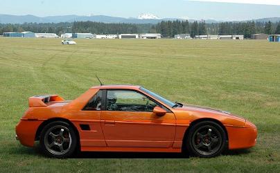

      Antenna mounted.

      Photochopped the side skirts on to it.
XzotikGT (marcellus_k@hotmail.com) MSG #126, 11-24-2006 11:06 AM
      Photchop some 18's on it.
FieroWannaBe (patond@alumni.msoe.edu) MSG #127, 11-24-2006 04:18 PM
      you hsould hav photoshoped the sailpanels in.

Well, since it's been painted, I've only driven it to the glass shop to get new door glass, and to the muffler shop to get the exhaust tips installed. The guys at Sunnydale Muffler liked it.
It still does not have side skirts (working on them now). My wife followed me in our Suburban on both trips and said most people look at it as it goes by. She's not sure if it's the sound of it or the bright orange color, but heads turn and smiles form.
Monday Icelander came over and helped me bondo and sand on the side skirt plugs. Thanks Icelander! I have some side skirt work pics I should post.
They are starting to look good. Tuesday I re-created my paint booth. This weekend is Easter so I will have family over and it doesn't look like I will get a lot done.

      Working on the side skirt plugs now.

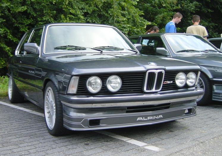

After I get done with my GT I'm considering a BMW E21 (Euro style) or a Fiero Notchback with an Ecotec.

      Sorry if I missed it, but can you give details on the hood scoops? Beautiful car!
fourpoint9 (stevenmsimpson@comcast.net) MSG #202, 05-05-2007 04:15 PM
      Working on perfecting the side skirt plugs today. Sanding and more sanding. Then Duratec Primer. Then polish....
http://www.aerogear.net/pro...al-NSX-air-ducts.htm
I just bought a BMW e30 baur cabrolet it is only a 318i but i need to save gas another doeruper.
needs new everything but it has 110,000kms so hasnt gone far in 20 years. After i finish it i will most likely buy another small engine car for daily driver as i put more money into fiero. Working on 2 cars now but was working on 3 just sold my 550cc micro ute.

      Thanks for the info on the hood scoops. Do you cut holes in the hood the size of the scoops and then glass them in? Any chance of getting a pic of the hood from the bottom side?

      Test fit

But I have one critque is that the sides of the front bumper seem to plain, like maybe throw a scoop on there or some sort of splitter.
fourpoint9 (stevenmsimpson@comcast.net) MSG #218, 05-28-2007 10:27 PM
      I have thought about making a front lip with splitters on the sides.
Might have to photochop it to see how it would look.

      Today's Arlington Picnic.
Hi all
Those skirts look absolutely incredible!! GREAT job! A + for your creativity sir.... That second pic is PURRRRRRRfectly beautiful... I've always loved notchies esp. with an aero like front end, and yours is just stunning, that orange color is a gorgeous choice and looks remarkable!!

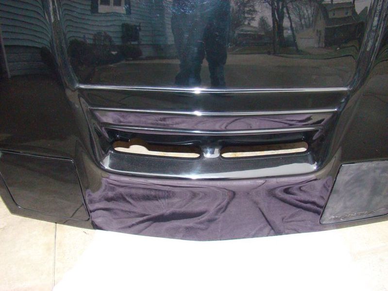

      Ok here's something I have not shared. I had to mount my license plate because Washington is a front plate state.
I've seen Corvettes with removable front plates and thought I'd make one with some kind of quick release. After talking to a friend about it, he suggested using a CB antenna mount
Here it is with the license plate
To remove it, I push in (it's spring loaded) and turn it
Then it pops out
Then I just put the Fiero badge over the female part of the mount in the grill, and it's ready to show
And here it is with a custom Fiero badge I made.
And I do have a plan for the turn signals. They will be mounted in the grill.

fourpoint9 (stevenmsimpson@comcast.net) MSG #277, 01-25-2008 01:51 AM
Originally posted by fatmerk:
what about the side skirts/scoops?
I did not take the side skirt molds to them.
The parts that came out of those molds had to be tweaked.
On both sides the doors rubbed some and
on the drivers side their was some fitment issues had to be fixed.
So if someone wanted the side skirts they would have to be prepared to deal with those issues.
During the summer (I work outside) it would be possible for me to make a set, perfect them and then make new molds.
But that would a lot of work, time and money. We'll see.

CoolBlue87GT (coolblue87gt@comcast.net) MSG #312, 06-15-2008 09:20 PM
      Just keeps getting better. Great job.
madcurl (madcurl@fiero-performance.com) MSG #313, 06-15-2008 09:32 PM
      One of the best looking rear bumpers on the market.
The front too.

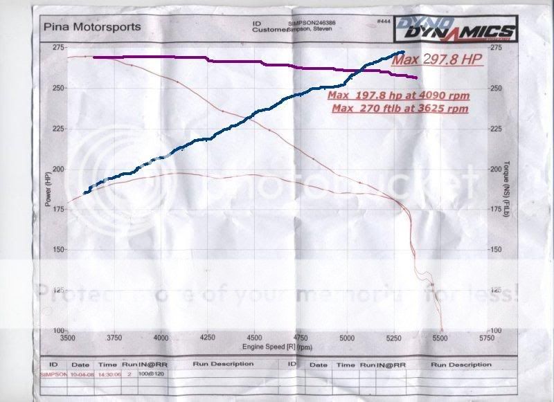

fourpoint9 (stevenmsimpson@comcast.net) MSG #327, 10-05-2008 12:25 AM
      Dyno day with the NWQuattro Club
197 whp 270 ftlbs
[This message has been edited by fourpoint9 (edited 10-05-2008).]
SpeedWorksAutoTuning (speedworksautotuning@hotmail.com) MSG #328, 10-05-2008 01:26 AM
      I am glad you came. IT was different seeing the numbers that thing put out. You should be proud!
fourpoint9 (stevenmsimpson@comcast.net) MSG #329, 10-05-2008 04:43 PM
      Got a 217 on my first run but they did not have my car tied down well, so the chart had bounces in it.
