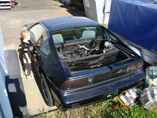

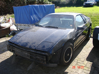

      I figure it is about time to finally start my build thread for the Steel Lady!! I hope you enjoy.

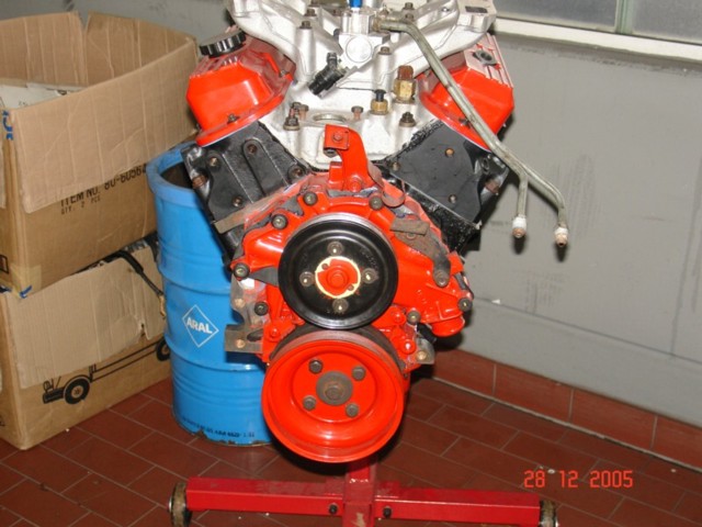

Here is what I started with, particially apart 88 GT with motor pulled and waiting for a 3.1.
[This message has been edited by Fiero1Fan (edited 12-27-2005).]

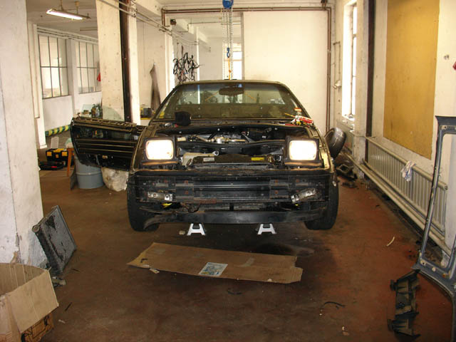

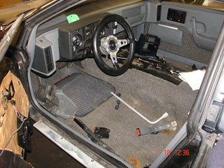

Fiero1Fan (fiero1fan@fieros.eu) MSG #2, 12-27-2005 03:30 PM

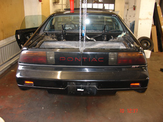

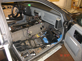

      The next step was getting into a garage to be worked on during the winter.
Now in the garage and on jack stands.
Seats removed along with alot of the interior.

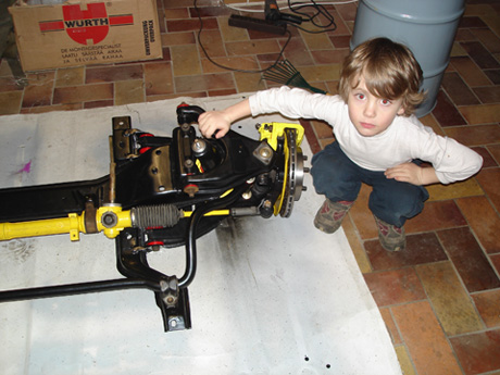

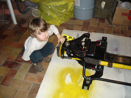

My son.

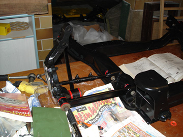

Fiero1Fan (fiero1fan@fieros.eu) MSG #4, 12-27-2005 03:41 PM

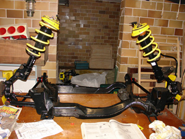

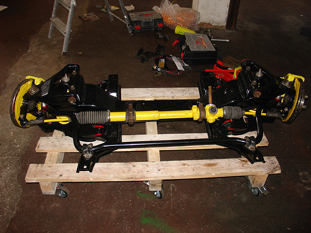

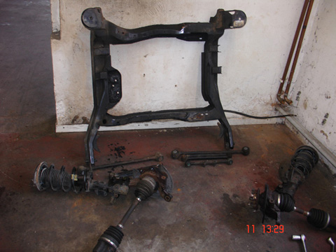

      Engine was already out so the next step was removing and disassembly of the engine cradle.
and then the removal of the front X-member.
and then taking it apart.
So far everything is going very well.

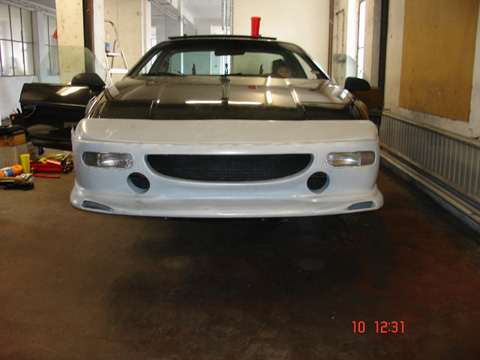

Fiero1Fan (fiero1fan@fieros.eu) MSG #6, 12-27-2005 03:48 PM

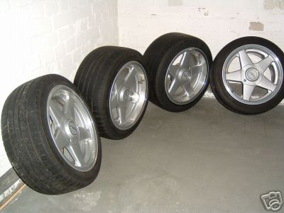

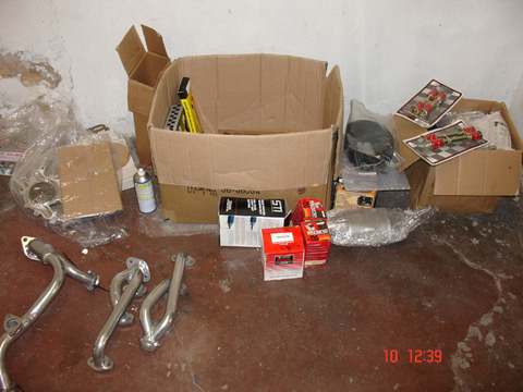

      I have a whole bunch of parts just waiting to go on the Lady.

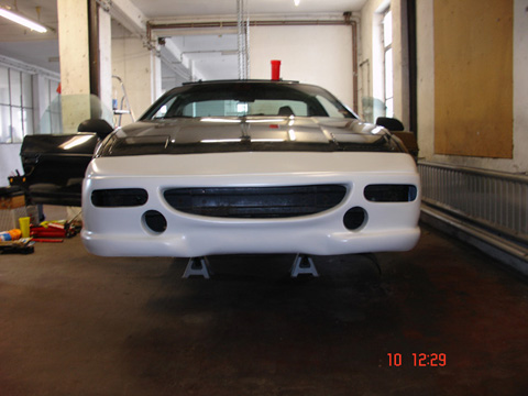

noses (which do you like better?)
Side Scoops

ryan.hess (ryan.h@excite.com) MSG #8, 12-27-2005 04:04 PM
Side Scoops
#2 both cases!
Dietmar's side scoops look a lot better, which is surprising, but I never saw a side by side comparison.

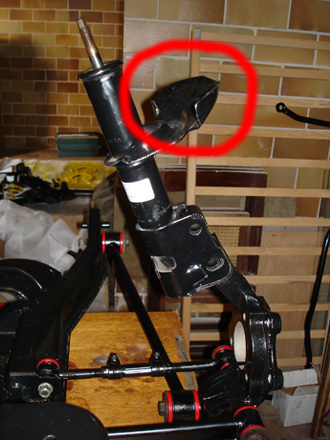

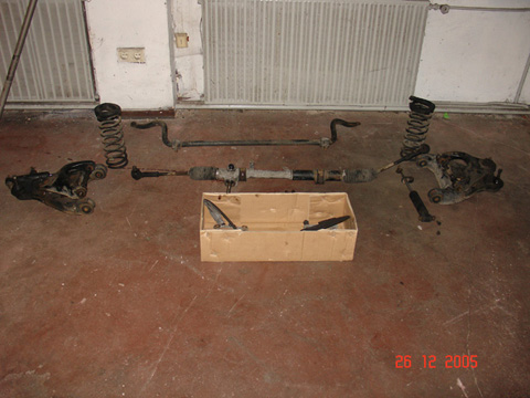

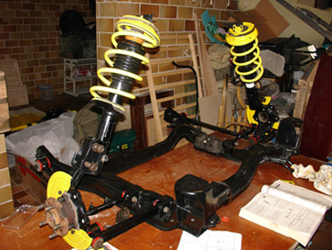

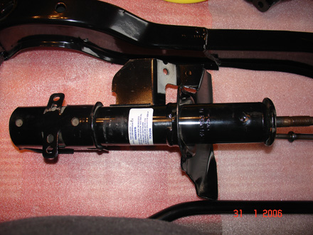

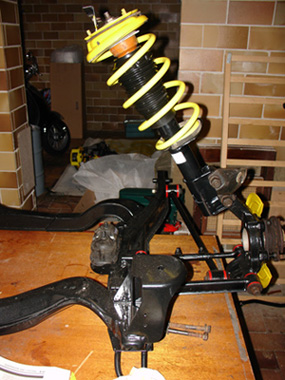

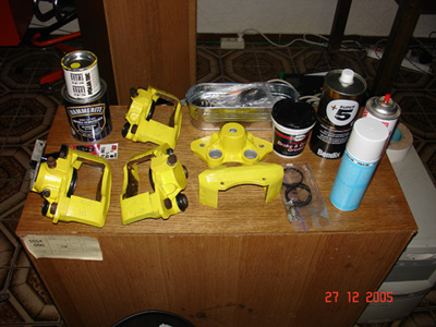

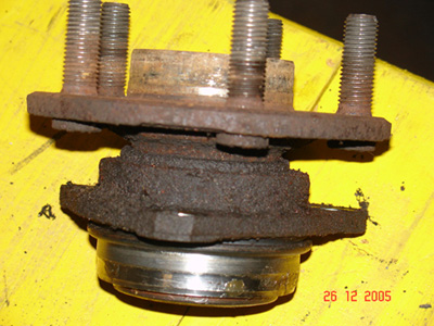

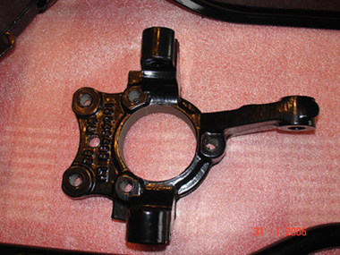

      Now begins the cleaning, repairing, rebuilding and repainting part.
First I did the brakes.

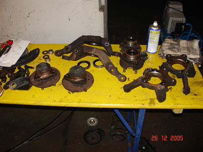

Next will be these. The knuckles and things won't be much of a problem because I use chemical baths to clean them.
The Hubs have seals in them so I will have to resort to a brass wire brush and engine cleaner.
edit: man I wish I could spell!!!

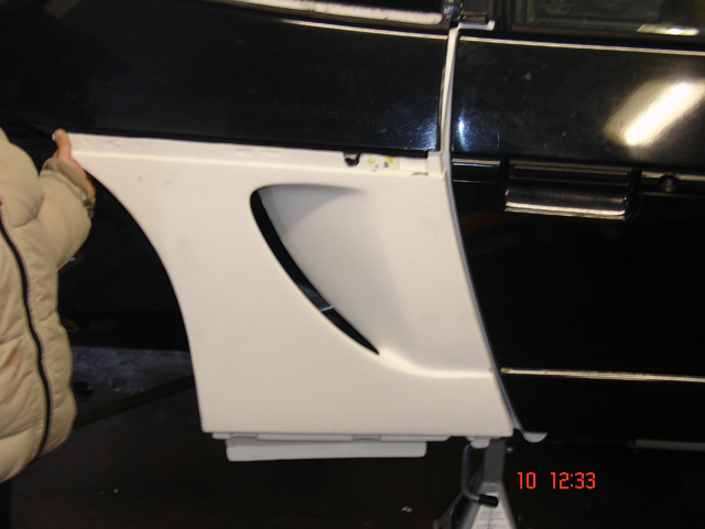

Fiero1Fan (fiero1fan@fieros.eu) MSG #10, 12-27-2005 04:17 PM

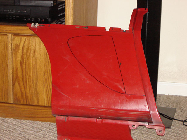

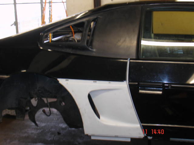

      Here are some pix of the Sailpanel Scoops I'll be using along with either the AUS scoops (top) or the ones from Dietmar (bottom).
My wife and Helmar (the hired help ) say the Dietmar scoops give it a smoother line.
Disillusion MSG #11, 12-27-2005 04:20 PM
      I like the first nose, where is that from?
alex de jorge (draco24433@gmail.com) MSG #12, 12-27-2005 04:20 PM
      I like the one on the left. BTW, are those headers I see? Where did you get the 355 nose at? Did you have any fitment issues with it or did it fit fine? What about the turns signals and fog lamps? Good luck on your build.
Fiero1Fan (fiero1fan@fieros.eu) MSG #13, 12-27-2005 04:23 PM
I kind of like the first nose too. It looks more aggressive to me. It is from a man here in Germany. I hope to have some cpoies of it by the first of March. The second f355 nose is from Dietmar here in Germany and I am looking into getting some copies of it done also (because it is the last one).

Yes those are headers from the Fiero Store. The Dietmar nose (the right one) fits perfectly. The f355 with the chin does not fit very well. I have someone who is going to take it and fix it then make copies of it for me that will fit right. Turn signal lights with fog/driving lights come from Ford Scorpio bumper lights.

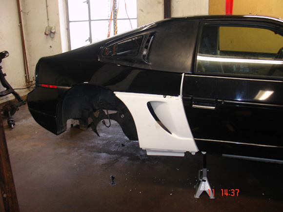

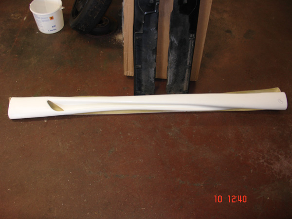

Fiero1Fan (fiero1fan@fieros.eu) MSG #15, 12-27-2005 04:50 PM
      Here is a set of side board mods from Dietmar that I'll be using.

      I like the second nose better, I'm not too big on having alot of holes up front- all I can think of is rice... Of the two scoops, I hate to say it, but I also like the Dietmar scoops better. Thanks for posting all the pics!
that's exactly my thoughts, but in Europe, you can get away with a lot more, just look at the cars that are coming off the lines! hehe j/k..
When I make my side scoops, I will be copying Dietmar's design, which is more or less a copy of the F355... They say imitation is the sincerest form of flattery, right?
JazzMan (jazzman@fierocentral.com) MSG #19, 12-27-2005 08:49 PM
[This message has been edited by JazzMan (edited 04-21-2009).]
Fiero1Fan (fiero1fan@fieros.eu) MSG #20, 12-28-2005 03:20 AM
      Thanks for the tip Jazzman.

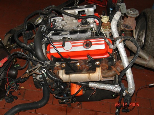

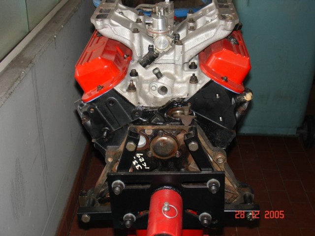

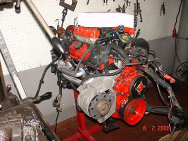

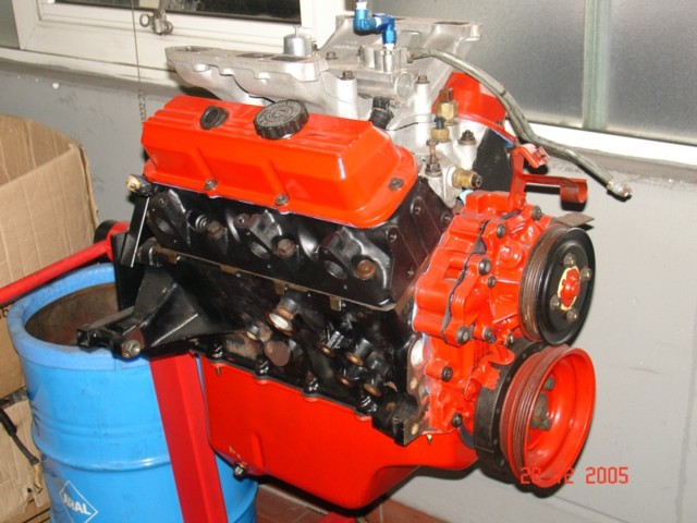

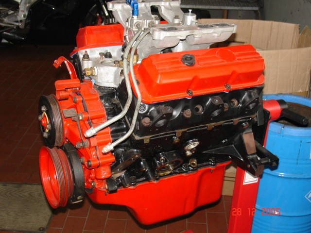

      Well now a couple of pix from the 3.1 going in to the car. The 3.1 was rebuilt by the previous owner and he did a really nice job. Crane performance everything (crank, pistons, cams, lifters, roller rockers, etc)!! So I am expecting it to run really nice!

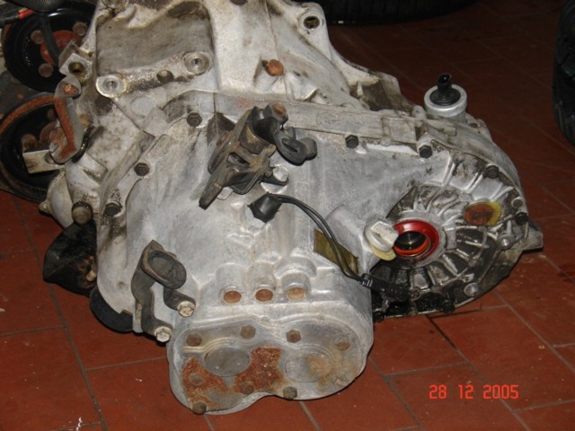

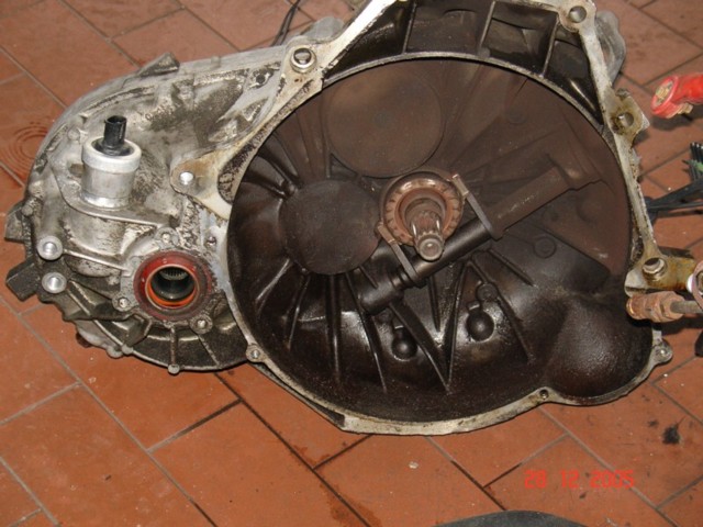

      Now a few pix from the trany out of the 87. Only has 70K on it and I'm putting a new clutch in it. I am having the 87 flywheel machined to a neutral balance and I pray it works.

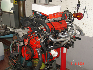

Fiero1Fan (fiero1fan@fieros.eu) MSG #26, 12-28-2005 02:49 PM
      Here is a pix of the 2.8 from the 87. Still runs fine and looks pretty good for 70k miles. I am planning on rebuilding it and keeping it for my next Fiero (maybe an 88 Formula).

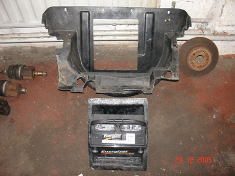

Fiero1Fan (fiero1fan@fieros.eu) MSG #30, 12-29-2005 10:21 AM

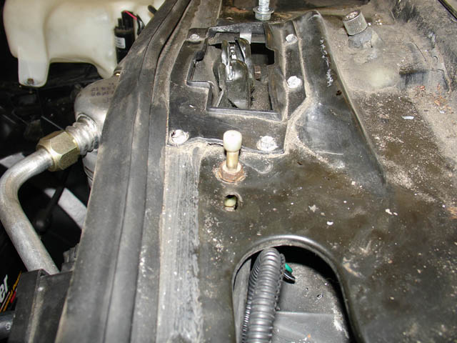

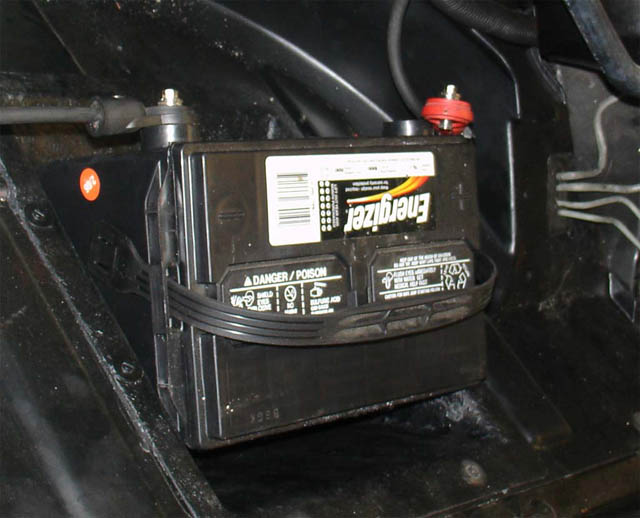

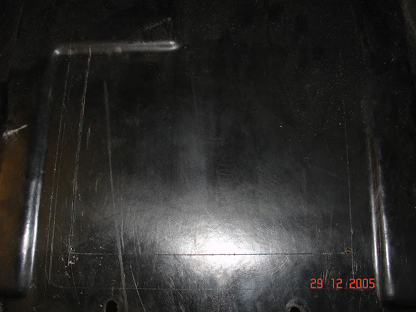

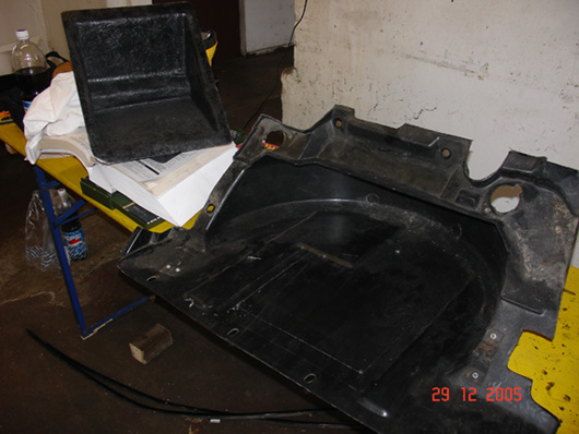

      Today I started the Battery relocation. I have a battery kit from Norm's.
Measured and started cutting the Spare Tire holder.
Hole cut but not yet exact. Final cutting and fitting will be done when front end is rebuilt and reinstalled to insure proper heighth.
When proper heighth is determined and cut then the battery box will be sealed with silicon and secured with screws to insure everything is water tight.
[This message has been edited by Fiero1Fan (edited 12-29-2005).]

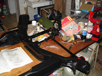

Fiero1Fan (fiero1fan@fieros.eu) MSG #45, 01-02-2006 12:09 PM

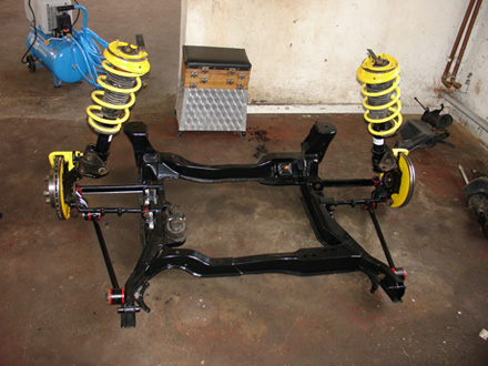

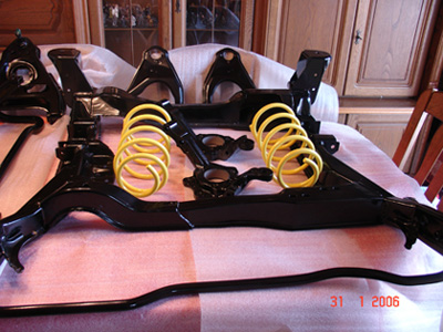

      Well I took my engine cradle and X-member to the shop today to have them sand blasted and base painted. I was worried that it would be very expensive. They only wanted $70 for the complete process. I was expecting to have to pay over $300. Boy that just made my day. I'll be taking several more parts over tomorrow for the same treatment.
[This message has been edited by Fiero1Fan (edited 01-02-2006).]

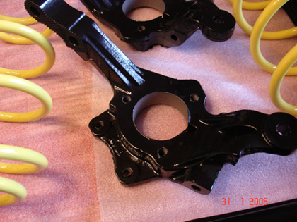

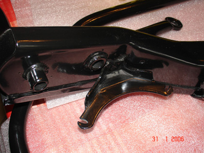

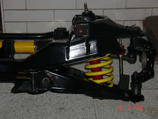

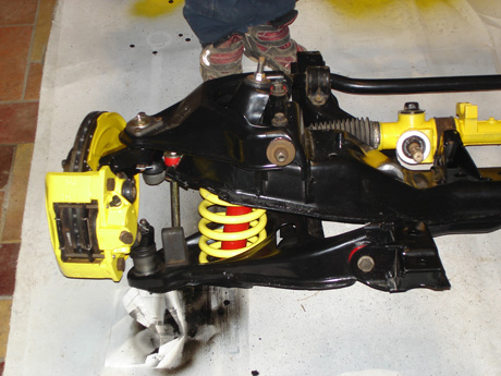

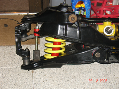

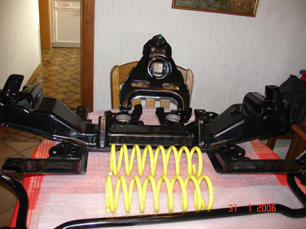

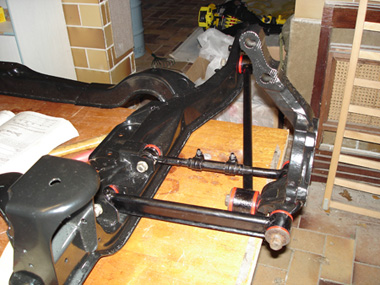

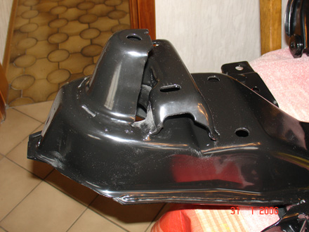

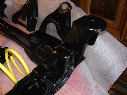

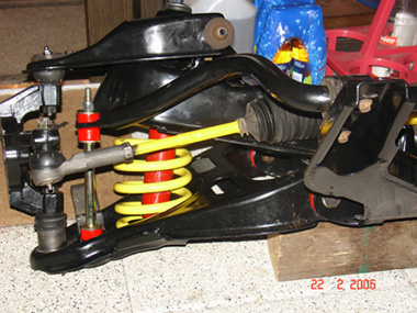

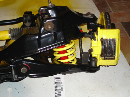

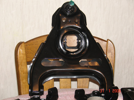

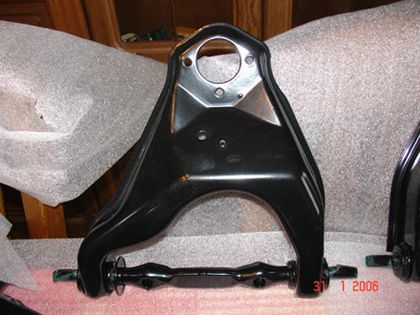

Fiero1Fan (fiero1fan@fieros.eu) MSG #48, 01-03-2006 09:44 AM
      More parts on their way to be powder coated.
[This message has been edited by Fiero1Fan (edited 01-03-2006).]
whadeduck (richardjborton@gmail.com) MSG #49, 01-03-2006 11:00 AM
      Mmmmm powdercoating. That's one thing I wish there was more of around this area. 'Twould cost me too much to have to ship everything off to do that. So I have to stick with paints for now. For as much as the Myrtle Beach area has, it's terribly lacking in other areas.
Torch-Red87 (mesias2000@hotmail.de) MSG #50, 01-03-2006 03:35 PM
      Powdercoating on this parts in this condition ?.
This does not work ,for me !.
[This message has been edited by Torch-Red87 (edited 01-03-2006).]

      The guy who does the powder coating also does the sand-blasting and presealant. The hubs will not be sand blasted. I'll clean those by hand.
So the condition will be like new after the coating.

      Is this nose available online anywhere?
yellowstone MSG #53, 01-04-2006 01:23 AM
      No, it isn't. It's a modification of the nose I have on my car but the guy who made them (in Germany) is no longer in business.
Fiero1Fan (fiero1fan@fieros.eu) MSG #54, 01-04-2006 03:55 AM
      The chin f355 nose might be available in the near future. I have a guy who is interested in making copies of it. I'll post more about it when I get more info.

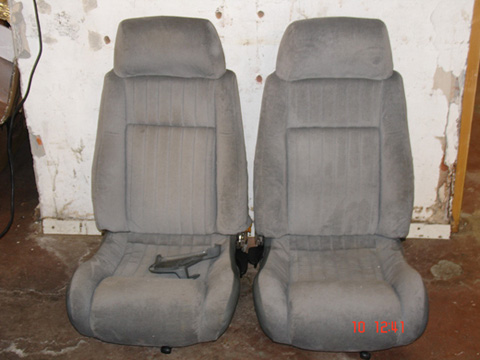

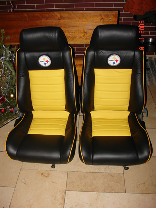

      Got my MrMikes seats, shifter boot, e-brake boot, visors and door panel coverings. These are VERY Fxxxing Nice!!! The man does fantastic work!!!
Well now the secret is out of why I named the car "The Steel Lady". Yup, I am a Steelers Fan!!
Fiero1Fan (fiero1fan@fieros.eu) MSG #62, 01-05-2006 06:02 PM
      I'll be doing the installs tomorrow on the seats and the door panels.

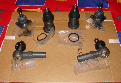

      I also got my Rodney Dickmans 1" lowering ball joints and Tie-Rods today. I have to wait on those until my parts get back from the Powder-coating.
Thanks for the fast delivery Rodney!

Fiero1Fan (fiero1fan@fieros.eu) MSG #72, 01-06-2006 05:54 PM
      MrMikes was the plan for today!!
I have my hired help.......
He took apart both seats.
Then he lost interest. It was just me and the camerawoman from then on.
Fiero1Fan (fiero1fan@fieros.eu) MSG #73, 01-06-2006 06:02 PM
      Off with the old.
Then on with the new.
Putting the bottom and back together.
Fiero1Fan (fiero1fan@fieros.eu) MSG #74, 01-06-2006 06:11 PM
      Passenger seat finished. Drivers seat yet to go. Now on my own. Camerawoman decided to take the rest of the night off!! Union workers! Go figure!
Passenger trying out his seat. (He thinks it's his!! )
Both seats finished!!!!! Hurrah Hard Core!!!
Only took me about 6 hours.
[This message has been edited by Fiero1Fan (edited 01-06-2006).]

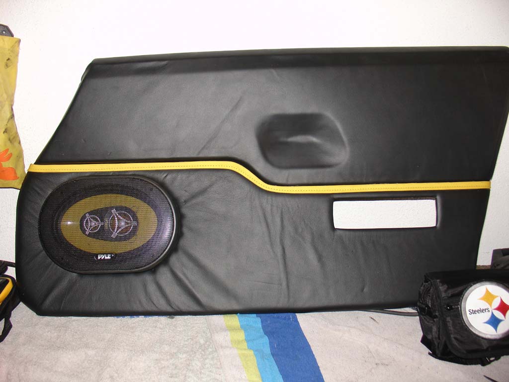

      Inner Door Panels have now been preped, cleaned, filled and trimmed. Now ready for the MrMikes leather door covers. (Tomorrow)
I needed about 2 hours for the prep. In the video MrMike makes it look so simple. Well tomorrow will seperate the men from the mice.

Fiero1Fan (fiero1fan@fieros.eu) MSG #102, 01-27-2006 04:08 PM
      I have a found some rims for @ $120 that will hold me over until I can buy my dream rims.
Which ones should I choose?
These (name ?) 16x7.5's?
or the AZEV 16x7.5's?
These are my dream rims:
LUD (wothrottle@gmx.de) MSG #103, 01-27-2006 07:06 PM
      as I said on the phone,16" are really too small for my taste,the first set of rims are tsw blades.
if I had to choose from the above,I would buy the tsw rims.
greets from berlin
Fiero1Fan (fiero1fan@fieros.eu) MSG #104, 01-27-2006 07:10 PM
      These are just temporary until I can buy the Billets in 18".
Fiero1Fan (fiero1fan@fieros.eu) MSG #105, 01-28-2006 01:48 PM
      Well some one else beat me to the top ones so I took these.
They'll hold me over for now.

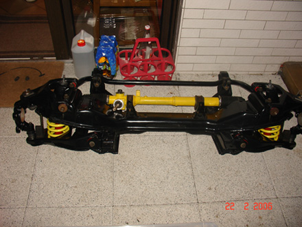

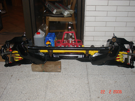

Fiero1Fan (fiero1fan@fieros.eu) MSG #106, 01-31-2006 10:58 AM
      Good Golly Miss Molly look what I picked-up today.
Rear suspension
Front Suspension

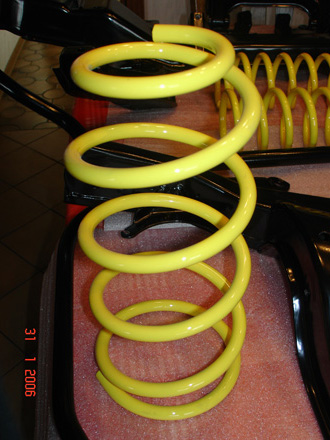

Fiero1Fan (fiero1fan@fieros.eu) MSG #107, 01-31-2006 11:06 AM
      Now for some close-ups. Rear:
Spring
Knuckle
Strut (Gabriel)
Cradle Mount Points
Front
Rear

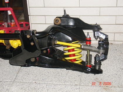

Fiero1Fan (fiero1fan@fieros.eu) MSG #108, 01-31-2006 11:14 AM
      Front close-ups
UCA (still have the alignment bushings in and will now be removed)
LCA (still have the old ball-joints which will now be removed)
X-Member Tower
Front Springs
Gabriel Shocks
Front Knuckle
Fiero1Fan (fiero1fan@fieros.eu) MSG #109, 01-31-2006 11:16 AM
      They look brand new. The guy did a fantastic job.
Tomorrow I get to put them back together. God I hope I remember how!!! LOL.
whadeduck (richardjborton@gmail.com) MSG #110, 01-31-2006 11:19 AM
      It's simple to put the front suspension together. Lefty-loosey, righty-tighty right? Ain't I just a smart ass?

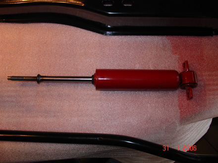

Fiero1Fan (fiero1fan@fieros.eu) MSG #111, 01-31-2006 11:24 AM
      I will be painting the shocks and struts the same color so that they match.
The question is red, yellow or black? My new bushings are red poly. So maybe red? Or yellow to match the Springs and brake saddles?
What do you guys and gals think?
[This message has been edited by Fiero1Fan (edited 01-31-2006).]

yellowstone MSG #113, 01-31-2006 12:10 PM
      Beautiful! Much better than my attempt with a pressure washer and POR-15... but mine was cheaper :-)
Who said that red and yellow don't look good together? :-)
Fiero1Fan (fiero1fan@fieros.eu) MSG #114, 01-31-2006 12:15 PM
      I only paid 250€ for the coating. How much was all your materials for the POR-15?

Fiero1Fan (fiero1fan@fieros.eu) MSG #119, 02-02-2006 10:35 AM
      Well things aren't going so good today. I can't get the adjustment bolt out of the UCA. The Police would give me a big citation if I burn them out here in Germany. I'll have to think of something else.

Fiero1Fan (fiero1fan@fieros.eu) MSG #128, 02-06-2006 05:51 PM
      I took some pix of the 3.1 today. It's coming along real nice. Just waiting on the flywheel to get here from the states (maybe next week).
and
It's not the prettiest thing in the world but it'll do me and the Lady just fine until the ser.II or III 3800sc is swaped in.
yellowstone MSG #129, 02-07-2006 12:56 PM
      I don't know what why people have this issue with the 2.8 - I think it looks just fine when cleaned up...
Fiero1Fan, I think yours looks great!
Fiero1Fan (fiero1fan@fieros.eu) MSG #130, 02-07-2006 01:34 PM
      What I was talking about is the layout of the wiring and hoses. I think it could look alot cleaner. When I have it up and running for this year I'll leave it as it is until next winter. Next winter I will redesign the hoses and wiring. I hope it will look cleaner and nicer after I am through.
I too find a V motor looks real good (they look balanced).

      Well I finally got off my duff and got some work done. I put the x.member back together today. What do you think?
From the front:
From the rear:
It took me all afternoon. First time is always a learning experience. Tomorrow the cradle...... !!!!
whadeduck (richardjborton@gmail.com) MSG #140, 02-22-2006 02:05 PM
      Looks sweet. Strong work. Maybe I'll do mine in silver, blue and black like the Panthers. Just the underside though. Outside I still think I'm painting it bright red. Do you have plenty of room to put a tarp in the back for covering puddles? I'd pass out if I got something that nice looking dirty.
Fiero1Fan (fiero1fan@fieros.eu) MSG #141, 02-22-2006 02:28 PM
      puddles......LMFAO!!!!!
Fiero1Fan (fiero1fan@fieros.eu) MSG #142, 02-22-2006 02:31 PM
      The only thing about it is using the old bolts and washers. Once I get everything aligned and working right I'll be painting them with a rust covering paint so it all looks clean and new. At least for awhile.

I started cleaning and repainting the trany today. Man what a Royal Pain in the south end of a north bound mule!!!! Pix tomorrow.
I hope to have it finished tomorrow. My flywheel should be here next week and then the engine, trany and clutch assembly can come together.
YELLOWFIERO88 (yellowfiero88@aol.com) MSG #147, 02-24-2006 12:44 AM
      Heck I dont remember but I have done worse things and I cant find it It was in my orion audio folder and what happened to it I dont know.
The trans are a royal pain to clean. I have used sulfuric acid to clean them before and also super clean.

      I have given up on trying to clean the trany by hand with just engine cleaner and some brushes. Monday it goes to the car wash and will be cleaned with the pressure hose!!

Fiero1Fan (fiero1fan@fieros.eu) MSG #151, 03-17-2006 02:28 PM
      Well I have finally got some more done on the suspension.
The front x-mem is finished except for putting it back in the car.
[This message has been edited by Fiero1Fan (edited 03-17-2006).]
Fiero1Fan (fiero1fan@fieros.eu) MSG #152, 03-17-2006 02:35 PM
      I also got started on the rear cradle.

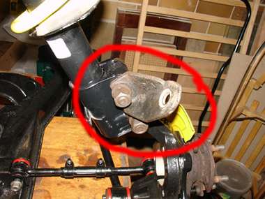

      I have a question on the struts for an 88. Do I need the wing on the strut ( circled in red)? I know I need the base for the spring to sit on but how much of the rest of the wing do I need?
whadeduck (richardjborton@gmail.com) MSG #157, 03-18-2006 10:56 AM
      Good question. But I've only worked on the struts for the earlier models. I won't have to deal with that for my Ferrario though. It's getting coil overs in the back. My guess from looking at it though would be no. You don't need all of that material. I'm probably wrong though. Give me a little bit, I have to take one of the rears off of the donor car to get a tire repaired. I'll take a look at things and see what it looks like with the spring still on it. It may just be an aftermarket one-size-fits-all kind of thing.
Fiero1Fan (fiero1fan@fieros.eu) MSG #158, 03-18-2006 11:19 AM
      I'll do coil over next winter.

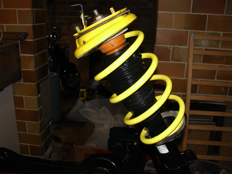

Fiero1Fan (fiero1fan@fieros.eu) MSG #159, 03-20-2006 04:12 PM
      Well I got the wings cut off (successful amputation) and alot of the rear suspension finished. Brakes and things will be tomorrow. Sorry I didn't get any pix today, tomorrow I get some posted.

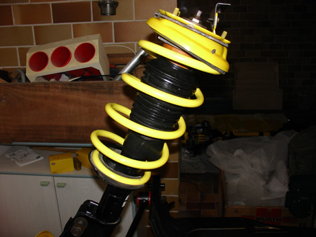

Fiero1Fan (fiero1fan@fieros.eu) MSG #161, 03-21-2006 11:19 AM
      Well I promised some pix and here they are. The cradle isn't finished but I'm getting there. This is going better than I thought.
First the complete pic.
Suspension Left
Suspension Right
Fiero1Fan (fiero1fan@fieros.eu) MSG #162, 03-21-2006 11:22 AM
      Here is close up of the spring assy.
Left
Right
I think they look alot better after the wing amputation that I preformed.

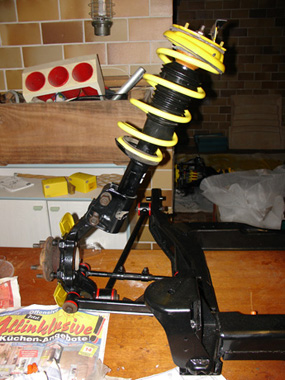

Fiero1Fan (fiero1fan@fieros.eu) MSG #163, 03-21-2006 11:27 AM
      Now I have a question. Where the strut is mounted to the knuckle there is a bracket that I believe is for the rear sway bar. Neither my Haynes not the Chiltons mention or show pix of this bracket.
The whole assy.
Close up of bracket.
Is the bracket mounted correctly?

      I was putting the brakes and brake disks on the cradle today and found that one of my hubs wobbled. I wanted to scream. Means I have a bad hub on the right side. Well tomorrow I will have to make a trip to my parts car and do some thieving. I didn't notice it until I was done.

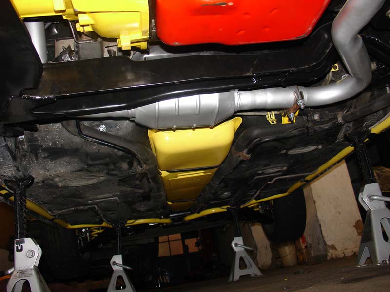

      Newest update. X-Mem and Cradle finished and ready to be reinstalled.
I finally got my new flywheel and once I have the undercarriage installed I'll trailer the car to where my mechanic will help me install motor, manual 5 speed trans, clutch and shifter mechanics.

      I finished the cleaning and painting of the getrag today.
Hey 1000 posts. Man do I type alot of junk!!!
[This message has been edited by Fiero1Fan (edited 04-06-2006).]
whadeduck (richardjborton@gmail.com) MSG #171, 04-06-2006 07:48 PM
      Lookin' good. How'd you clean all of the nooks and crannies of the tranny?
Fiero1Fan (fiero1fan@fieros.eu) MSG #172, 04-06-2006 09:01 PM
      I tried alot of different thing but nothing work worth a shjt!! So I took a can of engine cleaner and went to the car wash. It's amazing what a High Pressure bath will do to the gunk that builds up. Of course I was wet from head to foot. My son thought it was the funniest thing he had ever seen. Of course he wanted to try it too. Imagine that. My wife didn't think it was so funny.

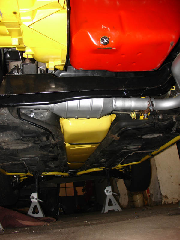

Fiero1Fan (fiero1fan@fieros.eu) MSG #174, 04-16-2006 02:11 PM
      Well I got the X-mem and the Cradle back in the car. Plus I had to see how the rims will look. A few pix.
It's coming along.

      Well here is something I have been playing with for a day or two. I had bought for the B-Pillars. The speaker covers on the B-pillars were ugly and the covers from the speakers would NEVER fit onto the pillar covering. I decided to make my own. I took the ugly speaker covers off the pillar covering and then removed the cloth. I then cut out the grill face and smoothed things down. I then took the grills off of the Speaker grills and cut them down to fit inside the original ugly speaker covers.
I then painted the ugly covers and then glued the grills to the back of the speaker covers and HELLO no more ugly speaker covers!!!!!!!

Kohburn MSG #177, 05-08-2006 11:42 AM
The whole assy.
upside down or switch left side and right side.. the hole should be relatively vertical for the sway bar end link to pass through
Fiero1Fan (fiero1fan@fieros.eu) MSG #178, 05-08-2006 11:44 AM
      Thanks Kohburn. With the help here I was able to get it right.

      Well I didn't get as far as I wanted to on Saturday. I removed and disassembled the window power motors and mechanism. The forward and downward pointing pw motor is in the way of my 6x9 speaker install. So I decided to move the motor upward. I got it all apart, did some trimming on the housing and then got a friend of mine to weld them back together. My thanks to Rickady88GT for the How To on this.
Rickady88GT's How To also showed how he moved the bumpstop that is located on the front lower end of the window. I had problems with the bracket he used. I couldn't get the bracket to clear the middle brace in the door and still catch on the upper lip. So I came up with my own idea. I'll post pix tomorrow on what I have done.
Fiero1Fan (fiero1fan@fieros.eu) MSG #197, 05-20-2006 04:58 PM
      Well I finally got some more stuff done today.
First off I got the bump stop issue finished. I had problems getting the bracket like Rickady88GT made to clear the middle door brace and still catch on the upper door brace. So here is what I did. I used a 6.5 x 30mm bolt with washers and self locking nuts in place of the bracket.
I then cut off the rest of the bolt until it would pass by the middle door brace.
I then cut a small tab into the upper brace and bent it back towards the window.
The nuts now hit the tab and act as the front window bump stop.
Next I'll pickup some heat shrinkable tubing to cover the nuts so I don't have a metal hitting metal sound when I roll up the window.

      Then I installed the pw motors back in the doors.
Here is what they look like after the control arm has been repossitioned upward.
As I said above, there is enough room now in the doors to fit a very nice set of 8" speakers!!
Thanks again to Rickady88GT for the How To.

I now have the 6x9 holes cut and the speaker wires run into the cabin.
Here I have the stereo connector installed. Was a bit of work soldering all the connections but I had to because the original connector was destroyed.

      Installed my Battery Relocations Box (from Norms) and routed the cable to the rear.
Front of Box.
Back of Box.
Started routing the Cable from the engine compartment. I went through the rubber gromet here.
Entered the drivers cabin here under the ECM.
Routed the cable forward in the Console.
Fiero1Fan (fiero1fan@fieros.eu) MSG #205, 06-01-2006 02:22 PM
      Here the cable disappears down under the heating duct.
Then comes back up and out here. Here you can see the hole I drilled for the cable to pass into the front compartment.
Here in the front compartment the cable comes out between the two hoses.
Perfect!!!

First the OEM clutch. I got this from GM here in Germany for $0.00 several years ago so why not use it? The clutch didn't come with a guide pin. So we improvised with a long socket that fit just right into the clutch plate and it worked great.
Here is a pic of the guys that helped. Helmar on the left and Michael on the right.
Then we got the Trany hooked up.
[This message has been edited by Fiero1Fan (edited 07-02-2006).]
Fiero1Fan (fiero1fan@fieros.eu) MSG #217, 07-02-2006 12:55 PM
      Next came getting the engine assembly onto the cradle. Went great with 3 people to help lower and guide everything together.
Then we got most of the rest of the cradle back together and ready for the installation into the car.

Fiero1Fan (fiero1fan@fieros.eu) MSG #227, 08-20-2006 02:00 PM
      You're not going to believe what happened yesterday!! We finally got the engine in!!!!
Here it is with only the cradle bolted up:
Left side:
Rear:
Right side:
Here is a pic of the idiots that put it in.
Here is the engine after connecting most everything.
Left:
Right:
Then we put the wheels on to see how it looks.
Startin to look like a car again, what?

Fiero1Fan (fiero1fan@fieros.eu) MSG #248, 02-24-2007 12:01 PM
      Hold on to your seats!!! I finally have an update.... the tank is in!!
Oil is in and anti-freeze too next Saturday is D-Day!! Keep your fingers crossed.

Fiero1Fan (fiero1fan@fieros.eu) MSG #251, 03-03-2007 07:01 PM
      Started bleeding the clutch and brakes today. Everything went find and without a hitch. I just followed the procedure in the Factory Repair Manual.
My mechanic friend wasn't able to make it down today but will be here next weekend I hope. I am really getting anxious about what will happen.

Fiero1Fan (fiero1fan@fieros.eu) MSG #275, 04-02-2009 11:53 AM
      You're all not going to believe this but I have an update....
Started finishing the door panels and mounting the 6x9's.
I'll deal with the wrinkles tomorrow.
