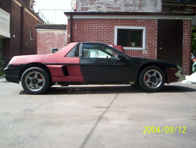

bubbajoexxx (bubbajoexx@sympatico.ca) MSG #1, 09-12-2003 06:18 PM

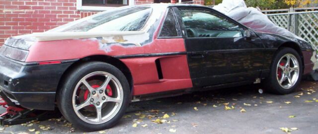

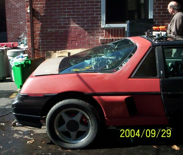

      my newest project a 12" stretched fiero using a N* with 5spd porsche tranaxle and new body configuration

1 12 inch stretch wagon concept with N* / Porsche transaxle / Webber fuel system

stevenrossi (stevenrossi49@hotmail.com) MSG #2, 09-12-2003 06:32 PM
      Coool concept but the car itself looks a little like a hearse, not to bad mouth it...you should just try to revise the style...perhaps some of the more imaginative people on the Forum could give their suggestions. Sweet project, I still wanna know how the 4.9SC went for you.

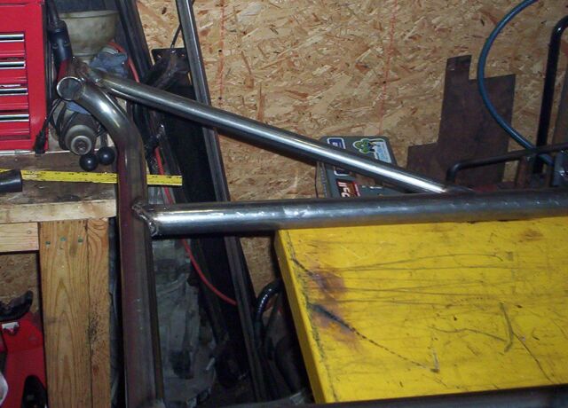

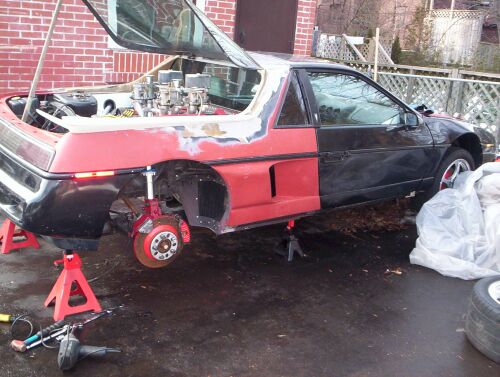

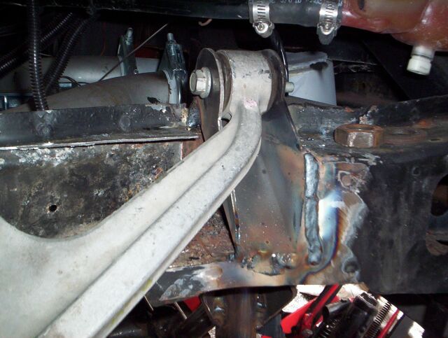

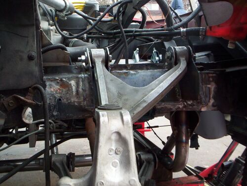

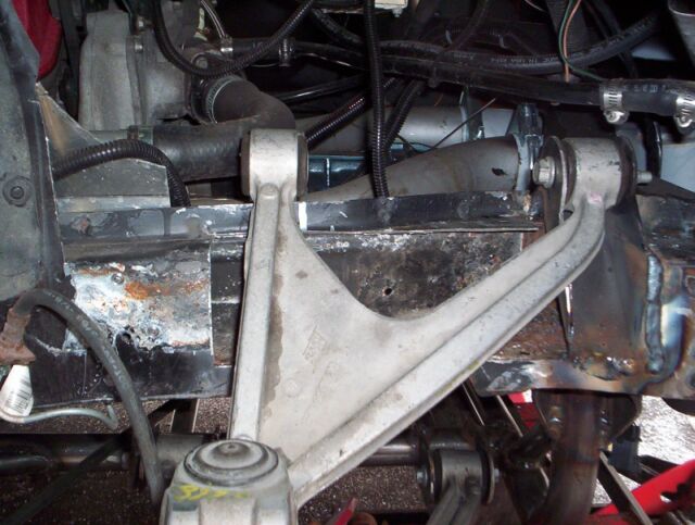

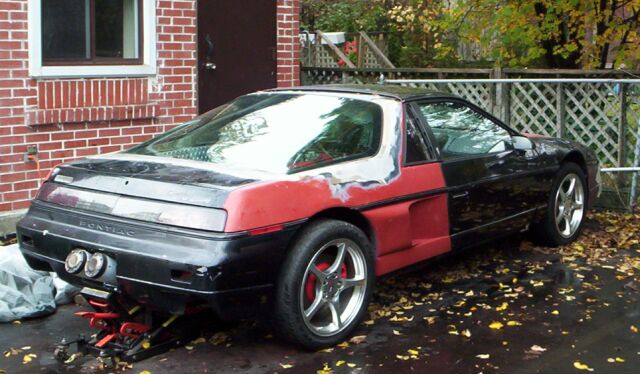

bubbajoexxx (bubbajoexx@sympatico.ca) MSG #36, 10-04-2003 12:03 AM

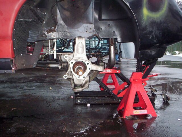

      here are some pics of the process so far
bubbajoexxx (bubbajoexx@sympatico.ca) MSG #37, 10-04-2003 12:11 AM

bubbajoexxx (bubbajoexx@sympatico.ca) MSG #45, 10-04-2003 03:43 PM
      here are some more

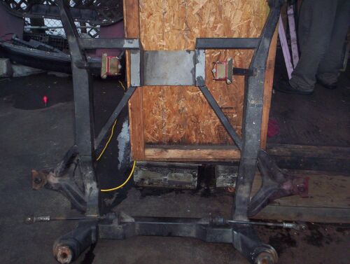

bubbajoexxx (bubbajoexx@sympatico.ca) MSG #47, 10-04-2003 06:34 PM
      thank you this is the hardest part to make the upper section will be made from 2 more rear sections and glass fill

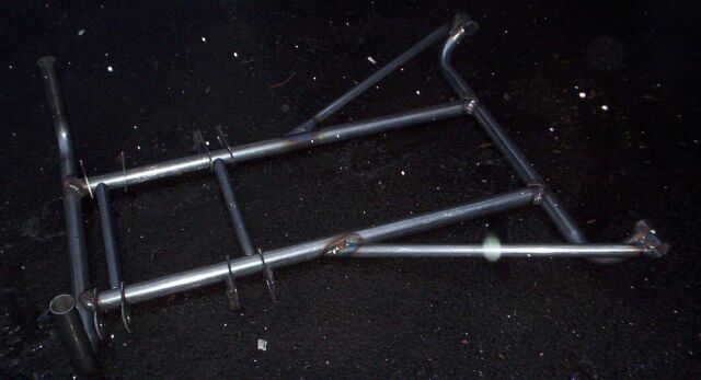

bubbajoexxx (bubbajoexx@sympatico.ca) MSG #48, 10-04-2003 06:39 PM

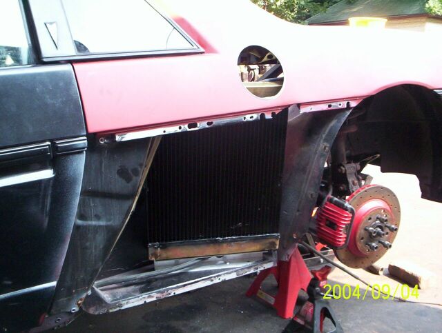

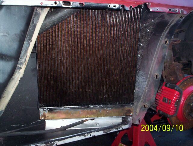

as you can see the chassie is well reinforced and the new space will hold the new rads one on each side
30+mpg (wshaw@par1.net) MSG #49, 10-04-2003 10:10 PM

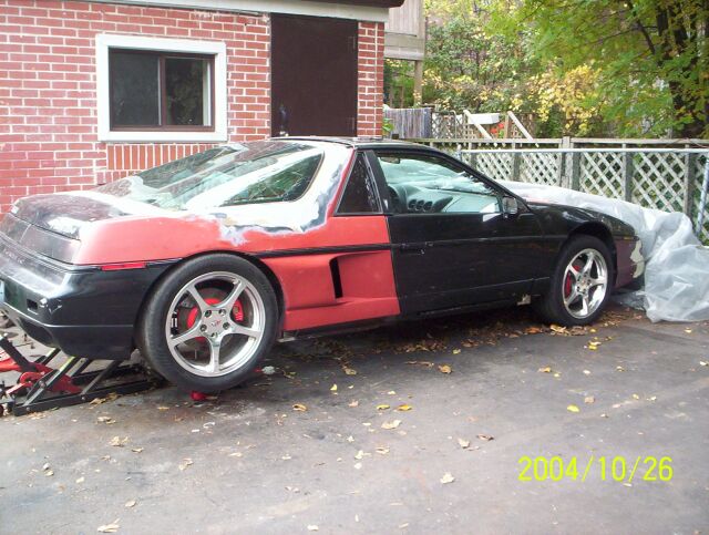

bubbajoexxx (bubbajoexx@sympatico.ca) MSG #54, 10-05-2003 03:30 PM

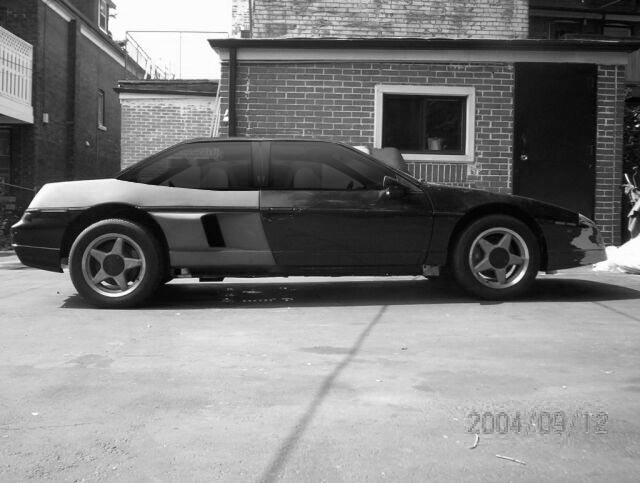

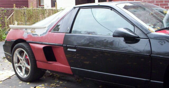

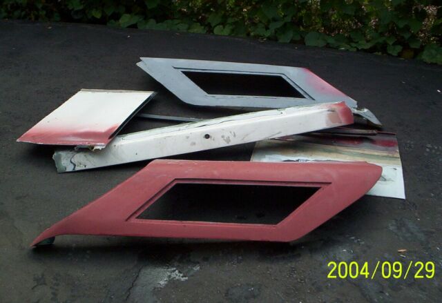

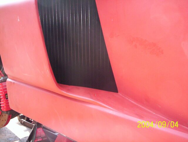

      started mock up of the side pannels that will be replaced with scoops once the lower rocker extentions are complete

bubbajoexxx (bubbajoexx@sympatico.ca) MSG #59, 10-05-2003 10:37 PM
      I thank you but I dont think 25 lbs of fiberglass will hurt that much the weight of the car has not increased much as there was as much cut out as put back in the new trans is lighter the engine is 30 lbs heavier and the relocated rads will weigh almost the same as the original the under car cooling tube will be removed and the front filled for a trunk

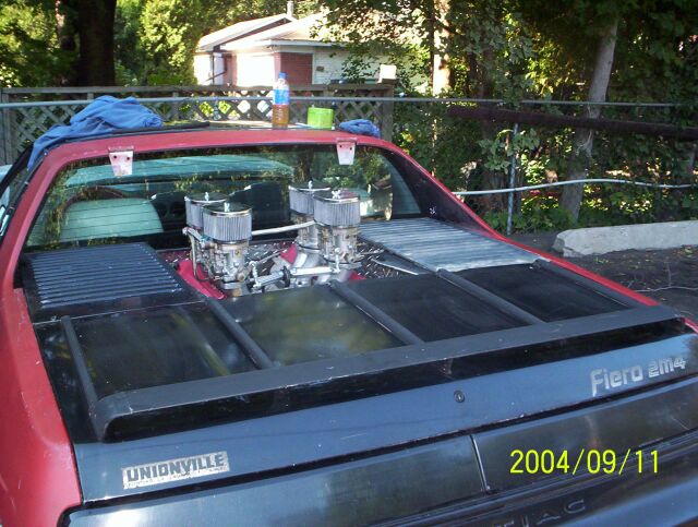

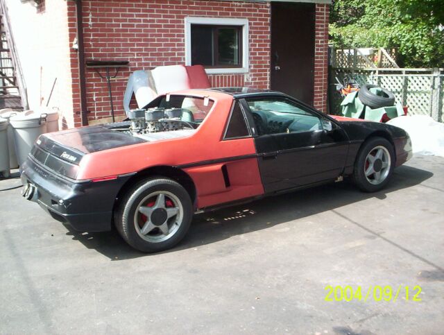

bubbajoexxx (bubbajoexx@sympatico.ca) MSG #66, 10-08-2003 08:32 PM
      these are the heart of the swap DELLortos=one carb per cylinder
bubbajoexxx (bubbajoexx@sympatico.ca) MSG #67, 10-08-2003 08:38 PM
      by the way this is the engine

      Hey bubbajoexxx, those Dell-lortos carbs, are those the ones that are going onto the Northstar? What gains are there compared to the normal fuel injection?

bubbajoexxx (bubbajoexx@sympatico.ca) MSG #72, 10-09-2003 08:03 PM
      madcurl
as of yet there are no hacks for the engine as it is an 01 so this was the next best

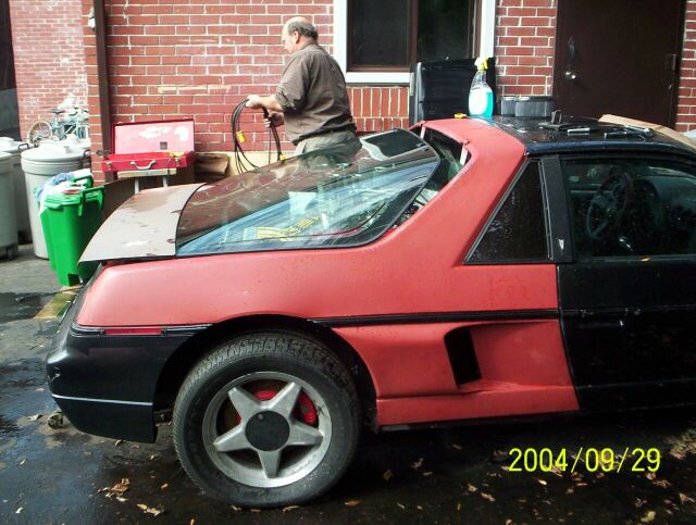

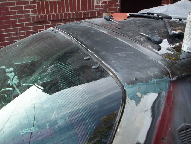

bubbajoexxx (bubbajoexx@sympatico.ca) MSG #74, 10-11-2003 07:12 PM

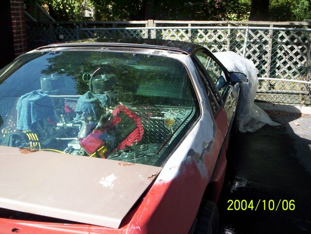

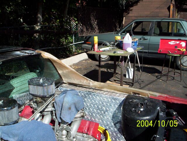

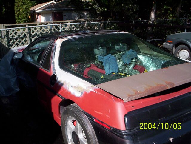

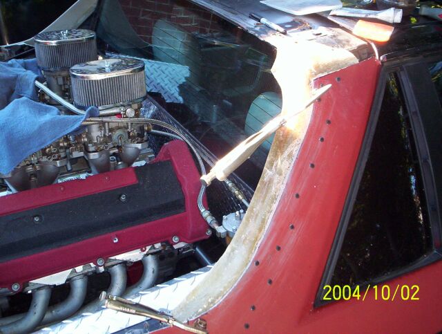

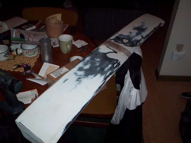

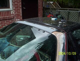

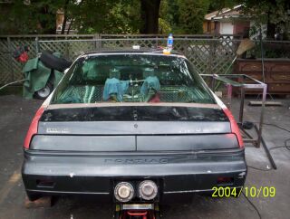

      rear is now framed and glassed and rear of roof attached now have to fill in the roof and part of the sides so windows can be installed

      I'm curious as to how you're going to access the engine compartment with the wagon roof on the car. Will the whole assembly be hinged? It doesn't look like it in the photos...
bubbajoexxx (bubbajoexx@sympatico.ca) MSG #82, 10-14-2003 11:33 AM
      you will see in tonights pics it is hinged

bubbajoexxx (bubbajoexx@sympatico.ca) MSG #87, 10-14-2003 06:40 PM
      rear section removed from the car as you can see its not part of the car

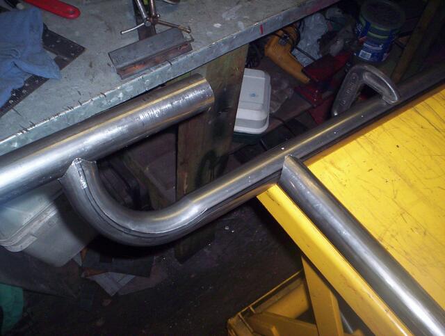

yosemitefieros MSG #89, 10-15-2003 12:23 PM
bubbajoexxx, what thickness metal stock did you use for the extensions? Also, what did you use specifically on the cradle?
Gary
bubbajoexxx (bubbajoexx@sympatico.ca) MSG #90, 10-15-2003 04:28 PM
      1/8 on extention and 100 wall on upper rails and cross bars and 3/16 on the cradle

      latest pics

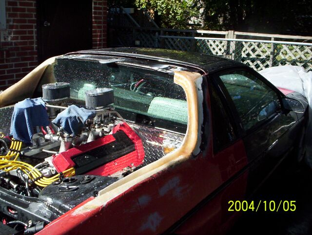

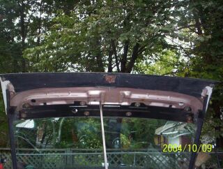

as you can see the roof is taking shape. It's hinged the rear is attached now it is time to fill in the center section and cut out the window openings
bubbajoexxx (bubbajoexx@sympatico.ca) MSG #92, 10-15-2003 04:44 PM

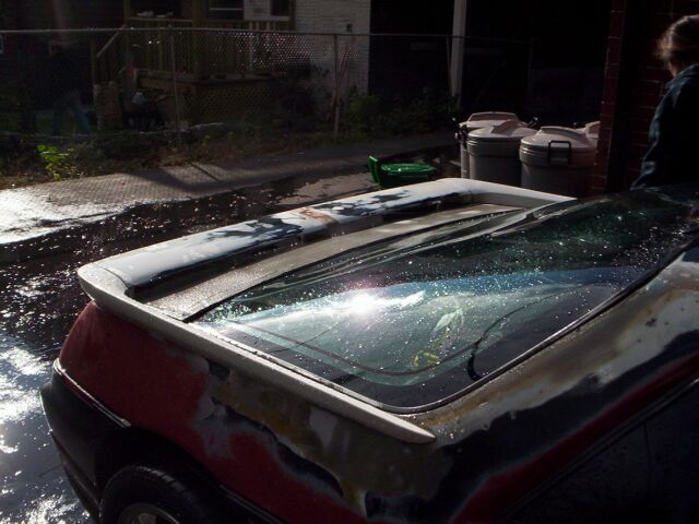

bubbajoexxx (bubbajoexx@sympatico.ca) MSG #93, 10-20-2003 05:26 PM

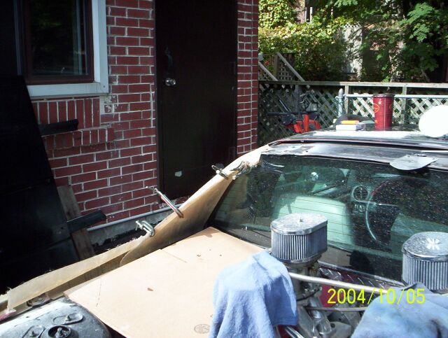

      roof almost done check out the roof scoop

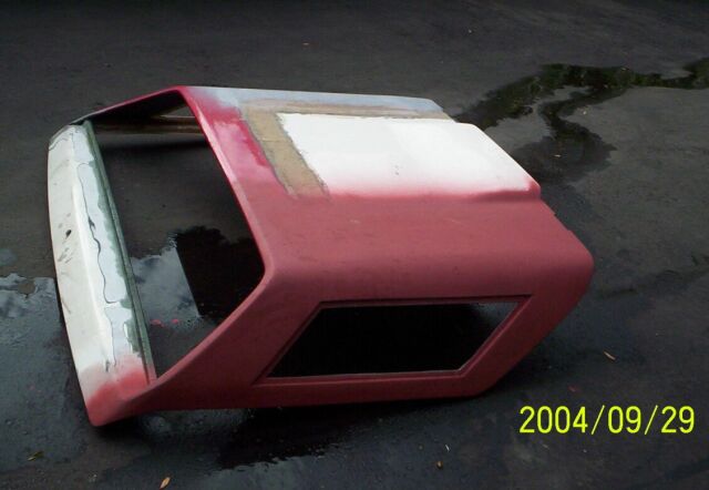

bubbajoexxx (bubbajoexx@sympatico.ca) MSG #95, 10-20-2003 06:29 PM
      the roof is one piece and lifts from the rear and the old deck made a good filler for the center of the roof . also I must mention that my bud Bobert a member here has help emensely with this stretch project and has contributed many ideas as how to go Thanks Bob you deserve it Bubbajoe
for more pics go to
http://www.fortunecity.com/skyscraper/switch/67/id210.htm

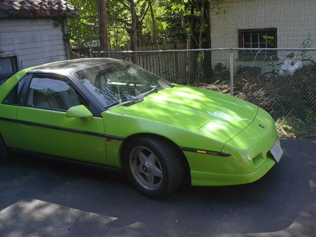

      Hey bubbajoe, can we see that green car under the tarp next to your project?
bubbajoexxx (bubbajoexx@sympatico.ca) MSG #113, 10-21-2003 07:47 PM
      Ya no problem GORDO
84 Fiero 4.9 V8 digital dash full gt package
86 vette hood scoop and much more

Bobert (simpsonbob@rogers.com) MSG #114, 10-21-2003 08:30 PM
That green Fiero has a future in my driveway.
Built by Bubbajoe, it is one sweet ride!

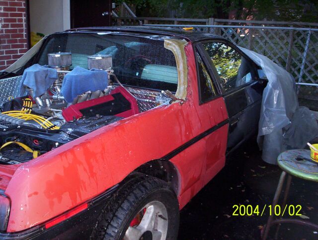

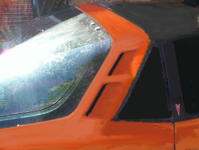

bubbajoexxx (bubbajoexx@sympatico.ca) MSG #119, 10-23-2003 06:33 PM
      latest update scoops on the car and they fit perfect
should provide plenty of air for the side mounted rads

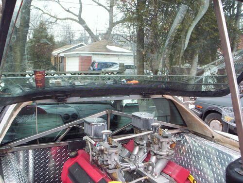

bubbajoexxx (bubbajoexx@sympatico.ca) MSG #123, 10-25-2003 08:57 PM
      engine starting to come together
Boricuasoy (powernaudio@gmail.com) MSG #124, 10-26-2003 08:26 AM
      looks like an indy car engine or something nice work.

bubbajoexxx (bubbajoexx@sympatico.ca) MSG #127, 10-26-2003 08:01 PM
      have you seen the scoop pics on page 3 smoooooth

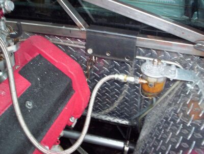

bubbajoexxx (bubbajoexx@sympatico.ca) MSG #136, 10-28-2003 03:20 PM
fuel system done except for the other stacks (on back order) time to go back to fiberglassing and the ichies while I wait for more parts

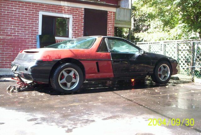

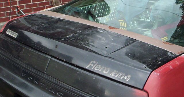

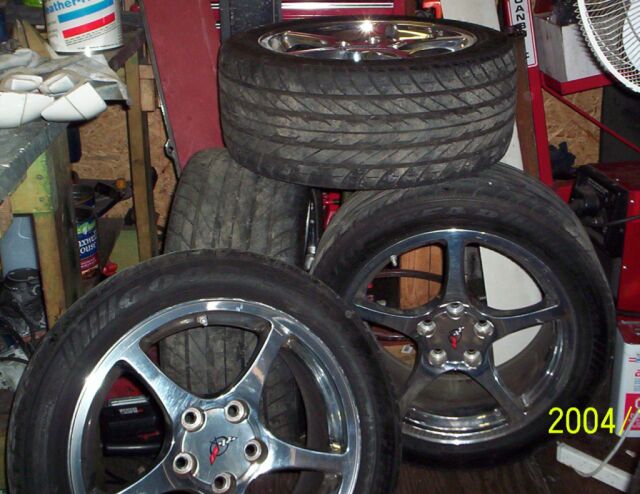

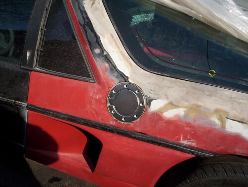

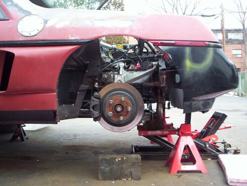

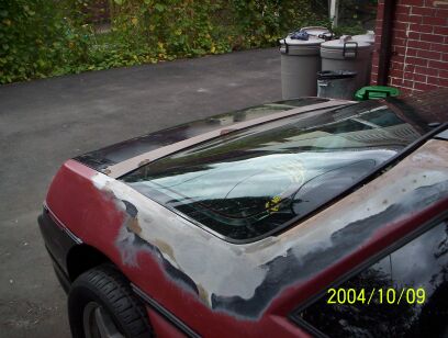

bubbajoexxx (bubbajoexx@sympatico.ca) MSG #166, 11-15-2003 08:49 PM
these are the latest pics of the body so far
engine dist pics will be posted on friday when the parts are back from the machine shop
crzyone (crzyone@cablerocket.com) MSG #167, 11-15-2003 09:48 PM
      Man you work fast! Nice job!
Kento (kento@triad.rr.com) MSG #168, 11-15-2003 10:20 PM
      Bubba,
I think those rims are WAY WRONG!!!! for that car. Please remove then and box them up and ship them to:
Kento
Sunny Place
Orlando FL
Once recieved I will put them on a car that is better suited for that style rim.
Thank you for reading, I return you to your regularly scheduled thead.
Nice job so far Bubba.
Mach10 (sfogg@shaw.ca) MSG #169, 11-15-2003 10:50 PM
      OMG... Paint it before I throw up...
that's some NASTY peeling up front. Didn't your mamma ever tell you to wear sunscreen?!?
Other than that...
Wow.
Not my style... but... WOW...
Gordo MSG #170, 11-16-2003 01:09 AM
Looks to me like one heck of a lot of sanding has been done to that nose.
Can't wait to see this all in one color (or at least in primer)!

      NEWEST PICS SO FAR
ENGINE AND TRANS CONNECTED

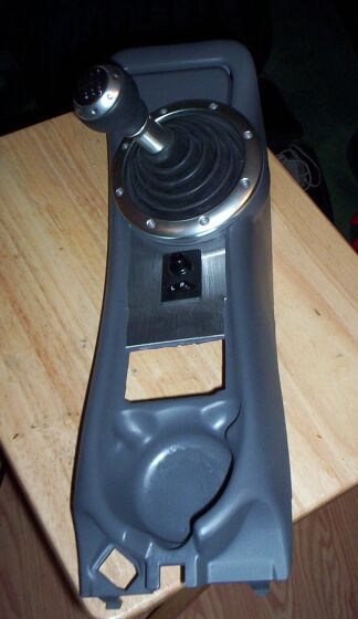

      just finished the shifter fore the porsche trans axle will post pics tomorrow night .
Have more to do tomorrow will have all the pivcs taken then so you will have a recient update

      just a question i always wondered about goin longitudinal wat do u do about the shifter cables this is the only thing buggin me id like to know its just buggin me like the fiero bug witch is very good
bubbajoexxx (bubbajoexx@sympatico.ca) MSG #242, 02-18-2004 12:11 PM
      Im using the stock cables and shifter will post the pics of the setup later today

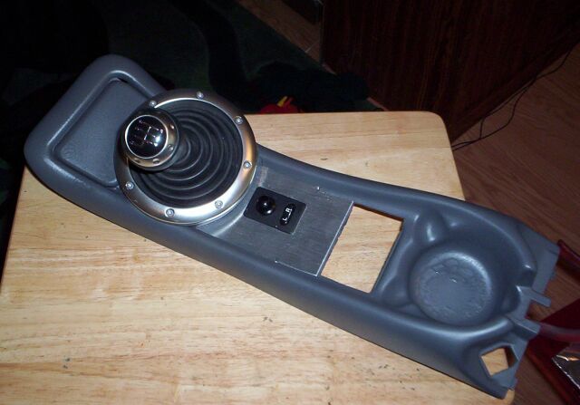

bubbajoexxx (bubbajoexx@sympatico.ca) MSG #243, 02-18-2004 01:44 PM
      here are the shifter setup pics hope they help you out
[This message has been edited by bubbajoexxx (edited 02-18-2004).]
fieroman87 (fieroman87@juno.com) MSG #244, 02-18-2004 04:20 PM
here are the shiter setup pics hope they help you out
read that again there Bubba
bubbajoexxx (bubbajoexx@sympatico.ca) MSG #245, 02-18-2004 04:34 PM
      oops we all have them bad days
fastbackboy MSG #246, 02-18-2004 04:48 PM
      thankx bubba i had always wondered how folks hooked a porsha tranny up now i know so wen i get the money ill have the idea how to do it +for ya

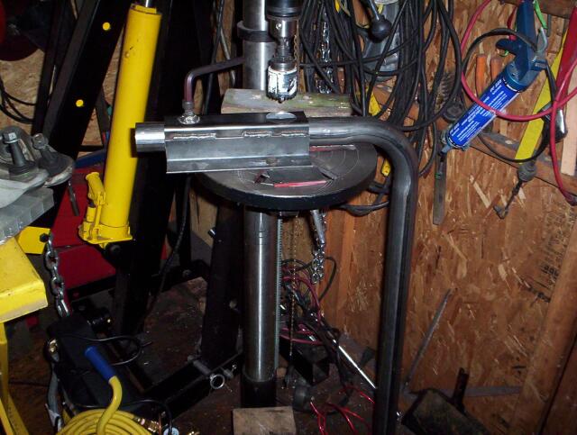

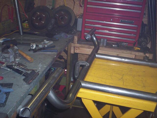

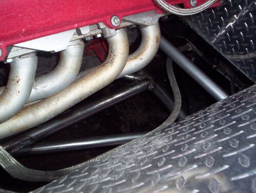

      started making the headers. they seem to be coming alone fine as you can see
[This message has been edited by bubbajoexxx (edited 02-22-2004).]

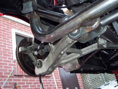

bubbajoexxx (bubbajoexx@sympatico.ca) MSG #249, 02-24-2004 11:17 PM

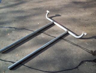

started to build the exhaust piping for the engine all 3" to 5 inch supertraps at the exit .where it will come out is where the rear plate used to be
