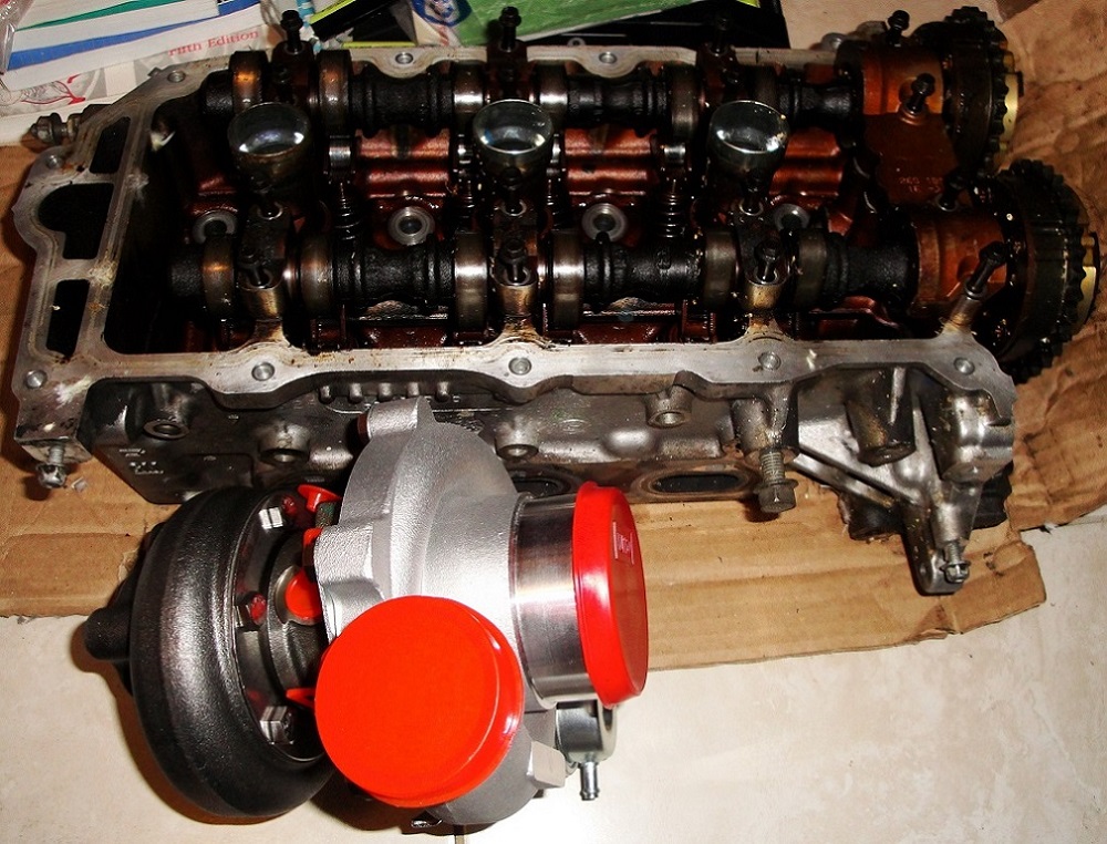

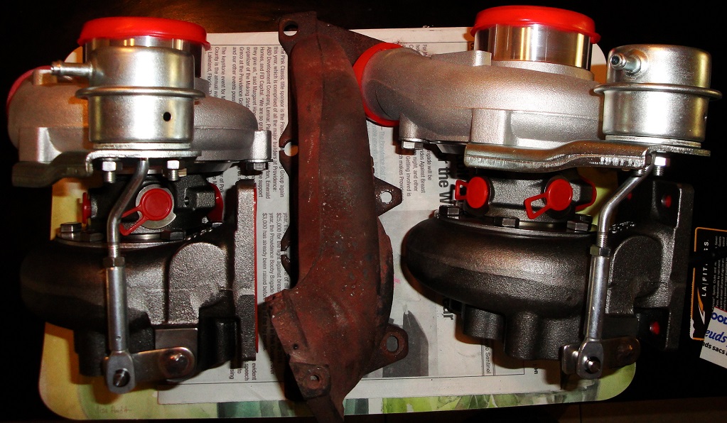

bmwguru (bmwguru@optonline.net) MSG #25, 09-12-2016 06:28 AM
Originally posted by dobey:
There have been many threads about this on here, but so far nobody has done one.
The closest would be the Saab 2.8t (LP9 high feature engine) swap that bmwguru did on his car. I'm not sure if he's finished it yet though.
I have been so consumed with my shop over the past two years, I put the project on hold. I did shoot this video the other day when I blew the dust off the project. I plan to get it over to the dyno shop in a week and actually enjoy the car in the very near future. I love the way the car sounds and the engine really likes to respond to the throttle with minimal mods. I couldn't get the video to embed.
Dave
https://youtu.be/eZwOlswP6-Y

That one was when I was running the stock Saab ecu, but I couldn't get the ecu to control the mixture and throttle the way the AEM does. It became a new car with the AEM ecu

      Figured that Dave would get this swap done and running. As for the AEM ECU; they make plug in units for mostly imports and if you are a member of the auto trans club as I am, you are S.O.L. With the AEM it appears that you must start the tuning from scratch but is there a work-around for the DOD or VVT? . Eventually there is a work around for everything it seems as the Ecotec guys have proven but don't see much in the way of managing control of this engine with an auto. This engine is the next logical step beyond the 3800 and I hope that it catches on.
bmwguru (bmwguru@optonline.net) MSG #32, 09-15-2016 03:28 PM
The AEM will work with the DBW and VVT. I used an Infinity-6 and made the harness myself. A lot of the sensors are AEM specific and it wasn't bad to do. I did have to swap the Saab VR crank sensor for the Camaro 3.6 hall effect type to make it work.

I've been musing for years that it would be fun to bolt the Saab turbo system up to an LLT... although with a bigger turbo, of course.

Will (william.lucke@gmail.com) MSG #127, 01-09-2019 04:36 PM
      The later twin turbo V6's use integrated exhaust manifolds and the turbos bolt directly to the cylinder heads. Just use the whole pullout engine in that case.
The Saab manifolds should bolt right up to the LLT and the crossover pipe will most likely work too... just needs a bigger turbo. Although I don't know where the HPFP is on an LLT right off and how it would relate to the crossover pipe.

Joseph Upson (j.j.upson@worldnet.att.net) MSG #128, 01-09-2019 05:11 PM
Originally posted by Will:
The 2.8 *IS* a high feature V6.
Do twins Will, that's what I'm planning for the CTS. I'm collecting hardware for the build now and sizing things up with the intent to mount the the turbos up high for gravity oil return instead of the scavenge pump most of the turbo Camaros are using along with low mounted turbos, as well as leaving room for catalytic converters.
The turbos are pretty compact next to one exhaust manifold, GT2860s with .86 turbines and ~330 hp rating. Not expecting to have it done by the end of the year but would at least like to have it completed on the engine stand. The aftermarket supercharged camaros are achieving 400+ hp at the wheels, the turbocharged versions are doing even more except with a lot more torque and using less boost pressure, best dyno sheet I've seen was 500 hp and 475 ft-lbs at 11 psi. I'm not aiming that high but, would like to reel in the 0-60 times from 6 sec to the 4 sec range with the 6 speed auto. It already has 11.3:1 compression so no engine modifications are necessary to increase it.
