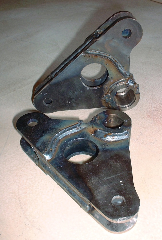

Second order of business is to finish posting the photos of the bell crank build up. Here's a close up of one of them showing just how hot things got to assure good weld penetration between the 3/16" plate steel and the hub which measures 9/32" thick. I find the heat patterns left on the steel are a good clue that there was even penetration. The other thing you can imagine is how disappointed I was with all the spatter, especially after making all the parts so clean and tidy!

This may sound like a silly question, but why is the triangle made of two pieces?

Thanks X-Body. I mentioned it earlier, but the reason each side of the main body of the bell crank was made in two pieces is so that I could accommodate the 5/8" width of the pushrod spherical bearing at one end, and the 1" wide spherical bearing at the end of the shock absorber. I could have made the bell crank 1" wide over it's entire length and used spacers on the pushrod bearings to make up the difference, but that would have forced me to use a wider hub since the triangular plates would have been moved further outboard and I would have otherwise lost the shoulder that I used to weld the plates onto the hub. So what's the big deal about using a wider hub? Not much, but I felt the bell crank was going to look quite large as it was and I wanted to minimize it's visual impact. A wider hub would have also forced me to change my bell crank mount design slightly to accommodate it.
