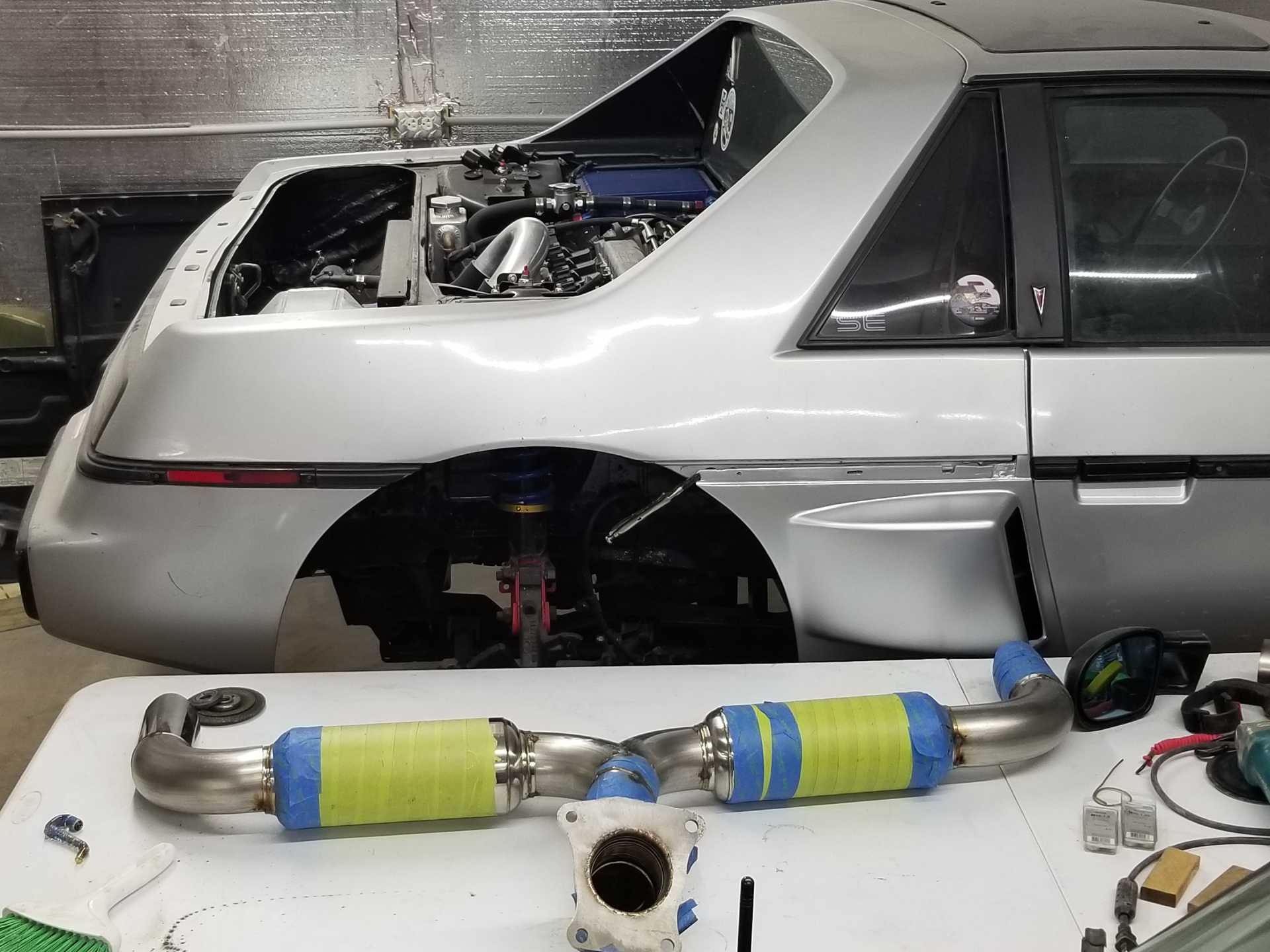

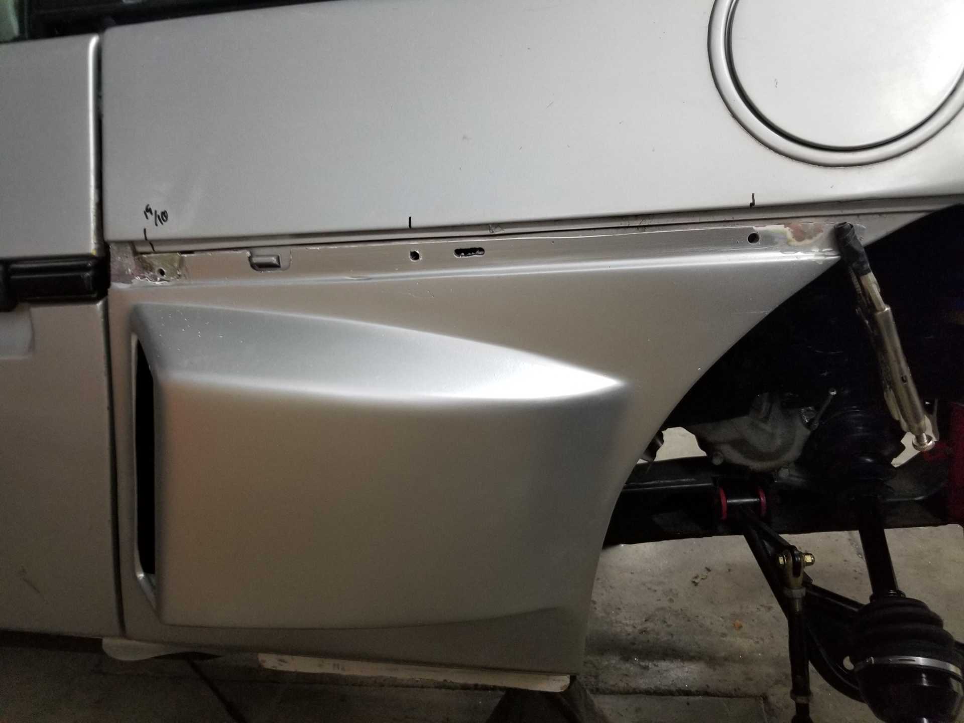

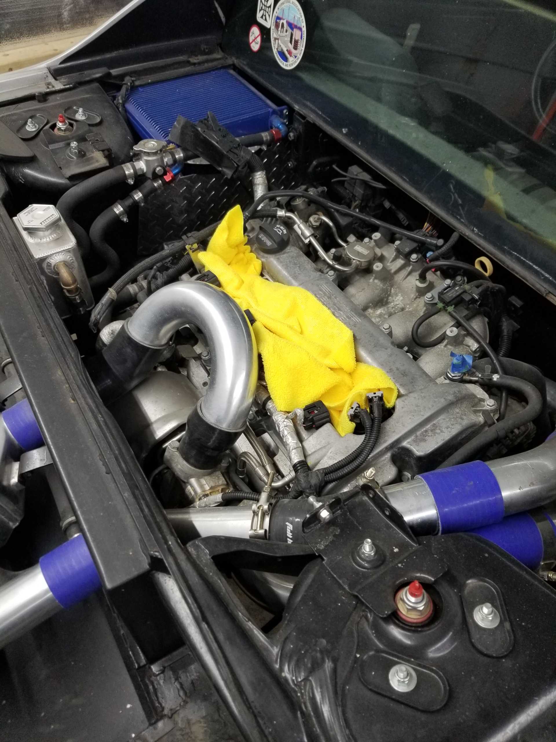

hey Guys and Gals. new member so thanks for the ad.i have an 84 notch that Ive been modding.it was my daily for over five yr ears. I have some fiberglass side scoop quarter panels that I reworked and have finally gotten to the point where Im geting ready to mount them.trouble is the panels have been off foryears and years. I have the fastener kits from the Fiero store and I dont know where and how these simple things go on. does anyone have any install pics???if not,would you please discribe the install to include the trim peice? I appreciate any hr\elp and sugestions. have a great night.[img]http://imag es.fieroforum.com/userimages/LNFiero/20210224_135658.jpg[/img][img]http://images.fieroforu m.com/userimages/LNFiero/20210225_170657.jpg[/img]

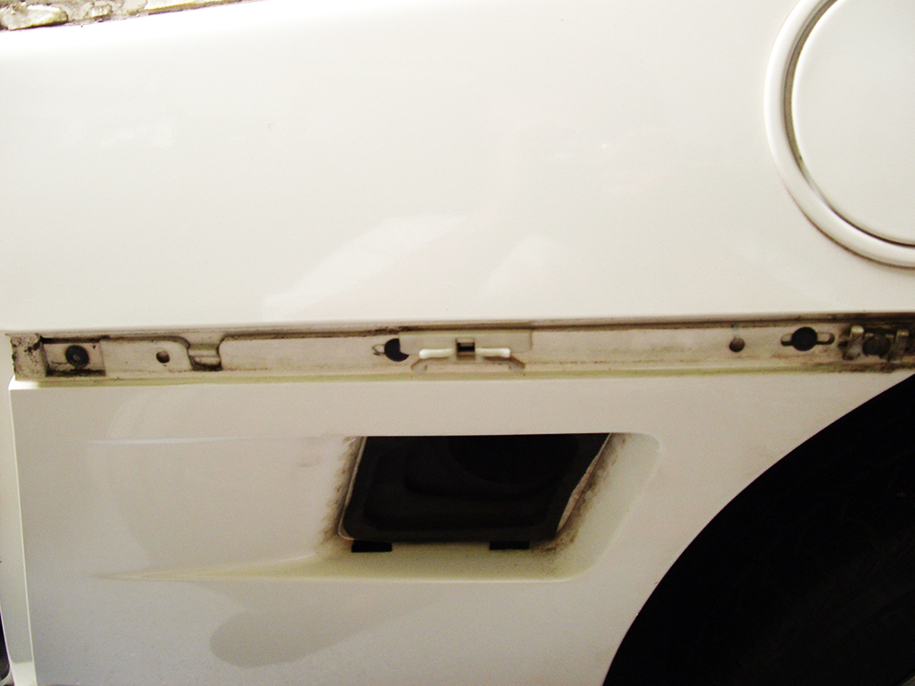

I had to really dig for this photo of my own car
This is the driver side. You can get an idea of how the clips mount. There should be about 7 total rivets holding each panel on and that little tiny rivet goes on the molding inside the door jamb.

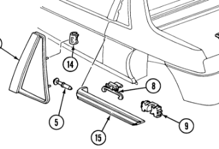

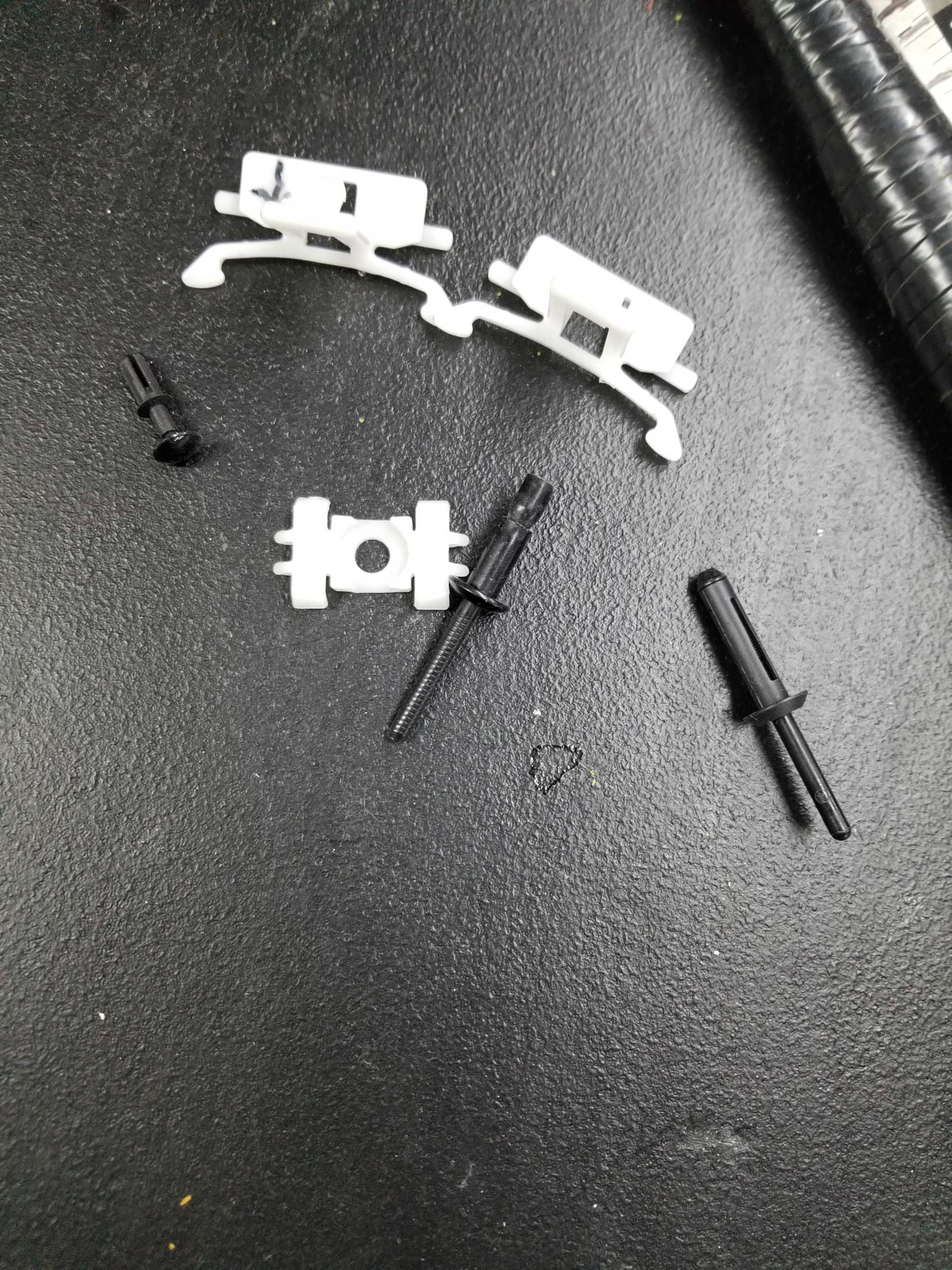

This is more simple. See parts 5,8, and 9
