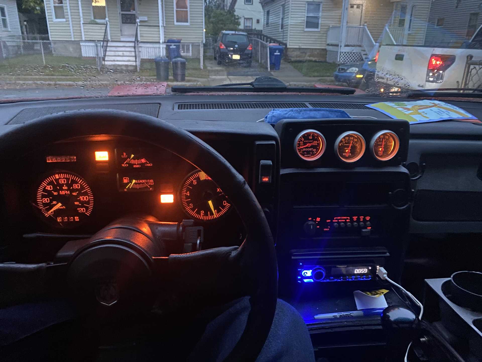

Ok I’m very confused I finally got my 3800sc with a Muncie 4 speed running and not overheating but now I’m running way to cold if that makes sense. I haven’t actually driving the car on the road yet due to not having a exhaust made yet. But idle time has been for a great 20-30 minutes here is where the temp gauge is at

I'm sure it is warming up! Does the radiator fan start up? Front radiator hoses hot?
On my car the temp gauge show always low. Use a scan tool to read the real temperature of the engine.
