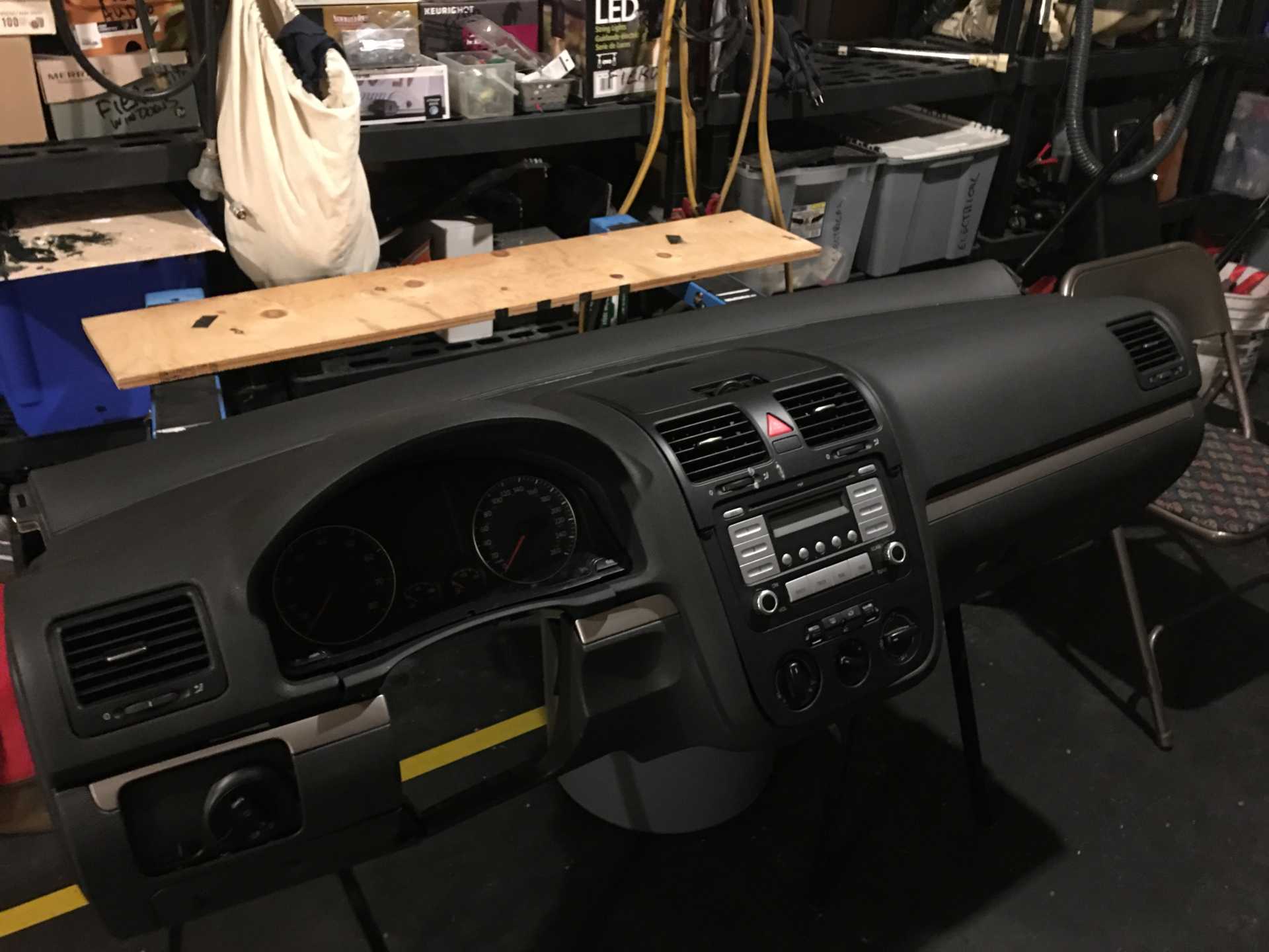

I decided on the golf. Took about three hours to remove it. Got it for $100 CAD at Kenny UPull in Montreal Canada. Included the pass. airbag that I'll sell and the radio!. I'll start a topic about the swap when I start the install.

Thx everyone for your comments. I went with the Golf as the Chevy had a larger space around the steering column and I'm keeping that stock. I'll update you when I start the swap. I've already using a custom dash I got from West Coast Fieros a few years back so I'll be using that. Never intended to use the dash from the donor car.

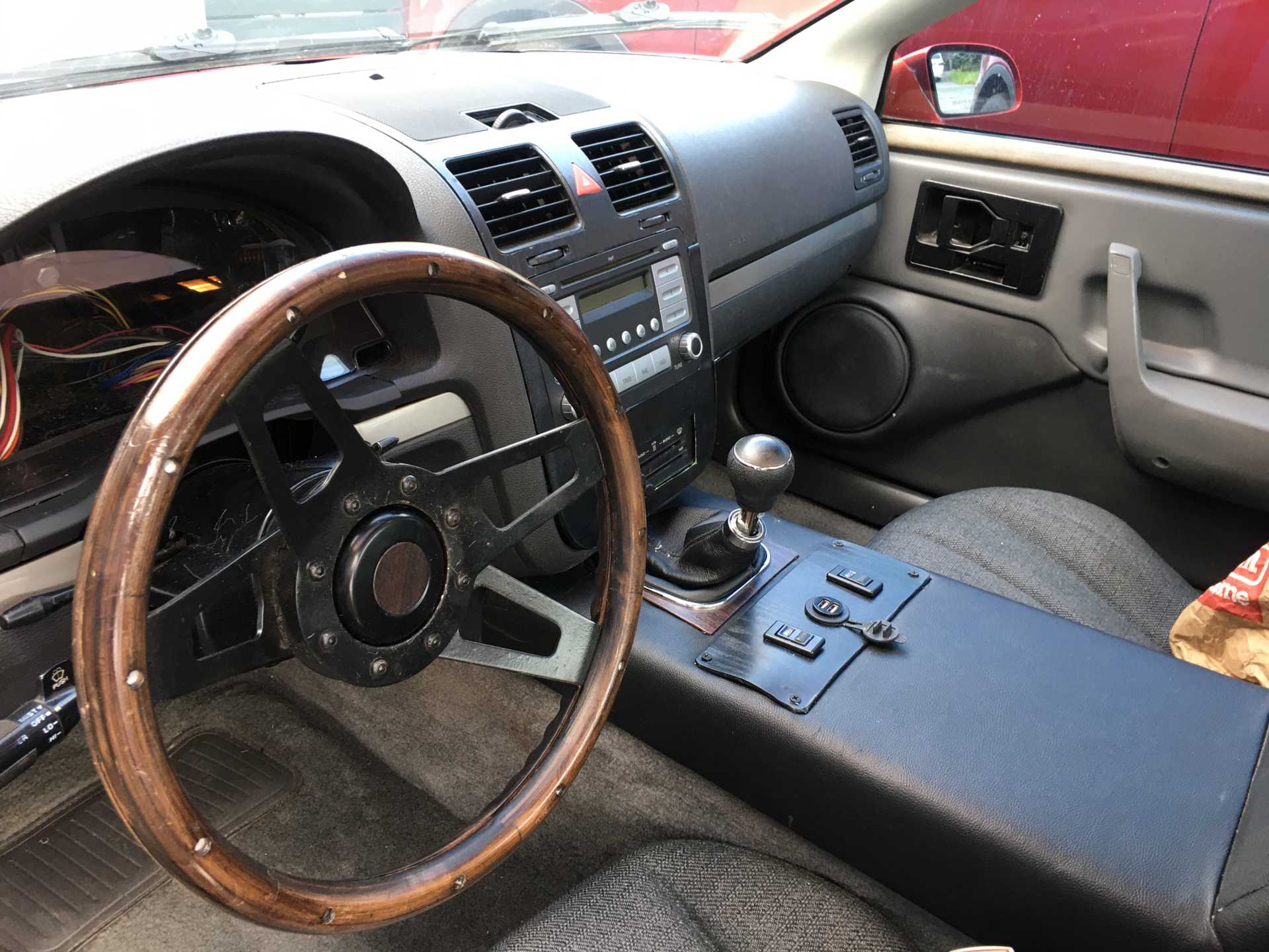

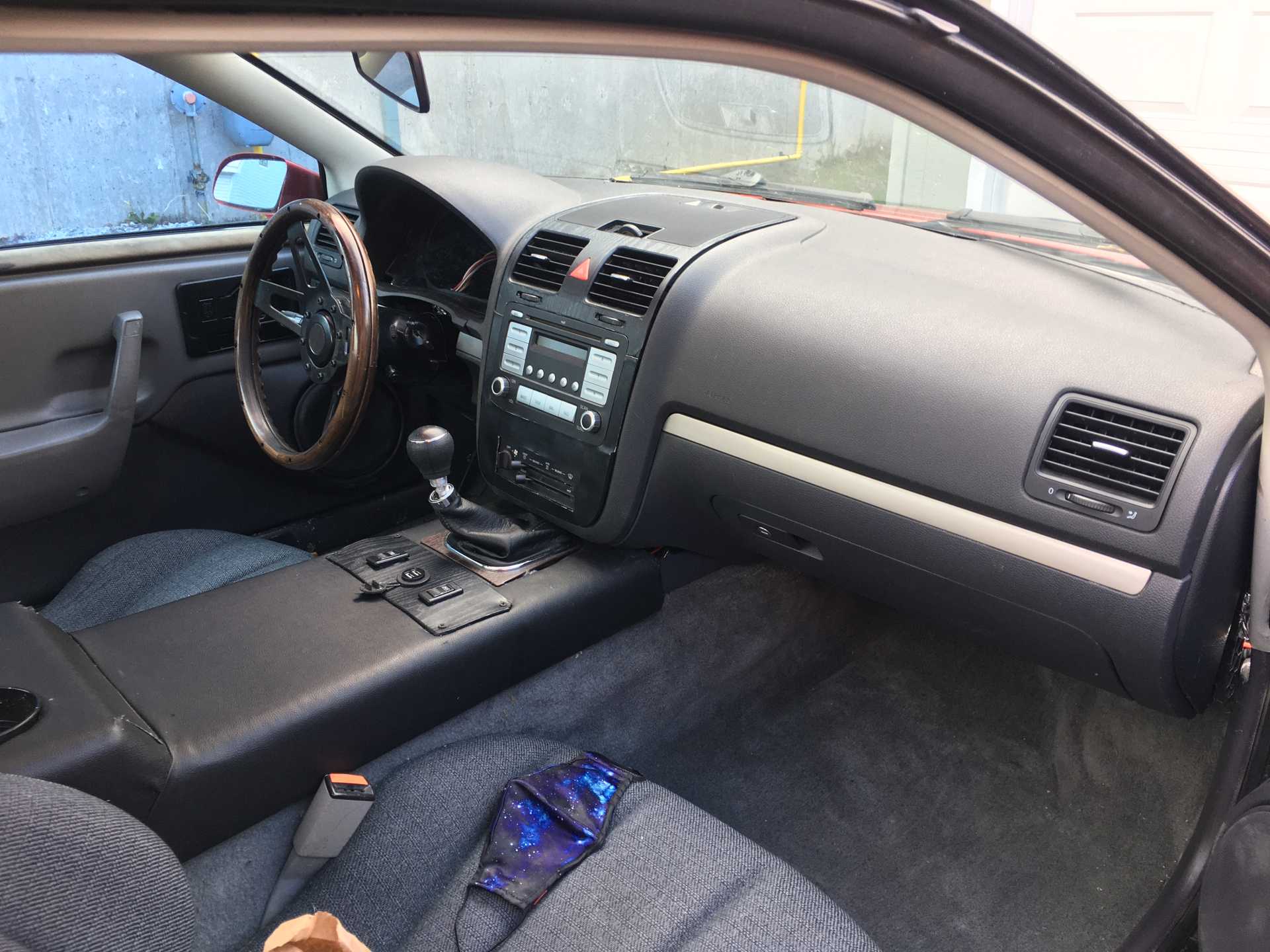

Well here it is. Over 40 hours but everything works I kept the light controls and the Hvac system with no mods except for the ventilation system.
You don’t need to be a mechanic to attempt this. Just someone who has creativity and fabricating skills.
I now actually have a glove box

You do know the 84 Speedo has the "module" for Cruise and the divider/buffer for ECM? And an aftermarket speedo doesn't?------------------ Dr. Ian Malcolm: Yeah, but your scientists were so preoccupied with whether or not they could, they didn't stop to think if they should. (Jurassic Park)
