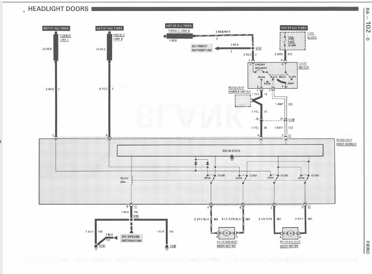

i got this headlight harness schematic from the Haynes manual. It seems to me to be the Gen 1 schematic. Does anybody have the Gen 2 schematic? thanks jon------------------ Astronomy says we will find a coded signal from outer space. Then we'll KNOW that life exists there, for coded signals aren't by chance.

Above is wrong for HL switch part... See my Cave, Service Manual notes------------------ Dr. Ian Malcolm: Yeah, but your scientists were so preoccupied with whether or not they could, they didn't stop to think if they should. (Jurassic Park)
