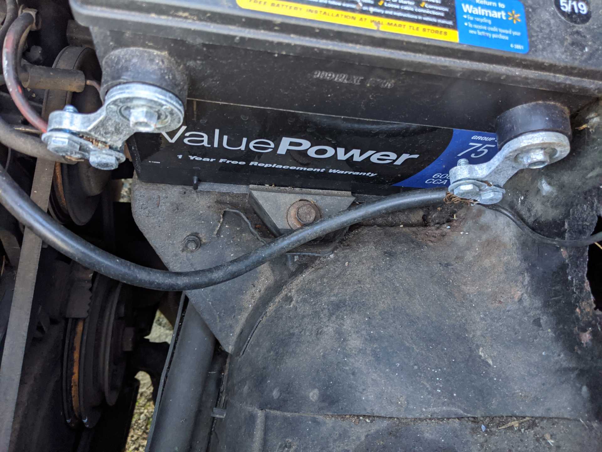

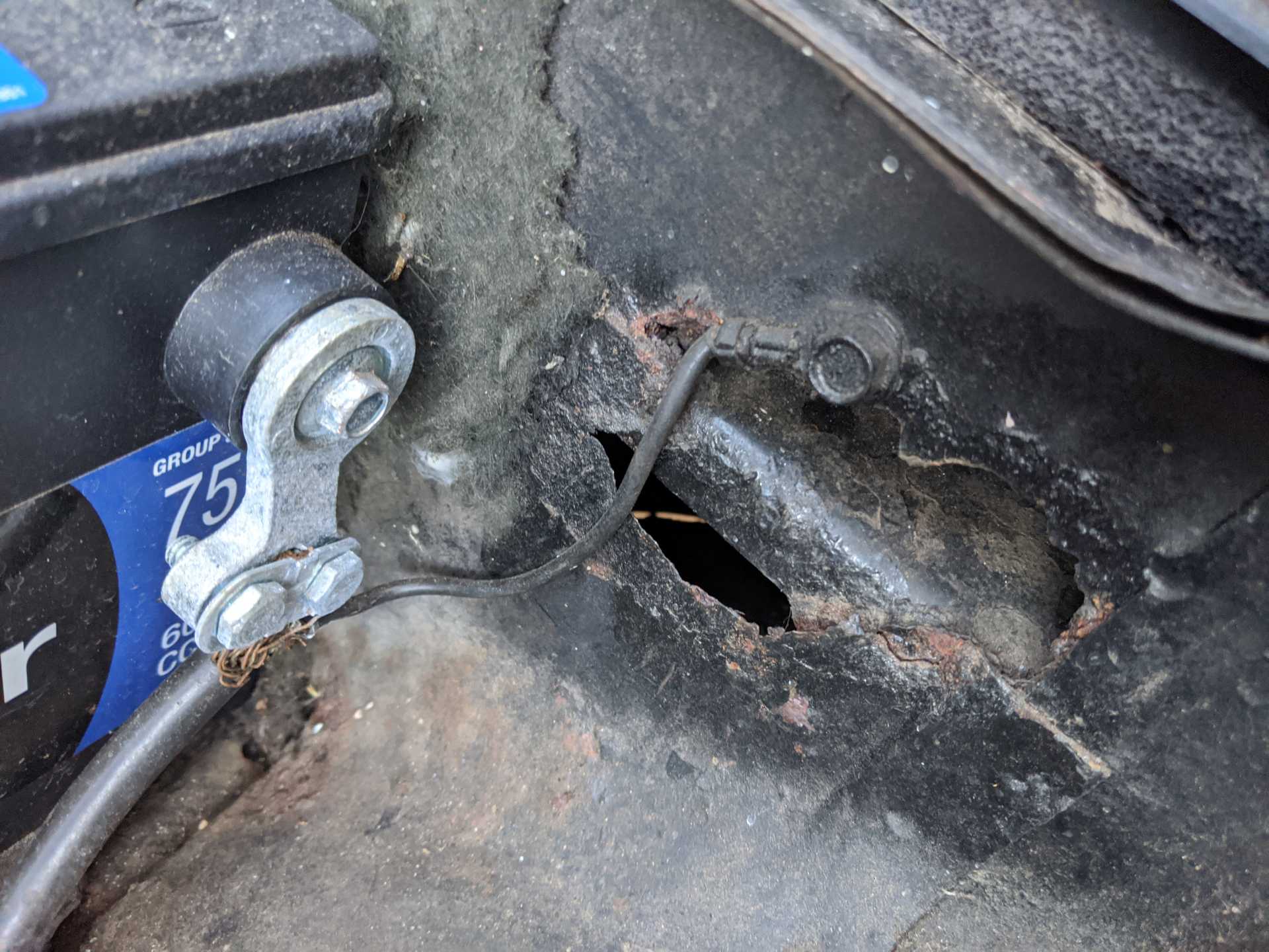

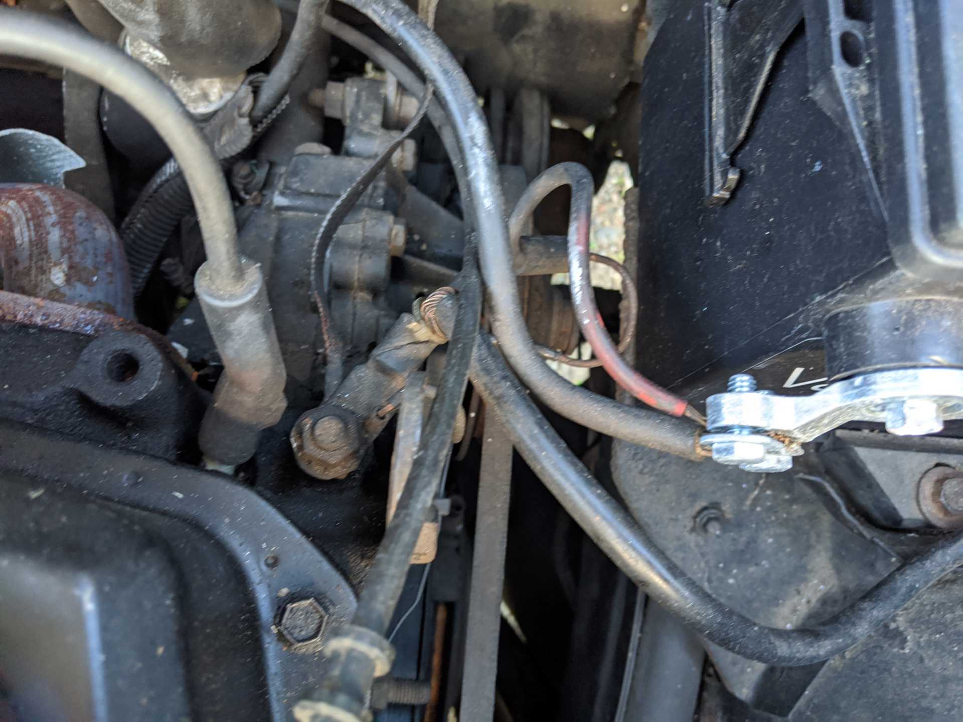

So this is what I'm working with.. I would imagine if it's a grounding issue it would be the wiring to the frame rather than the engine.
pmbrunelle
JAN 16, 09:09 PM
That entire grounding setup looks crusty...
Sanhino
JAN 16, 09:28 PM
yeah it does. I'm thinking I'll just ground it somewhere else in the interim before cutting and filling in that hole
pmbrunelle
JAN 16, 09:50 PM
The factory battery-to-body ground uses this screw:
Dremel/clean the contact area to bare metal as required for a good contact. You don't have to use that screw, but it's there for that purpose.
Everything else should be sanded / wirebrushed as well...
Since the wire strands themselves on the fat negative cable are corroded-looking, probably the cable should be changed as well.[This message has been edited by pmbrunelle (edited 01-16-2020).]
