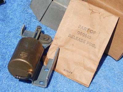

How old? I've seen Caddies using vacuum operated TPL button in the glove box for 1960's models. Still have button and vac motor from one of those because was kind of weird even then.

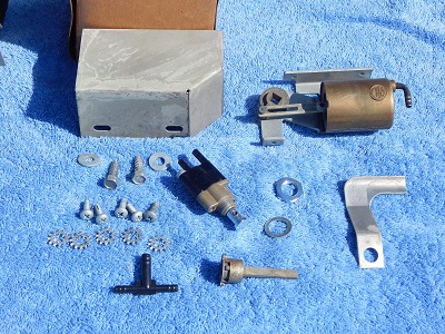

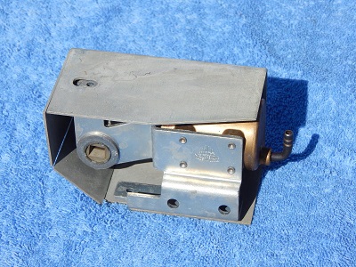

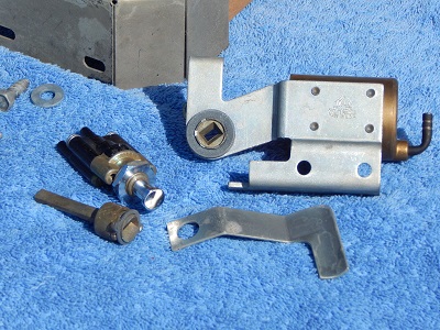

Thanks, Better then a picture just a button and motor. Was trying to find mine.
For others, the "motor" often goes between the lock and latch and won't fit most other cars because needs a lot of space. This version seem to mount lock, latch, motor, but still needs space. my motor is approx 2" x 3.5" x 4.5" just to mount w/o the case shown above then add more so more line won't pinch. Is not heavy only weighs a few ounces as cylinder is aluminum or something light.
It works same as key to turn the link. (The Vac Can shown above is way over kill just for this. That reserve could open the latch Many times w/ engine off.) Not like Fiero and others that works on back of latch and pulls the part inside that locks the part hitting the loop. IE Fiero solenoid doesn't rotate any part.
I think my motor was on frame side to get room and not flex/stress the vac line.
Is funny that they work like a key. I think Latch itself work same way as Fiero so could likely made it simpler smaller and many other was to mount. Even remote mount so doesn't need space at the latch.

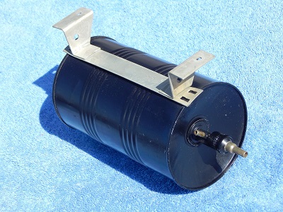

I actually used my original power brake vac-can (same size) and drilled and taped a hole then screwed in a male x thread adapter for the trunk vac hose. Non power brake cars had no need for the can. So this option would definitely be over-kill for just a trunk release. I just added a pic of my 60 in above post.
