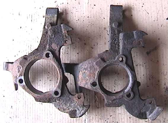

Does anyone have any pics of these? I'm looking for a more heavy duty rear spindle that will allow me to use a larger wheel bear.
fierosound OCT 07, 10:49 AM
From: http://www.fiero.nl/cgi-bin...ad=20040710-2-047965
Left is 6000 knuckle, right is Fiero...

Will OCT 08, 09:42 AM
Pontiac 6000 (and Chevy Celebrity, Olds Ciera & Buick Century) with JA2 brake package have 5x115 hub cartridges and are a bolt-in swap for '84-'87 Fiero parts. The rotors are ~10.25 x 1 vented.
They include larger 27 spline outer CV joints that plug right onto the stock Fiero manual transmission axles. They use the same ball joint and tie rod end as the '84-'87 Fiero.
Pontiac TransSport (and the other dustbuster minivans: Chevy Lumina APV, Olds Silhouette) with the 3.8 V6 in the '94-'95 years have similar knuckles, but use larger 33 spline outer CV joints as well as larger ball joints which still bolt to the Fiero control arms. The rotors are 11x1.25. This hub/brake/CV combo was used extensively across GM's large front wheel drive car line. These applications use the same front brakes as the '90's LT1 Camaro.
Because of the 33 spline outer CV's, C7 Corvette wheel bearings will fit these knuckles, although the threads have to be drilled out of the hub cartridge mounting holes and the backs of the holes spot-faced for bolt heads.
