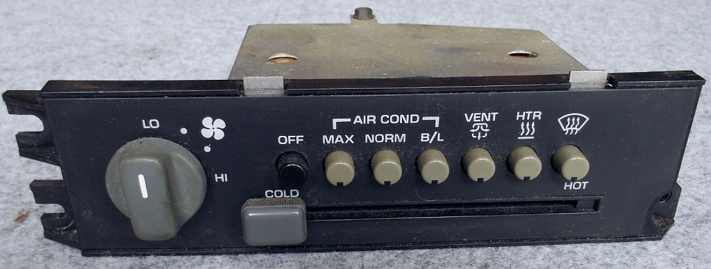

Guys... I need your help on this one. As soon as i turn on the ignition, the AC turns on. Even in the off positions, it stays on.
1. How can I disable it temporarily? fuse breaker? which one is it? 2. Where should i check to find the root of the problem?

Update.... After reconnecting and disconnecting the relays a few times.... The AC no longer blows cold air. However as soon as I turn the ignition key in the "on position" but with the engine off....i hear a motor sound(underneath the dash or in the front hood compartment) kick in. It stays on and i can feel air passing thru and under the dash. I check the front compartment and see that the radiator fan is on, but what else could be blowing the air?

There's a blower of course for the heater and A/C... but as long as the OFF button has been pushed in all the way, there should be no fan blowing anywhere. (The rad fan should only turn on if the coolant temp has reached 235°F.)

The OFF button is pushed in all the way. Motor still kicks in. How do I disconnect the blower motor?
