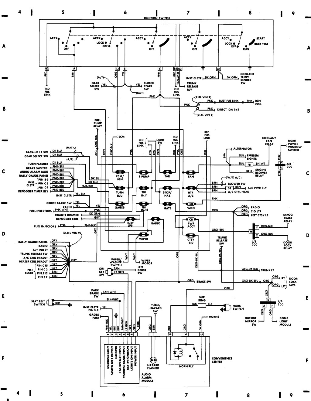

Gall757
JUN 27, 10:25 PM
You can have this one....
CSM842M4
JUL 02, 09:04 PM
I don't know what manual that diagram isthe out of, Gall757, but its quite the bomb. I'm guessing the FSM? Anyway, I just got to be in the car for a minute, and the grounds on both multi-pin connectors are grounded, and the pink/blacks get battery voltage. So, the mystery continues. Hate to think I'm going to have to pull the instrument panel out, but it wouldn't be the first time.
JUL 02, 10:01 PM
That's a nice diagram, but it's not from the FSM.
