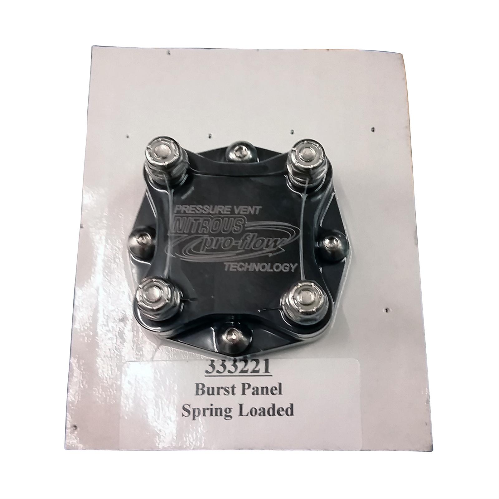

I'll fix that problem with this part and also getting in the habit of having the throttle opened a bit at least at the first couple seconds of hitting the start button. E85 also comes with its own oxygen so I believe that was also part of the problem.
The support from MS told me that that happens sometimes because when powering up the ECU it triggers the coils on re boot. The problem is more pronounced since I now have DIS and E85, before with the distributor and gasoline it was less likely to happen.

I know you are trying to save weight but that does look like it's too thin...
As for a solution...just add a blow-off valve.

You know, that was the first thing that came to my mind Lou!

I was thinking; my injectors are high up in the runners and E85 has its own oxygen and that makes a big problem. All it takes is to have some residual fuel in the runners and an intake valve open. In my case, I hit the start button, the spark plug fire (waste spark) and the residual fuel in the runners ignited. Having the TB closed and the explosion expanding without a way out, the manifold weld gave out due to the energy of the explosion. I never had this problem with non-oxygenated fuels, I switched to E85 I started backfires here and there, but this one was severe.
