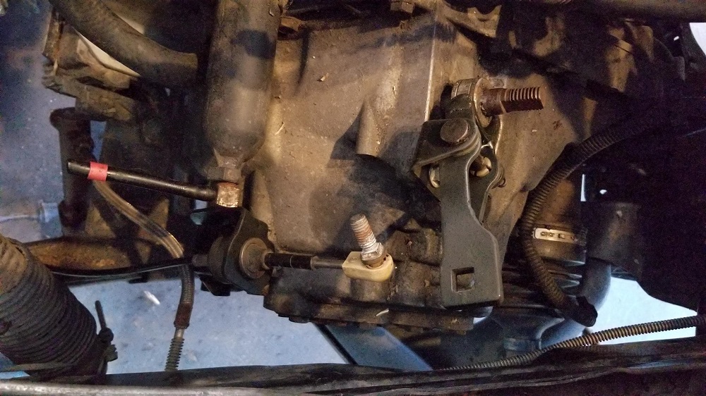

The loop on the engine side of the shift select lever hits the tranmission case, preventing the lever from moving the rod in.
I'm considering cutting off the loop, where the tape is in this photo, and welding in a piece of metal where the piece of wood is, or maybe on the other side of the hinge, closer to the shift rod.

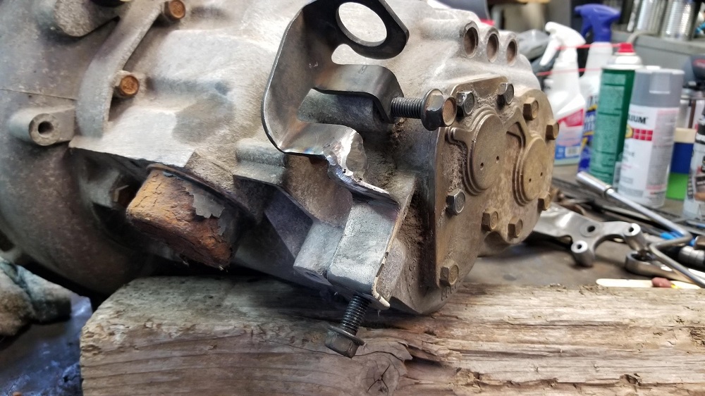

The other issue to address is mounting the bracket for the select cable. The GTZ Getrag only has one boss and bolt hole where the Fiero Getrag has two. These photos are from a spare Quad 4 transmission sitting on the floor in the shop.
I know I've seen photos of how others have solved this, but I'll have to look around the internet to refresh my memory. IIRC, the process involves welding a flange onto the bracket that will allow it to use one of the bolts for the inspection cover on the end of the transmission.

Progress. I cut then welded the select lever.
When I checked the fit, I found a new problem. The lever hit the mounting flange, so I cut out a section of the flange then welded a small piece of metal down its length to reinforce what was left.

I modified the select cable bracket to fit the GTZ Getrag.
When I installed everything on the transmission, I discovered a problem. The mount put the select cable end about 2" too short of the select lever.
The reason for this was something very obvious that I'd just missed. The GTZ transmission only has one boss for a bracket. Years ago I'd seen how Sardonyx had handled this in his thread. His Quad Getrag has the same two bosses as the Fiero, they just needed to be tapped:

I guess GM used some different Getrag cases with Quad engines over the years. To fix this, I changed the size and shape of the extra metal I welded to the bracket.
To get the right mounting position, I moved the linkage from the engine side while watching the shifter through the back window.
With everything installed, I sat in the seat and shifted the transmission. The select cable side of it felt pretty stiff so I will likely replace it with a Rodney Dickman cable. The shift cable side worked perfectly.

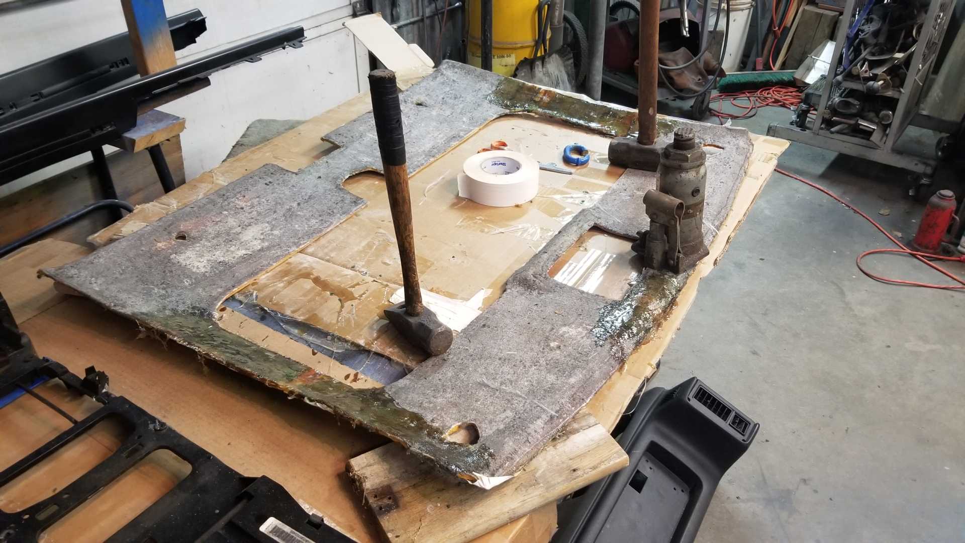

I fiberglassed the joints of the backer board. A couple hammers and a jack helped hold it in place.
